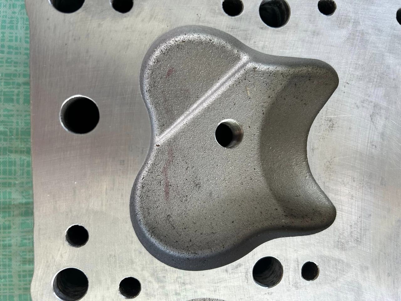

    Martin, I will take pictures of the 7X 232 iron cyl head  showing the Modified chamber and the Factory Part Number stamped on top of head . Tomorrow and send them.
      Rudy Bennett
  • Rudy, any chance you could post the photos here? I have two 232 heads that are drilled for 1/2" head bolts, (one, on a known 7x engine) I would like to compare with another that I have, that I'm sure is not 7x. (7/16" holes)
  • super651
    super651 Senior Contributor
    Yes i will do that .I hope to have pictures on here by Saturday .   Rudy.

    Posted per Rudy Bennett’s request-
    We removed paint and this # was stamped where the original one was cast into the 232 7x Head. The factory did this stamping as the engine had the head  and oil pan and front cover on it.

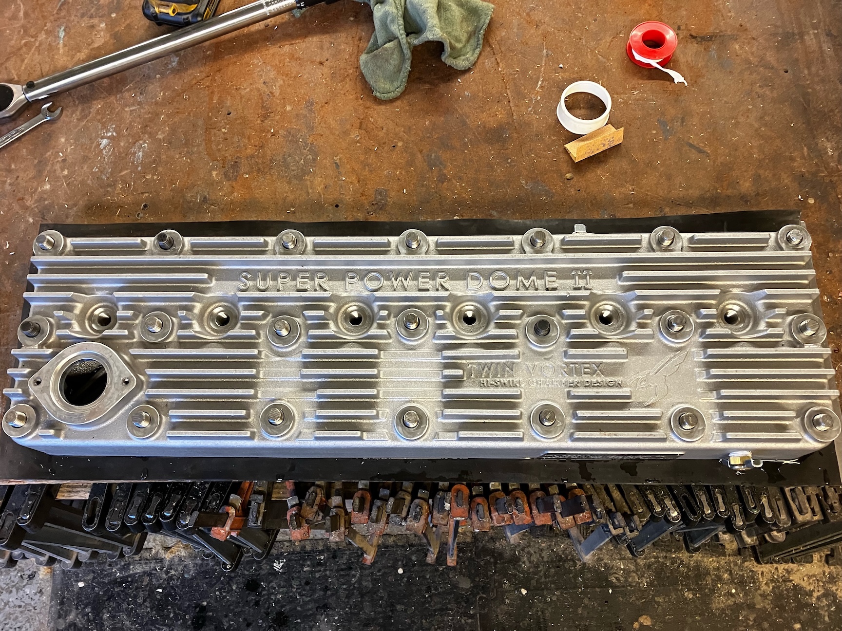

    I have a 232 head from machine shop - ready to go. In SLC, UT.If interested I will come up with price. Gert
  • Courtesy Man
    Courtesy Man Expert Adviser
    It is steel head not alum. Gert
  • 50C8DAN
    50C8DAN Senior Contributor
    I have these available, same CR as 232, but with revised combustion chambers
