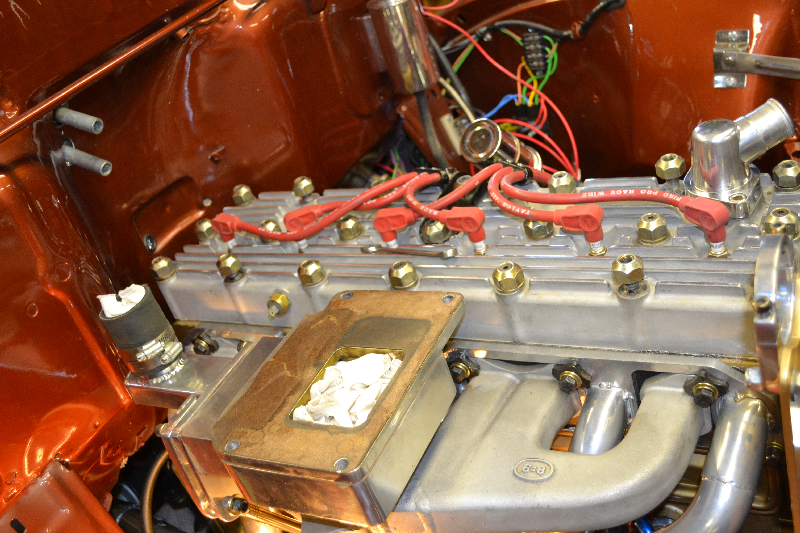

Thats a nice intake can those guys make an aluminum version of the Twin H intake? just the weight savings over the cast would be great.0

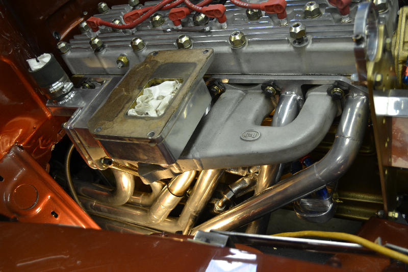

Check Out these Custom built Headers for Butch's Hudson....They are I 3/4" Tubes, not std 1 5/8" because of Supercharging.....
(I dont know who Fabricated those beauties).....0 -

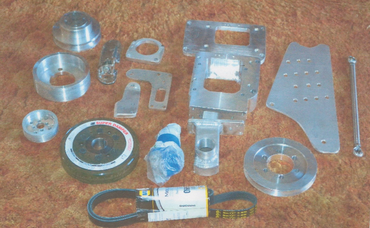

FYI
Mock up picture of Blower Drive Extension housing, Fabricated Bracket, Custom Billet Pullys, & Serpentine belt by Rich Thompson, of the Hudson Boy's.....0 -

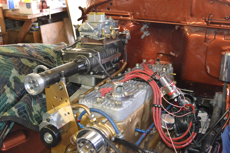

FYI
The latest picture of the big Superharger mounted on the Mock Up Hornet Motor.
The Fabrication by Rich Thompson of the Hudson Boys is completed0 -
Can that Manifold take one 4 with out the blower? That would be a great 4 bbl intake. Also will it fit a 308?

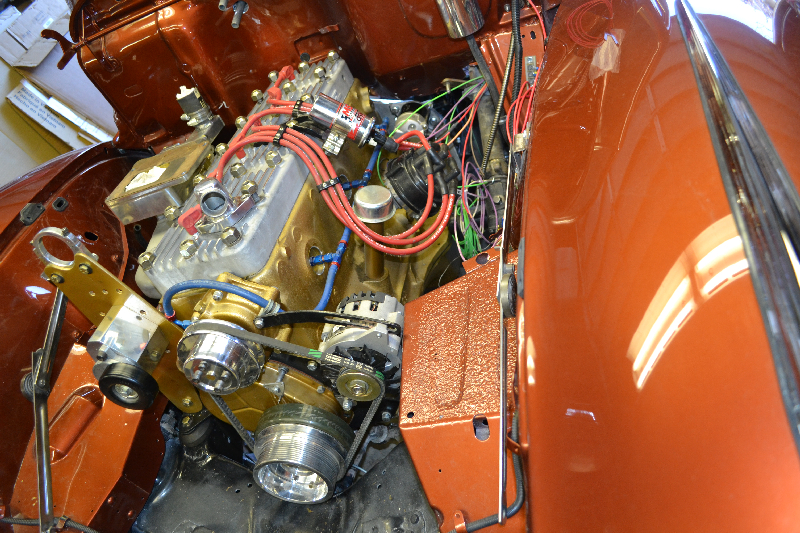

FYI
Another picture of the Supercharger with the Custom Headers0 -

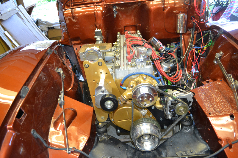

FYI
New Picture of the Motor in the '47 Hudson Cpe and a nice shot of the Custom Blower Set Up & that Rare Aluminum Head designed by Rudy Bennett & Chuck Fellows from Texas...
Someone asked about HP. but not mine to say ,but probably over 400 depending on Pully size since a Stroker with similar Mod's will pull 350 HP....
