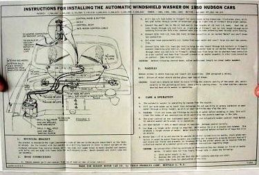

I am adding a windshied washer to my 54. Can someone post a diagram of how the vacuum hoses are routed and connected?
Chris: I need to find the Hudson Merchandiser sheet that shows this but in the mean time the attached file is a picture of the installation sheet for this accessory. Unfortunately this picture is very small and low quality so it does not enlarge well. I do think it will have sufficient clarity to show you the routing of the hoses.I found the PDF pages and they are also attached.1
That PDF page is perfect. Thank you Oldfarmer!
