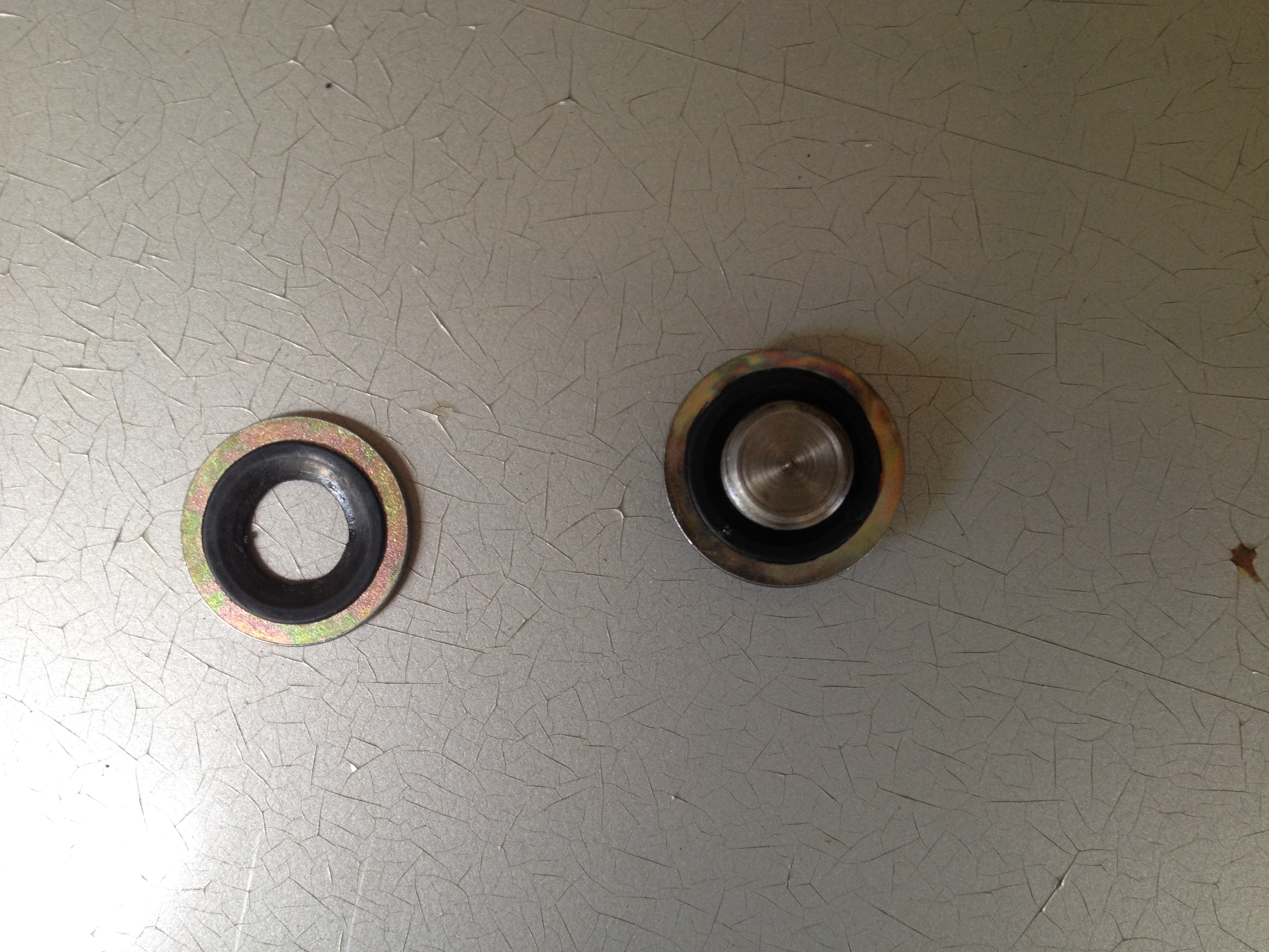

Got these washers/seals from auto store. Probably designed for a drain plug. They look like they could work because of tight rubber seal attached to steel ring. Anyone try these?0
airbrushguy how did your new seals work,where did you buy them?0
airbrushguy said:Got these washers/seals from auto store. Probably designed for a drain plug. They look like they could work because of tight rubber seal attached to steel ring. Anyone try these?
Looks like a Buick oil drain plug gasket , circa 1990'S0
