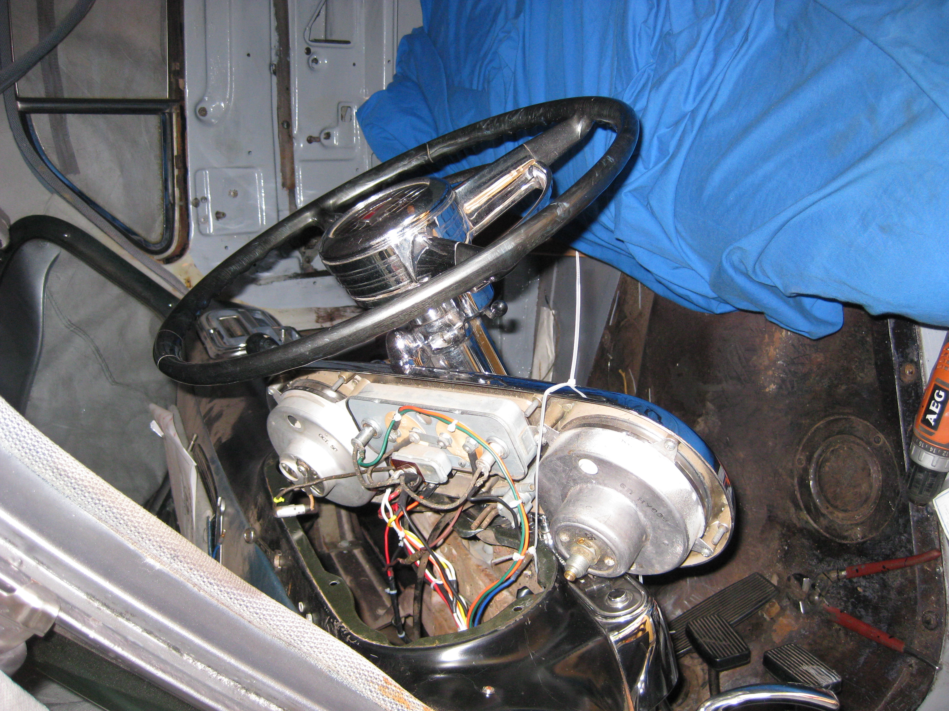

Any hints on how to remove the speedometer from a '51? The body manual says first to remove the whole instrument cluster, and I'm having some trouble with that. There's no diagram (in either the shop, parts, or body manuals) to show where the bolts are. I found some of them, but more experienced mechanics know how awkward it is to work under there, cluttered with wires and control cables as it is. If memory serves, I was more flexible 30 years ago, too...
There appear to be screws (I saw 2, but there's probably another one behind some wires) through tabs holding the speedo in place. Is it OK to just remove those, if I can reach them all, and remove the speedometer that way? With it out of the way I might also be able to remove the cluster.

As above i also remove the radio and a strong light pointed behind the dash will give you a better look at the Hex nuts . and disconnect the speedo cable from the speedometer head
Wow! Thanks for the photos, Ken and Lee. I've printed out Ken's with the five bolts identified. Lee, the radio has been gone for years (another round tuit project) so that's a nice access window. Ken, I have a knife switch on the positive (ground) terminal of the battery so that's not an issue... thanks for the warning, though!
I've not removed the radio, but removing the speaker gives you a pretty good look at the rear of the instrument cluster. But Ken's right . . . lie on your back on the floor. A nut driver will get at all the nuts.0
