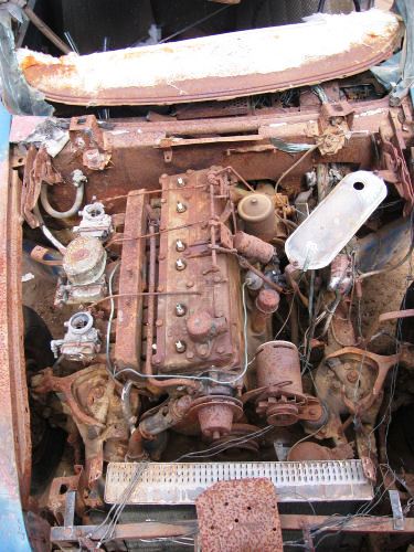

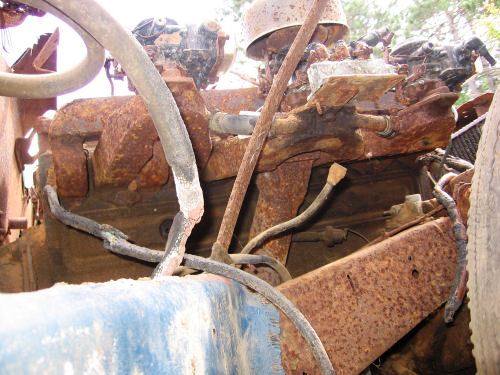

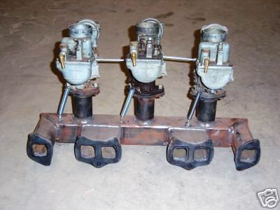

The following pictures are of a 56 or 57 Hudson cut down to run circle track, (at present can not find the pictures of the full car body) that has a 308 installed with a triple carb set up. Last is a picture of a manifold made from cut Hudson manifold and square tubing. Might be one of Chuck's "manufactured manifolds?
