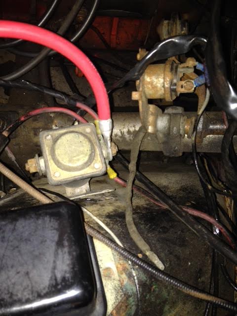

I'm guessing a fuse or the starter solenoid went bad. Here's a picture. Please notice that all the wires are attached to the one post.
Is there a reason for this? The car started fine for a while, but as I said... nothing happens when I turn on the key. Also, the lights do not work now.

But on the solenoid, why are all the cables attached to one post? Was the previous owner trying to bypass something or is this acceptable on a Jet?
According to the Jet wiring diagram http://home.comcast.net/~sarahdyoung/hudsonjetelectrical.html#hudsonjetwiringdiagram , the only wires coming into the solenoid are
1. the battery cable and wire to "B" on voltage regulator (both on one of the large solenoid terminals),
2. the wire from solenoid to terminal on starter (other large solenoid terminal),
3. and the wire to the starter switch (the small solenoid terminal).
No solenoid terminal should have more than two wires / cables attached.
If you have extra wires attached to the solenoid's "hot" terminal, my guess is that some previous owner needed power somewhere so simply tapped off that terminal (since it is connected through the battery cable to the battery). You might try tracing those extra wires to see where they go. If detach them, something (probably an accessory) won't work!

Hi
Your picture appears
to only have a red wire attached to one of the terminals on the starter
solenoid .the other terminal looks as if there is no wire from the starter ,this
is odd because as you have
said it tried to start once!Questions
