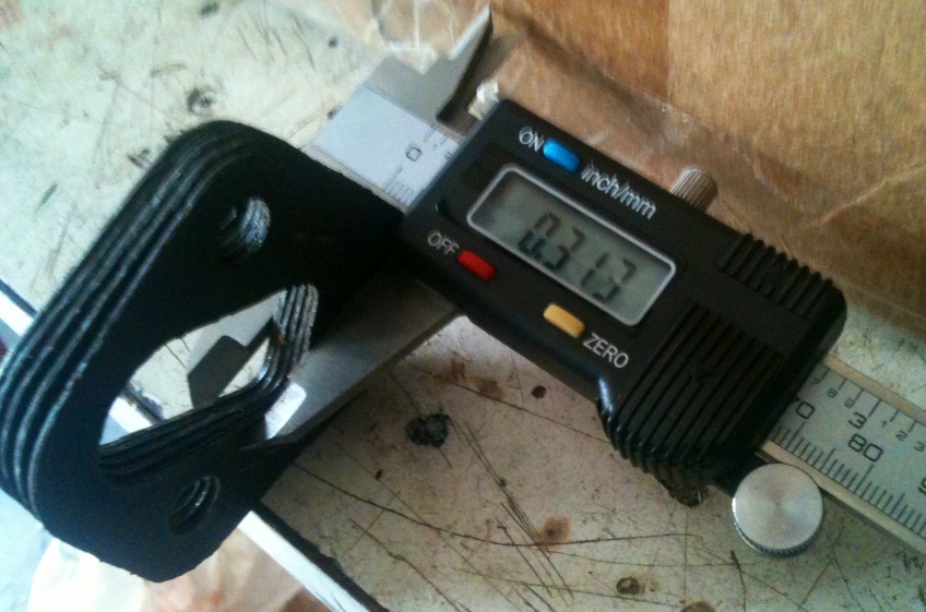

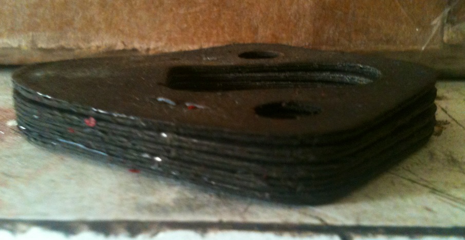

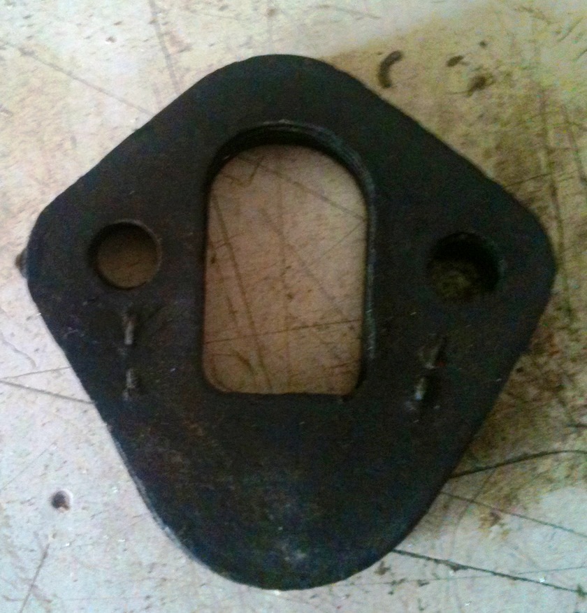

The attached pictures are of a NEW spacer stack for a double action fuel pump used on 232/262/308 engines. The thickness of the stack can be read on the digital caliper gauge.
