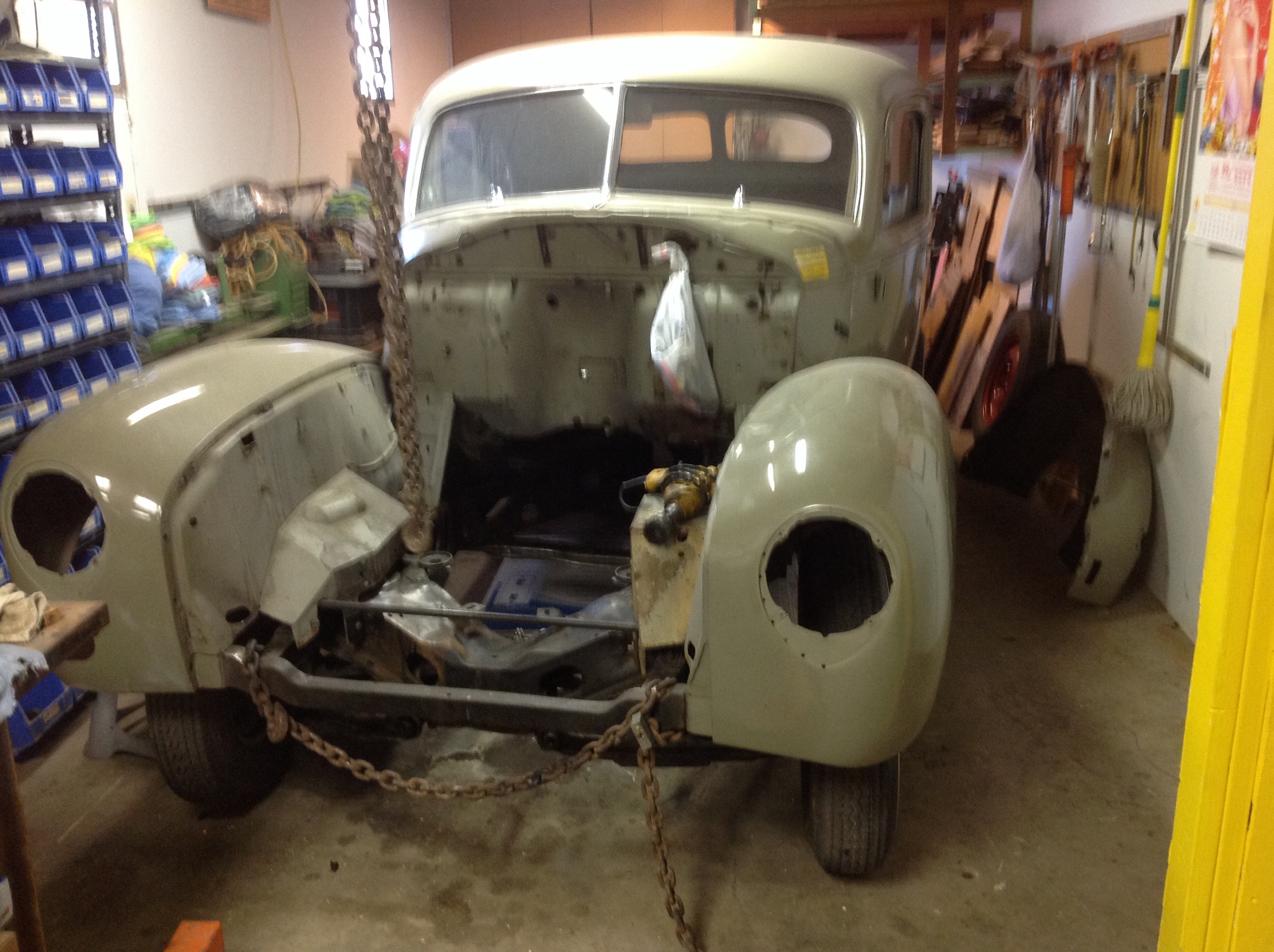

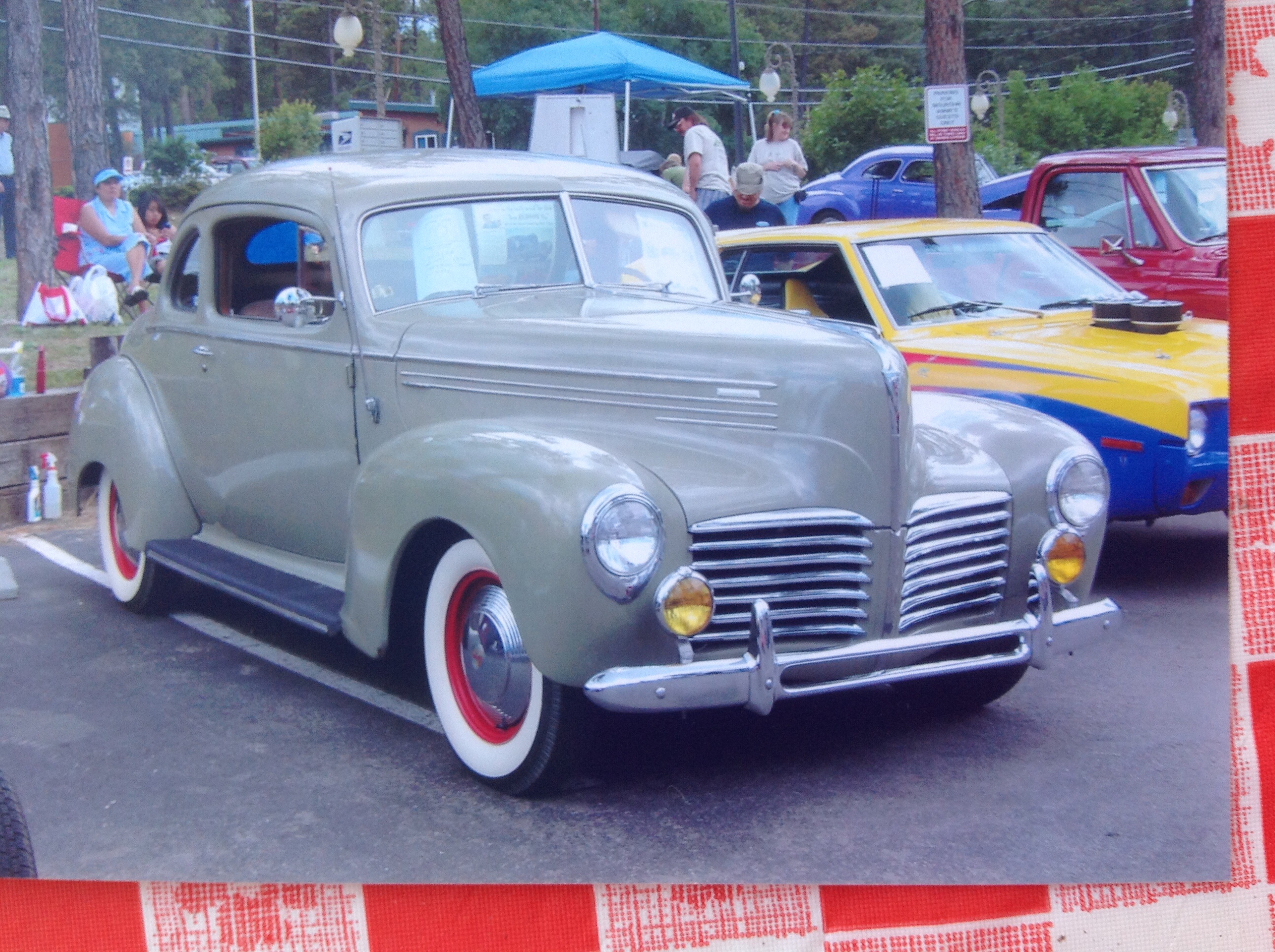

Attached are a couple pics. One from last year and one from the present. When I put it back together the body will be painted a California cream, which is a 40 Hudson color.
It is listed as a 1940 Hudson six deluxe Victoria coupe0 -
