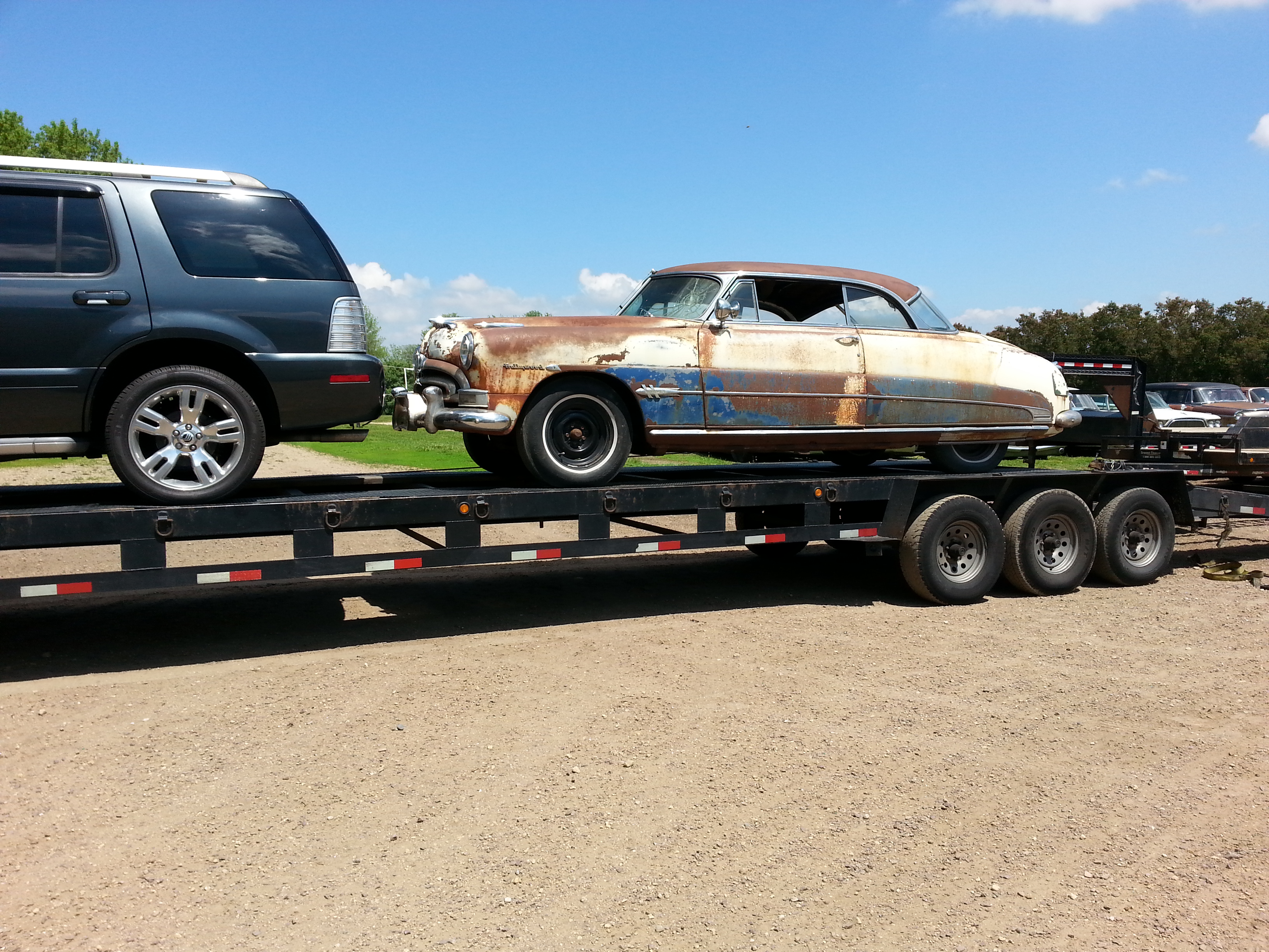

I first found out about the hudson hornet
through me and my wife's love of racing. We saw one for the first time
down in the museam at the Darlington Raceway. Well one thing led to
another and eventually I bought a 1951 Hornet Hollywood hardtop I found
for sale online. Its going to need a total restore and I am looking
forward to getting any advice and help that I can to get it back on the
road.

That car looks very familiar. Where did you get it?0

The parameter on the hornet is in pretty good shape, there isn't any serious rust through anywhere that I've found yet, there are a few pin holes in the rocker panel and the sill plates will need to be replaced, the bottom of the doors, fenders and trunk are all in really good shape.
The most serious issue the car has is the drivers floorboard, which the center transmission tunnel seems to have problems.
I found this car on Teds Tuna boats online, so you've may had seen it there.
lance Walker is right down the road from you near Concord.0
Regarding rust, just be sure to get on your back and thoroughly examine the perimeter frame in the vicinity of the wheel wells. If there are any rust issues on a Hudson, this is where they will manifest themselves. If you find any problems it's not the end of the world, but you will need to go in there and reinforce the area. (Fortunately, the quarter panels are removable and they exposes the entire area of the frame, so access is not an issue.) All Hudsons are not fated to eventually have rusty frames, but IF a Hudson has led a hard life, this is where it rusts. Once you fix it, it won't come back (providing you don't drive on salty roads, and leave your Hudson outside all year in the mud).
(Floorboard rust is a minor problem, people are making replacement panels that can be made to fit, if they don't already.)
Just wanted to warn you of this potential problem so you can go into this restoration with your eyes open!

My serial number is 120073, I got to look at the parameter frame around the rear wheel wells, they look in really good shape, I couldn't find any rust issues on it. The car originally came from Oklahoma and I have the title that was issued in 1958.
I've already joined the HET club, just haven't gotten around to introducing myself on that forum yet. It looks like a great club.
I want to fully restore this car, so the first step will be to take it apart and stop what rust is there, Is there any suggestions on what isn't worth takeing apart of taking off the car? Also, what are the best lift points for a car like this? Can I just lift it from the parameter frame?
120073 - Late production run - August 1951 (119453-122517). They were intro'd late in the 1951 season, as was mentioned in a previous post. In total there were 3,065 units produced in August 1951.
I made an error in my previous post - should have said Hollywoods in '51 took up approx 10% of total 1951 production, not just Hornet.
Be very careful and patient if you remove any of the body trim. Hudson used full length clips that the trim pops on and over the years it gets rusty and makes removing the trim without bending it difficult.
Wildricks sells stainless clip lengths to replace the original. I've had some on order for a few months so can't report how well it fits.
Here is a former post on trim removal-
http://openforum.hetclub.org/discussion/165739/chrome-trim-removal-help-54-jet/p1
Anyone know what became of this poster or the car?0
I just talked to the poster. He still has the car--it is not for sale. He has yet to build a garage to work on it in. He basically has done nothing to the car. The car is sitting outside; said it was sitting outside since 1963 before he bought it--has that tag on it. Anyway, asked him to let me know if he wants to sell the car sometime in the future; I am NOT interested--too old, but will let the club know. Anyway, he and it exists.0
