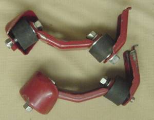

Check with Wildrick Restorations - they have them in stock

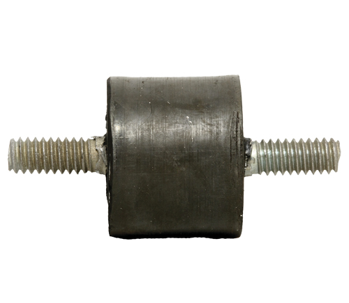

As a temporary or permanent fix, the original rubber mount can be replaced with a set of Stabilizer bushings the are equivalent to the uncompressed thickness of each bearing rubber mount. To use these bushings a piece of all thread the same diameter as the original bushing shaft is cut to match the length of the original bushing shafts. The bushings are placed onto the all thread with stabilizer caps on each end. Install a nut one each end and tighten until you just get compression on the bushings. Place the bushings back into the metal carrier mount using lock washers and a nut tighten each end. The beauty of this arrangement is that the center bushings will not tear out again even if the rubber fails completely.0
