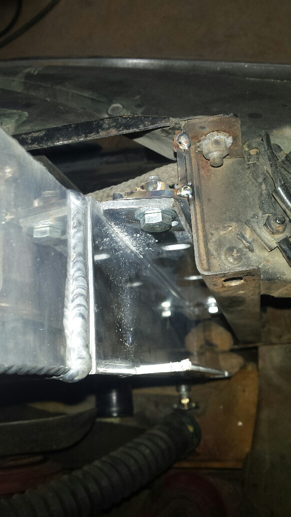

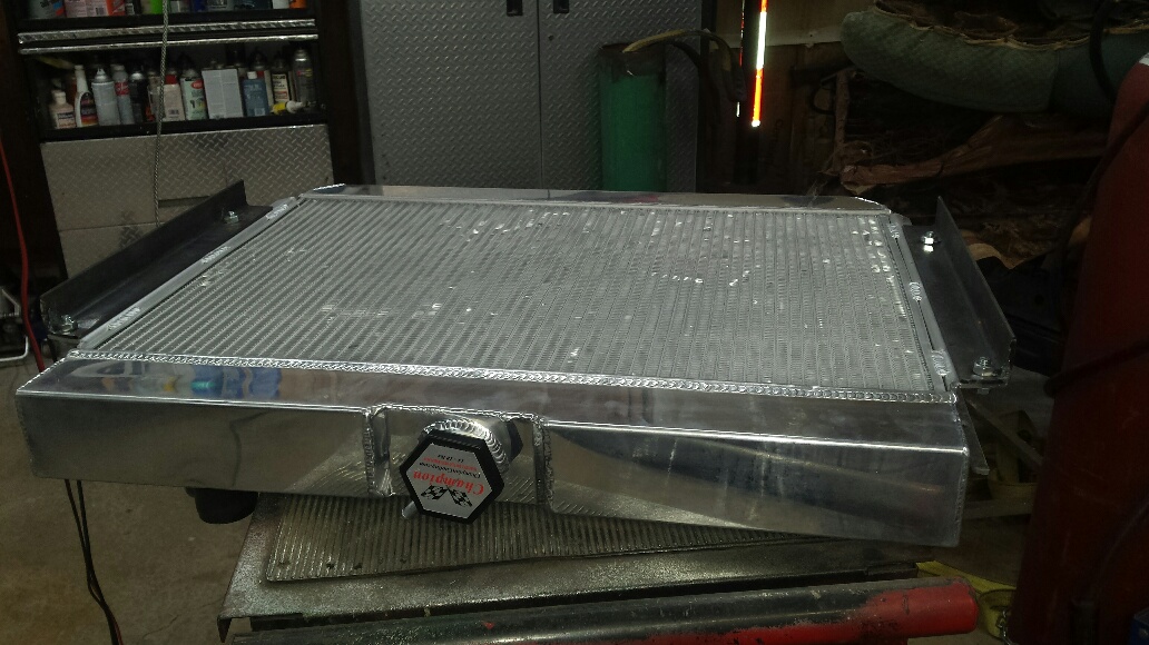

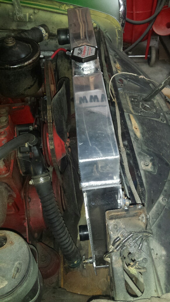

So I solved my issue with the radiator. I did a bunch of research. I found out a 66 Chevelle radiator core and mounting brackets fit. Minor modifications needed such as; remove the 4 mounting tabs to line up with the Chevelle radiator holes, Mount tabs to radiator, install radiator to the position you want, and then weld brackets to core support. Plus you will want to weld nuts to the back side of the tabs, so you can bolt and un bolt the radiator at will. Took me approximately 1 hour. I will be posting some pics soon. This radiator mod cost about $200 dollars for the radiator. Hope this helps0
Is that a 3-core or a 4-core? Is the cooling fin area the same sf as a stock radiator? Is it aluminum or brass?0
Its a 3 row aluminum with .75 inch rows. It is for a big block V8. the core dimensions are very close to the original hudson.0
I will get pics up by tomorrow0
Look forward to the pics!0
Looking down at the bracket to the core support. More pics to come, I was side tracked by cleaning the engine bay.0
