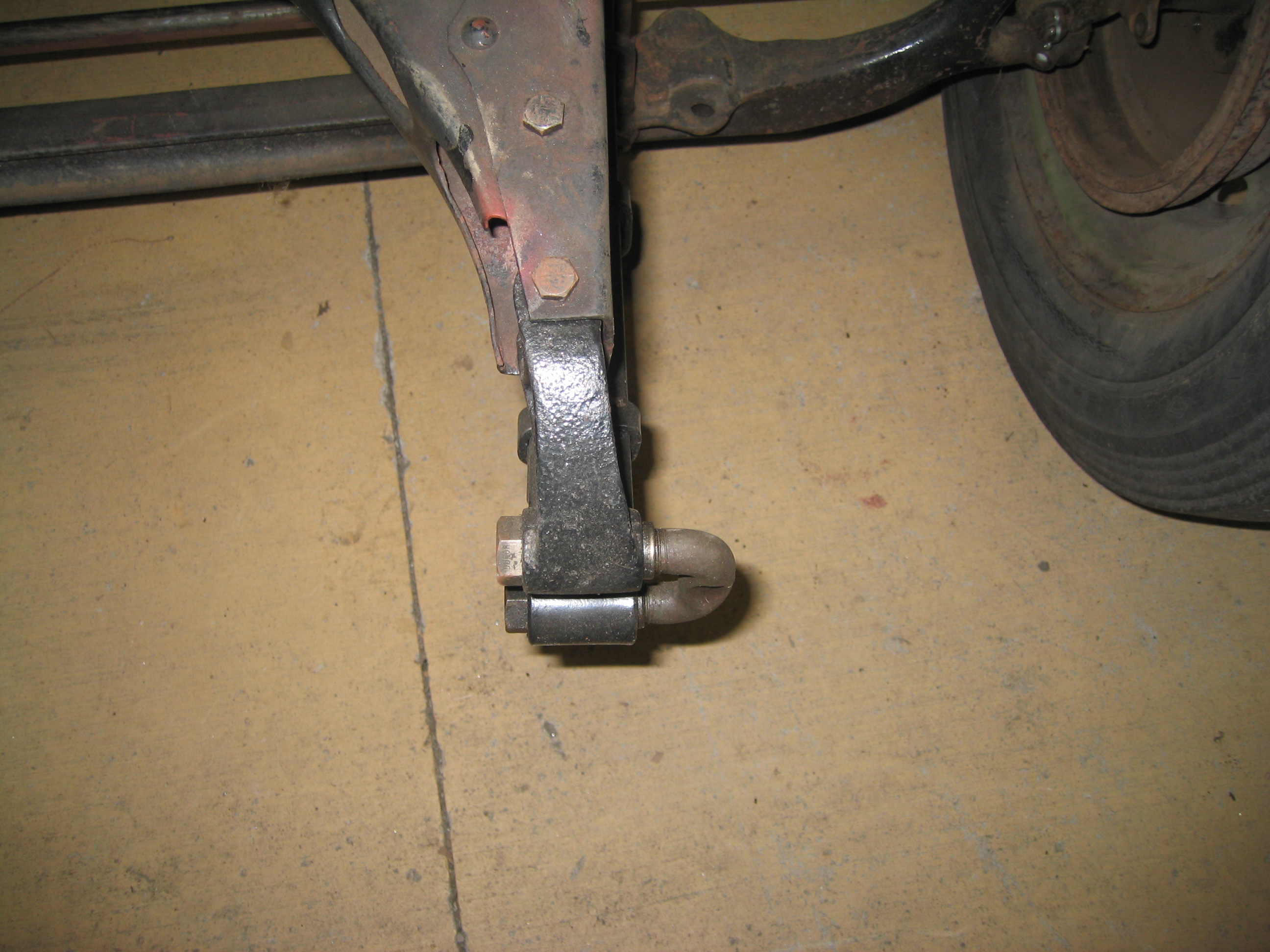

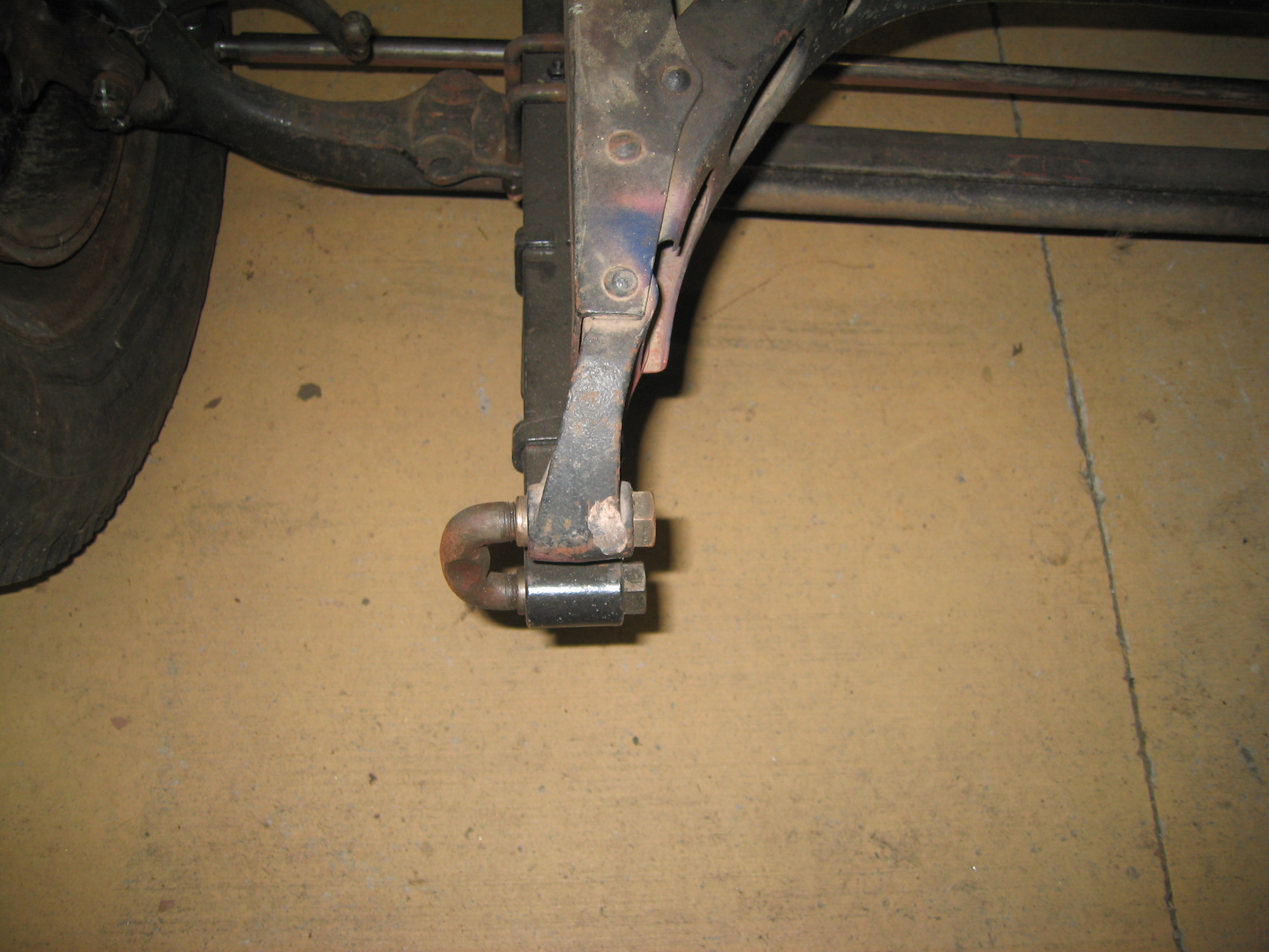

The spring hangers on the front of my 35 H8 project 117" WB have 2 different offsets. Bummer. The RH spring hanger is an original and the LH hanger is a bolted in replacement.
Offsets measured from the outside face of the rail are 3/4" and 5/16" respectively, presumably the bolted in hanger is from the shorter wheel base Terraplane.
Anyone have a dead chassis they can cut a spring hanger from and mail to me? Its not impossible to make a LH hanger with the correct offset, but buying one is easier. PM me here or email bobwardDOTlaidleyATgmailDOTcom
