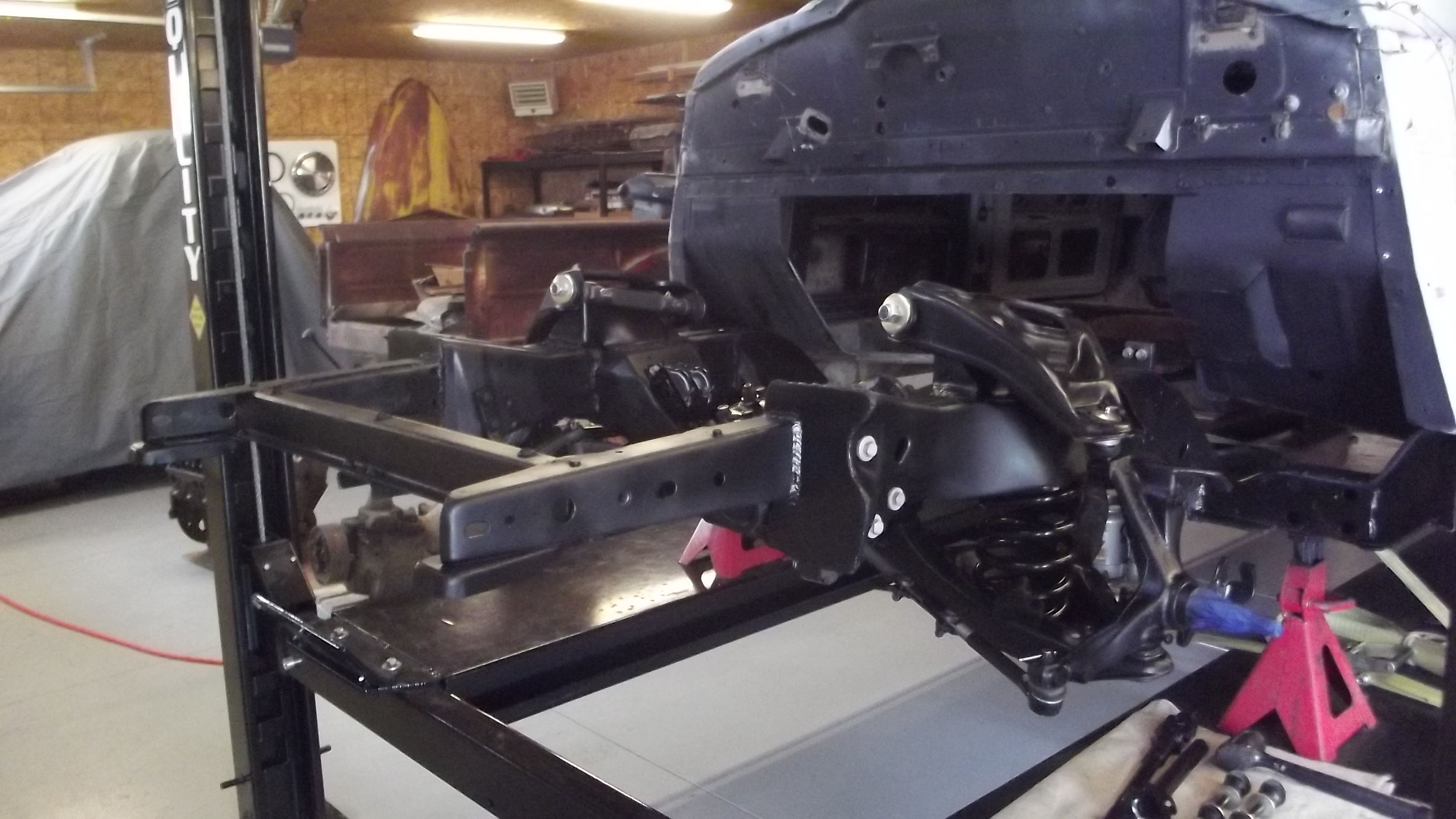

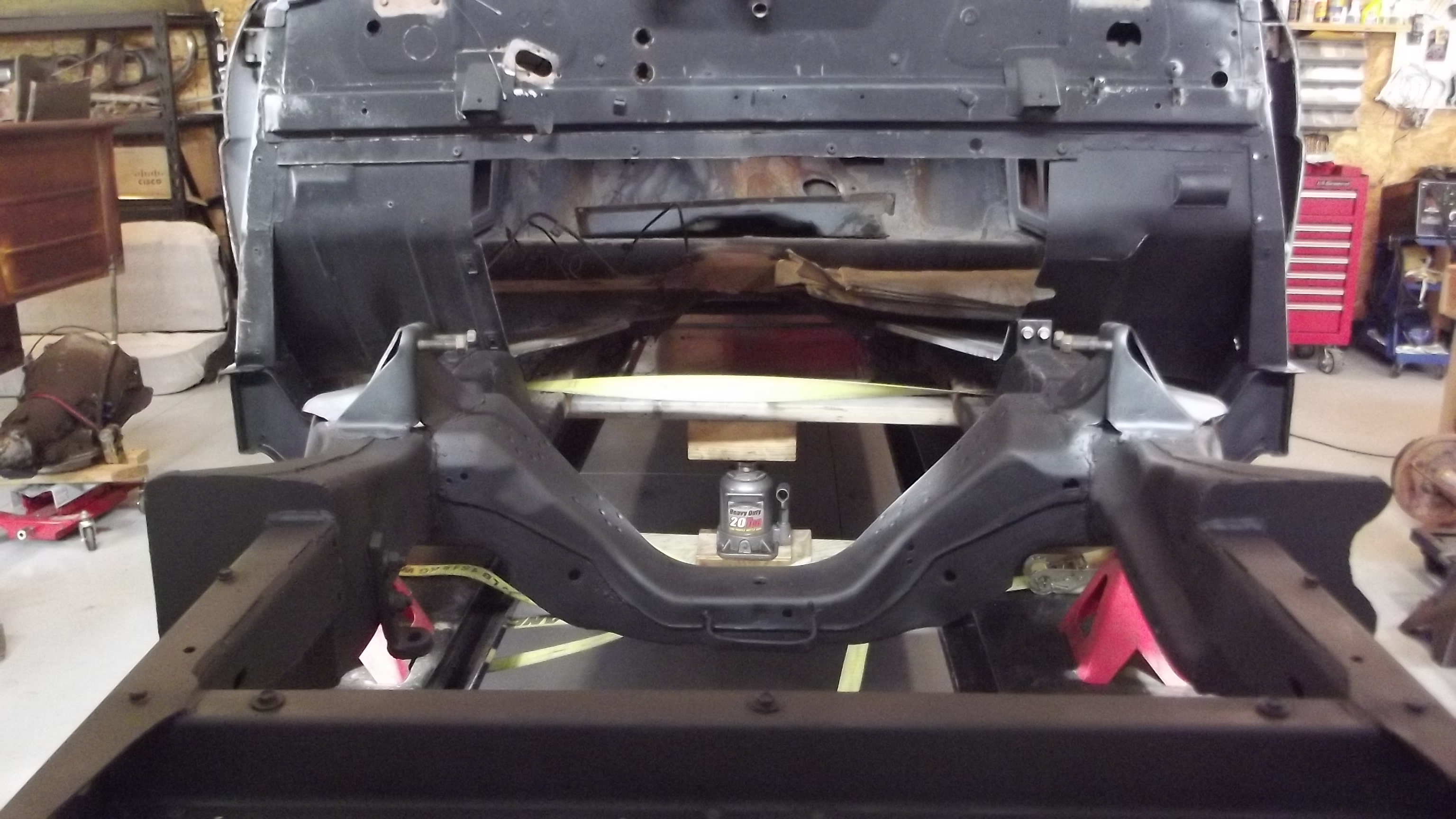

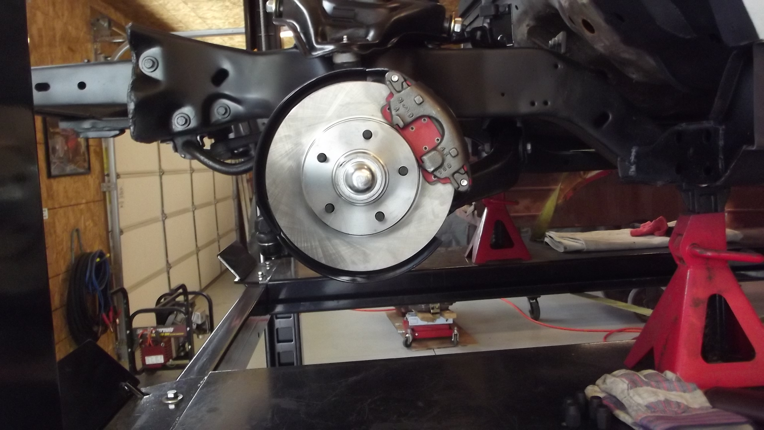

Here's a cronicle of my '49 super six fatman install.....
http://openforum.hetclub.org/discussion/114985/new-front-stub-frame-in-my-49-brougham/p1
after a long interruption with a '52 airstream rebuild, I'm about ready to get back on my hudson!!
Good luck!
Lee
Very nice detailing each step of the Front Suspension Update for others that may consider do an upgrade to modern componets..
