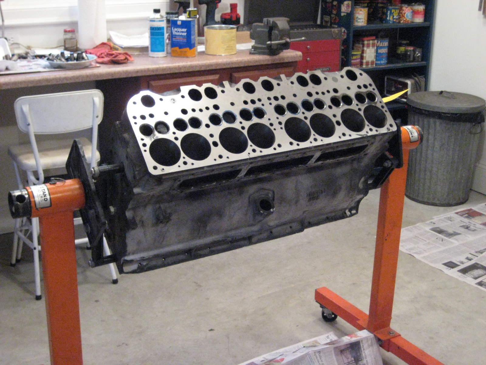

I did the "use two, face to face" approach. At the stage where I need access to the ends of the engine, I remove the "rotary risers" and install other support brackets..0

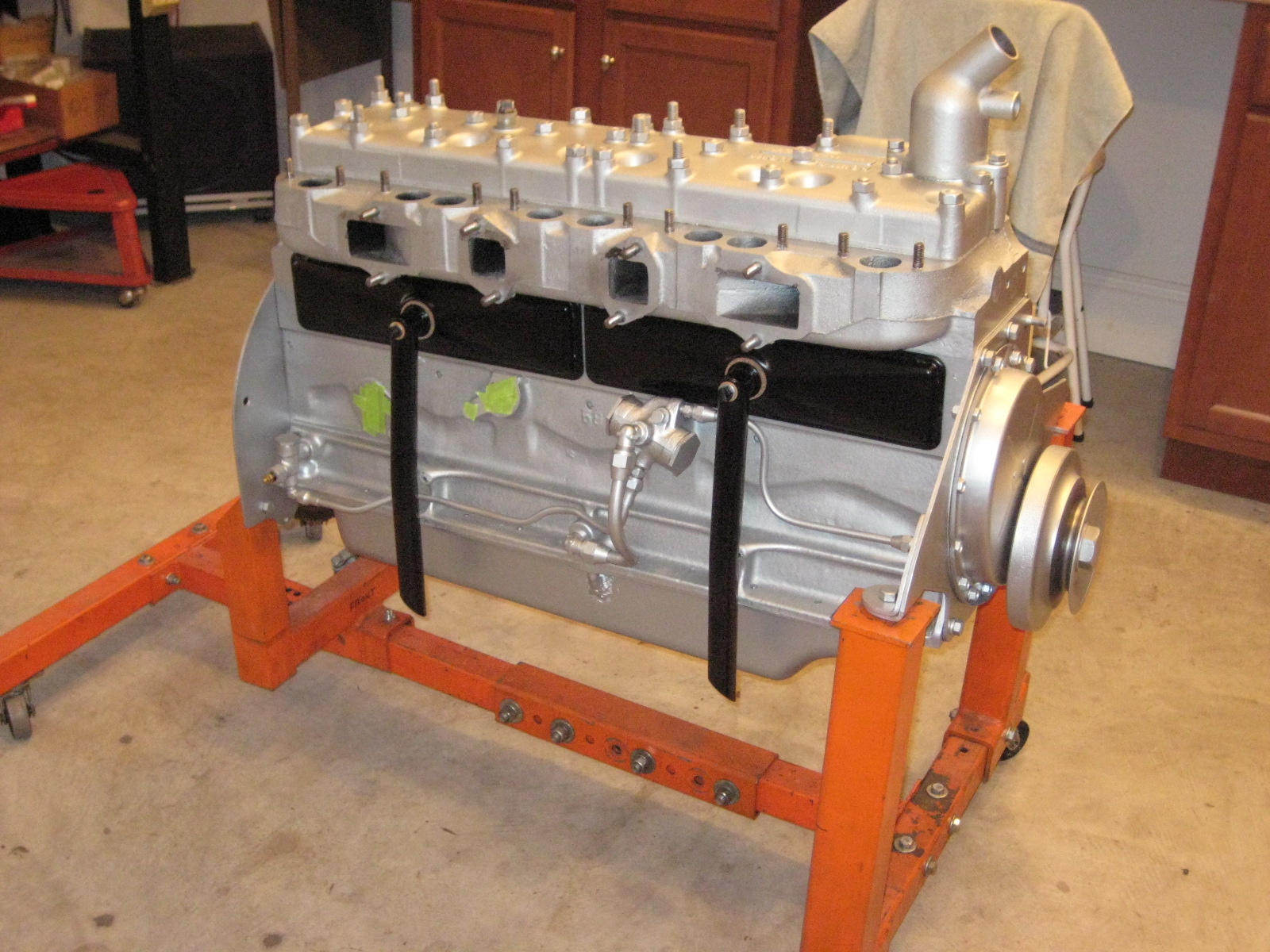

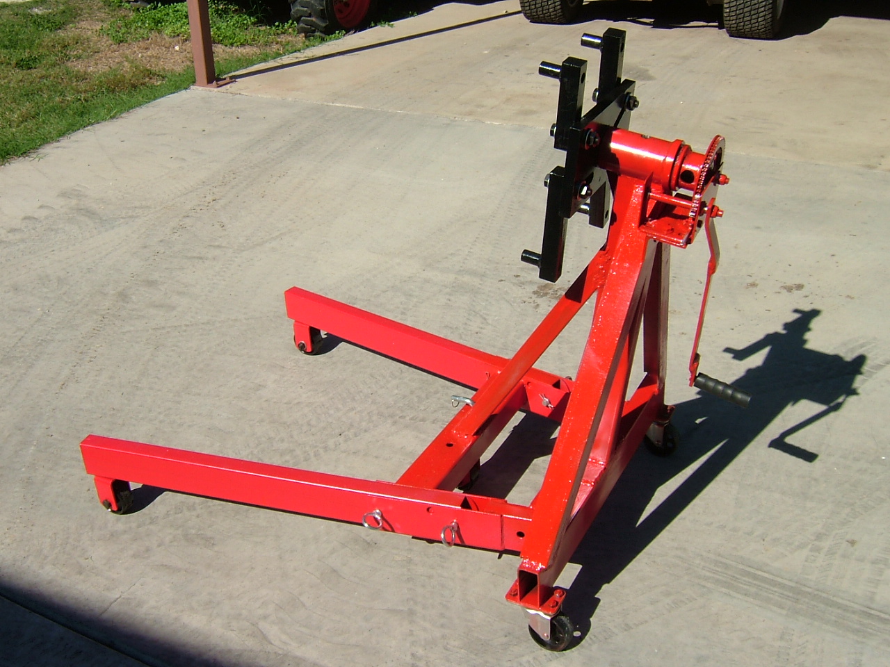

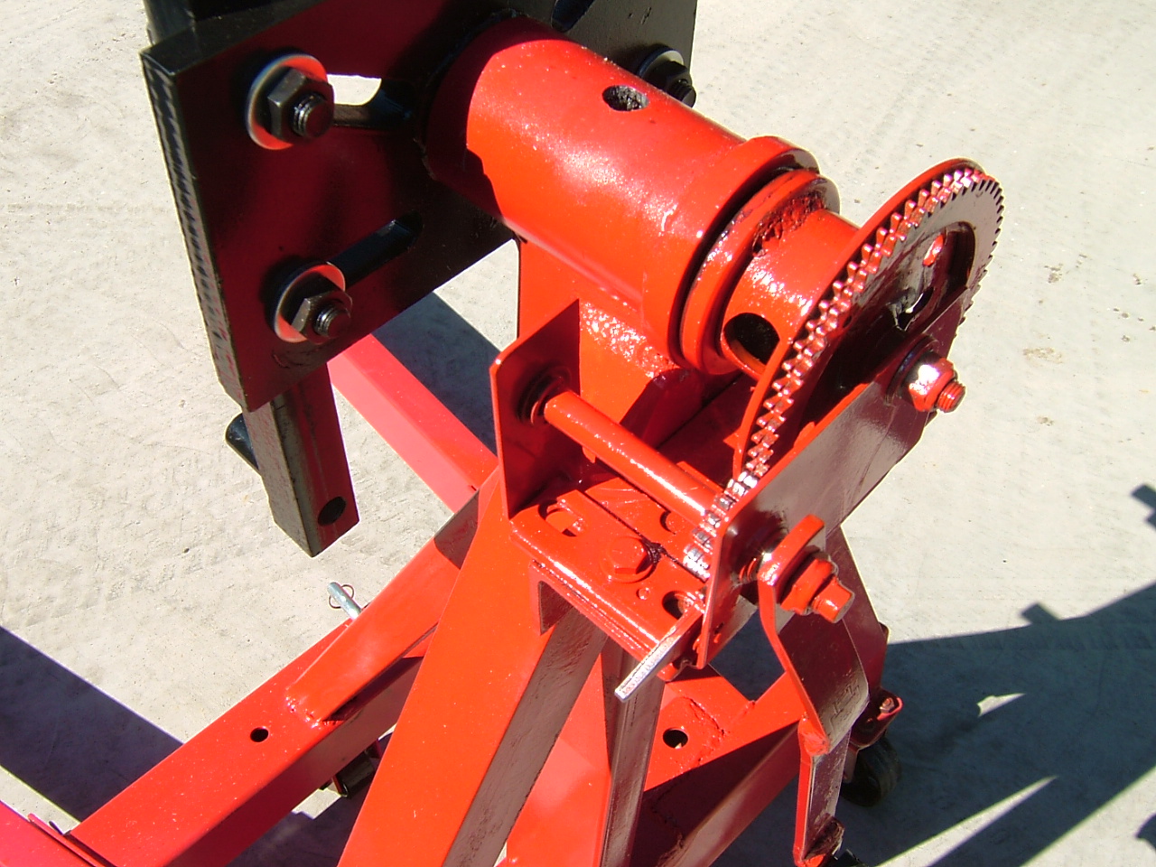

Keith there are obviously many different methods and preferences and opinions on what is or is not the ideal stand. For me I have an old four wheel stand as well as a four wheel engine run. Both have been used for Hudson and other engine builds and post build run in. The following is a stand that one of the members or our chapter put together ... it handles a Hudson Big Six very wellComments about the stand from the builder...Attached are pictures of my
new Hudson engine stand. I started with a Harbor freight 2000 lb stand which is
a joke. I moved the post back , welded in a piece of angle , added a square
tube brace up front and angle iron from the post down to the rear legs. I
adapted a winch that gives me a 4 to one reduction and lengthened the handle so
you can roll the engine safely. The other stand that i built is like this
without the winch. It supports the engine very solid even with all the stuff on
the engine. The new stand has folding legs so it will take up less space to
store. I used a 25% off coupon and it was already on sale for $129.
I have a bunch of lighter stands but even Studebaker V/8 engines get pretty
heavy with everything on them and the stands feel overloaded. The Hudson engine is so
long and heavy you need a stout stand0 -

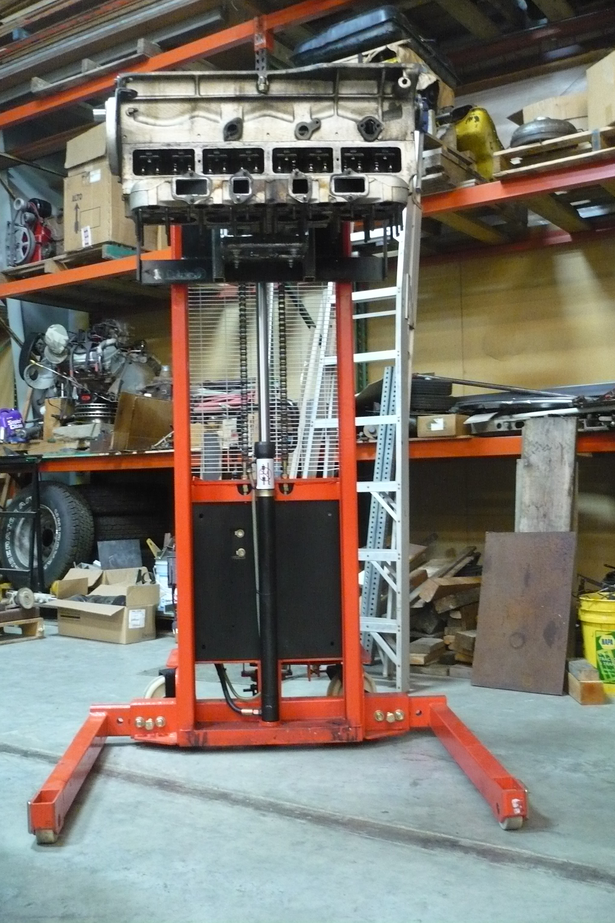

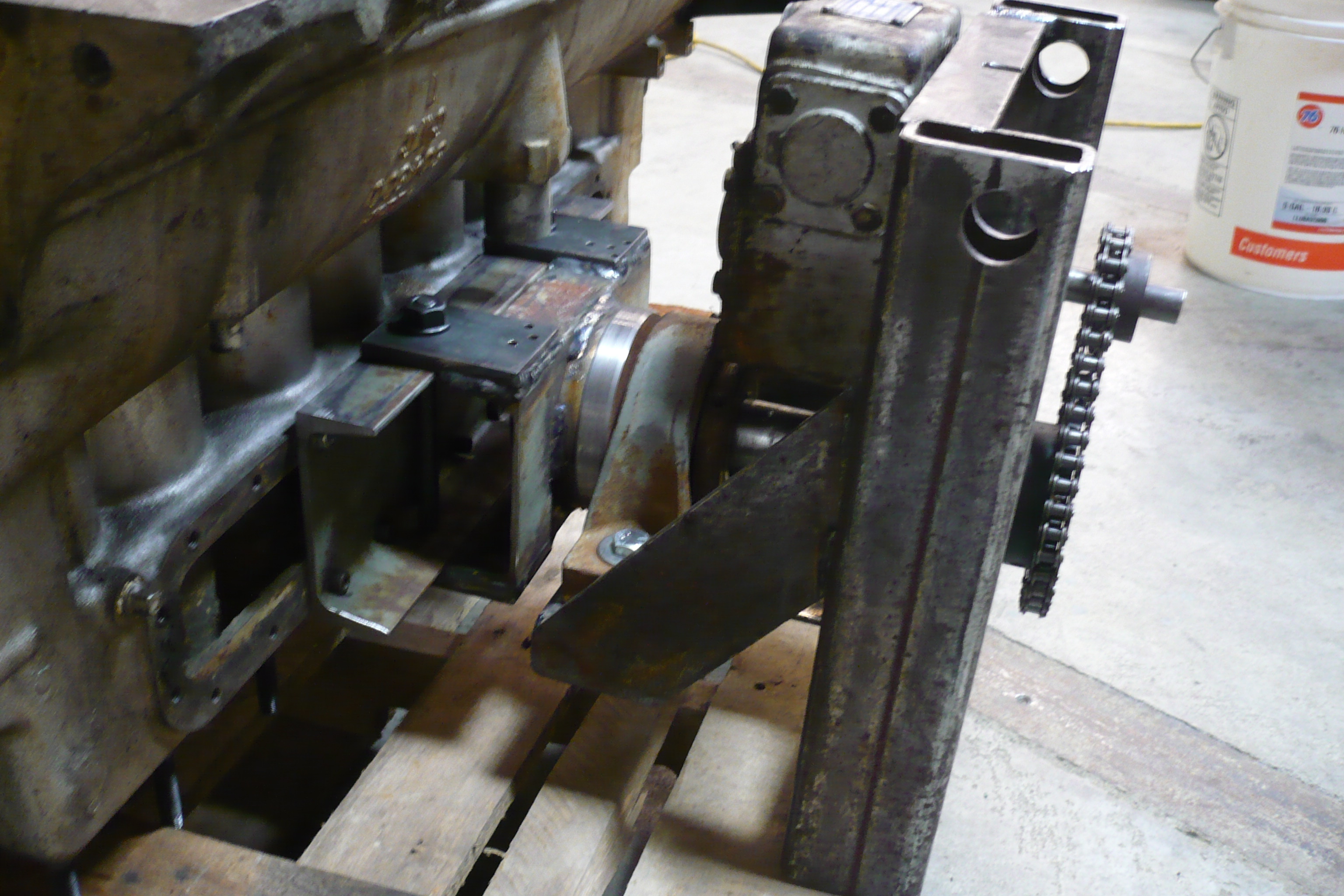

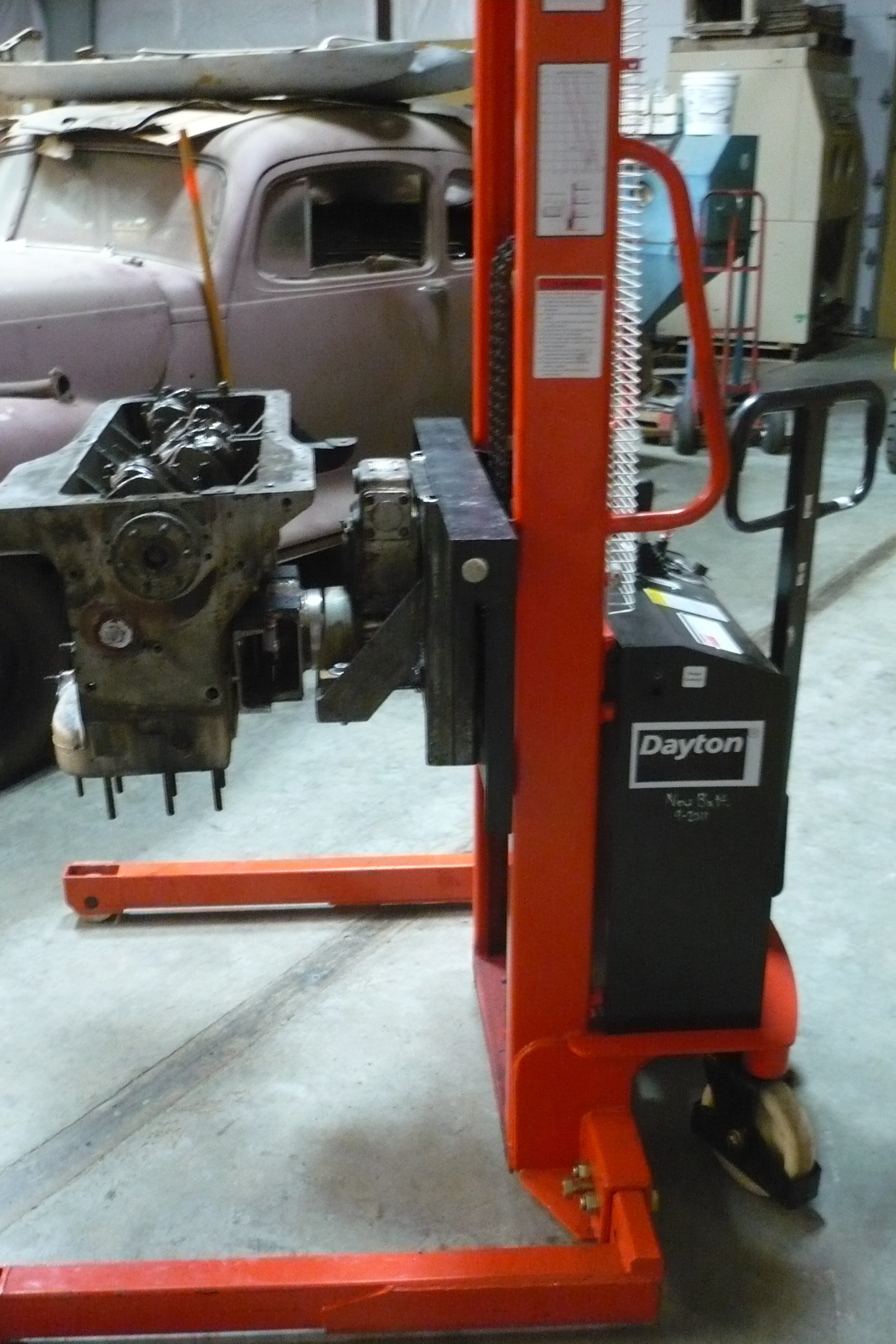

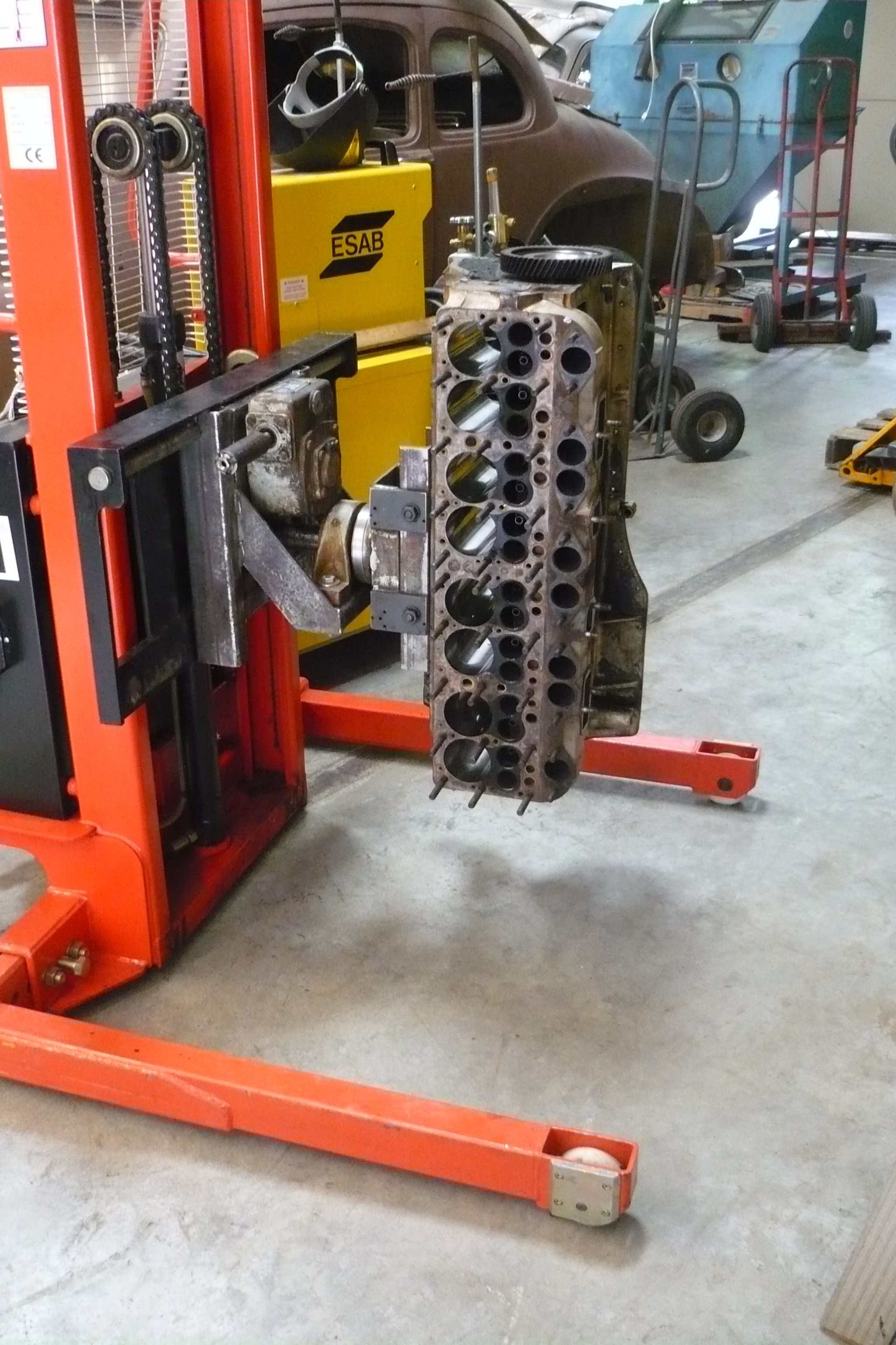

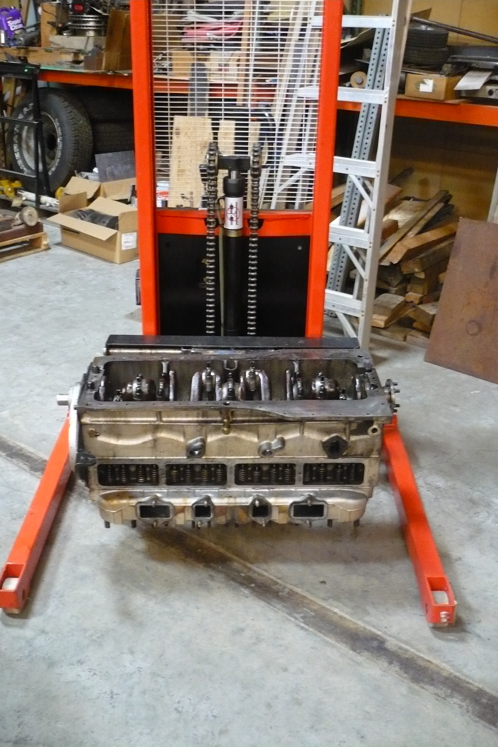

Although not very practical for the average guy, I have made an attachment for my small electric fork lift that attaches to the water manifold bolt holes on the splasher sixes and eights or the distributor side of the 202s and big sixes. Granted, it doesn't allow access to anything on those sides but there isn't really anything I need to get to anyway that can't wait 'til it's dis-mounted.
The worm-gear drive allows continuous rotation in either direction with a cordless drill. My back loves it.
Shown in photos with a '51 8 mounted on it.0 -
Frank, what is the gear reducer ratio?0
My concern about holding up the engines was as much about the the cantilever pressures on the bolts and the end of the engine casting. It looks like a LOT of weight against just the four bolts on the end!Pictures tell the story though, and I guess I can quit worrying. I have a very beefed up rotisserie stand built in the same style as Old Farmer's and Twin H's that will hold up the engine if the bolt connection is satisfactory. Thanks for the pictures...keith0
I'm with you, Keith. Pains me to think of the stress on those two upper bolts.0
