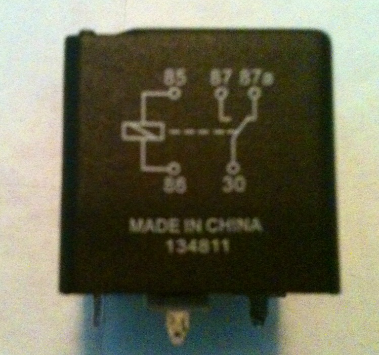

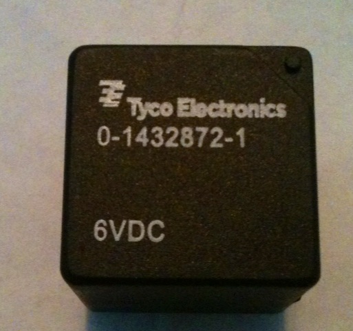

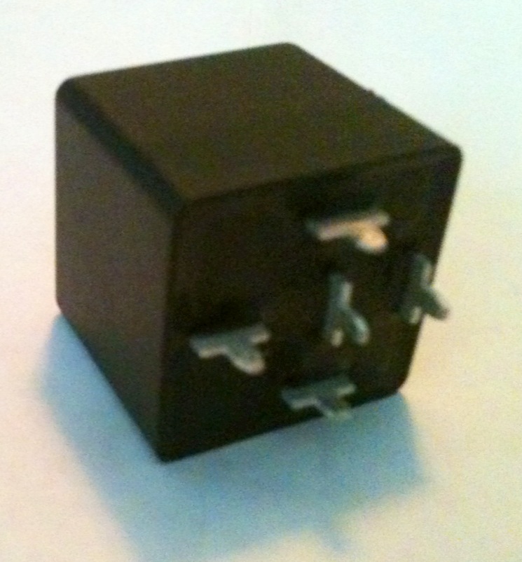

You have the option of using new manufacture 6 Volt DC relays when working with the HUDSON 6 volt positive ground electrical systems.I recently began the complete rewire of a 6 volt positive ground 54 Hudson using an alternator and modern wiring harness which includes a fuse block. To effectively use the maximum amount of current when interfacing the available 6 volts to each accessory I use relays and reset able circuit breakers on high current circuits.Six (6) volt relays are not usually stocked at your local auto parts store. But, you can order them from electrical suppliers. To this end the following pictures and contact information are provided to show you the relays I purchased to complete my project. I ordered my relays from NEWARK an electrical supply house that can be reached via telephone at: 800-463-9275 or on the INTERNET at www.newark.com . The relays are designed to be mounted on a circuit board, but you can easily solder individual wiring to the relay covering each connection with a shrink tube to create a neat and secured relay harness. Secure the relay harness with a Zip Tye.0
