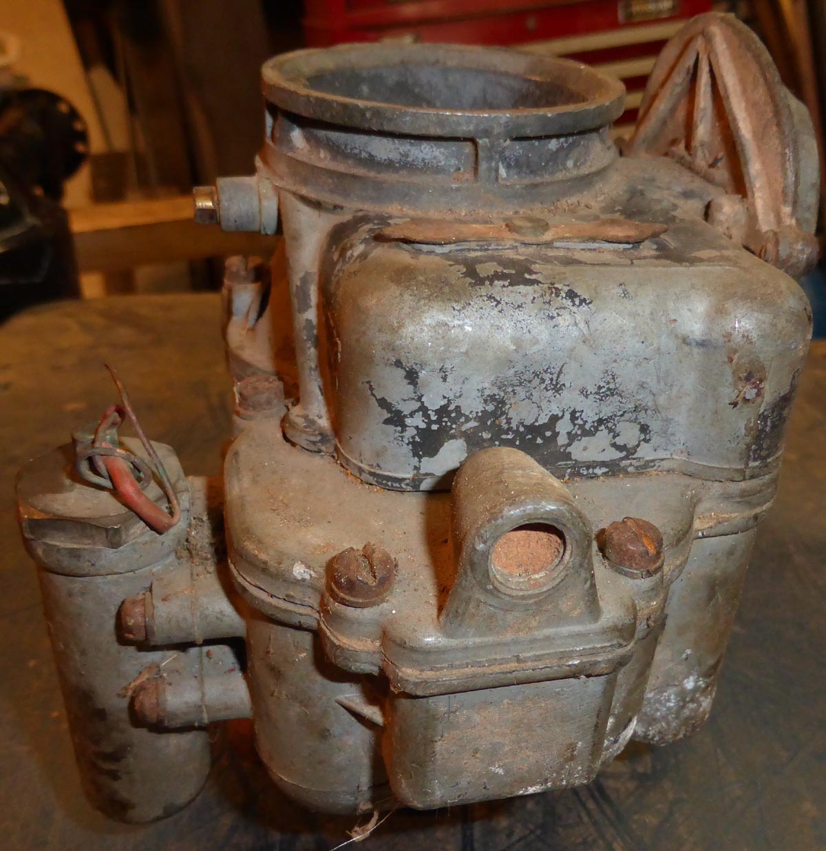

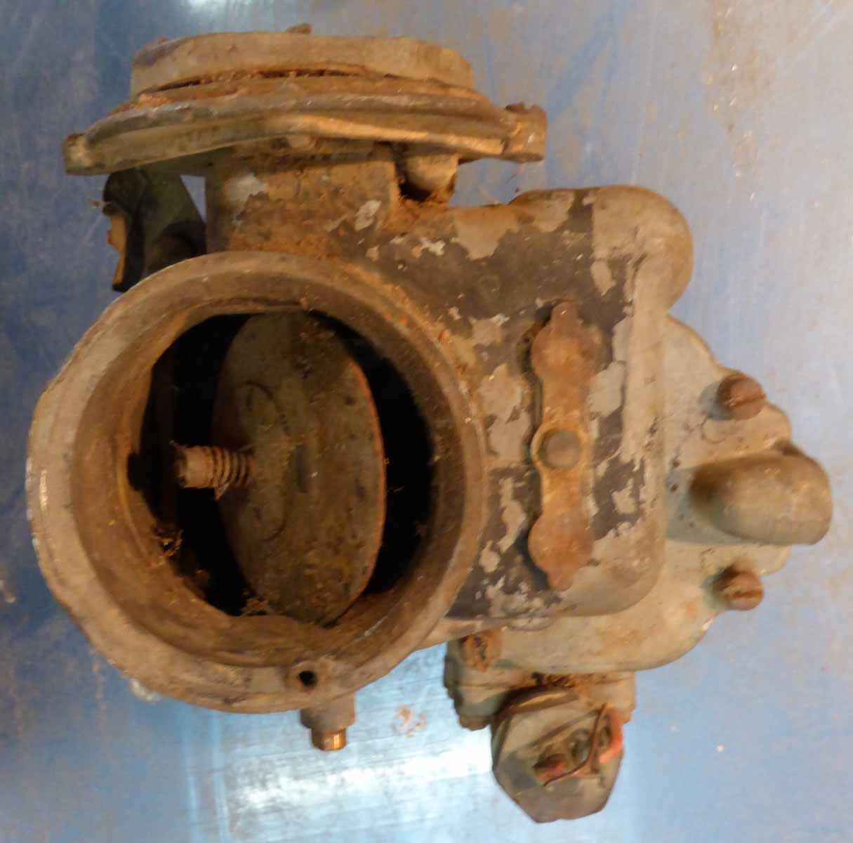

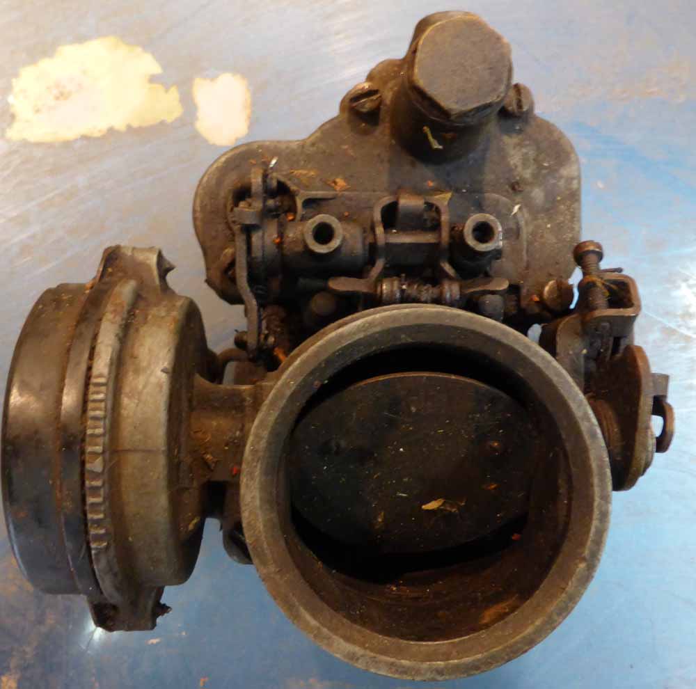

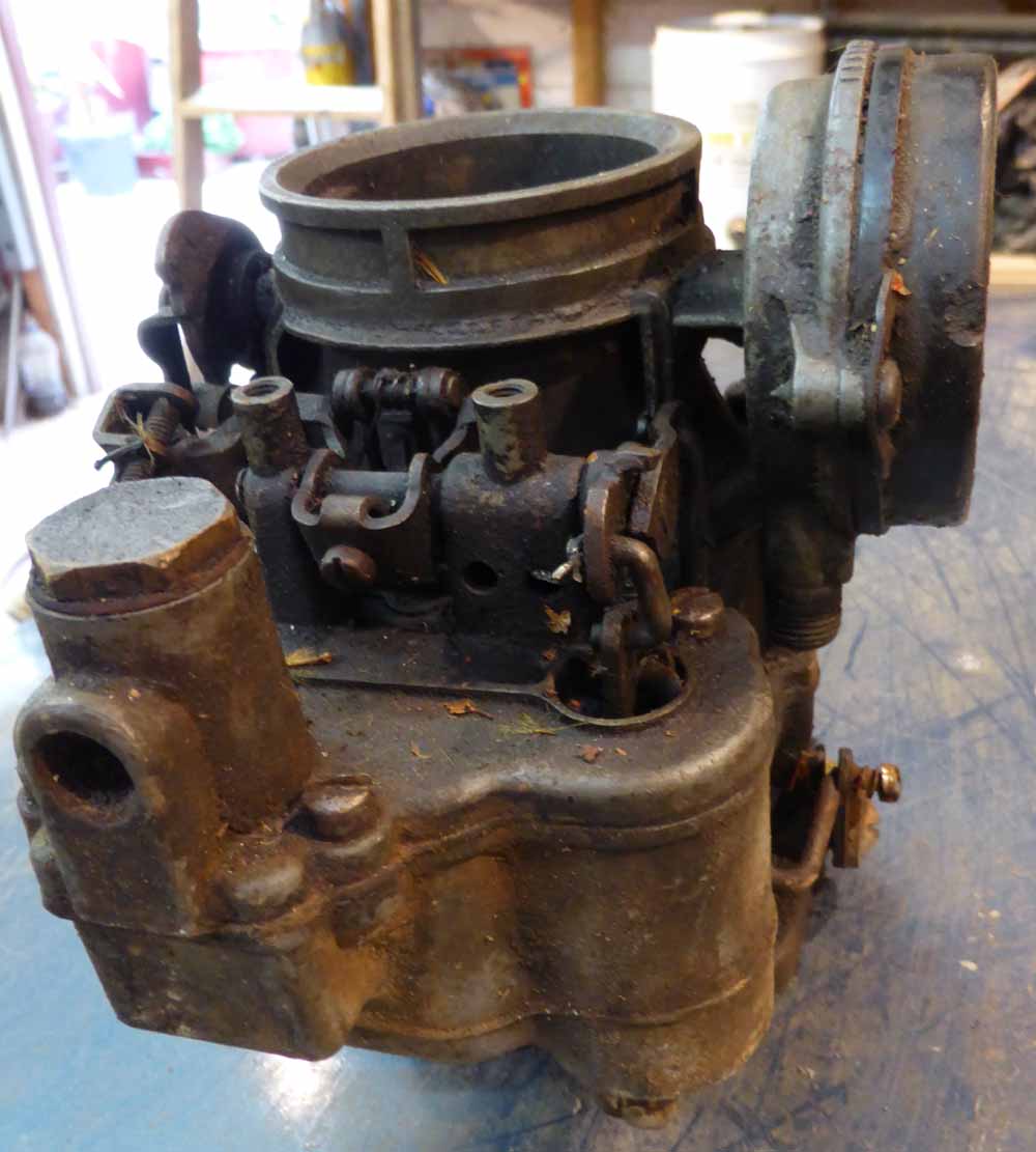

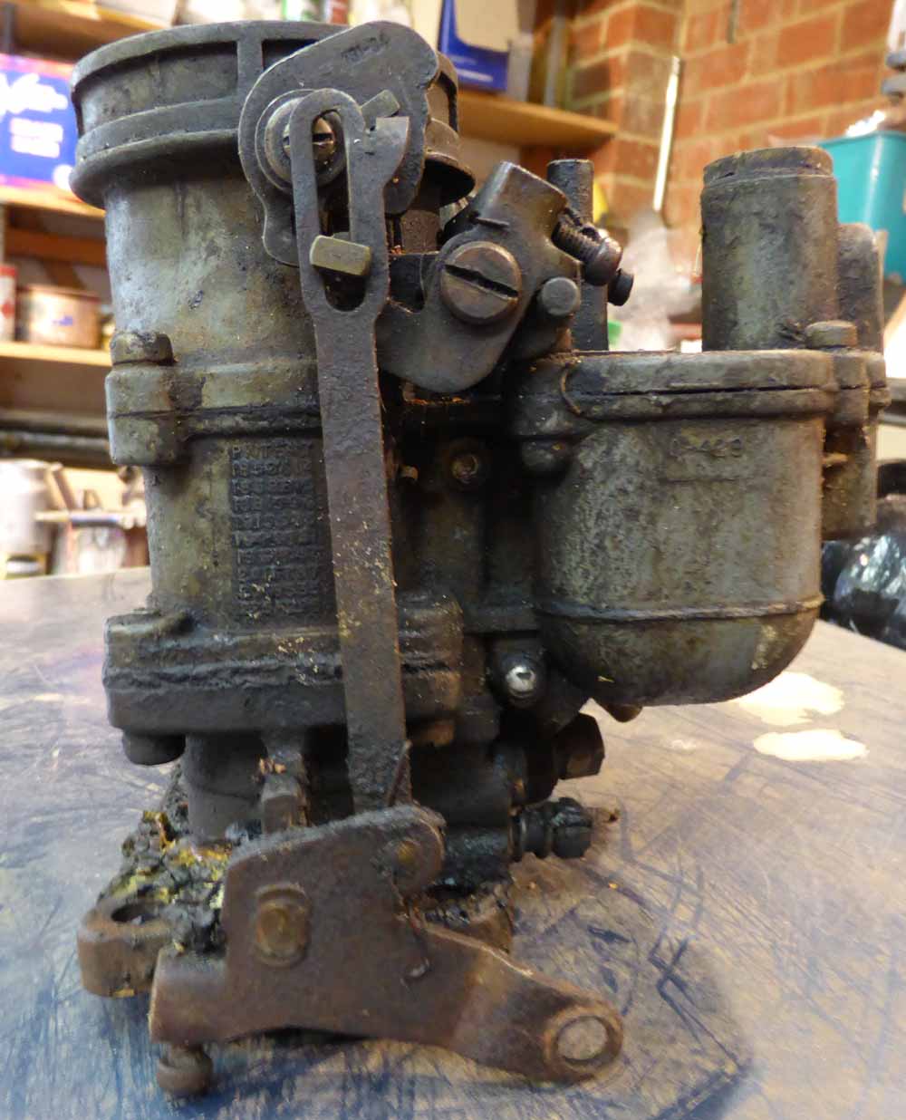

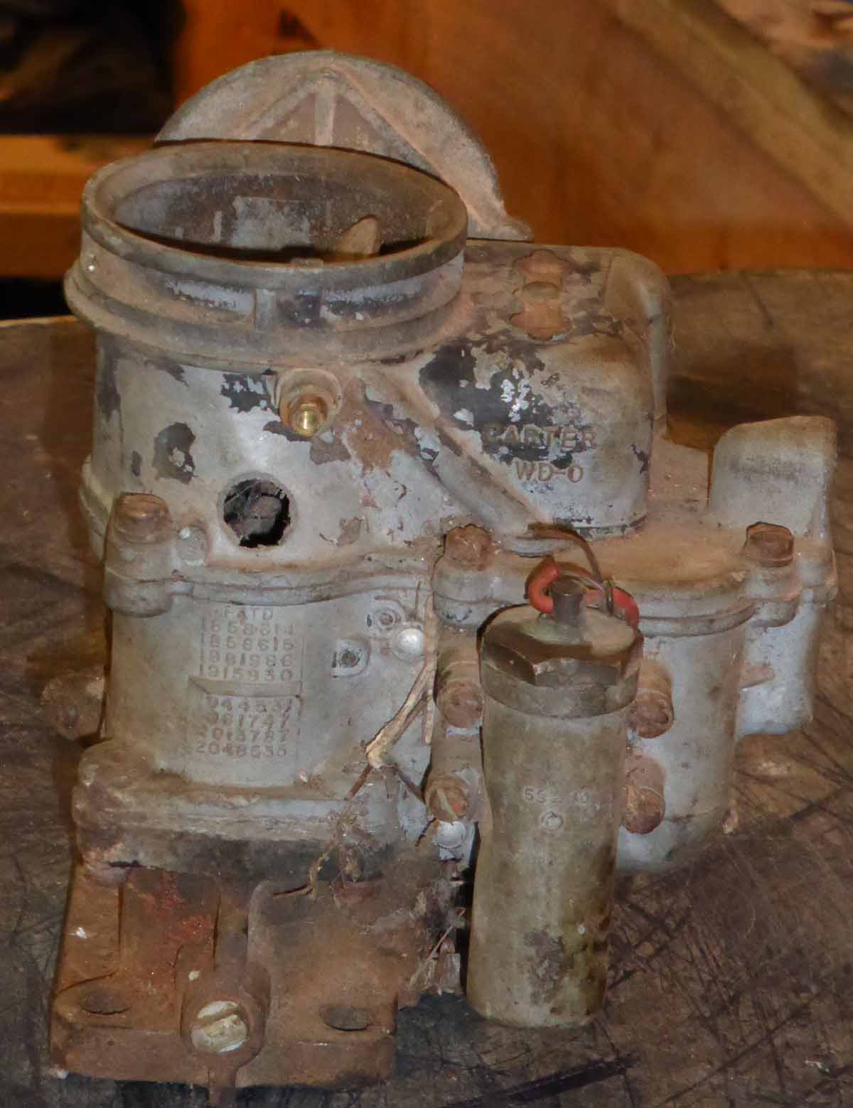

I am confused as to how many types of Carter WD 's there are
Seemingly endless variants
I attach photo's of two I have
The oily one has a base too large for the 8cyl manifold
The rather rusty one fits well and I have another unit which is not damaged and will use. I am missing all linkages though and would appreciate pics etc of linkages for this type of carby

There were many different Carter carbs made in the 30s. Basically every car maker that use Carter used a different linkage set up, then every time there was a change in jets or metering rods there was a different Carter number. I have a 37 8 that looks similar, it is a Carter 344 (they also used a 377), but the linkage is slightly different. Also as you found out the later manifolds have a large bolt pattern.
It is important that the metering rods and jets match you application or it will never run right and you will not be happy. So knowing the engine and manifold is just as important as the carb number.

HUDSON USED CARTER CARBS IN THE 30'S - 37 TO 41 WERE WDO'S HERE ARE SOME OF THE NUMBERS 344S, 377S, 402S, 430S, 455S, 461S, THESE NUMBERS WILL BE ON THE BRASS TAG ON THE CARB AND SOME WERE STAMPED ON THE BASE WHERE THE MOUNTING GASKET ISTHESE ARE A SMALL BASE 2 BARREL CARBCARTER DID MAKE A LARGE BASE WDO BUT HUDSON DID NOT USE IT IN THE 30'S0
