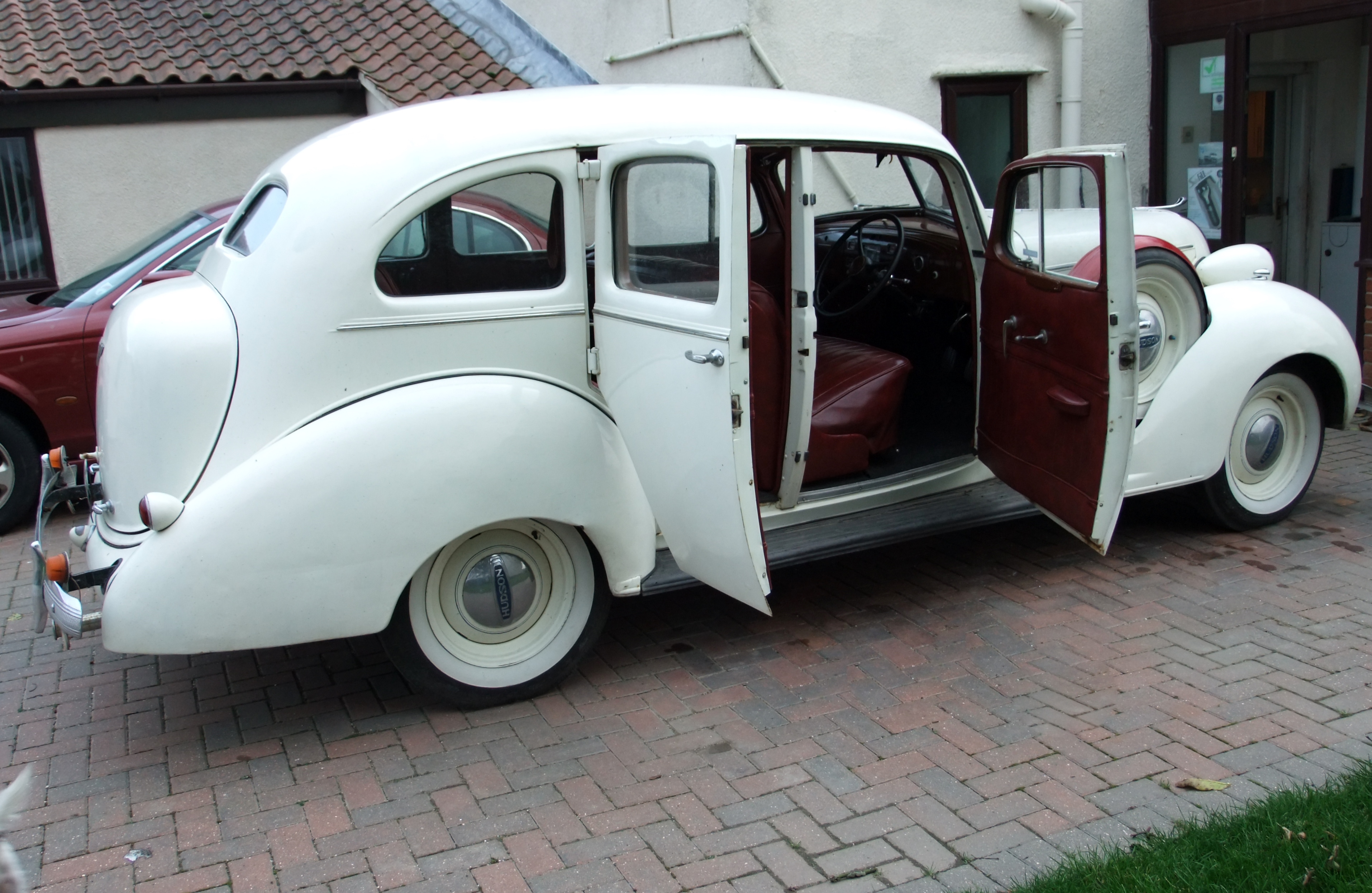

1937 Hudson six

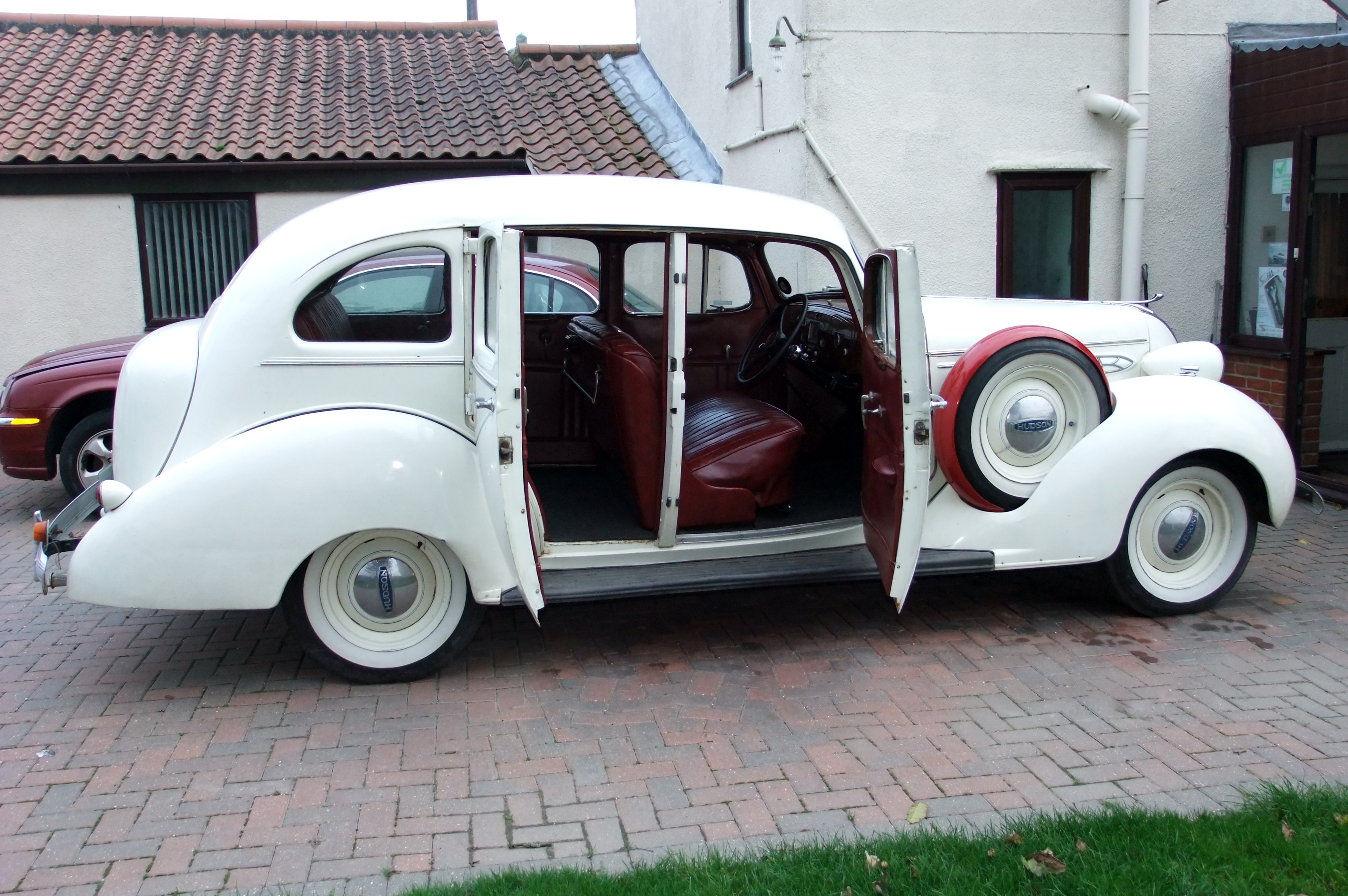

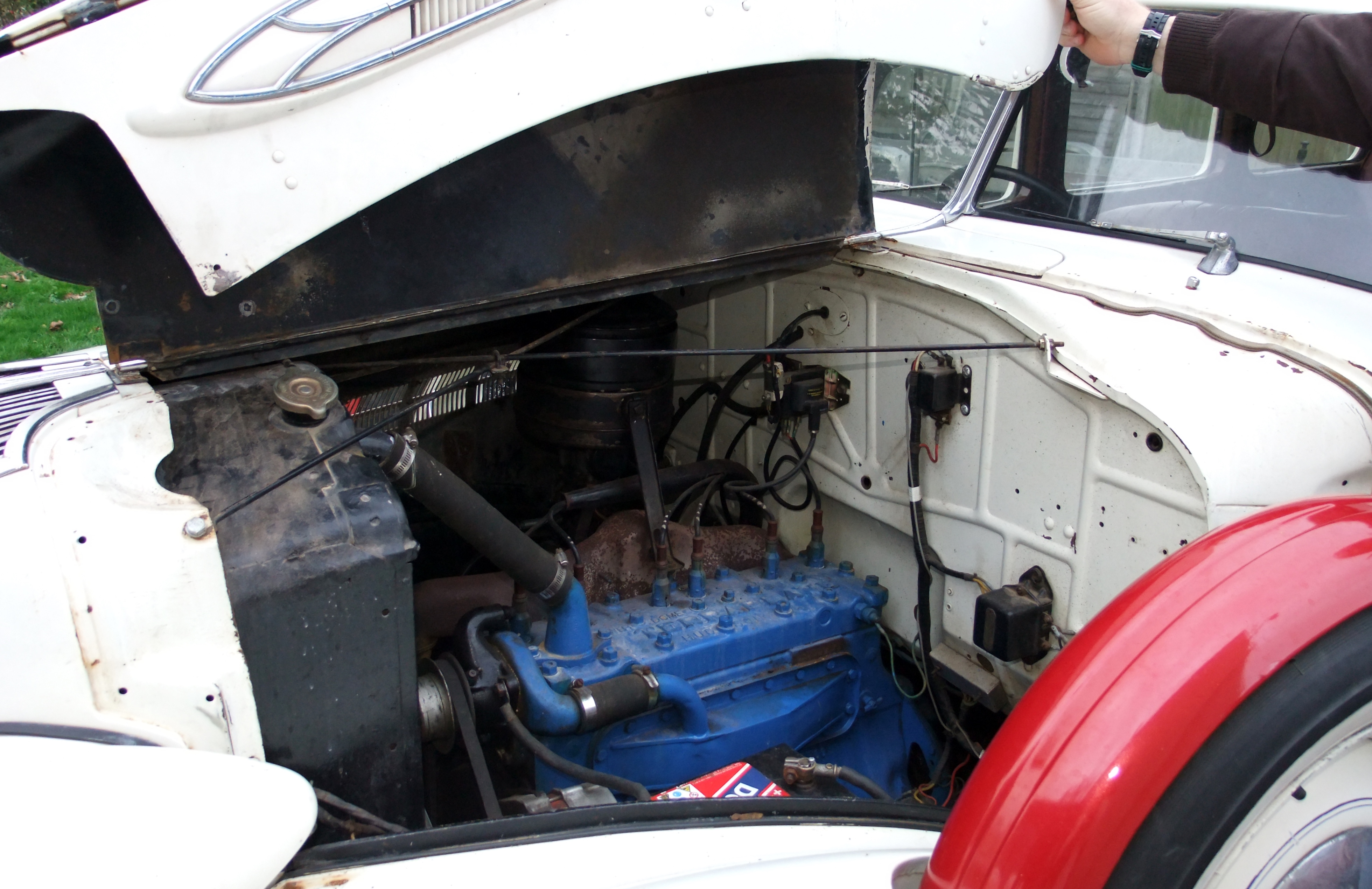

I need to sort the choke on the carb as the starting process includes some fuel down the throat of the carb as it's choke is u/s , it growls into life instantly once this is done, running well and smooth on road, brakes etc good.
The car held a few surprises as it was sold to us as a terraplane but is a six touring sedan, it also has a power dome head on it and this does say terraplane on it, the casting number though on engine fits the year of the car and the engine number begins with 366 interestingly as it's a six this could from all the docs I have read be correct, the eights numbers started at 80 or 90 but some info shows the six starts on 25 and other info on the het site show the 36 number began in 1938 , but this could vary.
So if I have it right the whole car looks like it's pretty authentic, come to think of it at those times in South Africa gold and diamonds were big business , who knows this car may have been bought from this.

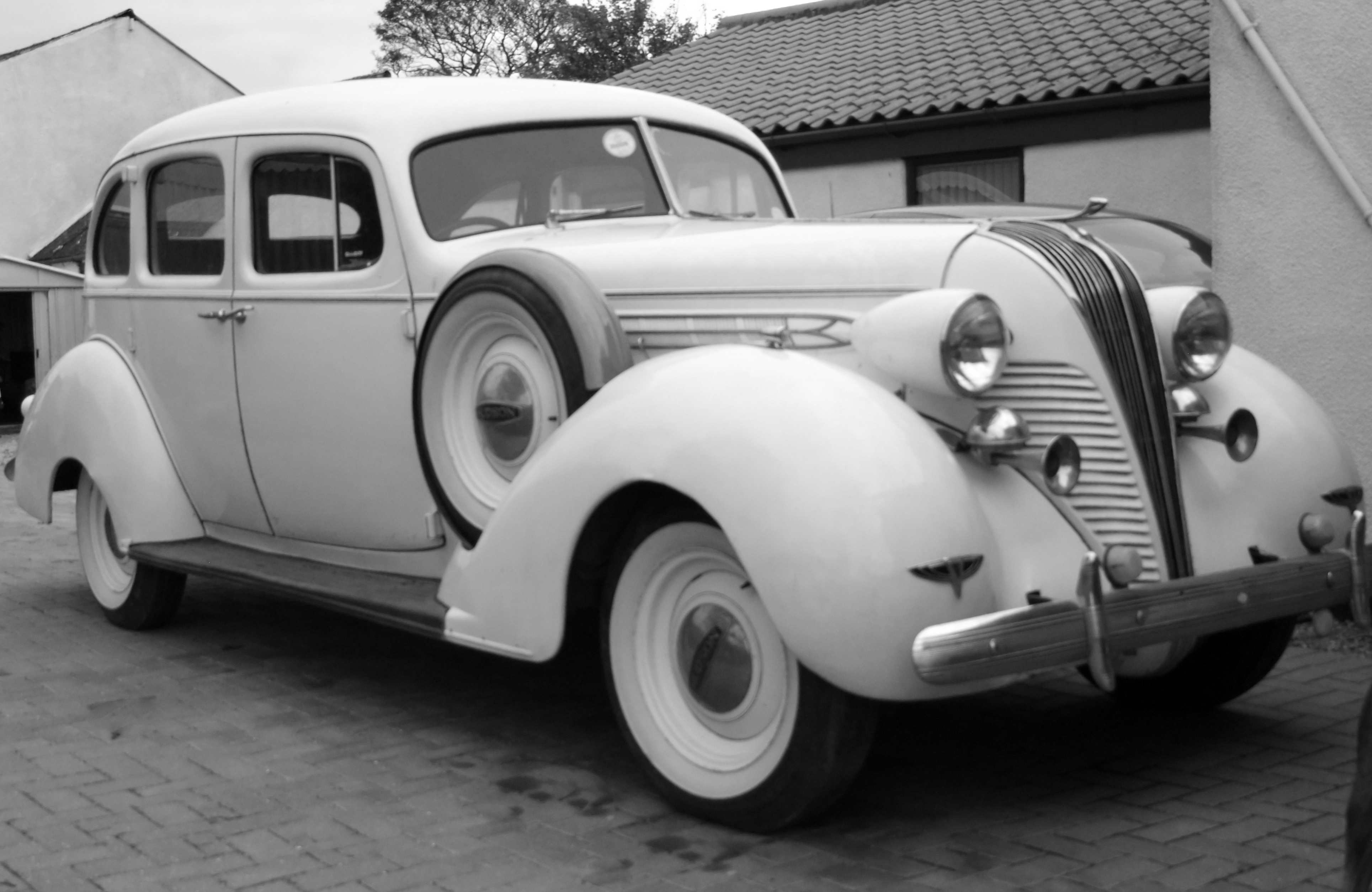

Both fender trims are missing but indications ( holes) seem to indicate it had fender lights, these are I believe almost impossible to buy so I have made a plug and will cast some.

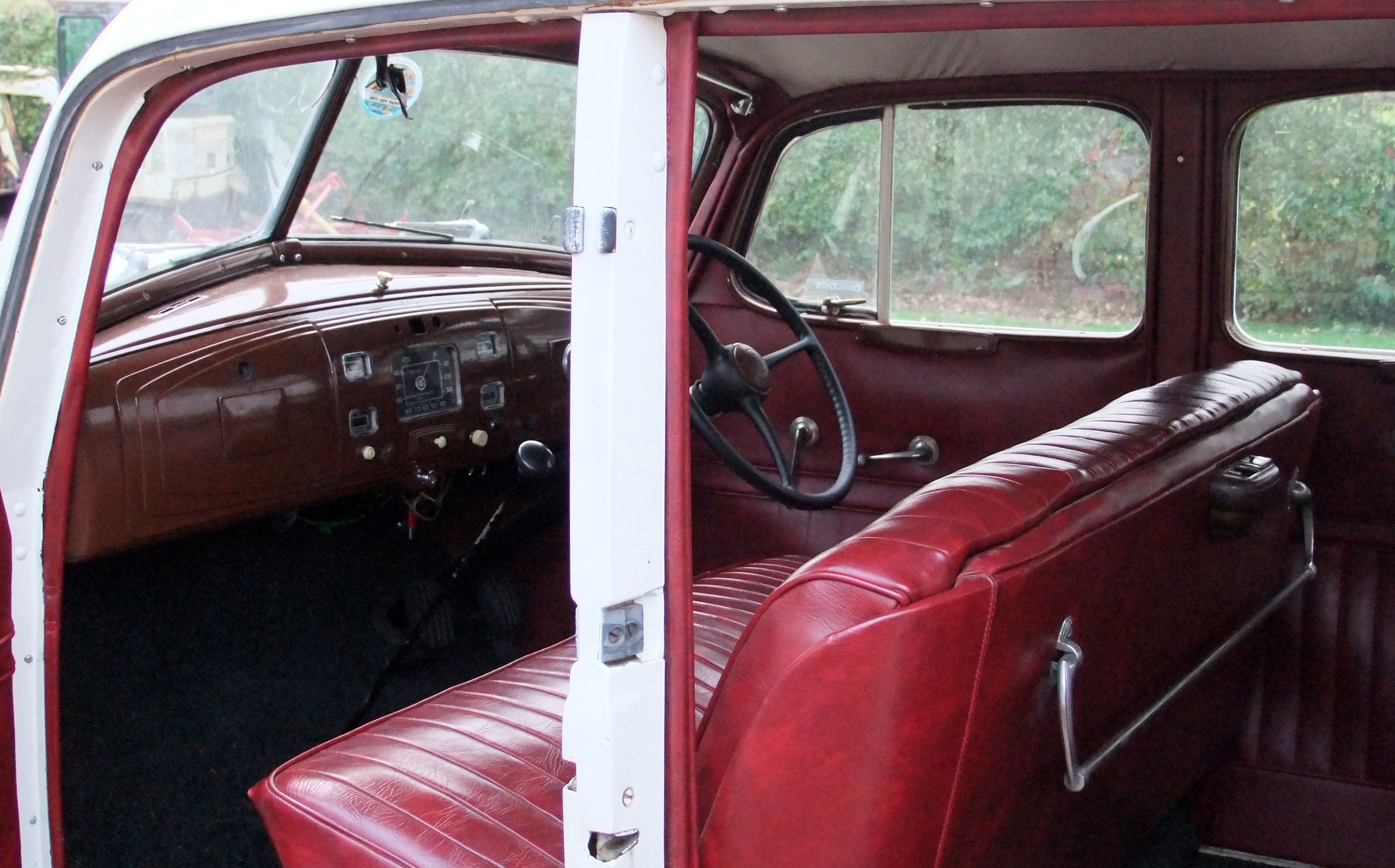

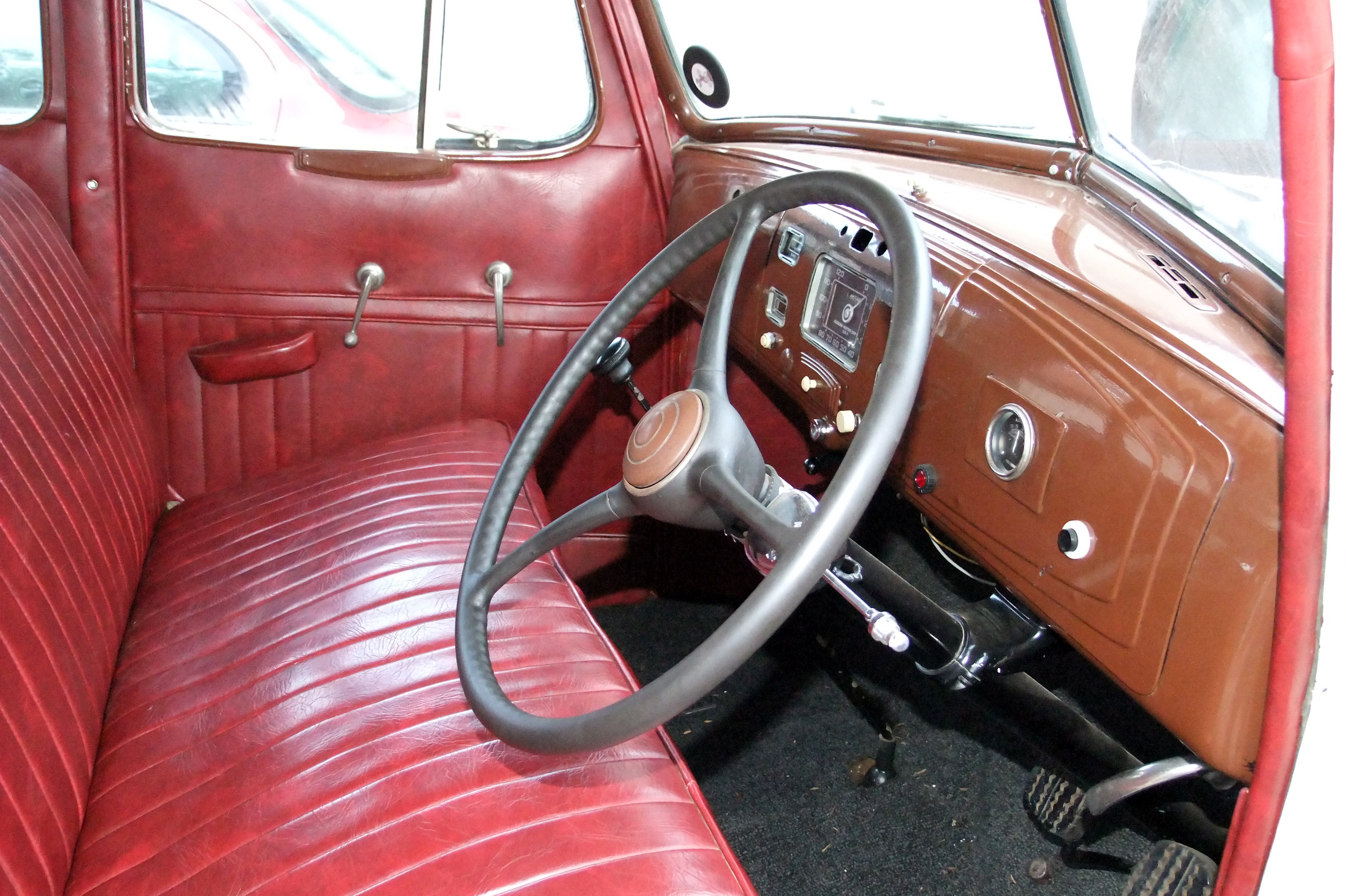

The body is rust free, all engine bay plates in place and all seems very original, car is fitted with two spare wheels.

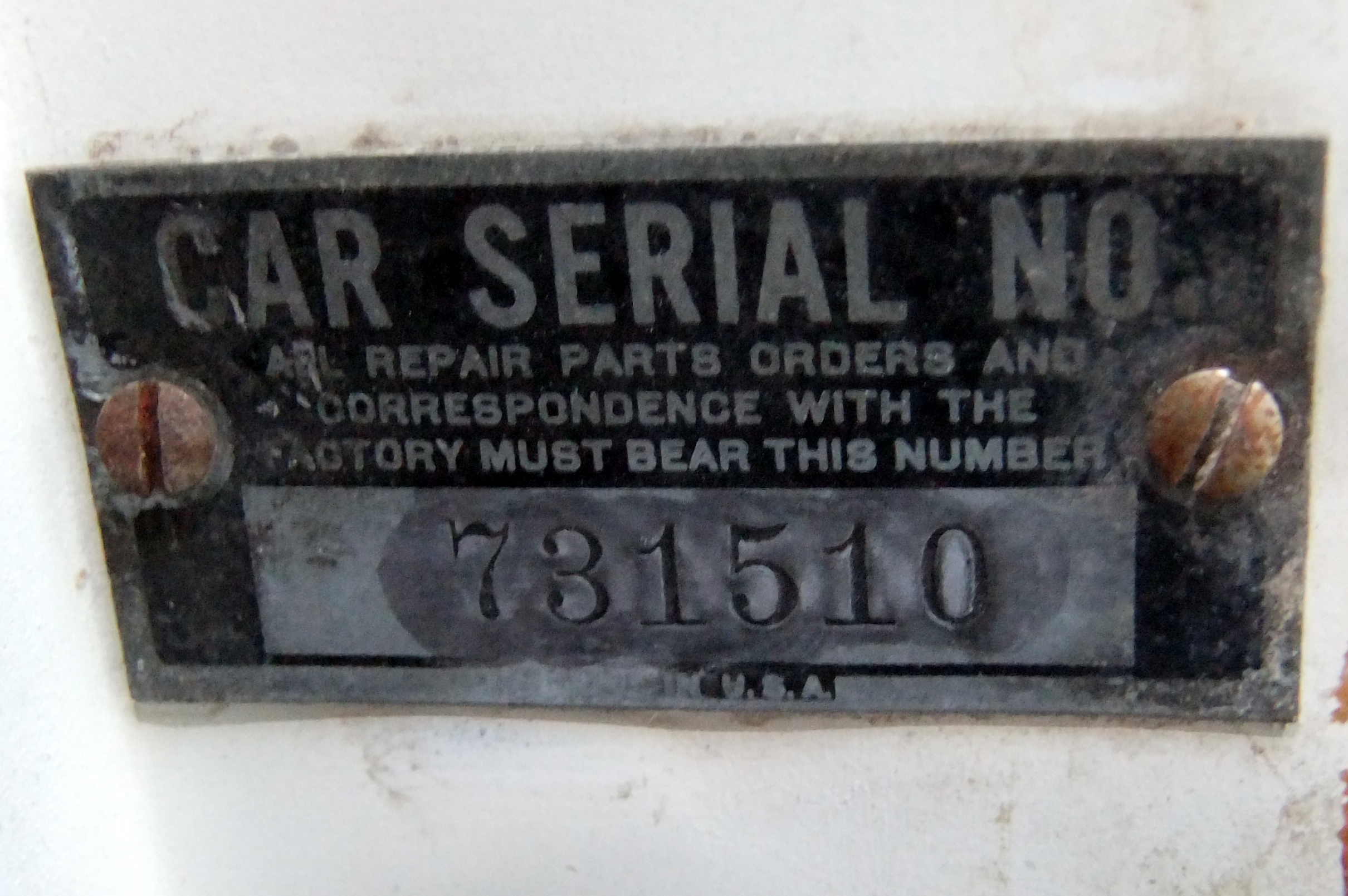

Anybody out there with more info please feel free to advise, the chassis number is 731510 .
Glad the car got there all right, Alan. It's my understanding that all export models, regardless of point of manufacture, were equipped with the fender parking lights.0
Thanks for the info, finding them seems a challange so will make them, also need to find the red single wing so if anyone has one please let me know.0

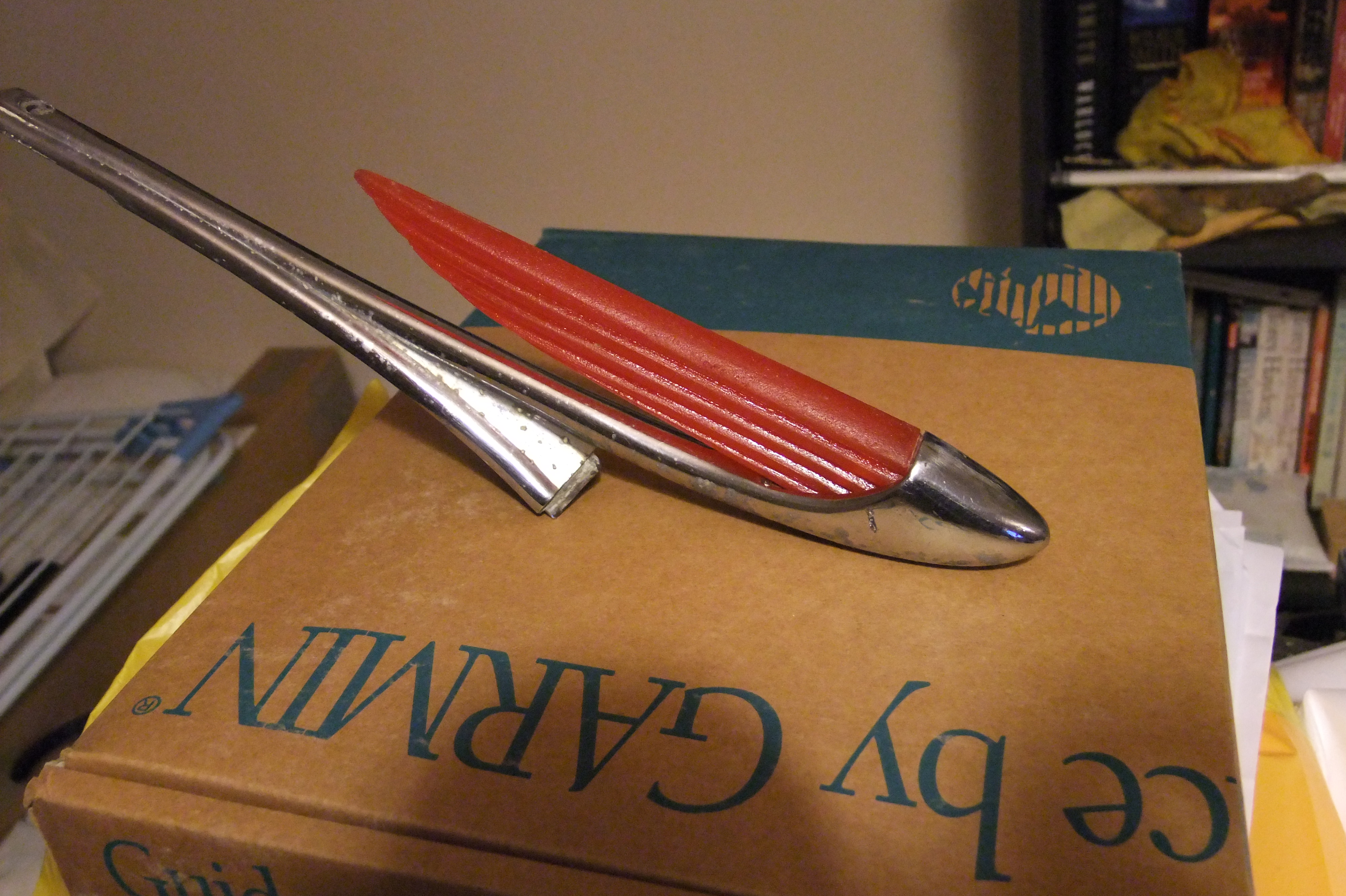

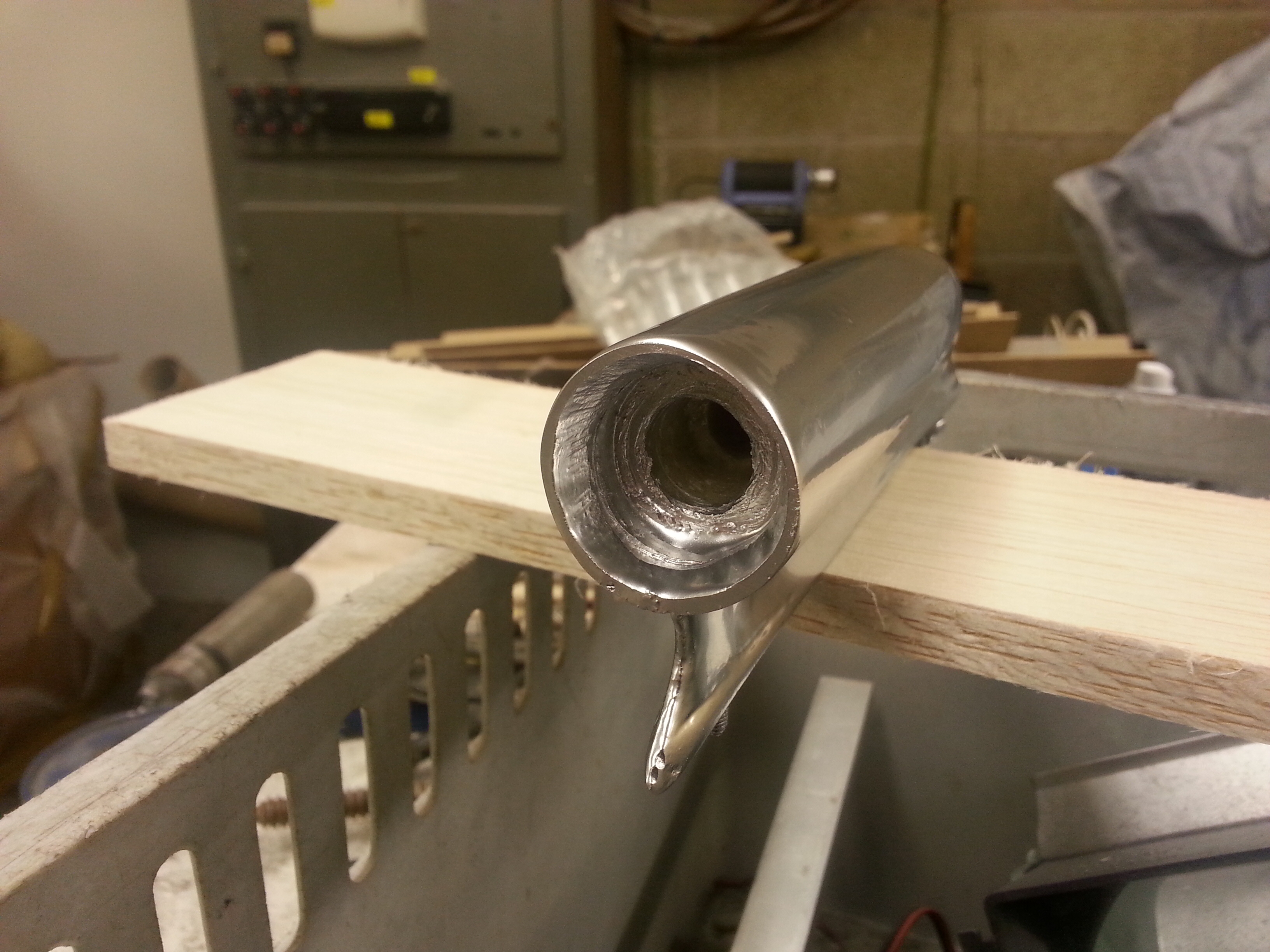

Dont worry aboutva Red Wing. I bought one on E Bay tghen tweaked it to fit the '37 Hood Orament. Its not perfect replacement but will suffice until they start reproducing them...
b vThey can also be ourchased on E Bay for about $25 for a Pair... I used Awquariun Adhesive from Petsmart to secure the Wing...0 -

Park, are you saying that all HUDSON exports had the fender lights? Or all 1937s (including Terraplane)? My 37 T was an export model but had no fender lights.0

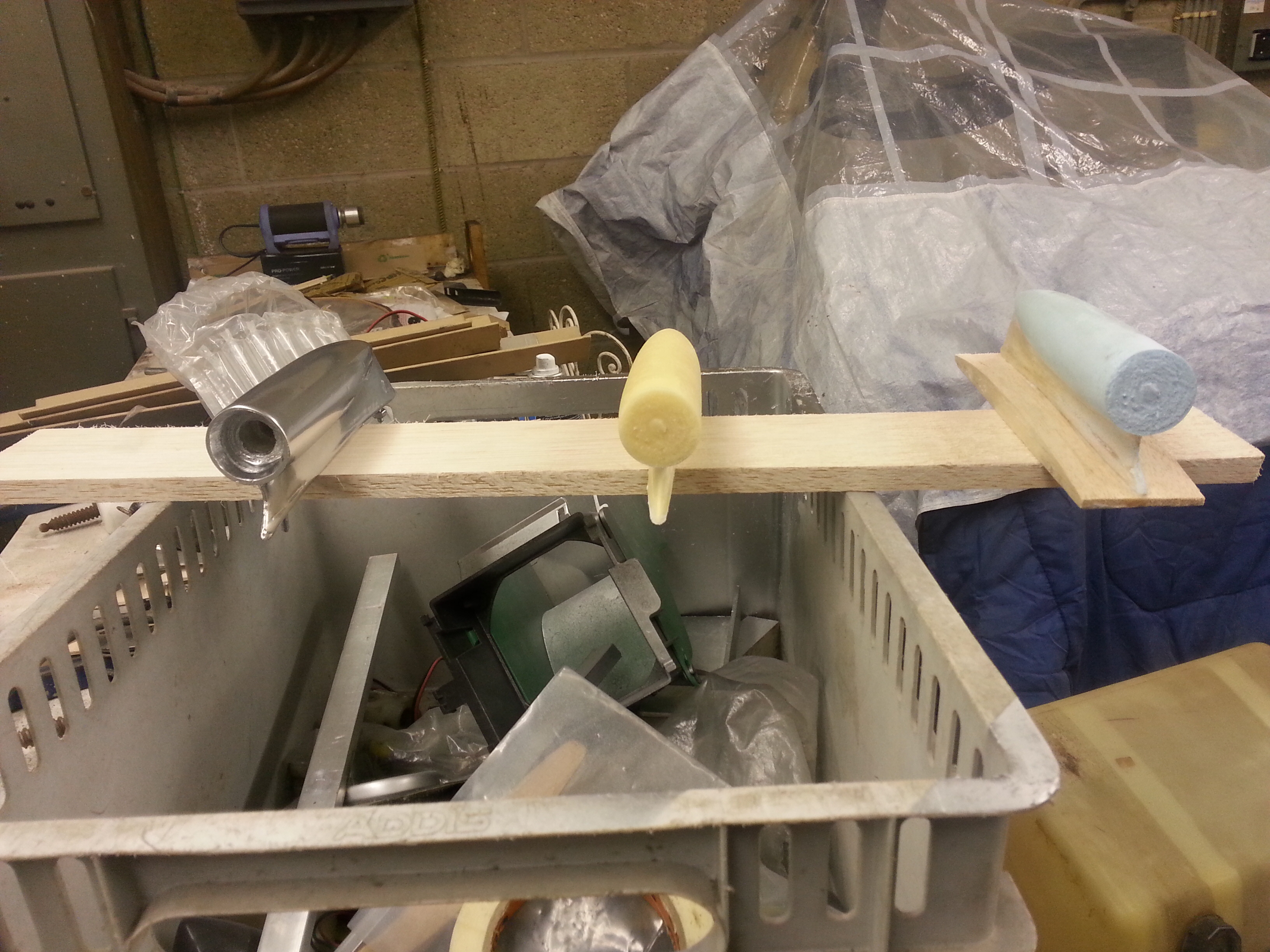

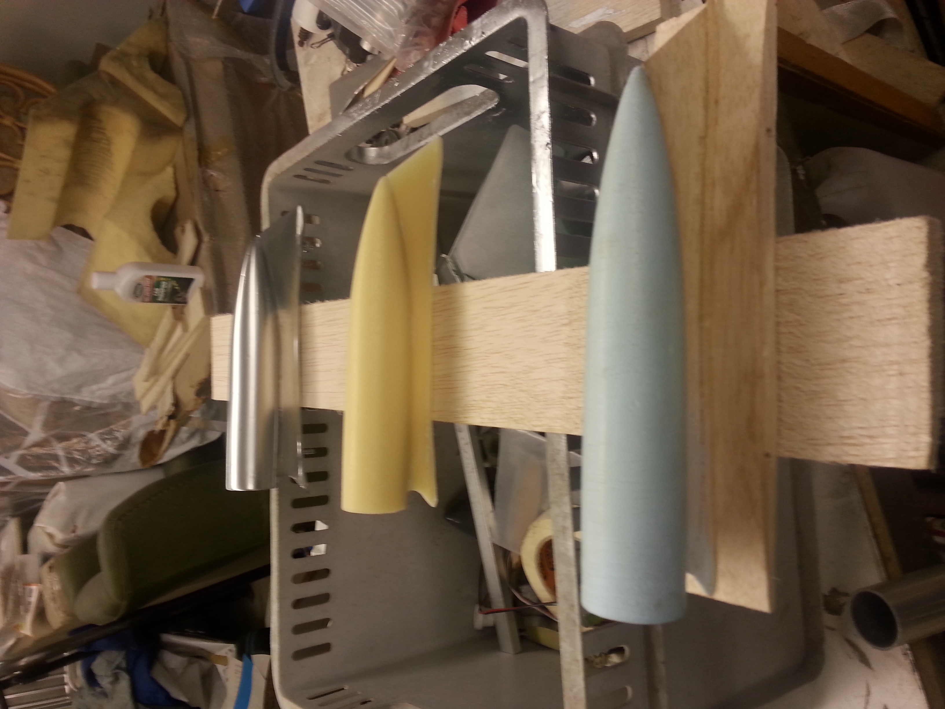

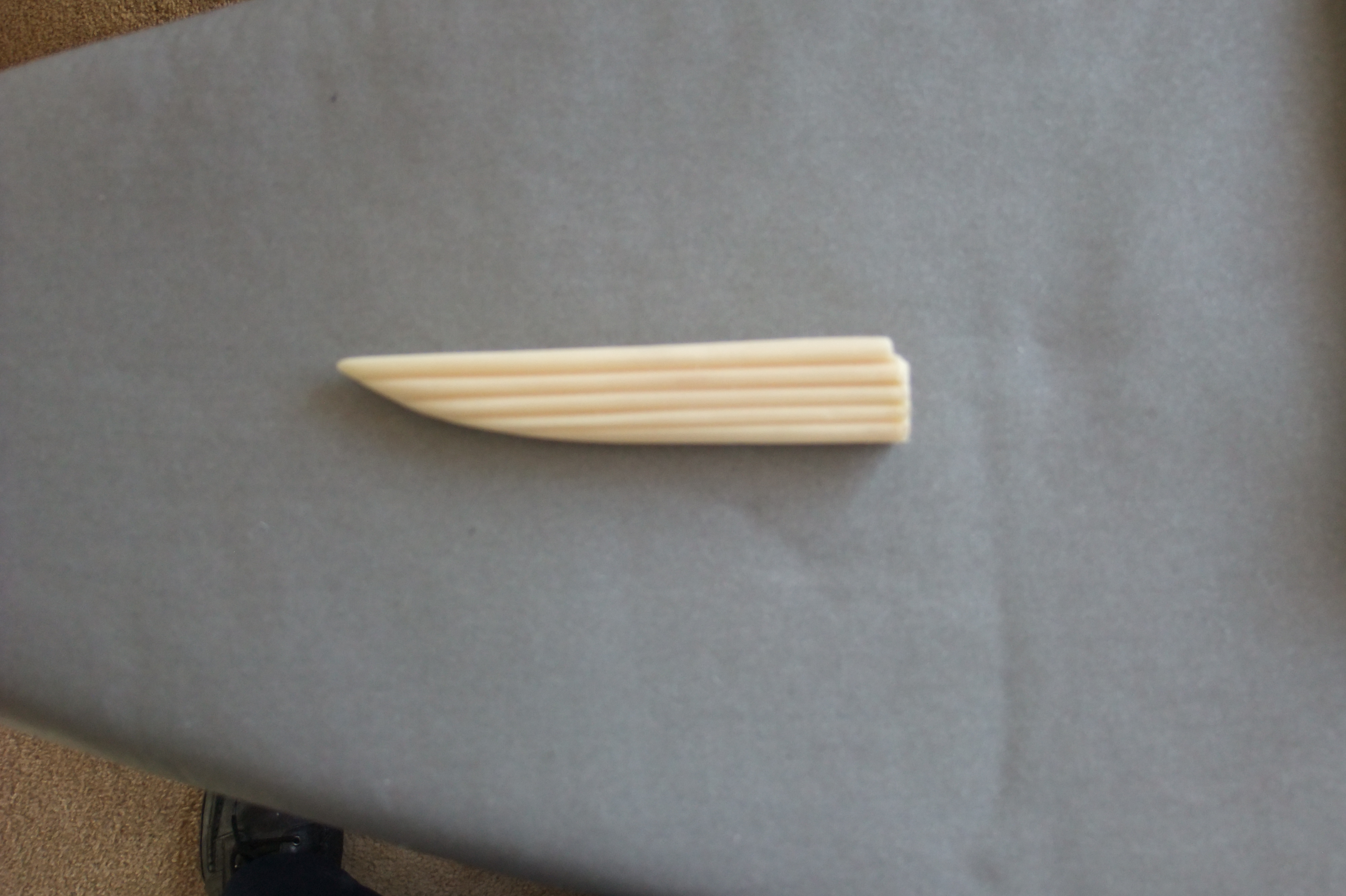

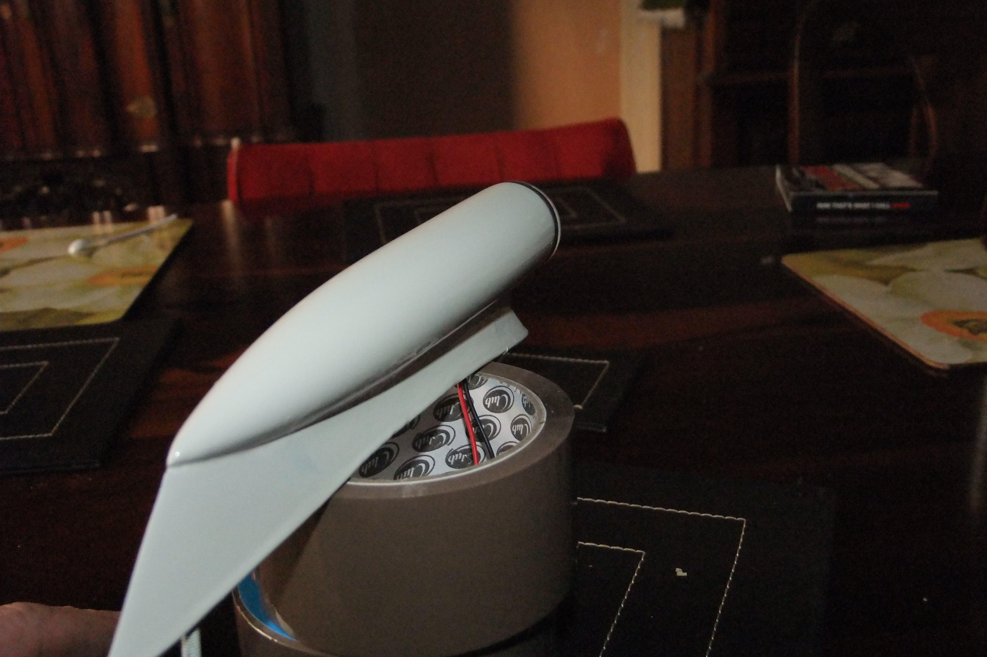

The hudson six in 1937 had a single wing, hood ornament and based on some photos I am going to cut one from perspex I will do it in a five layer lamination and use a friend's laser to cut it out each layer will then be shaped and polished prior to lamination, this should give a fairly accurate copy. As to Hudson's being assembled in SA my understanding is this was done from kits in Port Elizabeth , this is very likely as the cape province is known now for car production, I have some family in PE and have asked one of them if he has any knowledge of this.
I am not sure about the fender lights and what cars had them but mine definitely has three holes in each fender , looking at pics of these lights the holes look to be in appropriate places, I have completed the plug and will be looking at doing some sand castings but may also persue the lost wax method. The lenses for the lights is a small challenge but I have found an appropriate shaped lense.
If my wing looks good I will pull a mould off it and cast some in red casting resin, I was going to make a plug but decided the perspex route would be interesting.
The 1937 red carrot or zeppelin or cigar is similar to the 1936 carrot shape, except for the mounting grooves. I think the 1936 carrots are being reproduced by Eshelman moulding. Perhaps you can buy one without the grooves and modify it for your 1937. Might be easier. I also have spare 1936 cigars. ozhudson@gmail.com0

On the 1937 Hudson six unlike the terraplane the ornament had a wing not the cigar, this wing is quite simple to make if a picture of it is carefully examined, the cigar or torpedo would also be easy to cut on a lathe and then polish but it would I think not be able to be made to look like the wing , this seems to be quite a rare item to find.0

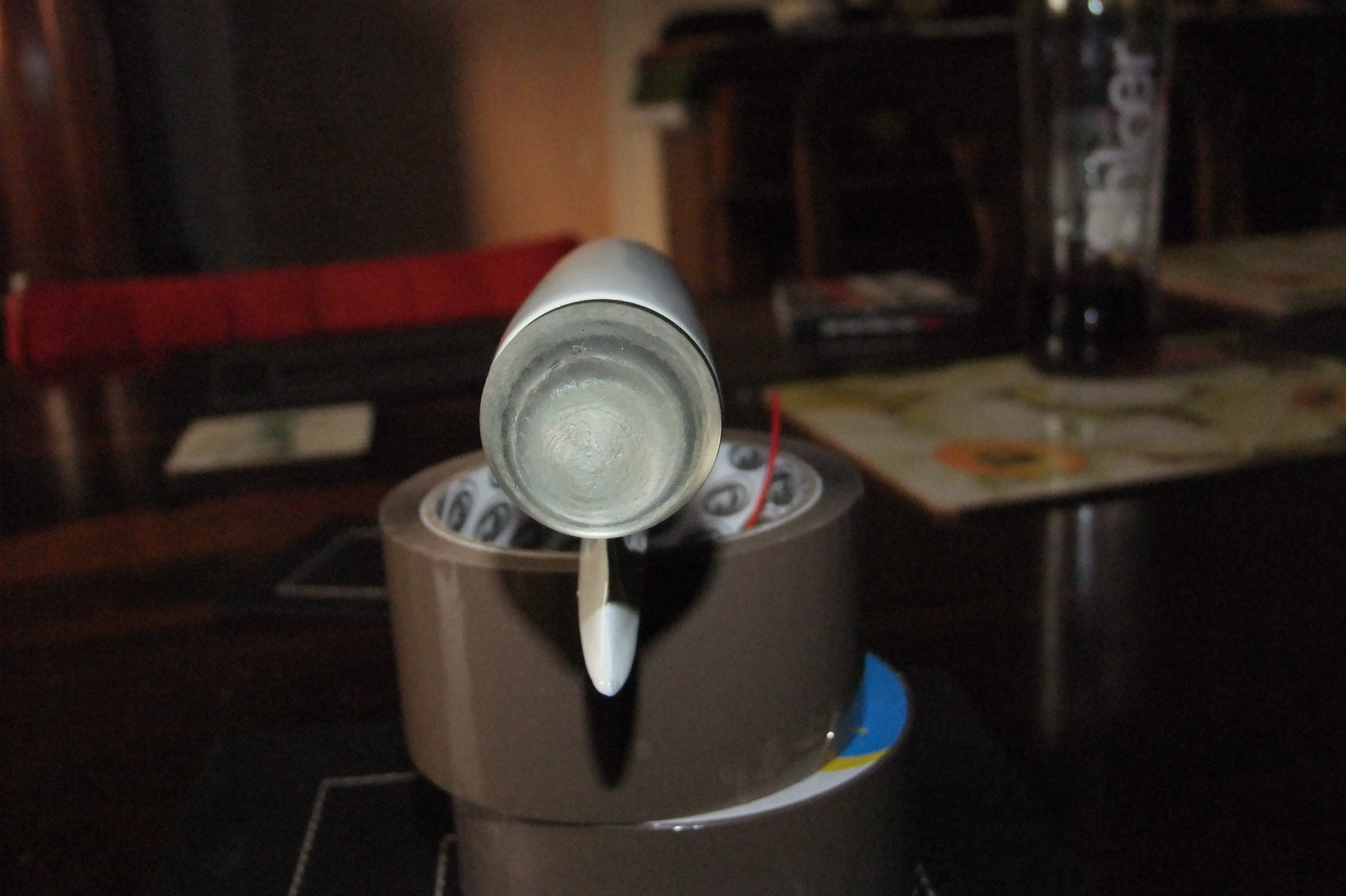

As I have completed the plug I have ordered some product to make a mould from, I will then cast some in wax which will then enable them to be cast in brass, will turn some reflectors plus ring and then use a low wattage candle bulb housing for the lenses. I will also make some in clear casting resin and see what they look like.0

These are the pics I have based my lights on, I will be casting my lights in two ways, one will be using the lost wax method , the second will be using casting resin, in the first case I will need to reproduce a lense and the chrome ring, should not be a huge problem, on the casting resin I may do them as one piece drilling up from the base for a LED and then chrome spraying the light fitting leaving the lense in clear and then lightly sand blasting it.0

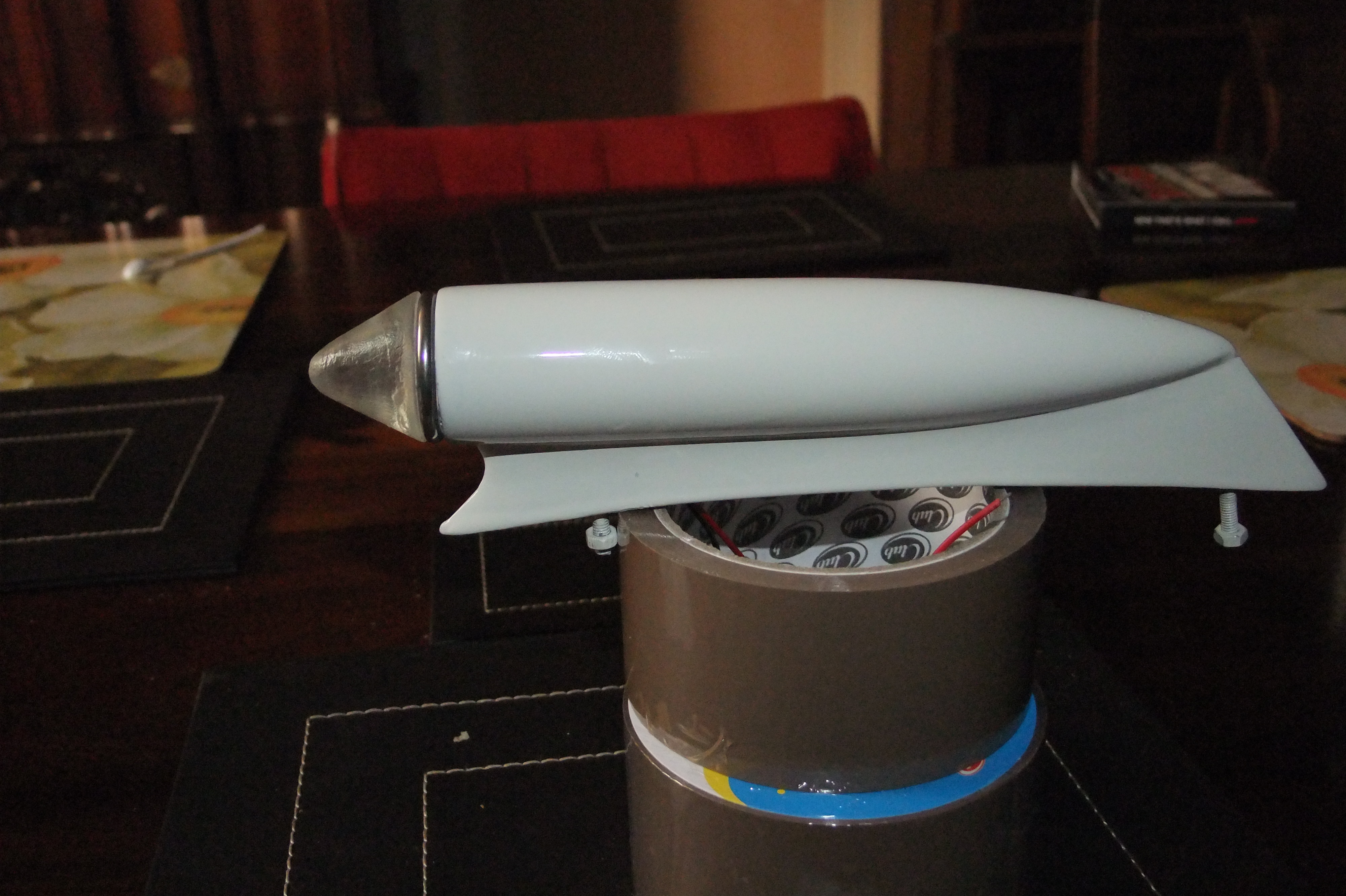

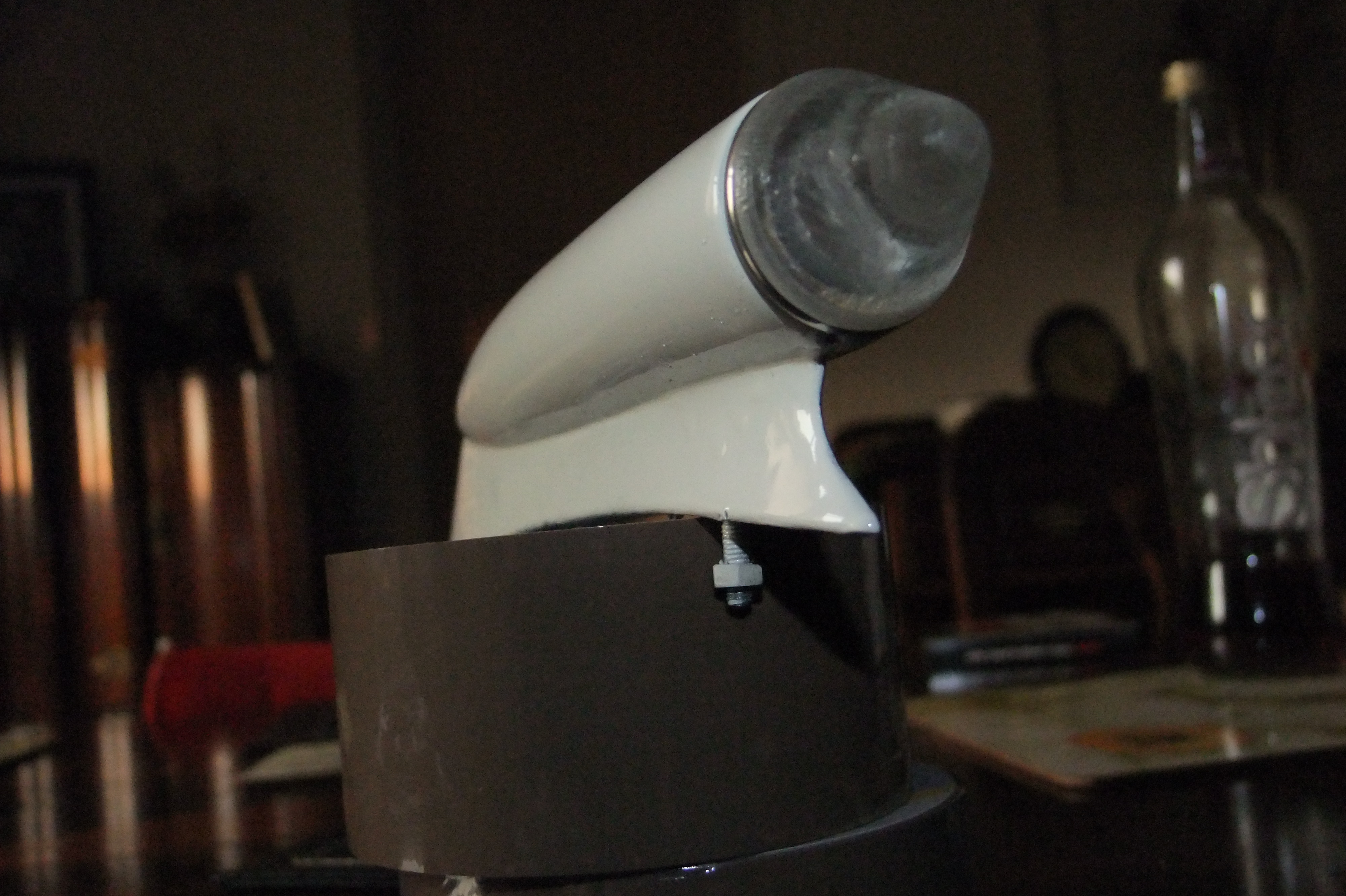

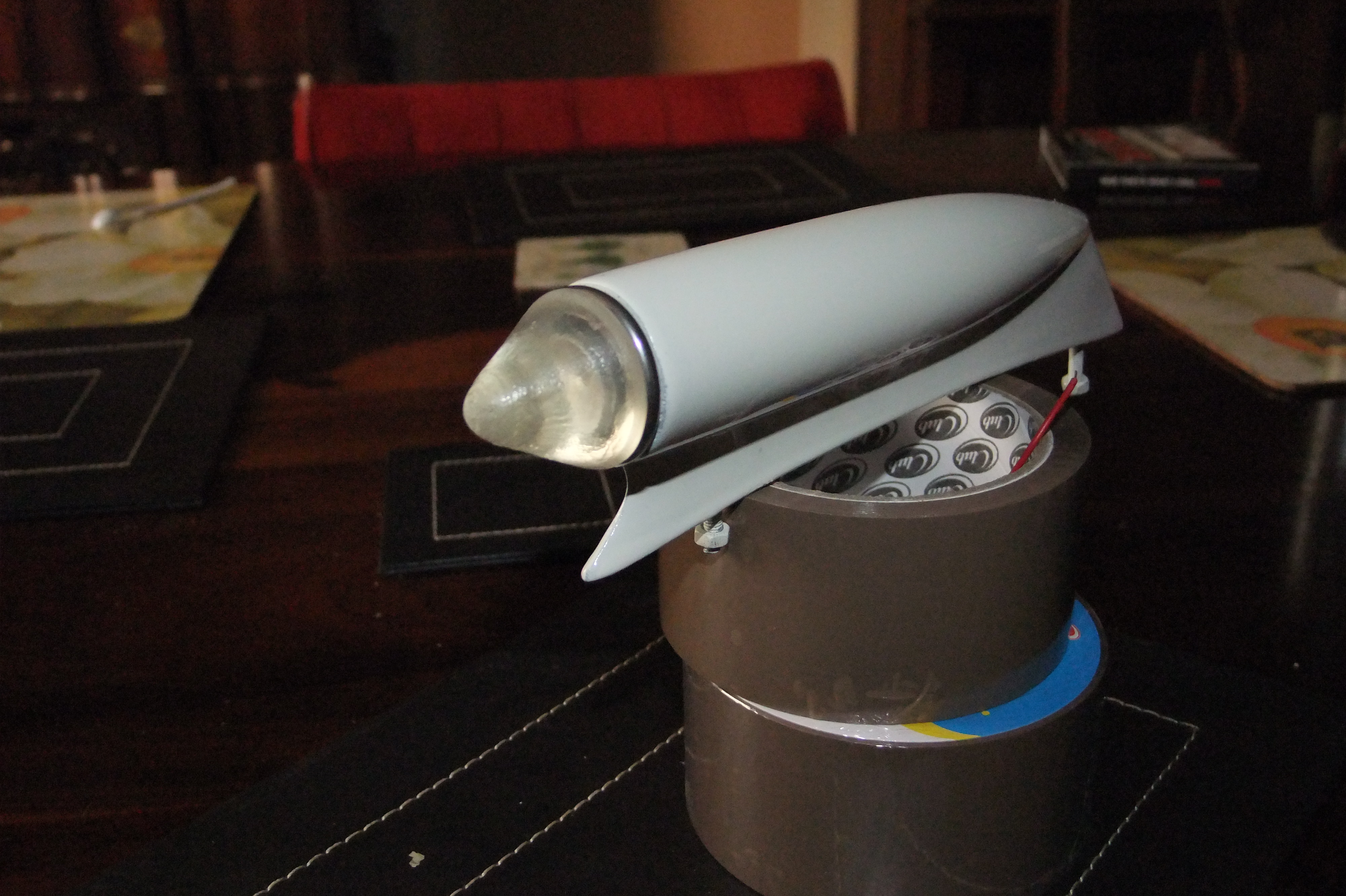

So here they are, one blue foam and balsa plug, then a casting resin body, then the body prepared and sprayed, made a lense mould too will post pics later of complete light, light fitted with a flashing LED 10mm diameter, rear tail light will have LED's fitted into the reflector. I will cast some in brass but to be honest the cast resin units look good and are quick and easy to make, they could be chromed as per most modern plastic parts.1

If made in casting resin I would not think very much, in brass will need to work it out once made, I will let you know but in resin with lenses and flashing LED not chromed but silver sprayed I think max £60 a pair.0 -
In the above example the body is cast in resin as per the pictures, then the lense is made in perspex this is then fitted to the backing plate which is made of stainless steel with a stainless trim ring, the LED fits into this trim, LED can be flashing Amber normal Amber or white light if required .0

I will also be able to offer the single wing for the hood ornament, this will be cast in red transluscent casting resin.0 -

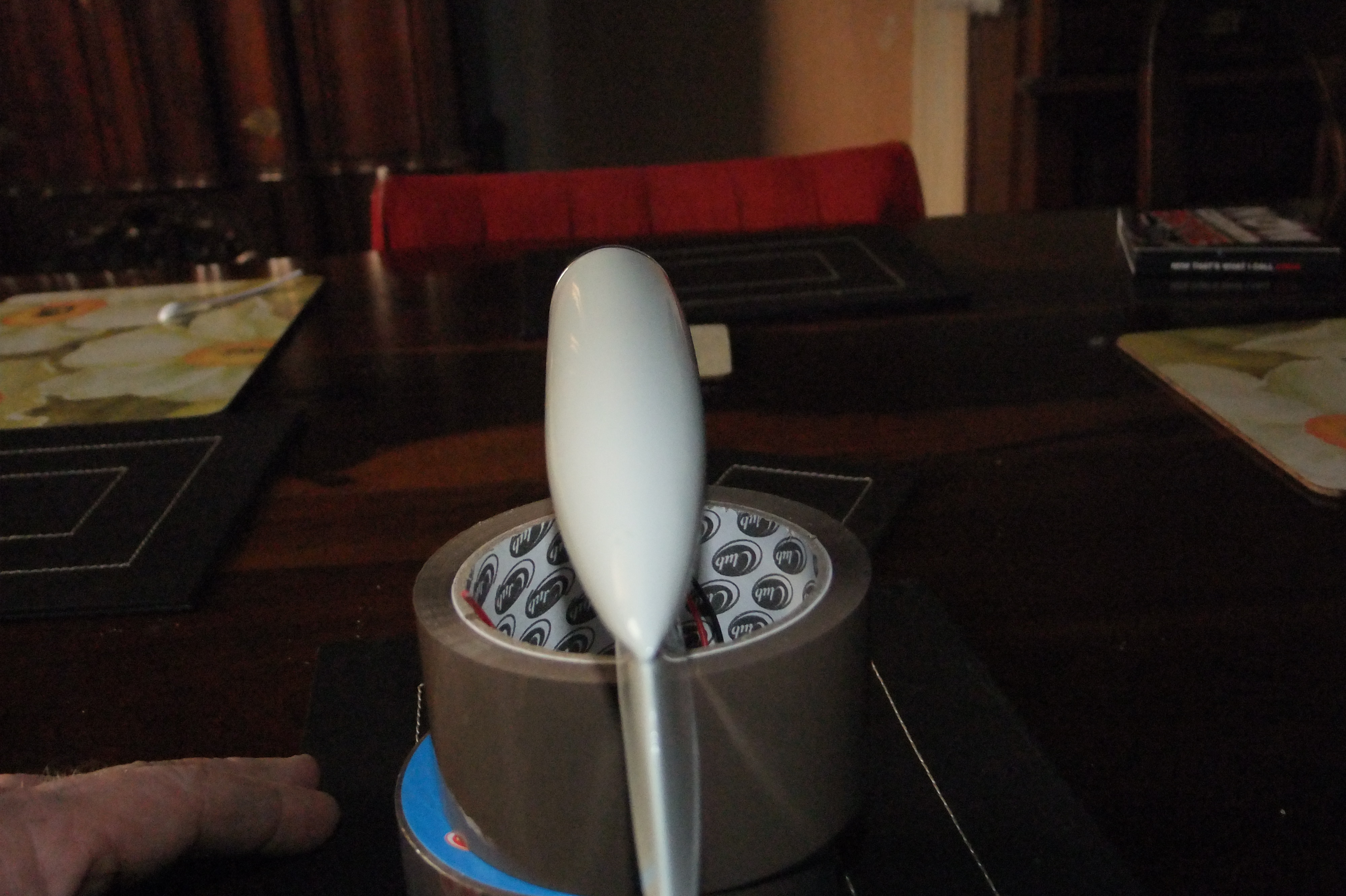

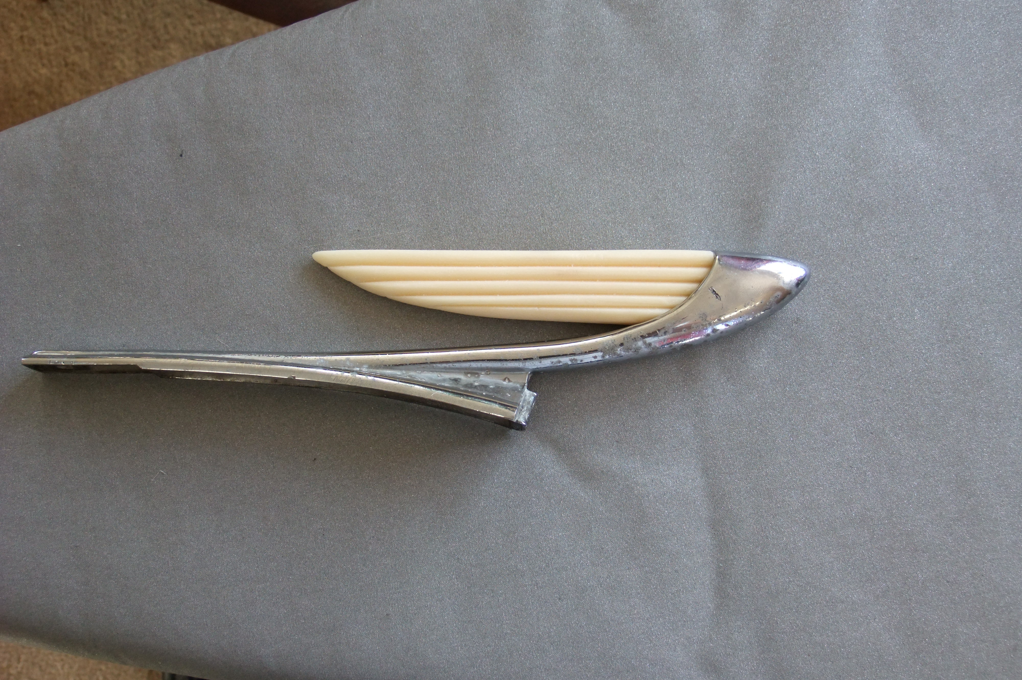

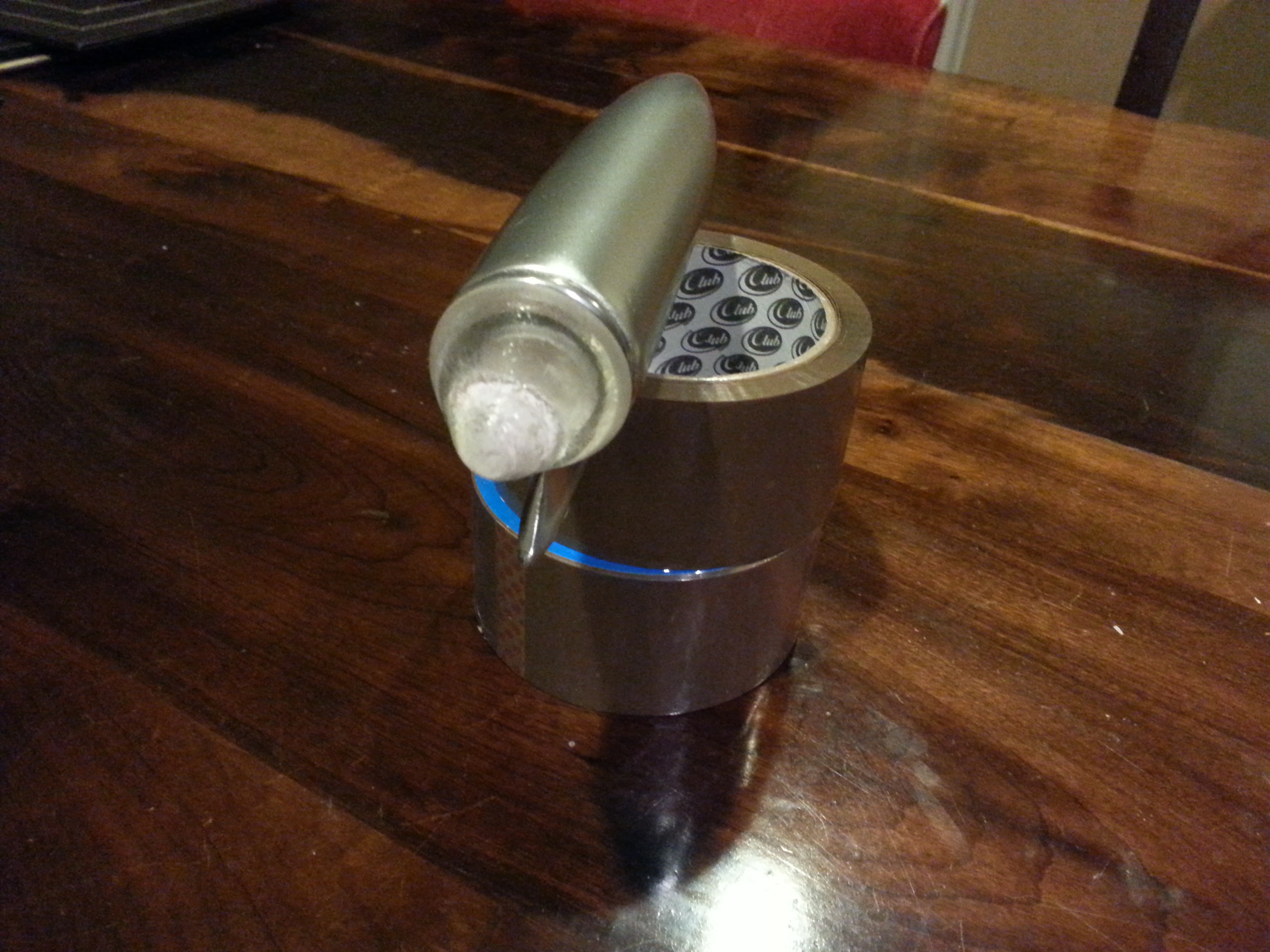

here are my first castings of wing, the cream colour one was done to check the mould was ok, the plug was made from pink foam. the red wing is from clear casting resin with a red tint added, the wing now needs to be polished. the mould is from silicon so can make about 25 before I need to make a new mould.
I am able to offer these to anyone wanting them at a fair price, if you want them in a particular colour to add your own signature to your car I can do this.

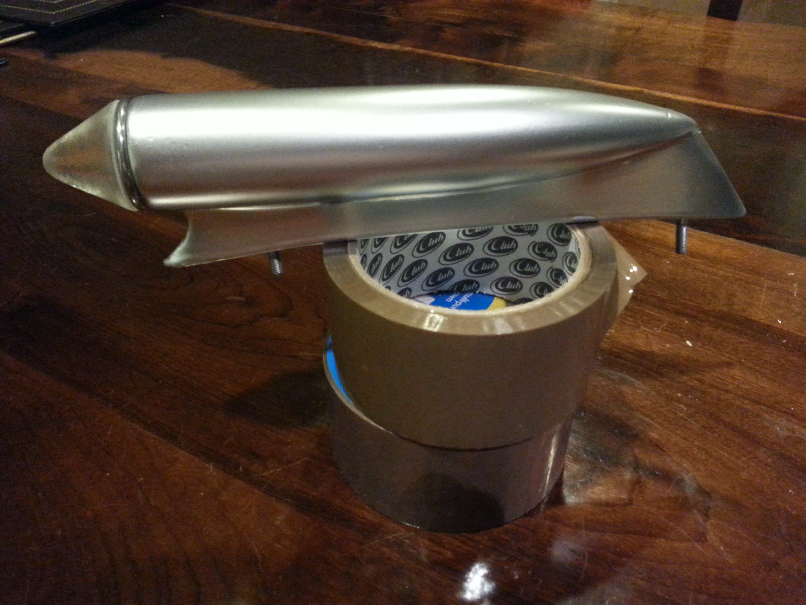

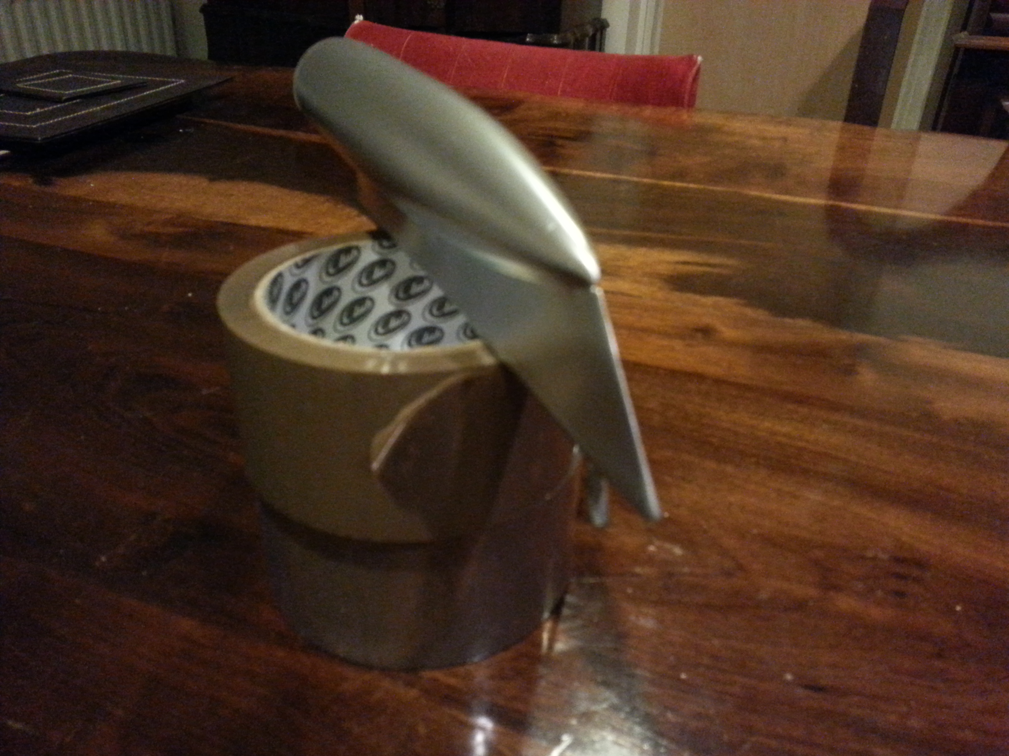

Here is the first completed unit but this is silver sprayed not chrome sprayed, lense is solid casting which screws into the body, ring is a stainless steel unit , lense drilled to accept 10mm LED , in my lights I have used flashing Amber LED's for turn signals. As I had nothing to measure from other then mounting holes in fender I have judged the size of the lights from this, I think they have come out well.0
