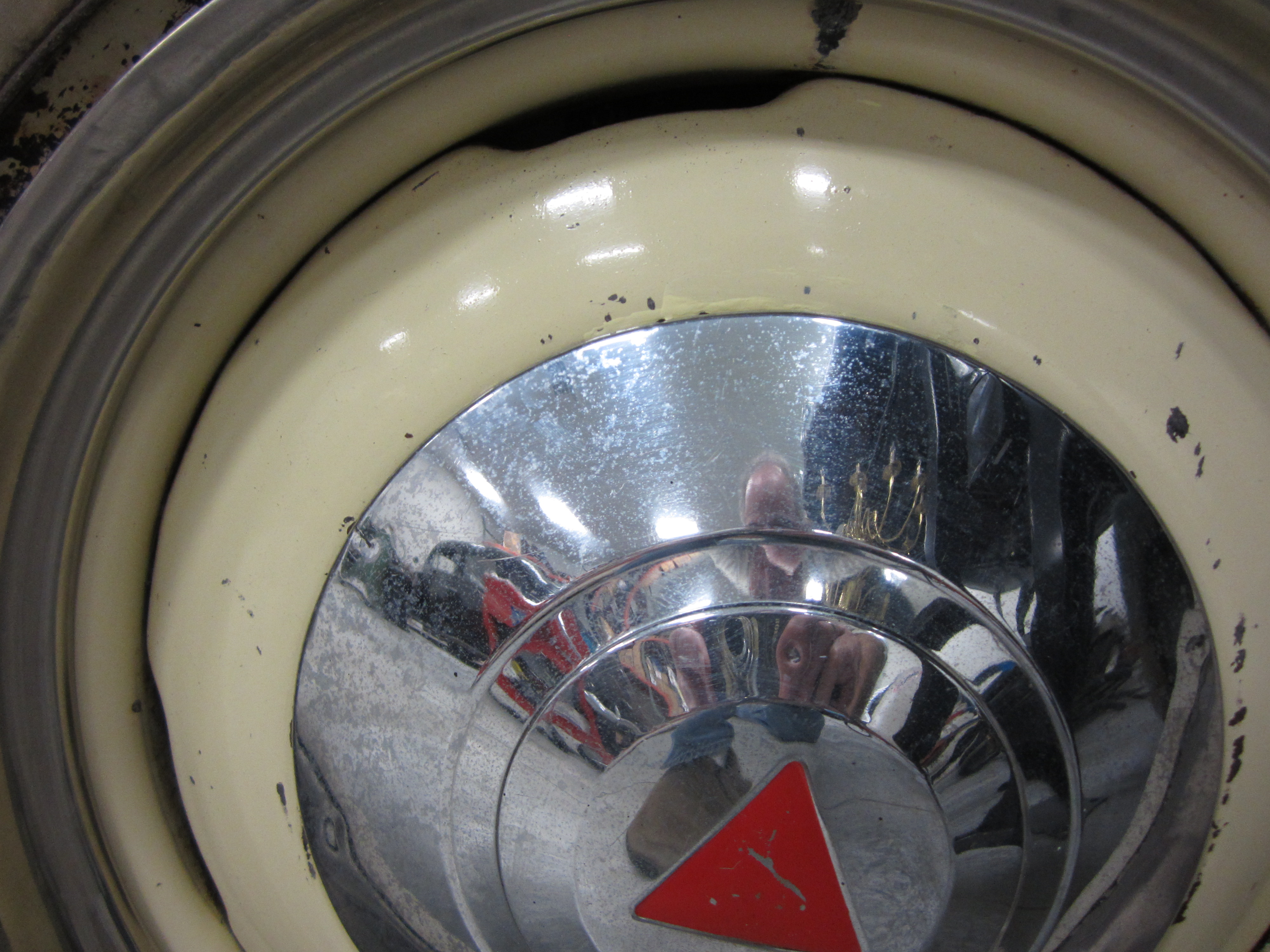

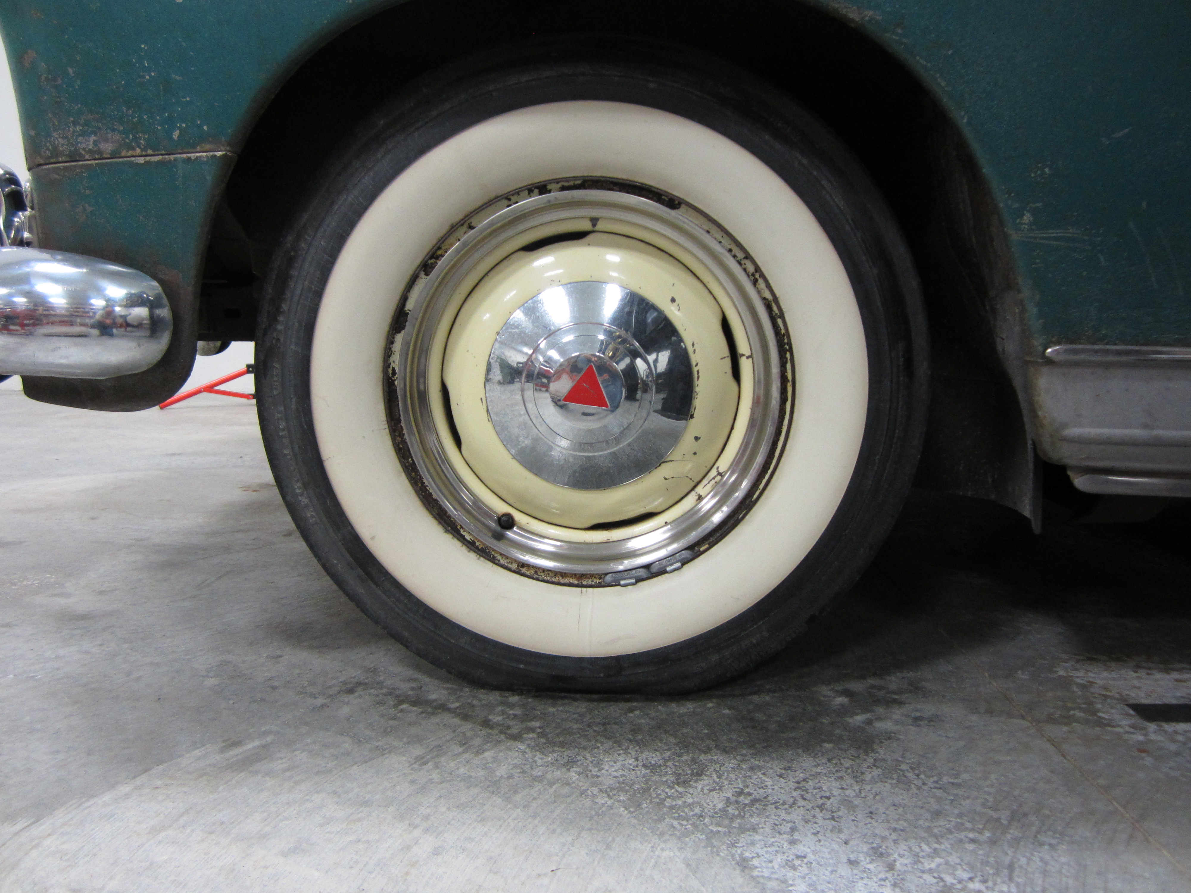

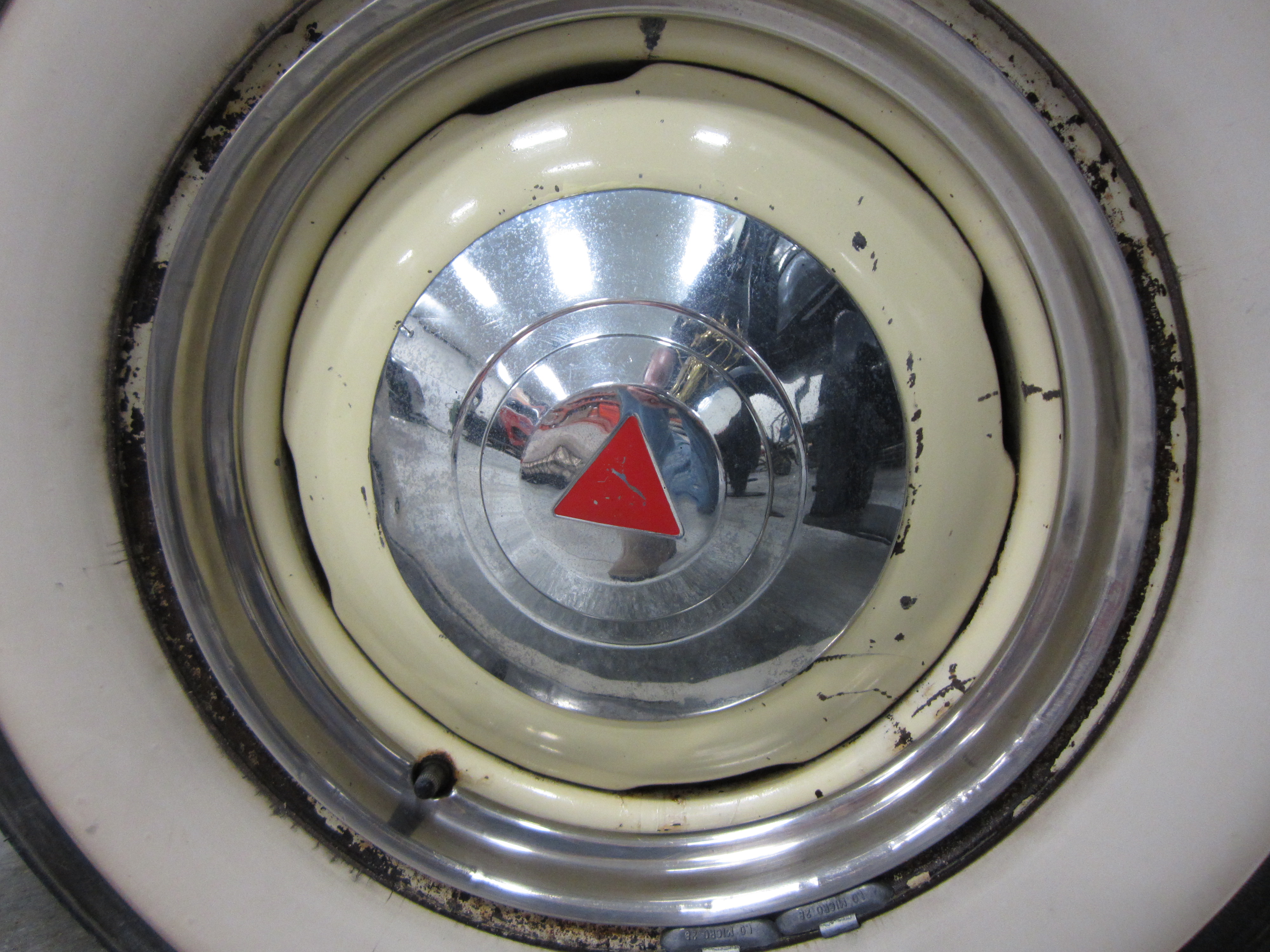

When they enable us to insert pictures again I will post a picture of the cream yellow wheels on my 50 Pacemaker (50A). I believe they are unrestored originals.John Forkner0

I believe the the wheels on my 1950 Pacemaker (50A) are original. I have never found any evidence that the car has been repainted or restored. It's OK if someone wants to prove me wrong.John Forkner0
John, Yours looks just like mine. They sure as heck were not yellow! as I have seen on some restored cars.

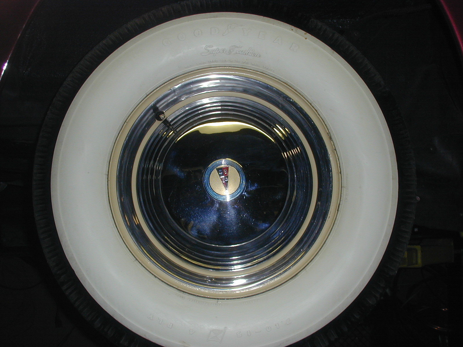

...just an interesting anecdote... An older pal of mine, who recently passed on, mentored me most of my life in all life choices including all of my previous car restorations (late 40's, early 50's).He once told me when I was pondering wheel color,"Man, if you didn't have red wheels, you didn't have s&#*".In his memory, and since I'm sure he's watching every move, my wheels will be red.By the way, Dave that wheel, wheel cover, tire combo is georgous. Are those radials? Where can a guy get them.One more "by the way". What in the world makes me a "expert adviser" that is broadcasted behind my name here. Just in case anyone considers anything I say, I am anything but! lol...keith0
