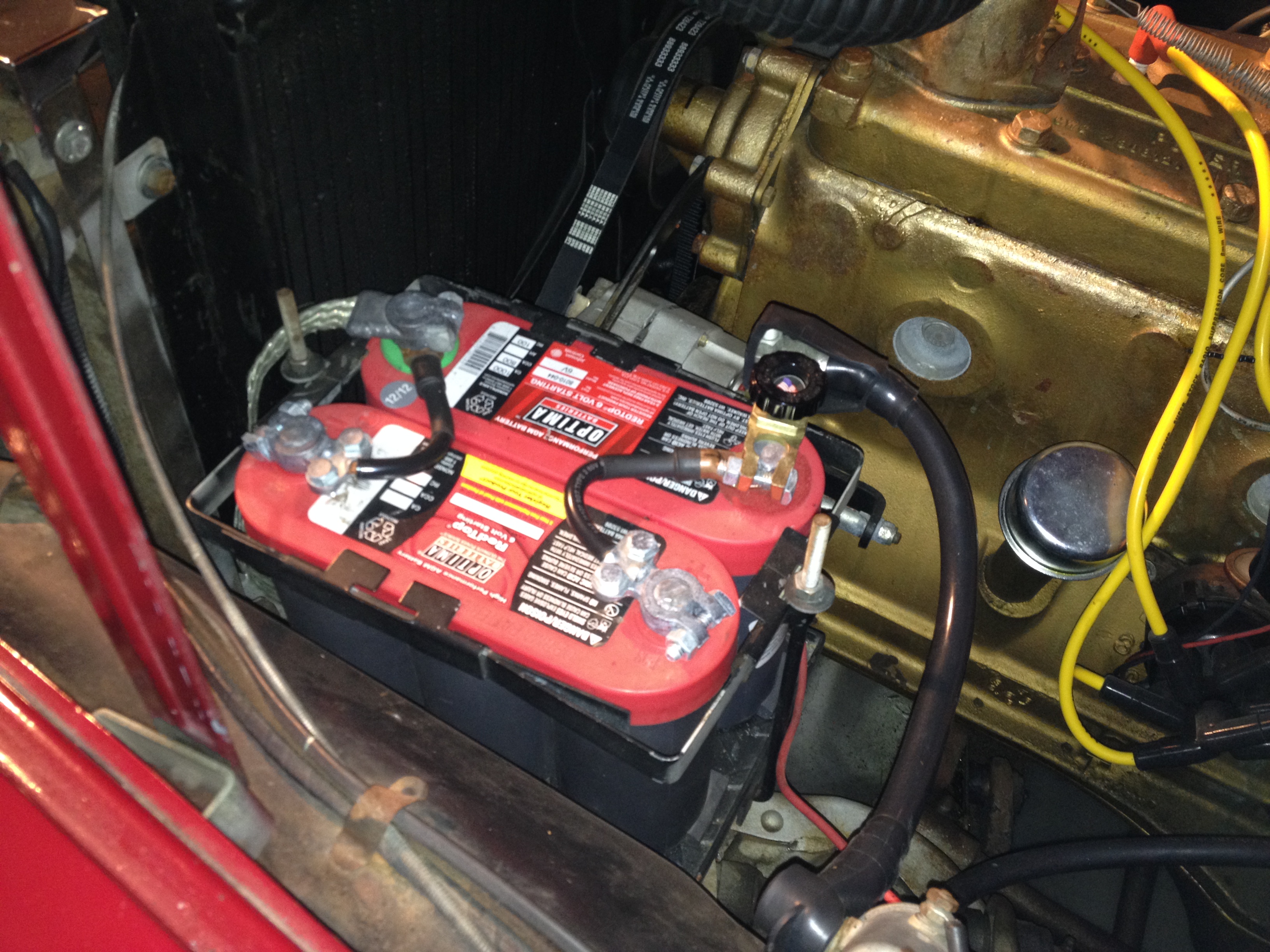

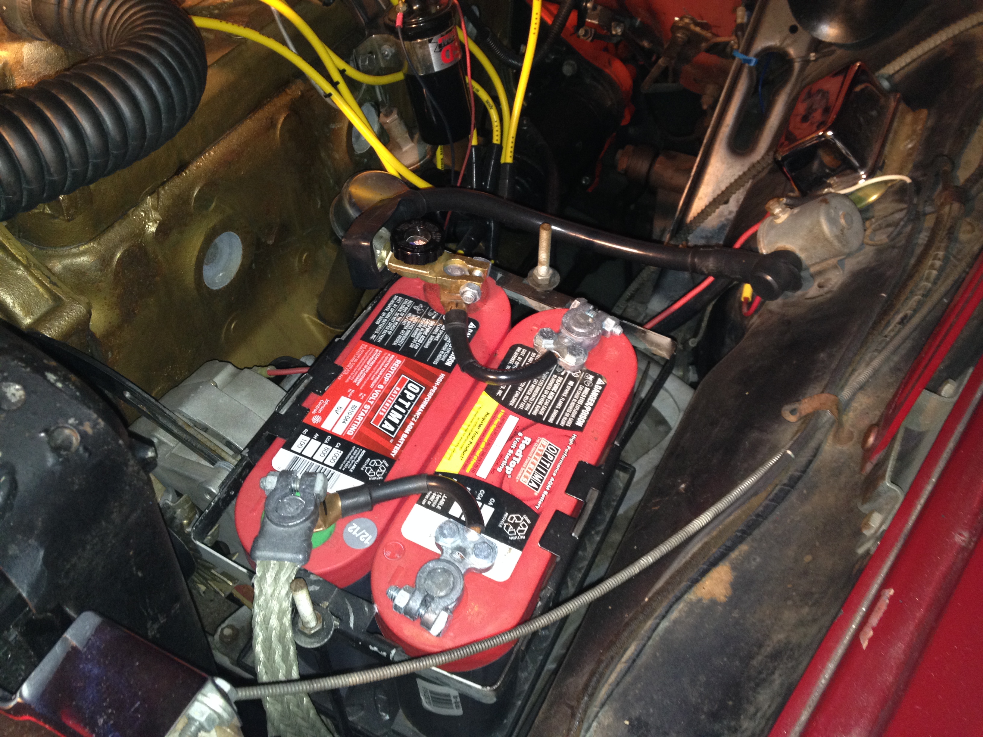

Why would I want to hide these. They fit into the battery shelf perfectly, and the holder is a unit that I bought
from Advanced Auto. Fits two batteries or one...Hope these go in......Also need to preview the file before posting....
