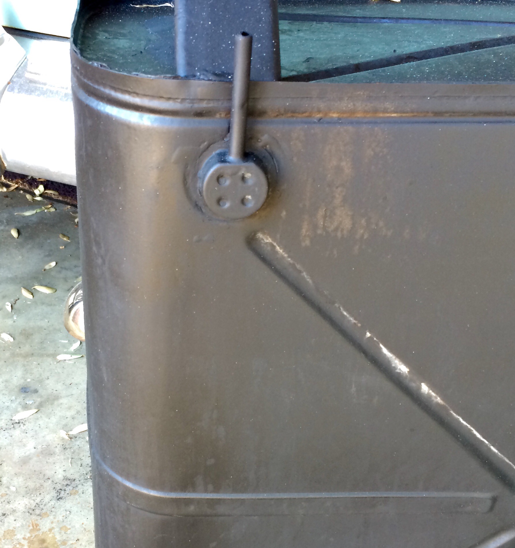

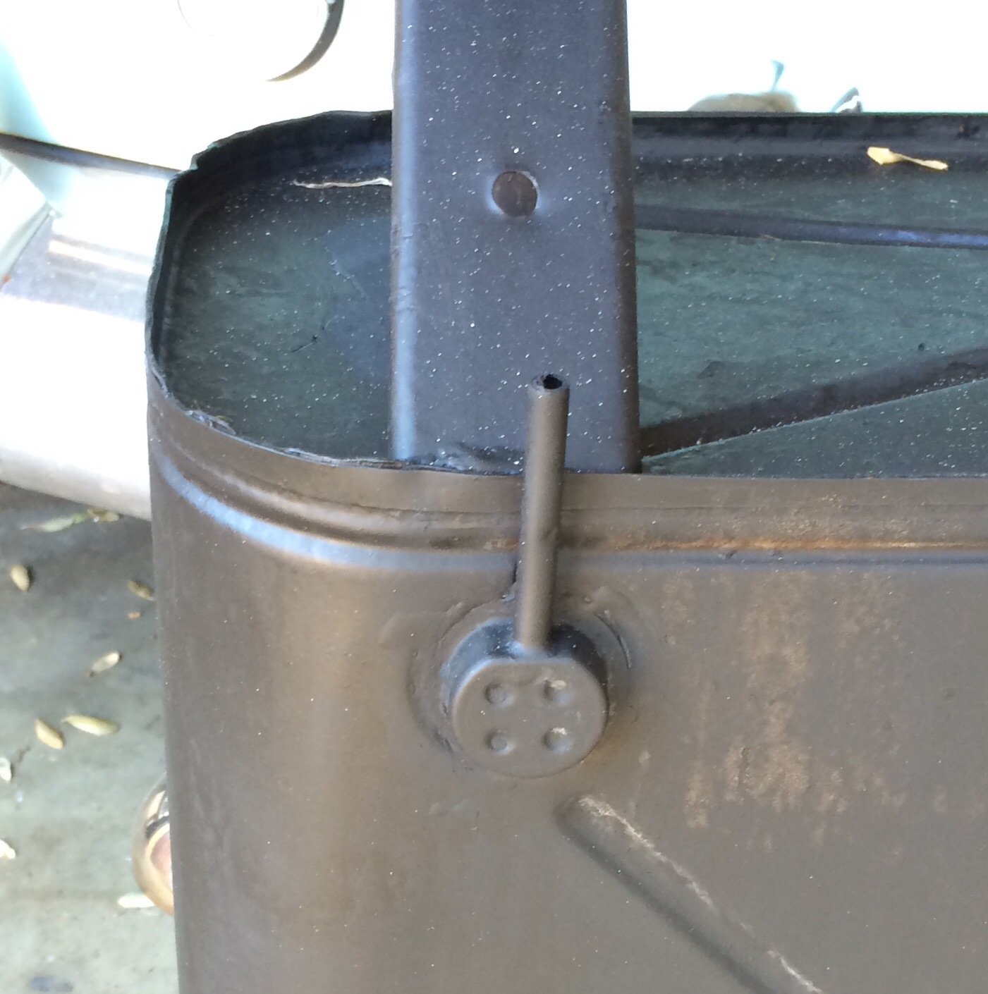

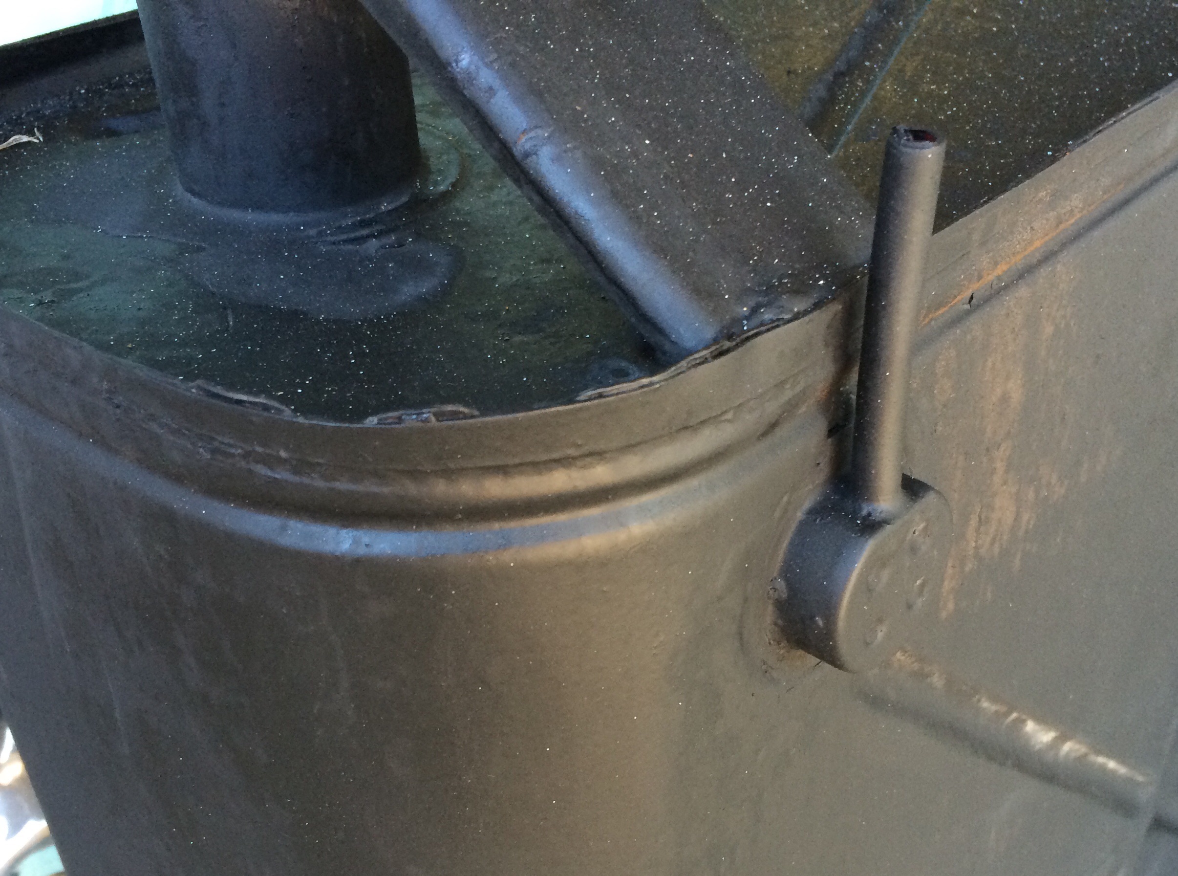

See the pictures...the tube is connected to a burp valve which allows air being compressed by in coming gasoline to escape from the tank. Gas entering at the bottom of the tank pushing air out will fill without backing up into the fill tube. Crushed rubber hose at the frame is the usual reason for air NOT escaping from the tank. Tank sealant can cause the burp valve to stick. Hope this helps.0
