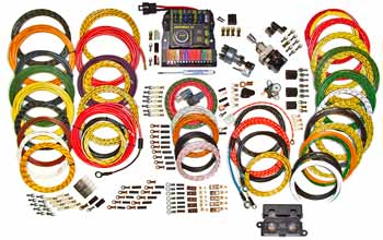

Too much of my wiring was gone. To change to 12V modern fuse system, yet retain the loomed look, I went with American Autowire nostalgia kit. Only challenge to customizing this kit for a Hudson was that all the lengths had to be determined. Any critical terminals were soldered for safety, the rest crimped. Nice kit. Not cheap, but cheaper than any pre-cut kits for 6V. Love the exposed colorful loomed wires under the hood!0
David, exactly which American Autowire harness did you use? I didn't see one that called itself the nostalgia kit. Most seemed to be for Chevys, even the vintage ones.0

I used the regular Highway 15 kit for the '52 Sedan. Easy to install, just takes a little time, if you don't wire cars for a living. I didn't use the "Nostalgia" kit, but the standard one, with the single-color wires. Nice thing about the step-downs, is that the wiring under the hood originally came from the factory not in a loom, but wrapped in black tape, so you couldn't see the wiring anyway. These are great kits when properly installed. Safe, reliable and utilizes modern day fuses.For the '52 Convertible, we went with a YNZ wiring harness for the originality. MUCH easier to install, and if you tell them about any "extras" you have, they wire in the necessary wiring so it's basically hook it up and go.0
