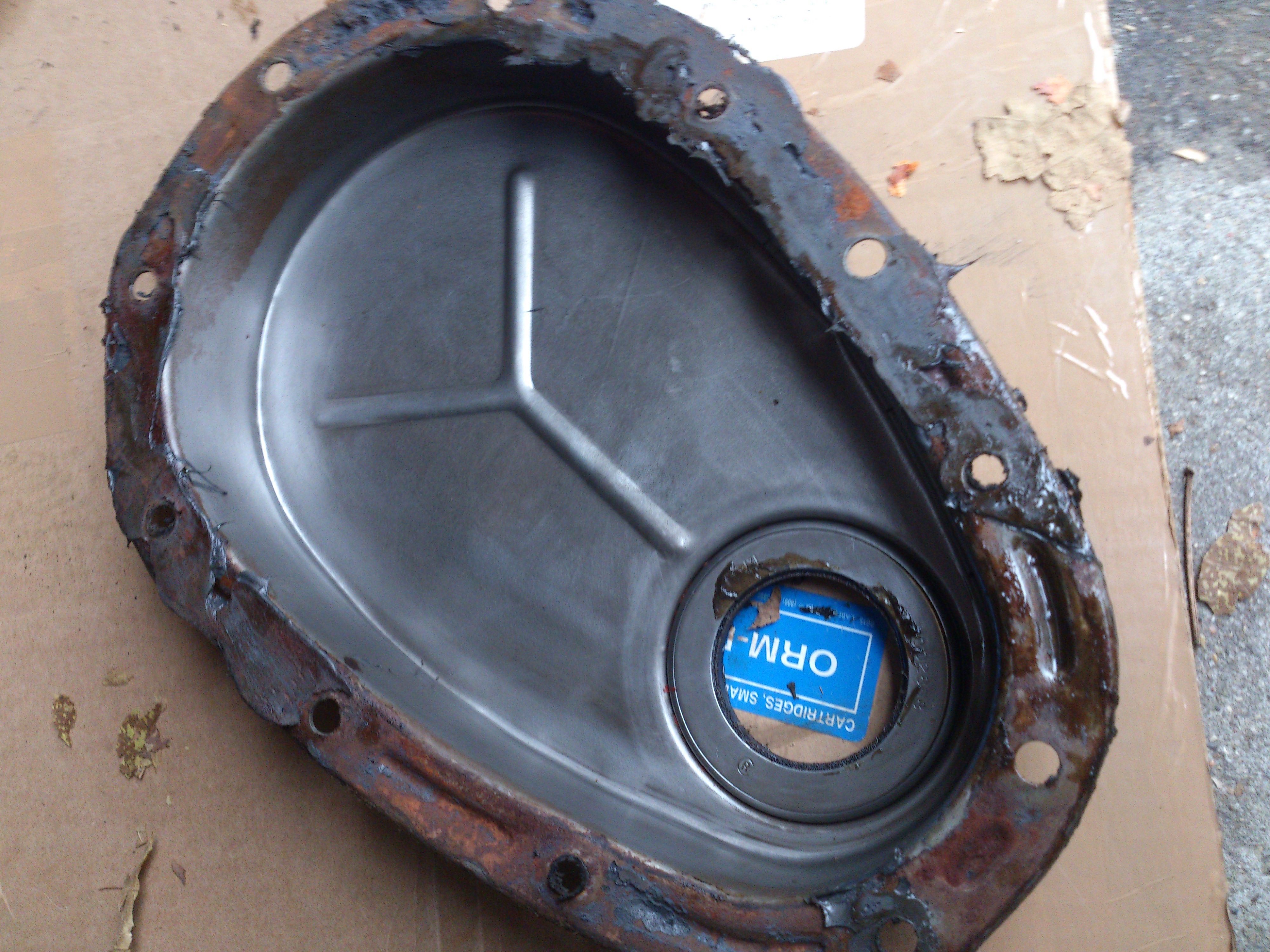

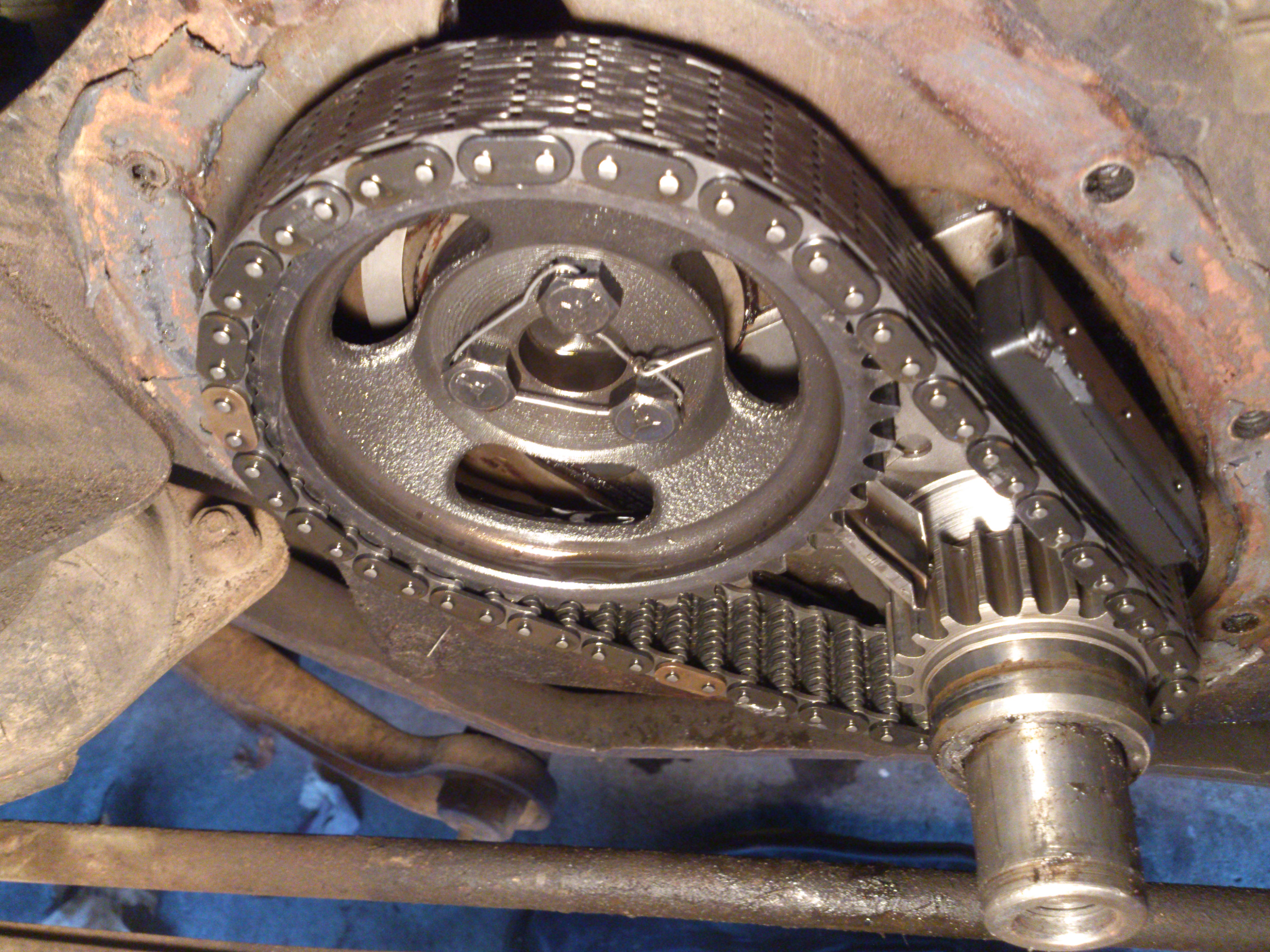

Here is what I found. A timing cover put on with a gasket in a tube... obviously failed and was leaking oil badly. The timing chain and pulleys looked good however. Your thoughts?Thanks-Ray0
Safety wire was put in wrong on one bolt. It should be put in to put pressure into a "tightening" direction.0
Thanks Kerry,I'll fix the direction of the wire on the top bolt before I button everything up. Besides the wire issue am I wrong to assume it looks fine?Thanks again,- Ray0

The Chain appears tight in picture, however, try turning the Crank back & forth 'slightly' to be sure the Cam gear has no delay in movement..if so.replace it because Hudson's were known to wear stock Timing chains prematurely.
(Randy Maas has modern 'Double Roller' Chains that totally eliminates that problem)
I suggest turn the slide on crank 'Spacer' around so that the Seal has a new 'spot' on the Spacer and recommend a National/Timken #450084 Front Seal
