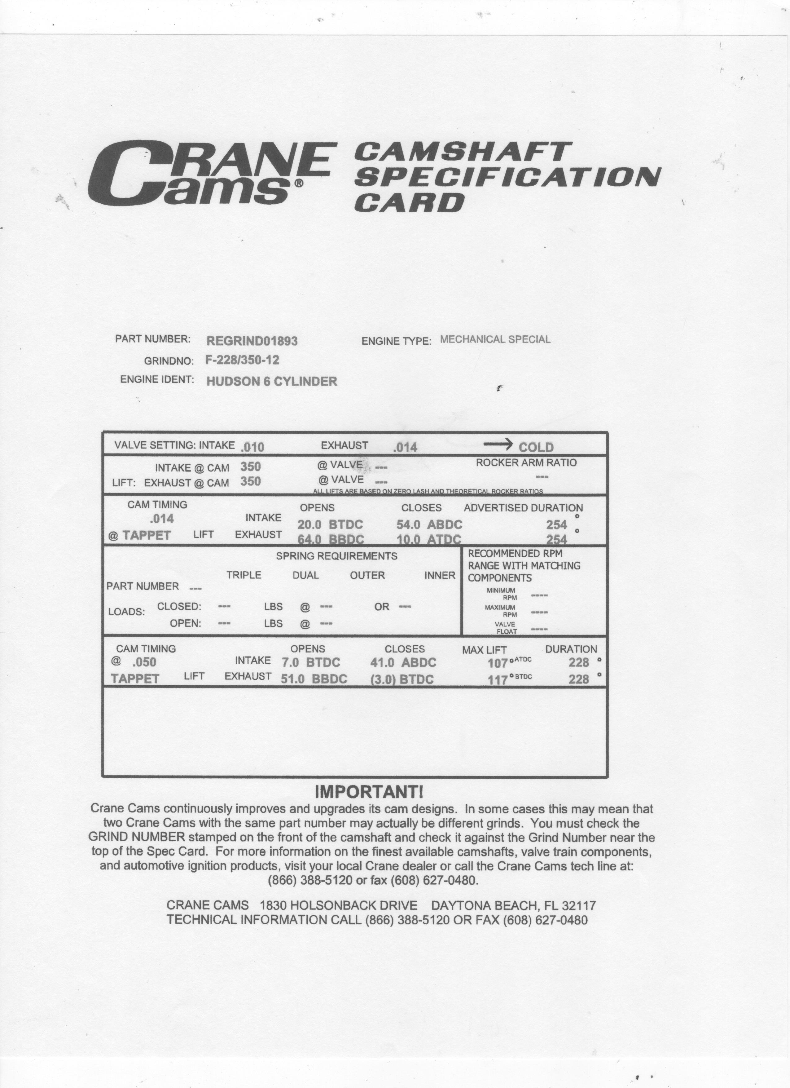

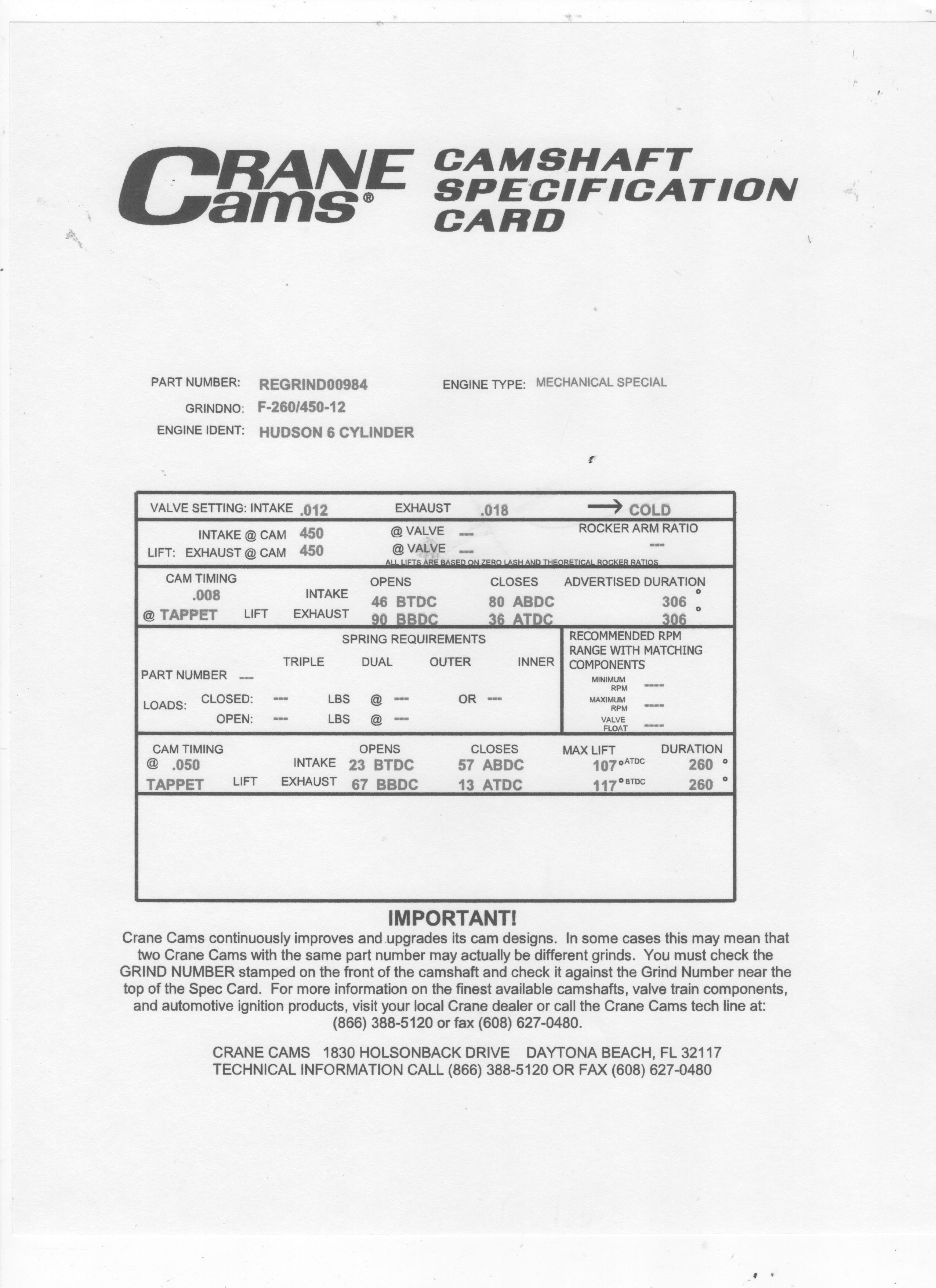

I sent them for re-grind.

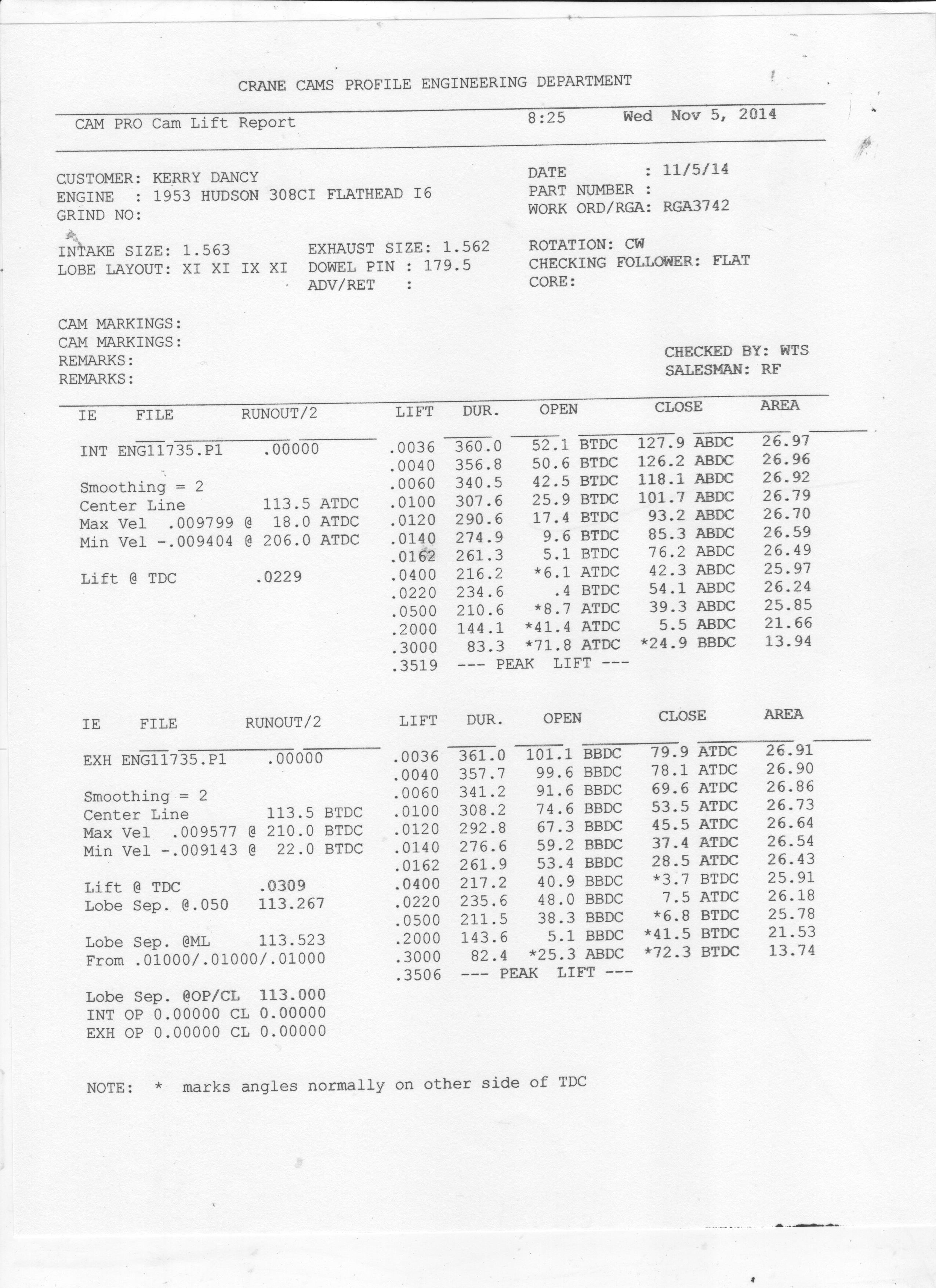

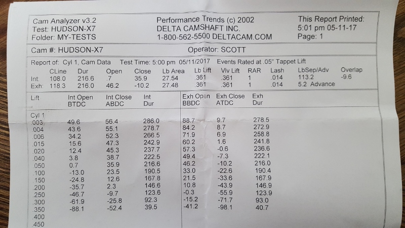

So far here are the Crane results of two Hudson cam profiles and three Crane - Hudson profiles-
Well, that's cool.0
Did they give an advertised duration? I didn't see it.
Lift looked a little smaller than I would have thought.
Bill, this was a factory Hudson cam that I had them to give me it's profile.
That's what I put in my 262 from my 54 308.
I didn't see the advertised duration listed and they didn't do a duration @ .050 like most cams are listed.
Just trying to get an idea of it's size.
Bill, I added to the first post and also sent Robert a note for more info.

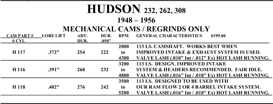

These are the cams that Randy has listed.
1955-1956 Mechanical Cam: 372 lift, 254 duration
Super 7X Cam: 391 lift, 268 duration
Super Street Cam: 402 lift, 276 duration
Race cam is Isky: 446 lift, 280 durationI assume the 55-56 cam is based on the 742/040 cam.

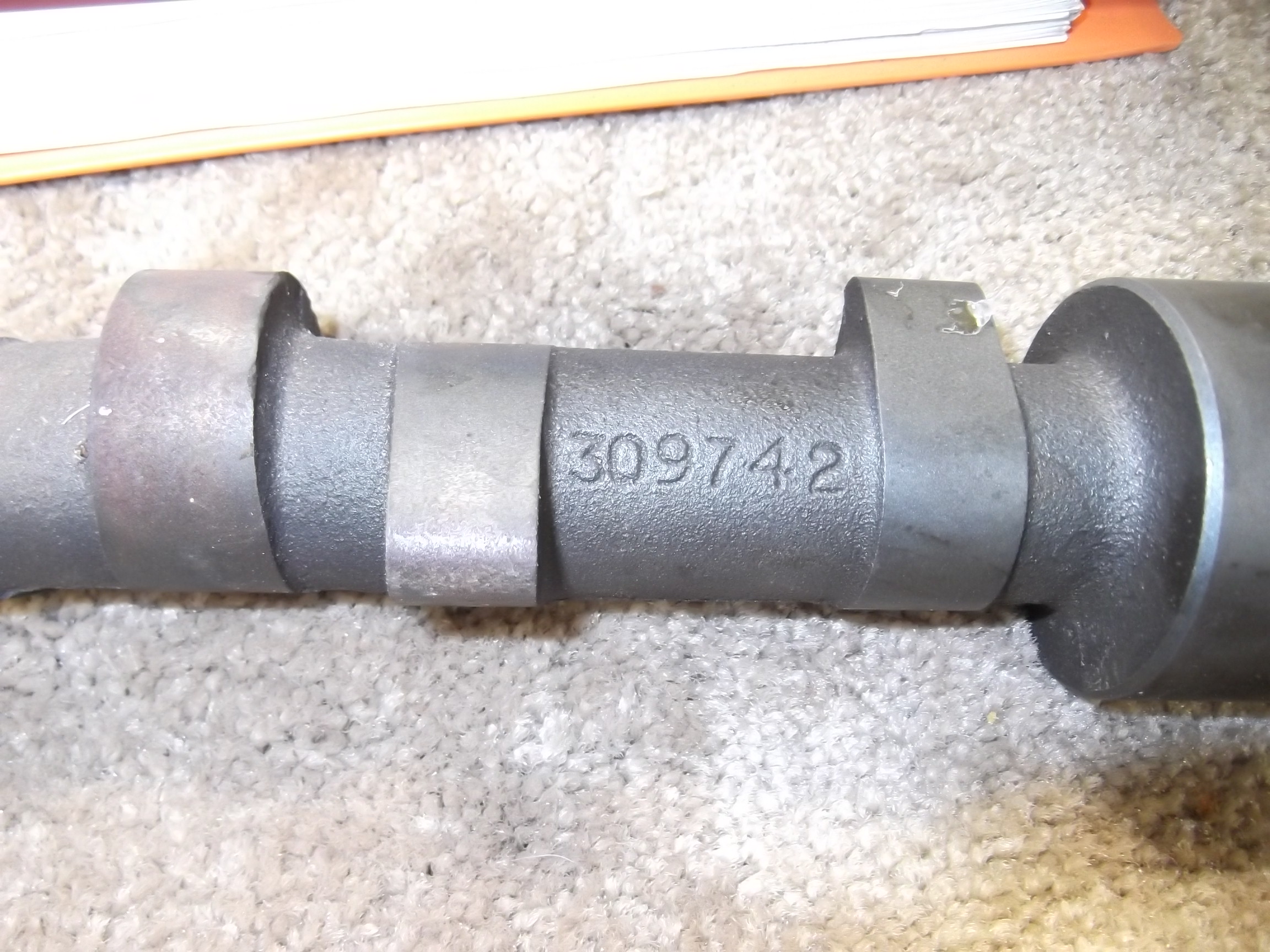

Not all #309742 Cams are alike.I understand that Hudson utilized their stock pile of 309742 Cam Blanks for the '55 & '56 Motors grinding 'Hydraulic Ramps' to utilize Hyd lifters because of tight Nash inner fender wells & Suspension.....
Grinds for the '55 & '56 #309742 is also milder than the earlier Cams that did Increased Performance. Additionally, I read that you should Not use Solid Tappets on the '55 & '56 Hyd Cams.
I believe Ivan Zeremba did the earlier research by having several #309742 Cams profiled discovering all the differences between them then he Posted the results on the old Forum....Im not sure if its accessable now.
I understand the only way one can tell the real Performance #309742 Cam is by its 'Flat Top'....
added more info to first post--

Here the specs of my regrind.
Started with a 742, this is supposed to be a super 7X GRIND.
I'm still trying to wade thru the numbers to decide what it's close to.
