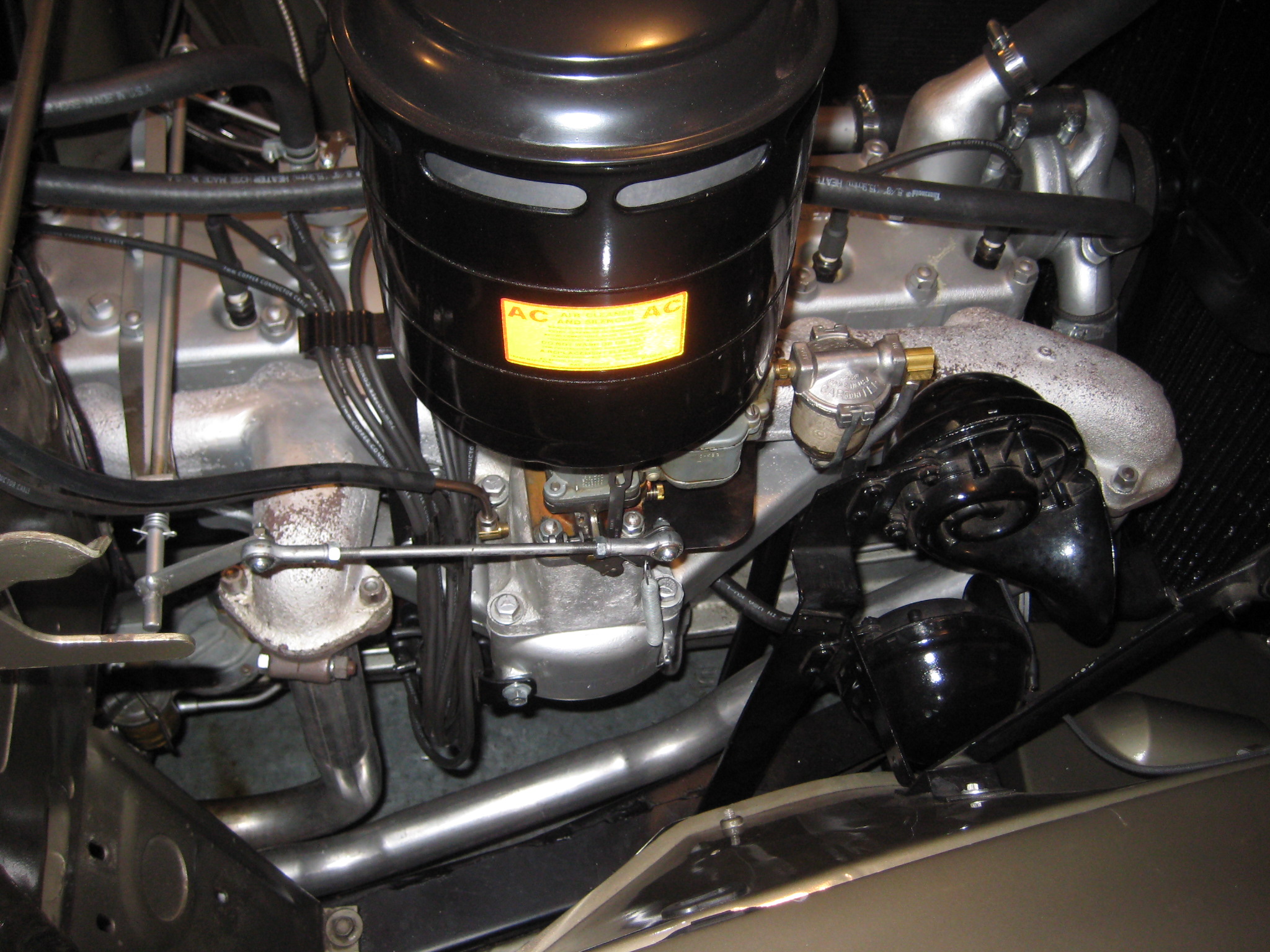

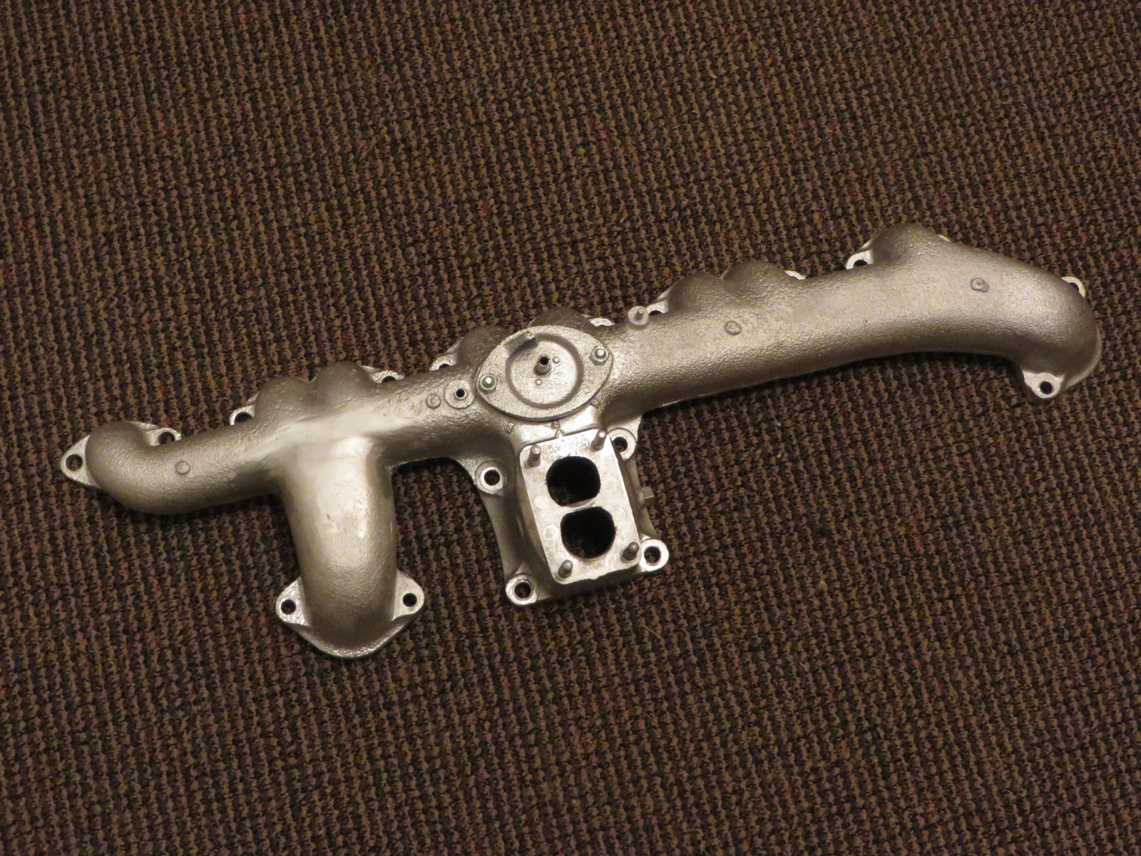

You're correct Frank. There are a couple of dual intakes for the eights, but I don't recall anything on the exhaust side except for one-offs as I had made for my '47. Keith, this manifold is available, by the way. I just finished removing it since I'm selling the car and figure some potential buyers would want the engine compartment as original. Photo on the left below was taken a couple of days ago. Email me if interested . . . hetpwald@comporium.net. (remove het for actual address).0

Will it fit my '50 Commodore?Email sent...k0
I'm sure Park could tell you better, but there's more room in a step down than there is in a '47.0
That fuel pump is hard enough to reach! Bet it sounds good though.0
