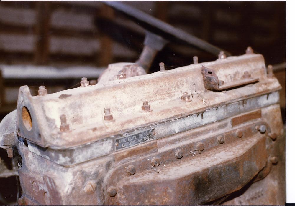

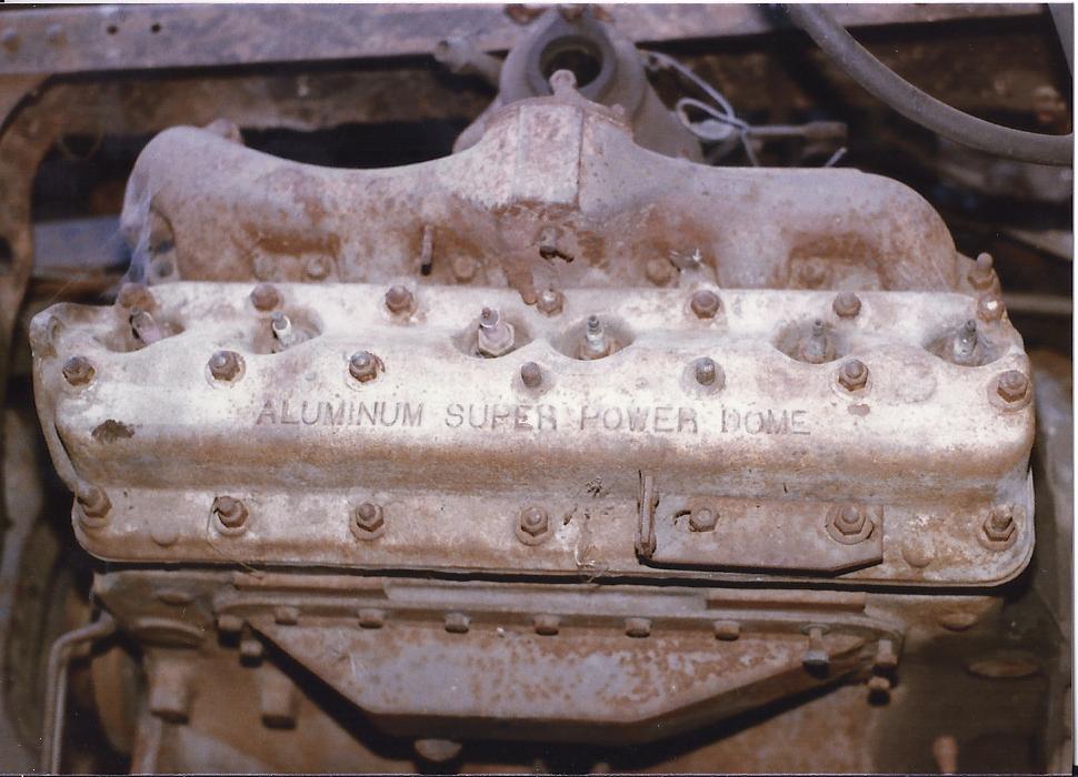

There were "sandwich" high compression cylinder heads available for the '34-35 six and eight cylinder heads. Either head had top and bottom halves with a gasket in the center (besides the standard gasket from bottom of head to block) Higher octane fuel was required due to the higher compression and a brass tag riveted to the head made owner aware of this. Top of the head was cast steel. Yes it is an oddity that the steel top bears the words "ALUMINUM....". Bottom of the head was cast aluminum by Bohnalite Corp.. 6 cyl head is illustrated.

I've heard of those but first time setting eyes on a Hudson head like that. Thanks for sharing photos.
