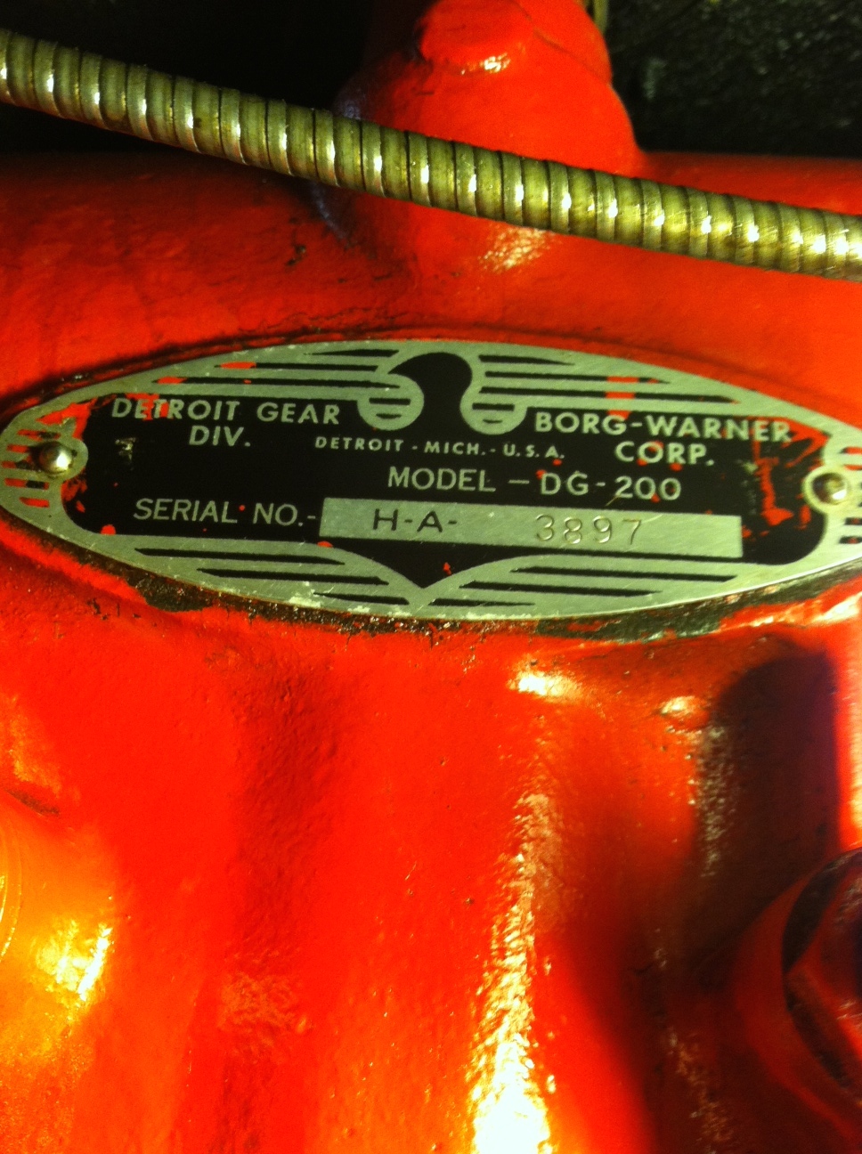

From another post.
When taking my car to the trans shop in Jan of this year, I said it has a B & W Trans in it. They said what?
This is after spending a bunch of money at another trans shop 2 years ago, that also said "what"? so I had to do my research, as I had ordered the original parts from them in the first place. These people are the gurus of Borg Warner transmissions. Any year.
My trans model DG-200
Northeast Transmission
Winchester, Ohio
938-442-2811
Also Fatsco Transmission in New Jersey.
800-524-0485

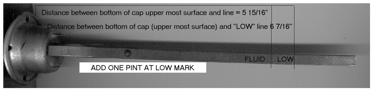

Oh BTW, I have a recall notice from Hudson which discusses a change in the dipstick for the BW. It seems the first ones starved a bit for fluid. I have a replacement dipstick and the full mark is a bit higher, So apparently there was a problem and it was looked after. Maybe this is why the BW has a bum rap
