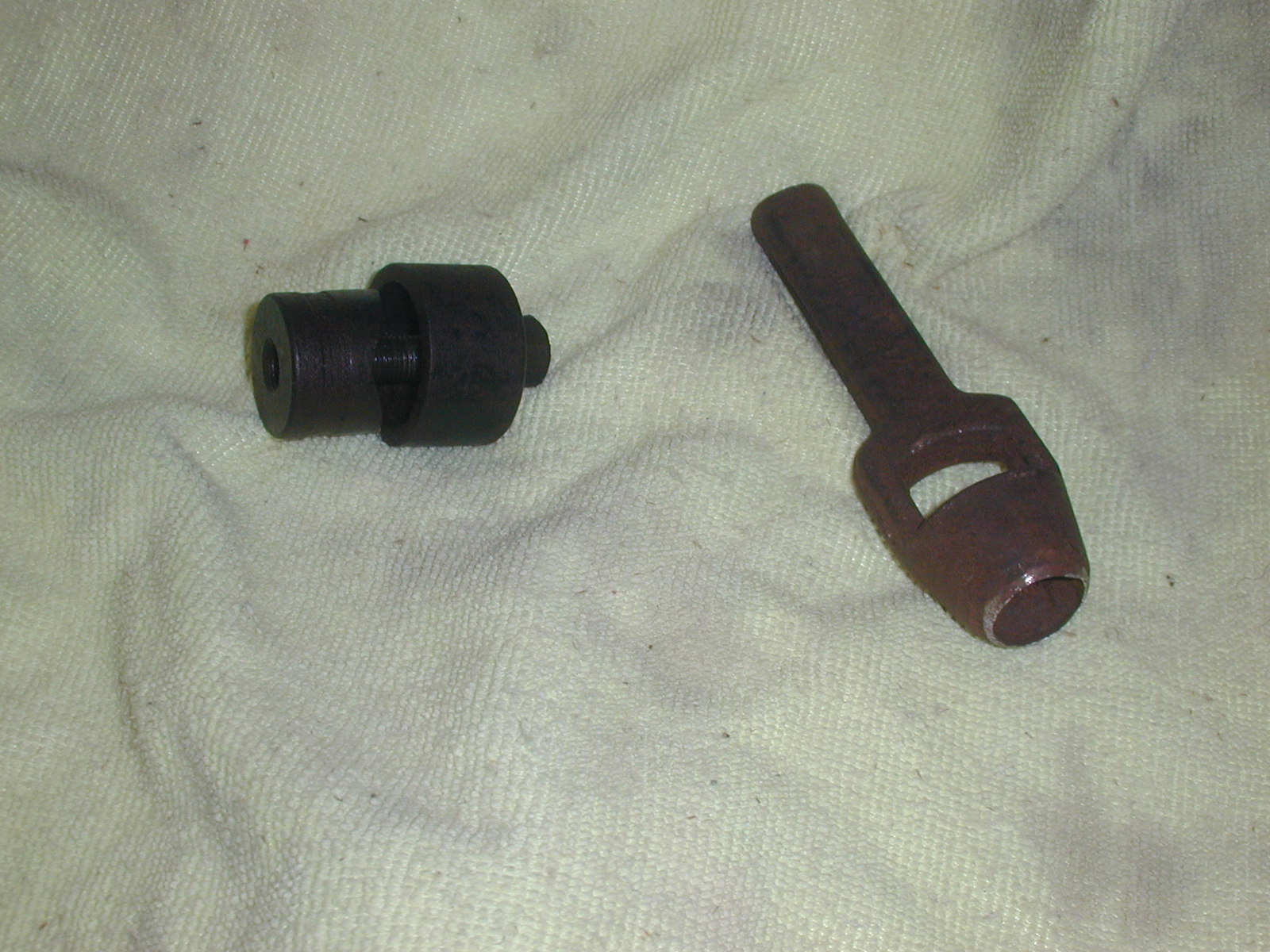

If you can find a leather/gasket punch of the correct size , or an electricians chassis punch. they will make a neat hole.
The one on the left is used by electricians to punch holes in junction boxes and in to radio chassis when they used vacuum tubes ! Yes I used it for that "back in the day".. The leather or gasket punch on the right has been in my tool box longer than I can remember.
I have a snap-on gasket hole punch set that should work well for the holes but the box cutter method is not my favorite way to cut out the rest of the shapes. I wonder what the pros use. I will both methods suggested and see what leaves the cleanest edge.Thanks for the tips.
