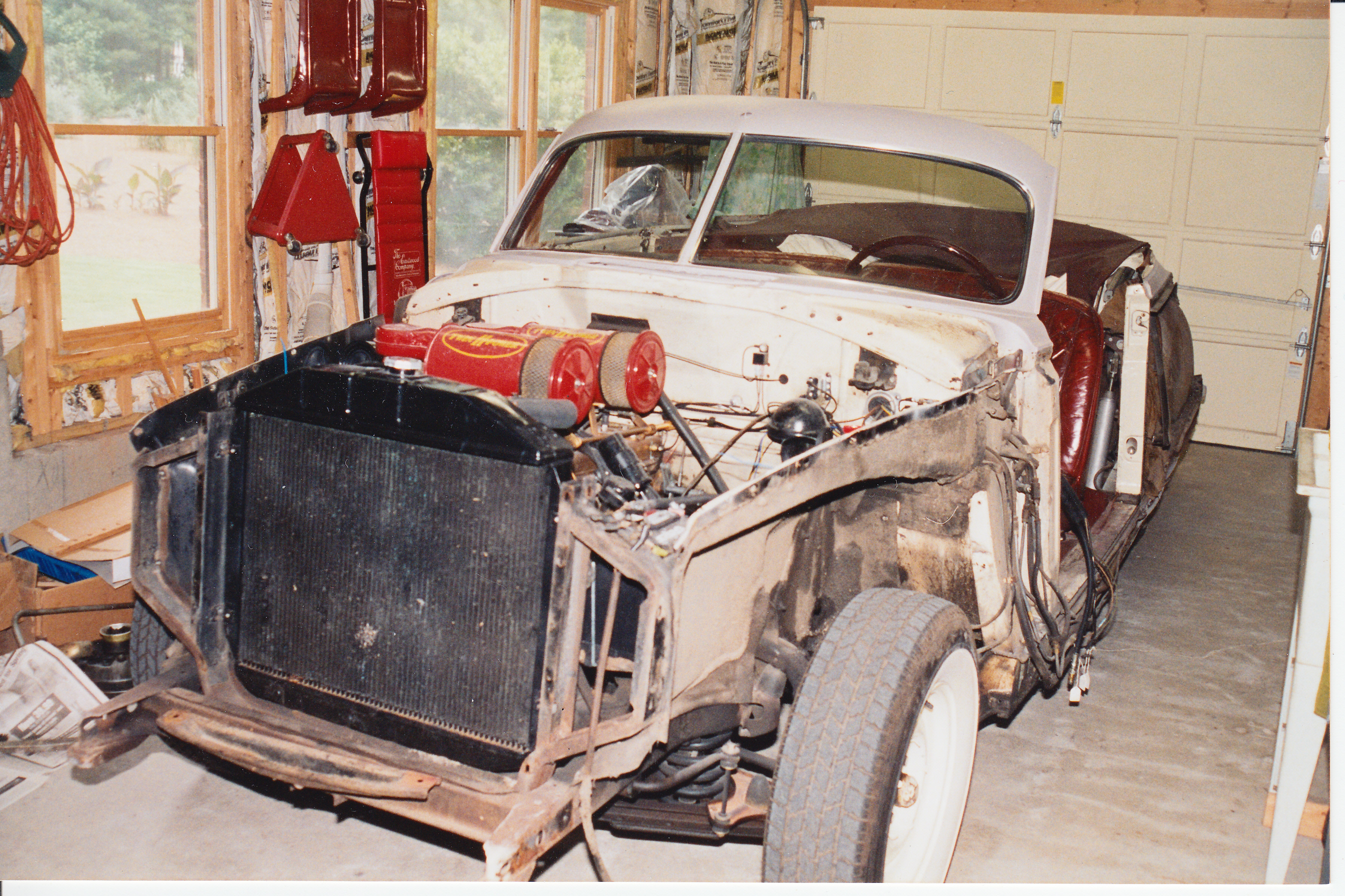

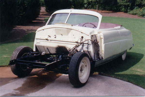

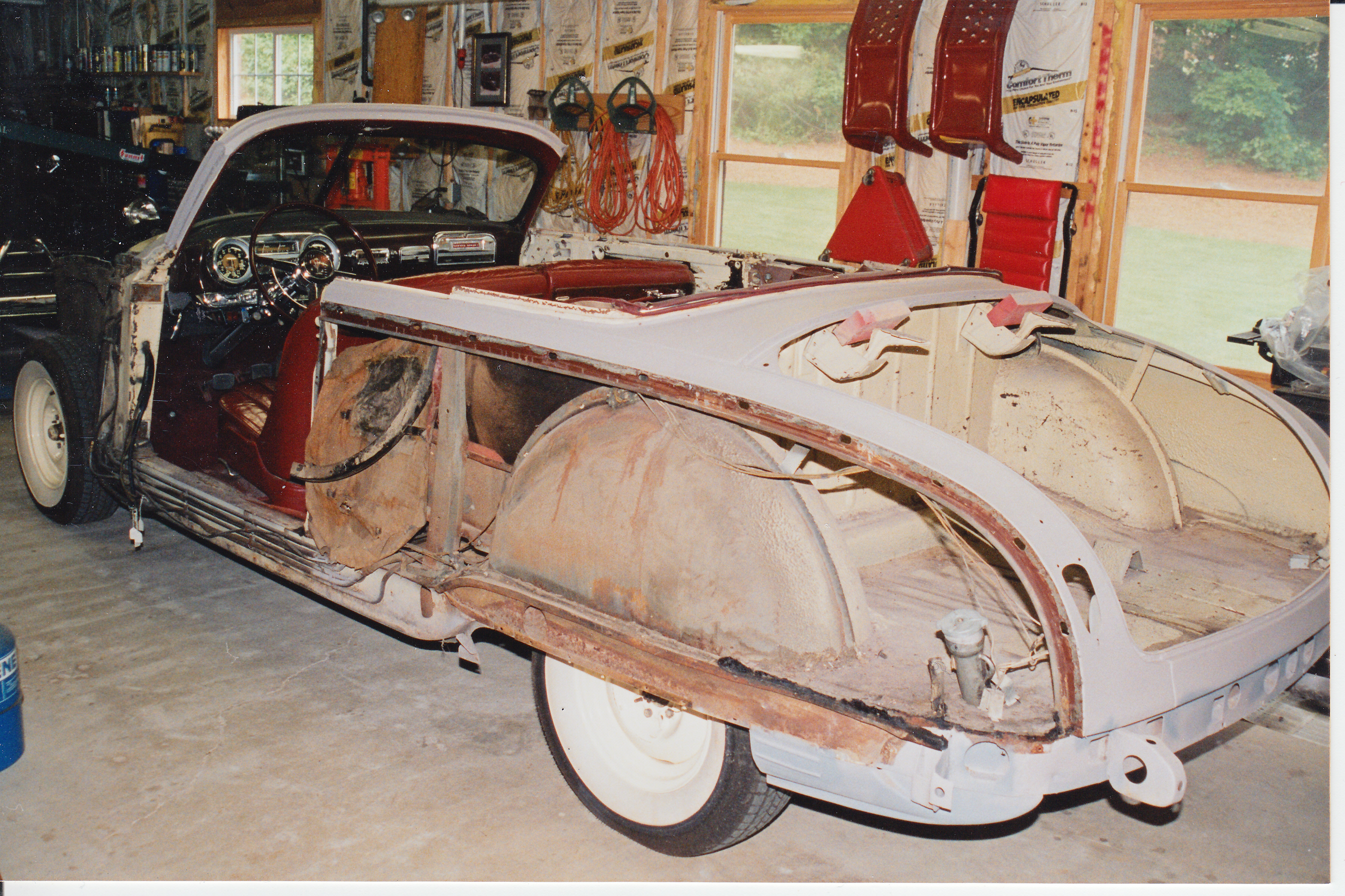

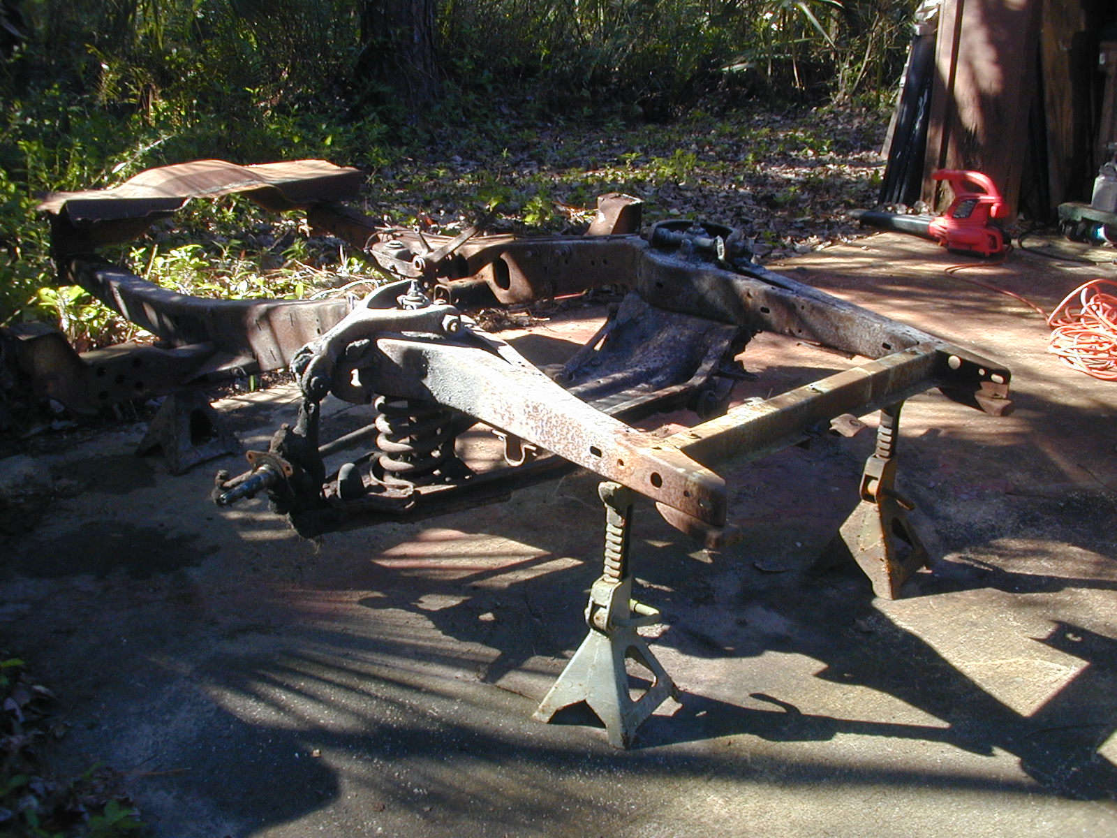

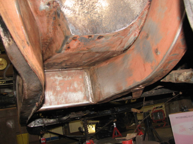

Here are a few pics of my Pacemaker Convertible FrameRob0

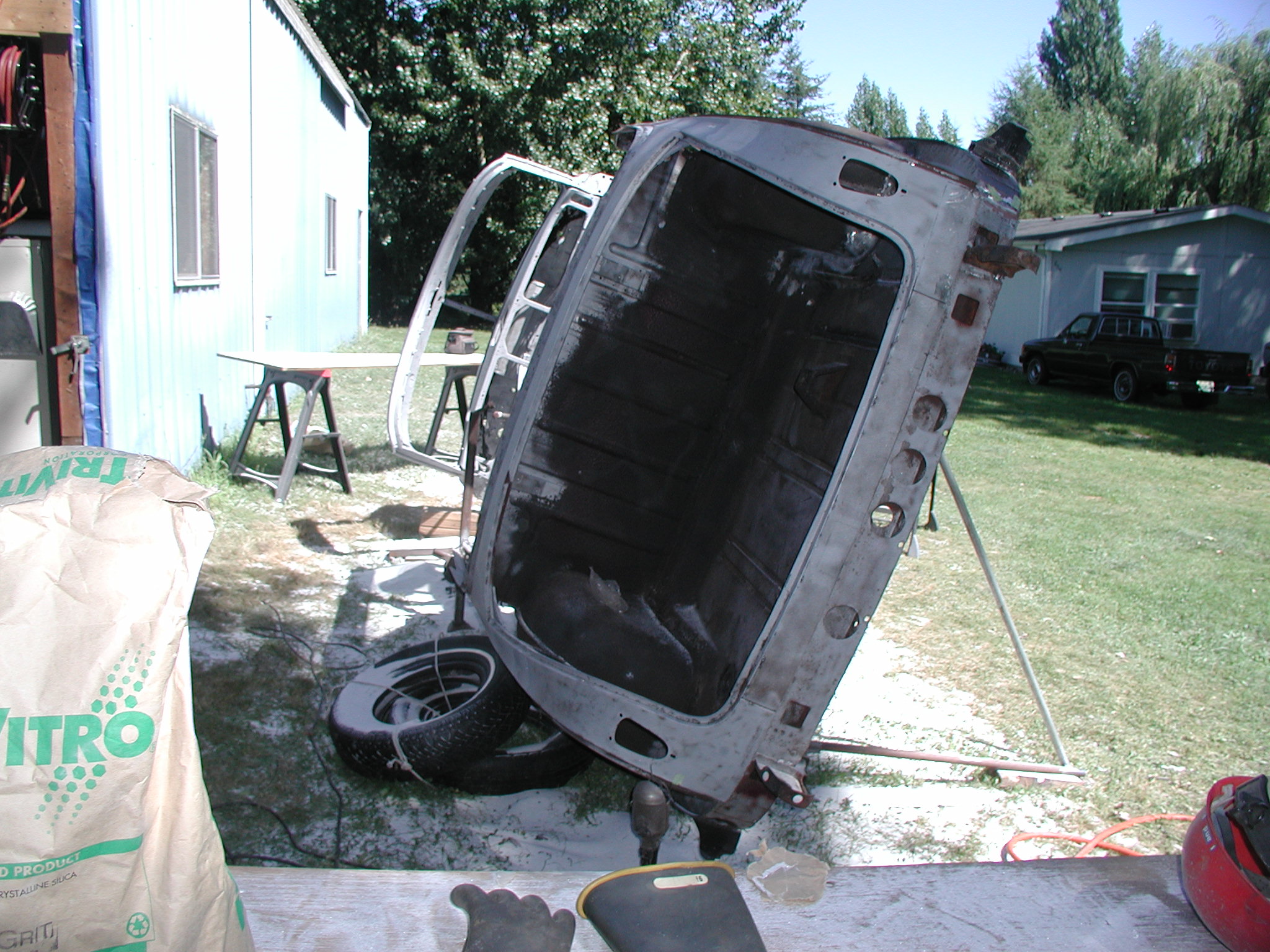

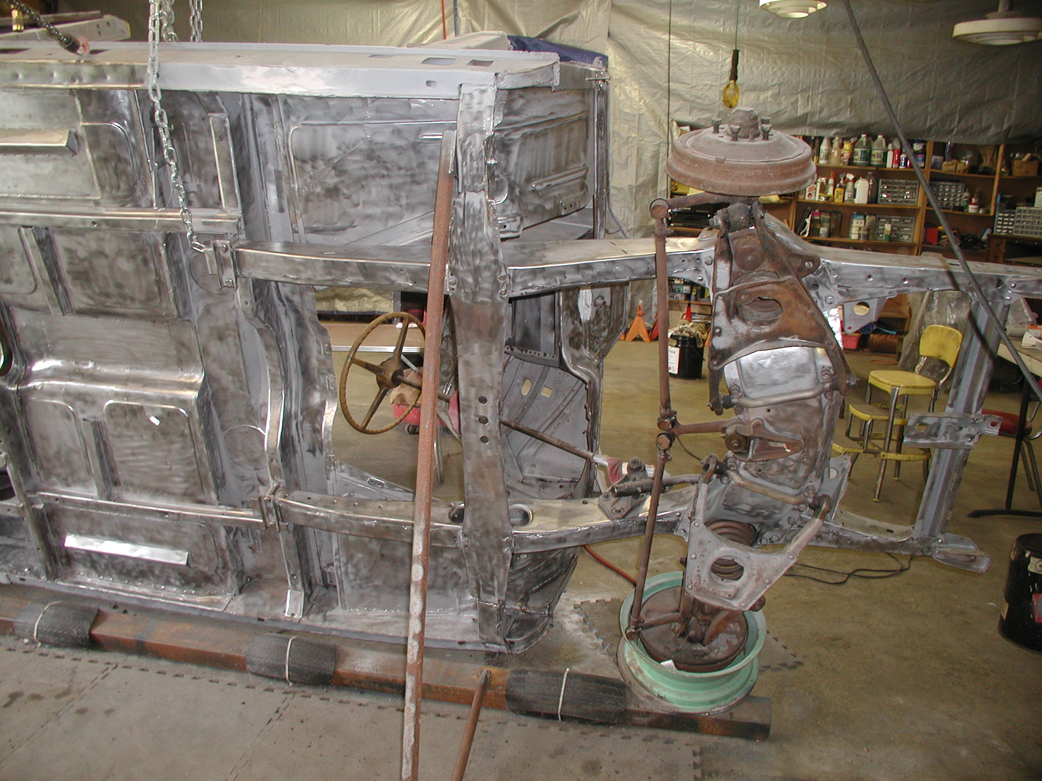

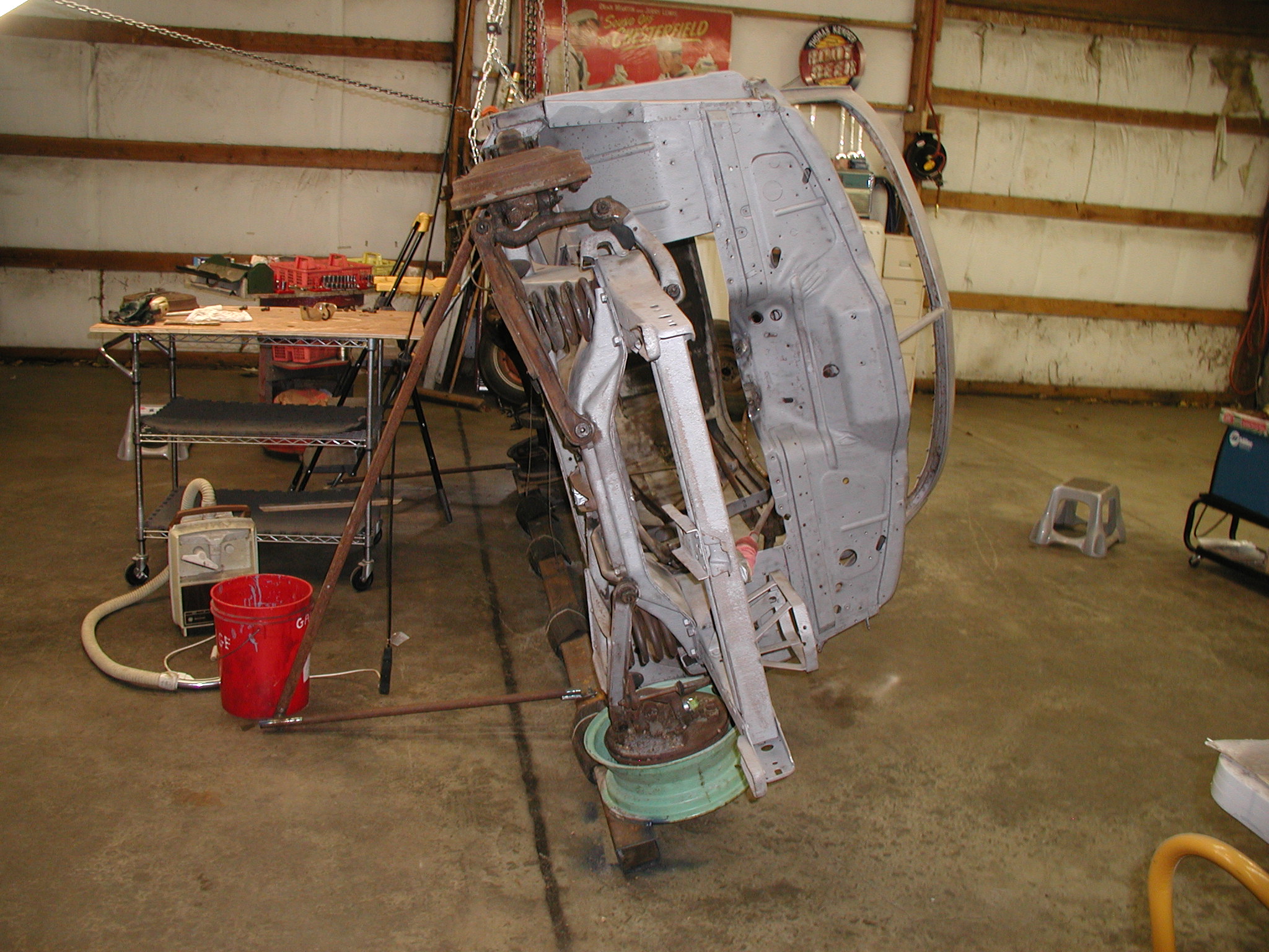

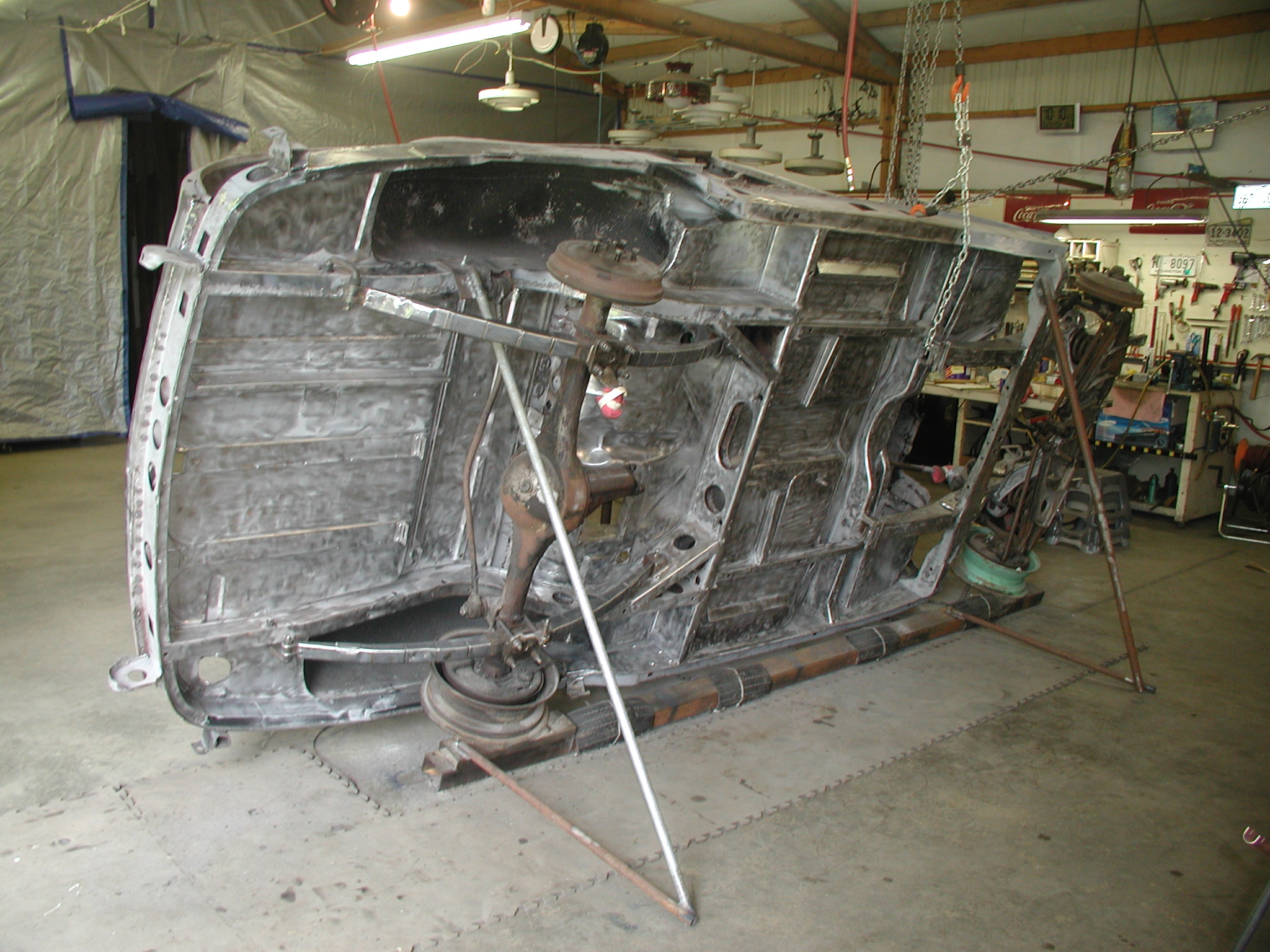

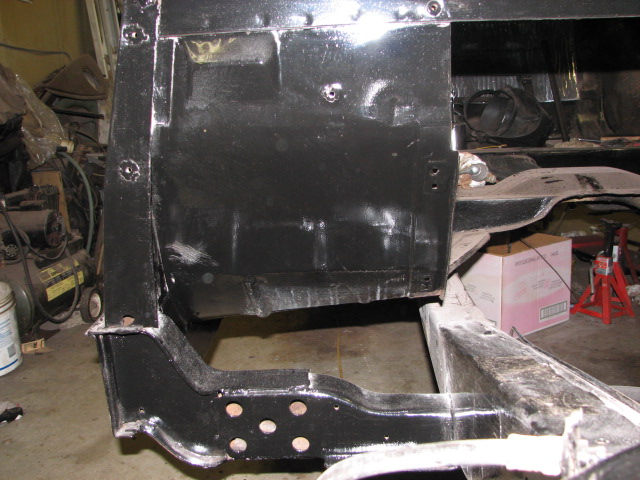

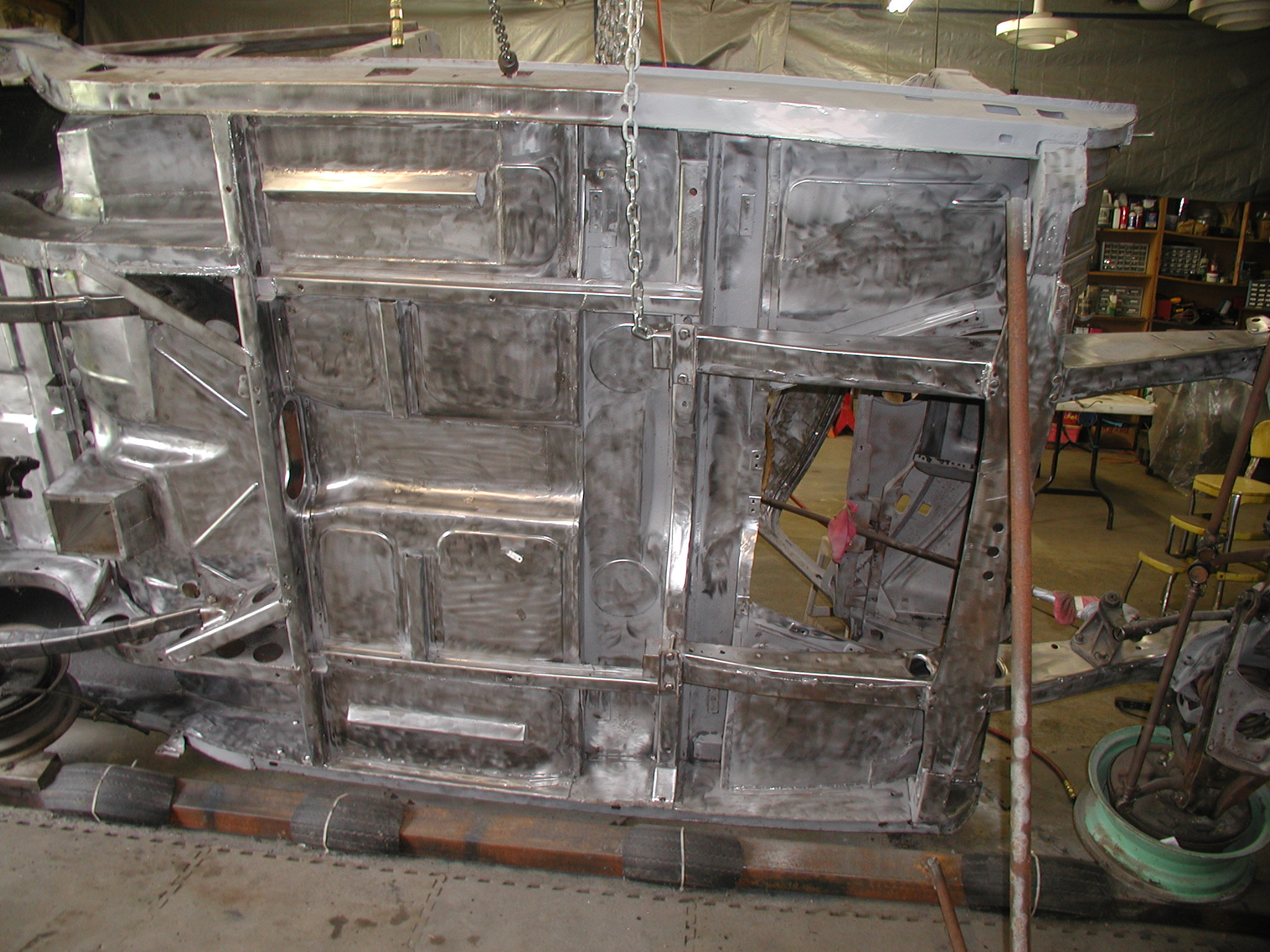

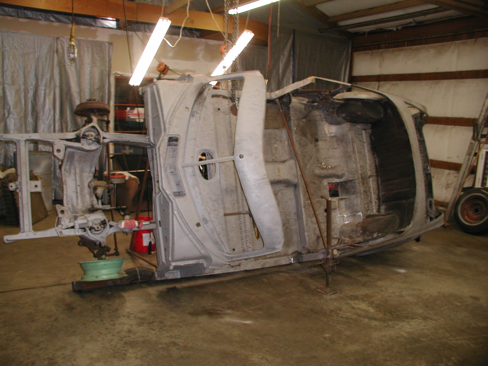

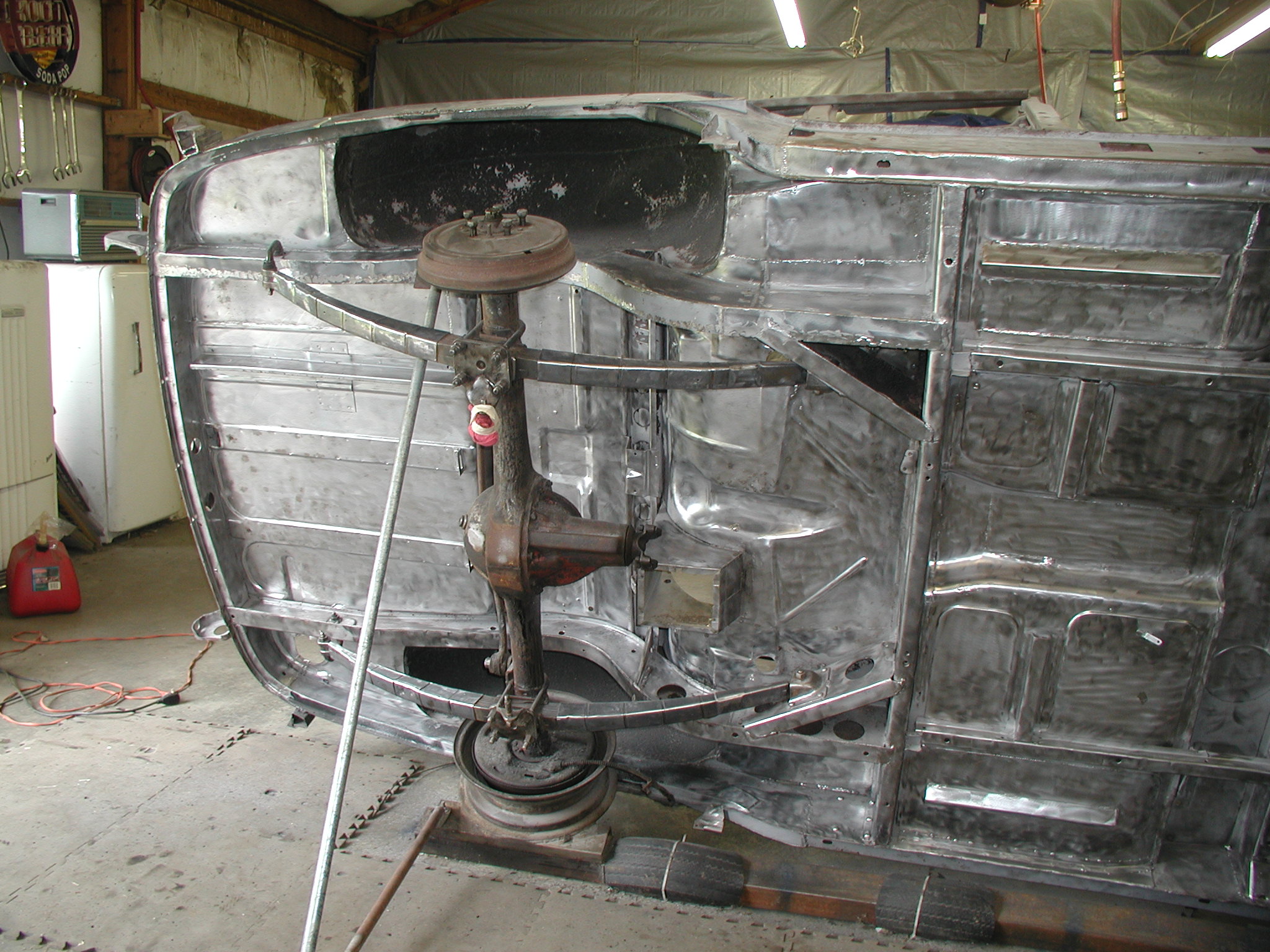

Here's a shot that shows some of the structure. Taken 2002-2004 when mine was undergoing major teardown/rehab after getting sideswiped. Posting more below.0
Here are a couple more. Obviously there's some convertible-unique structure shown, but you can get the general idea.0

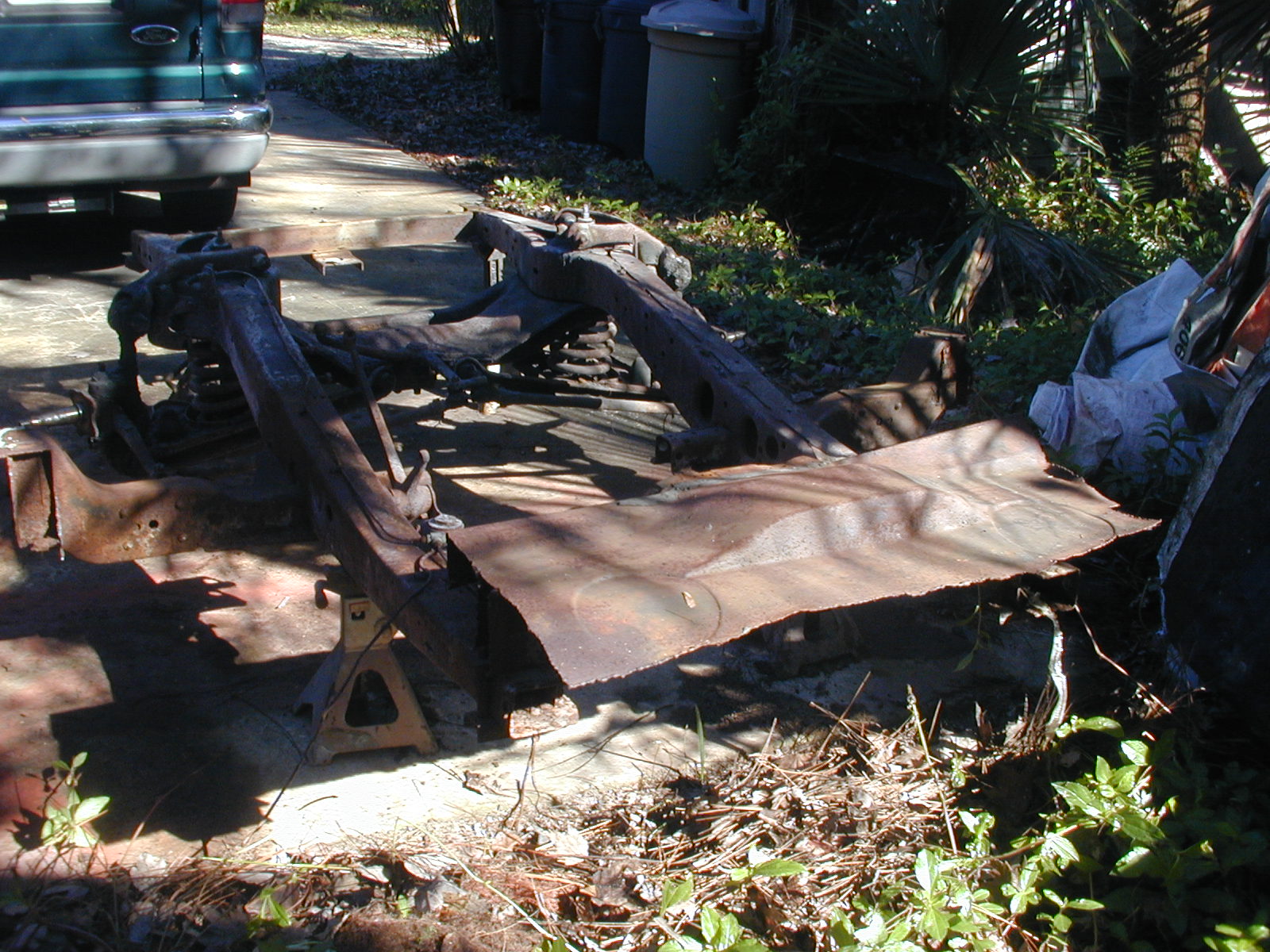

Here is what is left of a 51 Hornet sub frame. Round indentions in the sheet metal is where the under seat heater would be mounted.0
