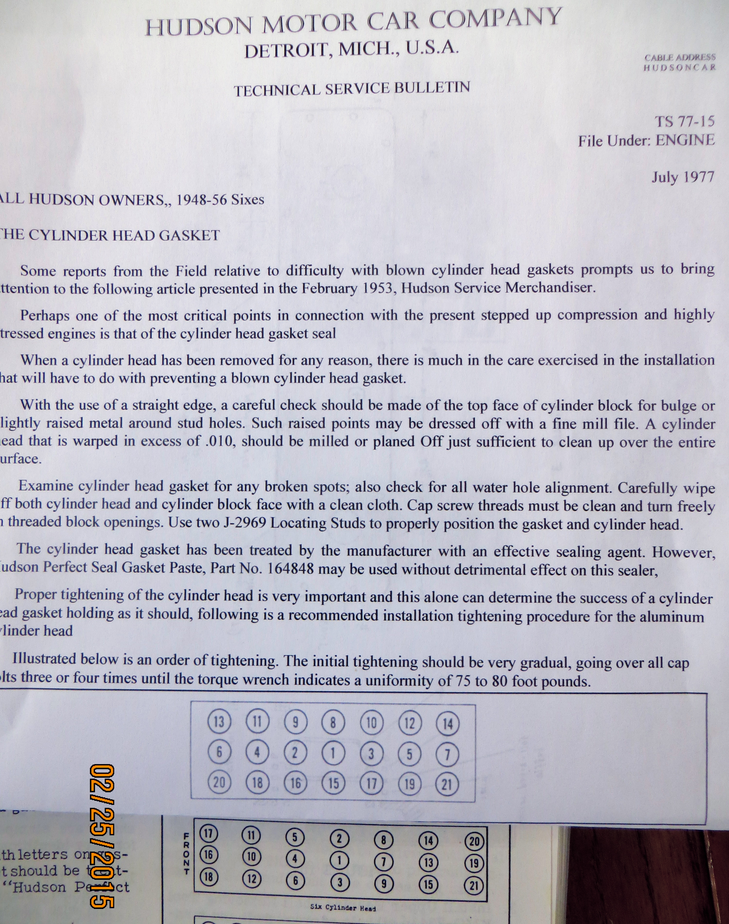

I came across a Technical Service Bulletin that shows a different chart for tightening the head down than the factory manual chart.
Does anyone know if one is better than the other.
It starts off All Hudson Owners but later talks about the Aluminum head.
I want to use the best chart for a 48 iron head.
Thanks

Walt Mordenti uses this pattern to tighten his cylinder heads with success for all 6cyl 48-54 This information come out of Walt's Hudson Tech Tips book Volume 1
carburetor side
21 14 6 2 8 12 19
16 11 4 1 5 10 17
18 13 9 3 7 15 20
distributor side
With 7/16 bolts tighten 40. lbs., then 50, then 65
With 1/2 bolts tighten 50 ft. lbs., then 65., then 80, then 95. You will notice that the 1/2 bolts or studs require four steps.
An important part of this job is waiting at least 15 minutes between each step. Once you have started torqueing the cylinder head do not stop until the job is complete(i.e., don't allow any interruptions like answering the phone or talking to friends). .
After you are done torqueing, run the engine until it is warm (or at least 1/2 hour), then let it sit for 12 hours. Now set your torque wrench to two (2) ft. lbs. above your last setting and re-torque the head
Any questions contact Walt

Correction: Torque pattern for all six cylinder Hudsons
I missed adding that note under the diagram.
There is also a torque pattern for all eight cylinder Hudson in Walts Tec book.
Lee O'Dell0 -
Thanks LeeThis now makes 3 different charts for the big 6 so I quess any of them will work.0
