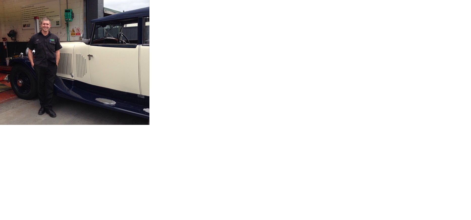

I am a vehicle inspector in South Australia although I originally come from Scotland, I arrived in Australia in 1998.
I have just had the pleasure of working on a 1930 Great Eight which belongs to Heidi Hetzer who is driving it around the world and as I needed some info you guys were the obvious choice

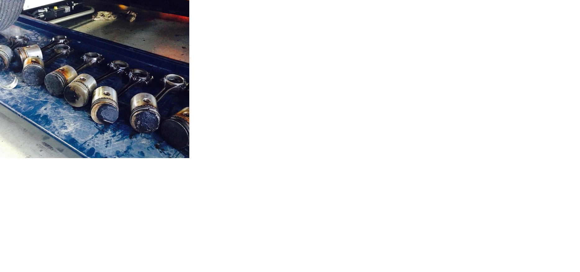

Turns out Heidi's engine is no more

Many of these photos are apparently taken at the car restoration shop that is now bringing Heidi's 1930 Hudson Eight back from the dead. It had suffered a number of seat-of-the-pants fixes in countries where "1930" and "Hudson" are completely foreign concepts! Anyway, here is her "english" website:

Half way across the Nullarbor Ms Hetzer noticed the car had begun to blow smoke and use a lot of oil.
By the time she had arrive in Adelaide she was burning about five litres of oil per day and knew her treasured car was in a little trouble.
"So far I have driven about 30,000 kilometres – this is a lot for one old engine," Ms Hetzer said as she stood next to the Hudson, resting in an Adelaide mechanical workshop.
Both are now temporarily halted in Adelaide until the car is transported to Melbourne where a new engine will be fitted.

Photo The 1930 Hudson at a standstill, waiting for engine repairs after cracks were found on two piston heads.
