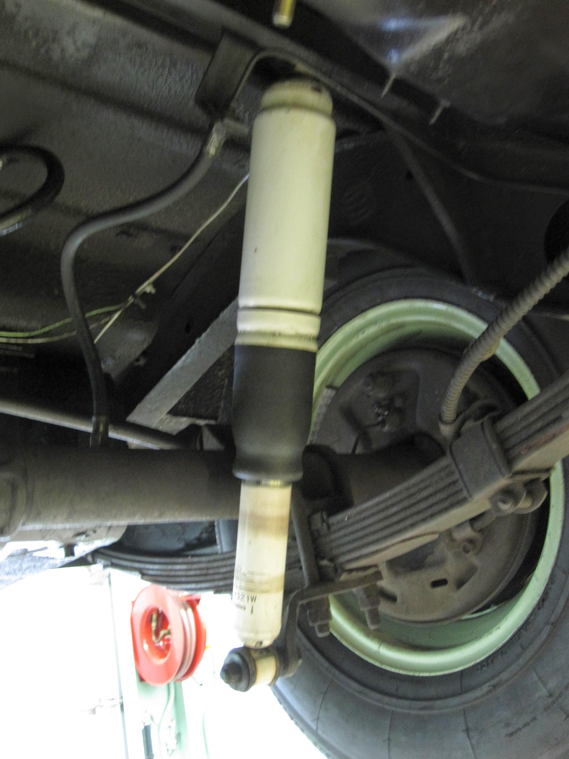

I have Monroe Max-Air shocks on the rear of my 1953 Hornet; the number is MA727.
The tech number at Monroe (Tenneco Auto) if you want to check your application is 734-384-7809.
These are PUMP-UP SHOCKS with an air valve behind bumper {or you could connect compressor if you wanted to.}
Here is photo of one.
The one with the air shocks in the rear:
