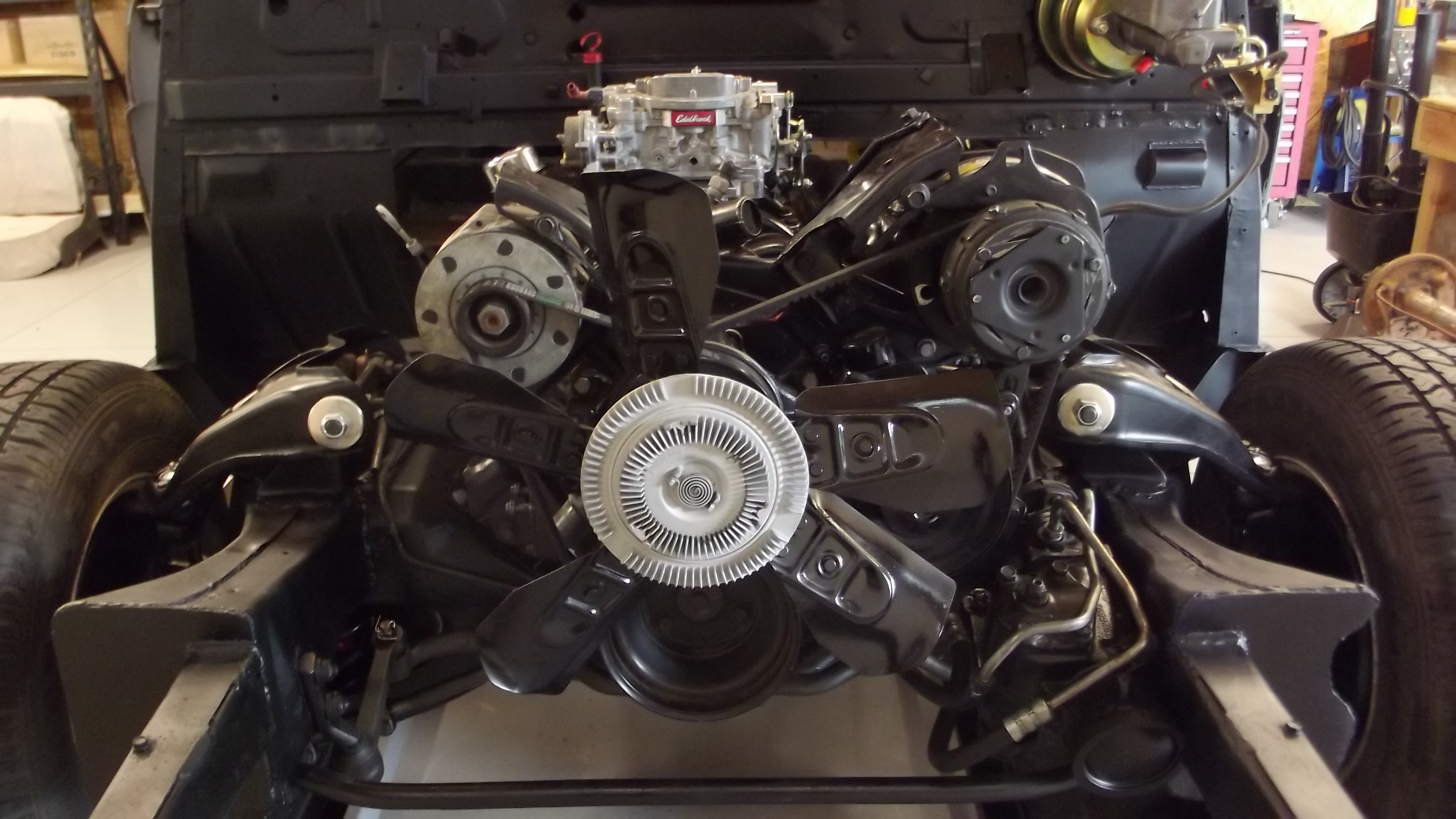

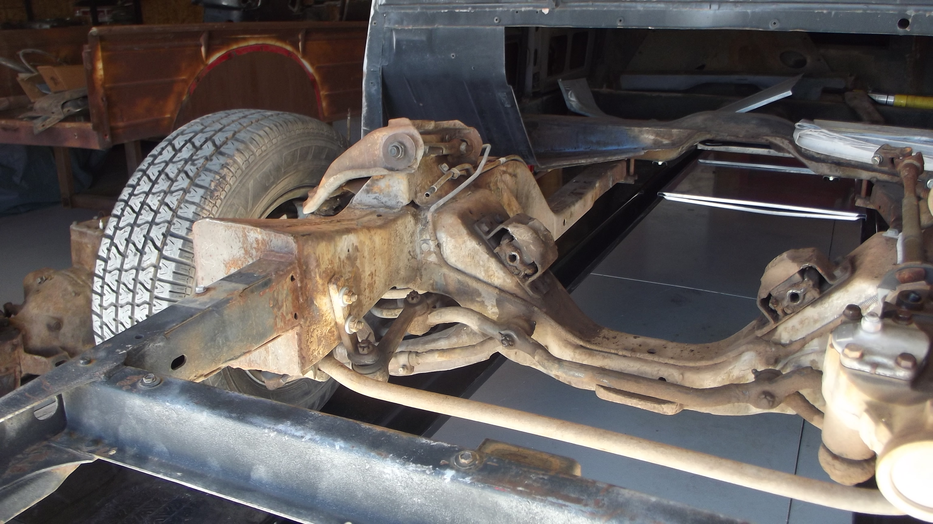

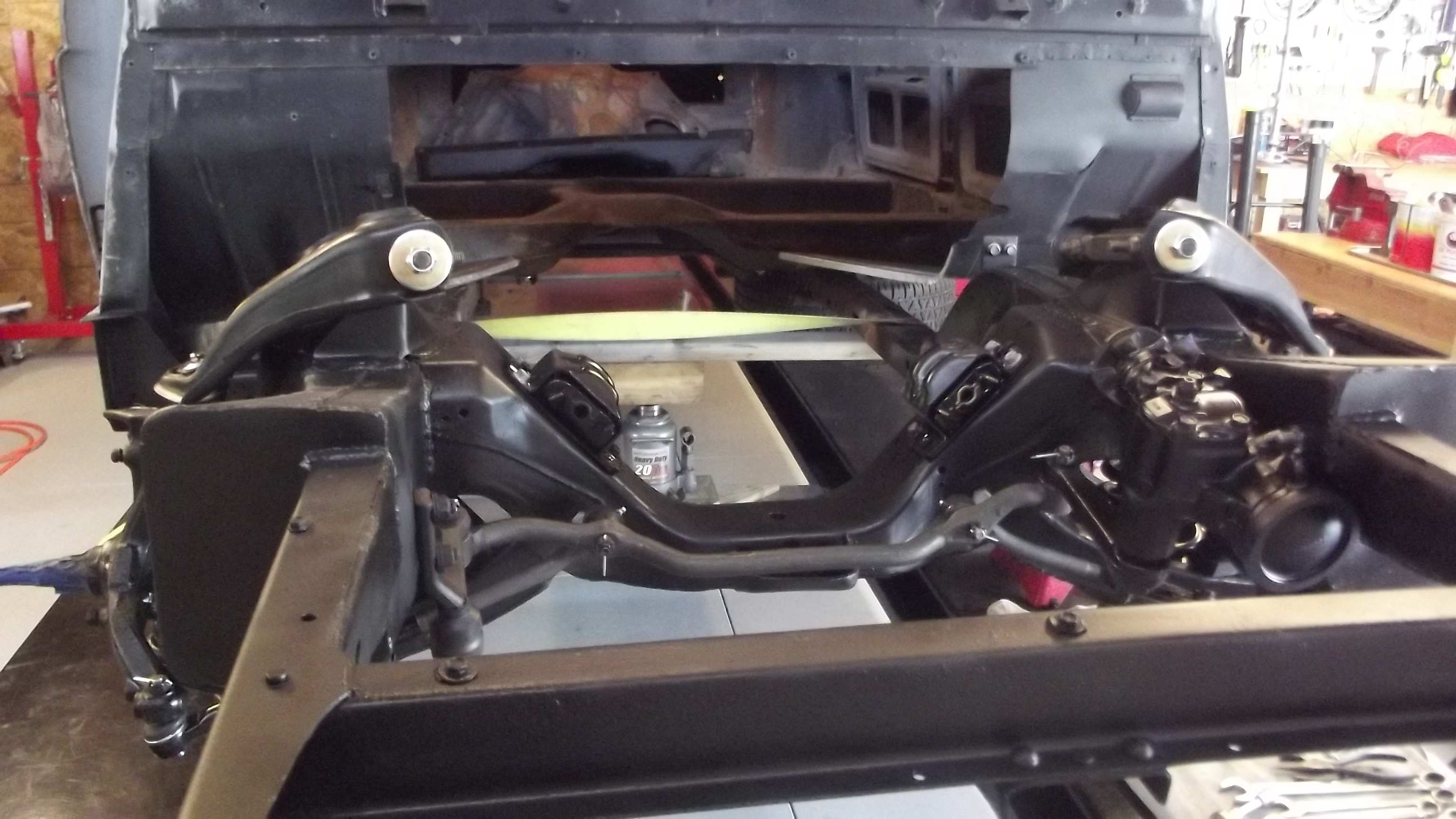

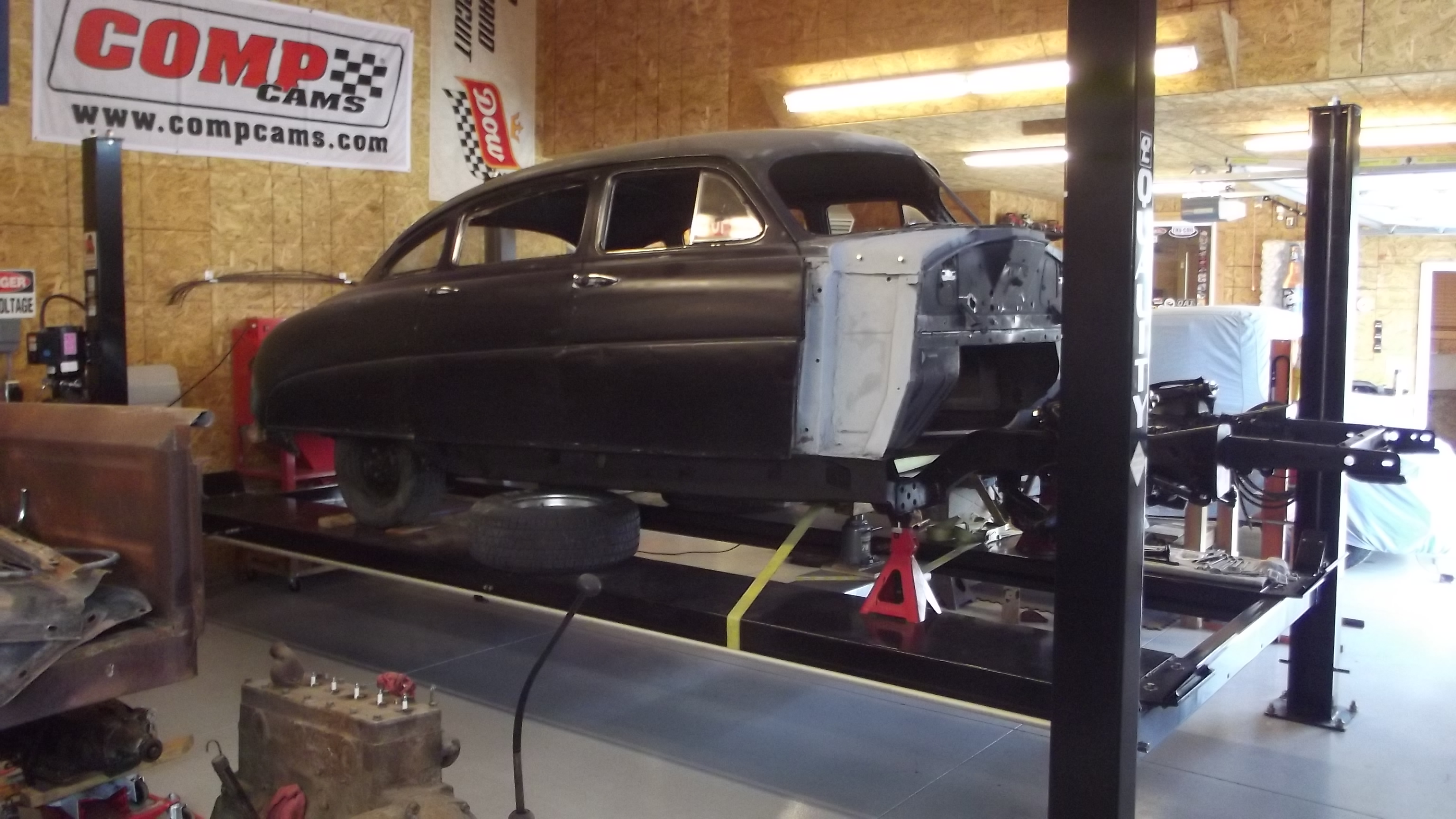

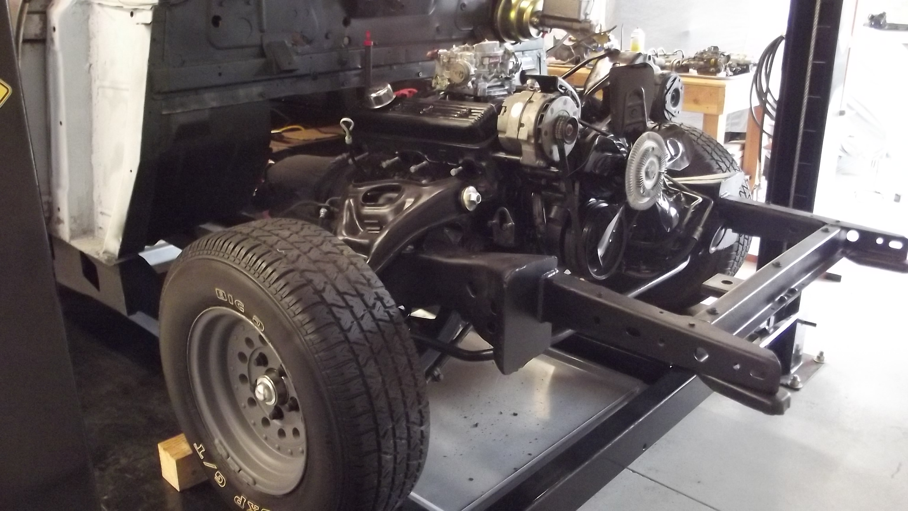

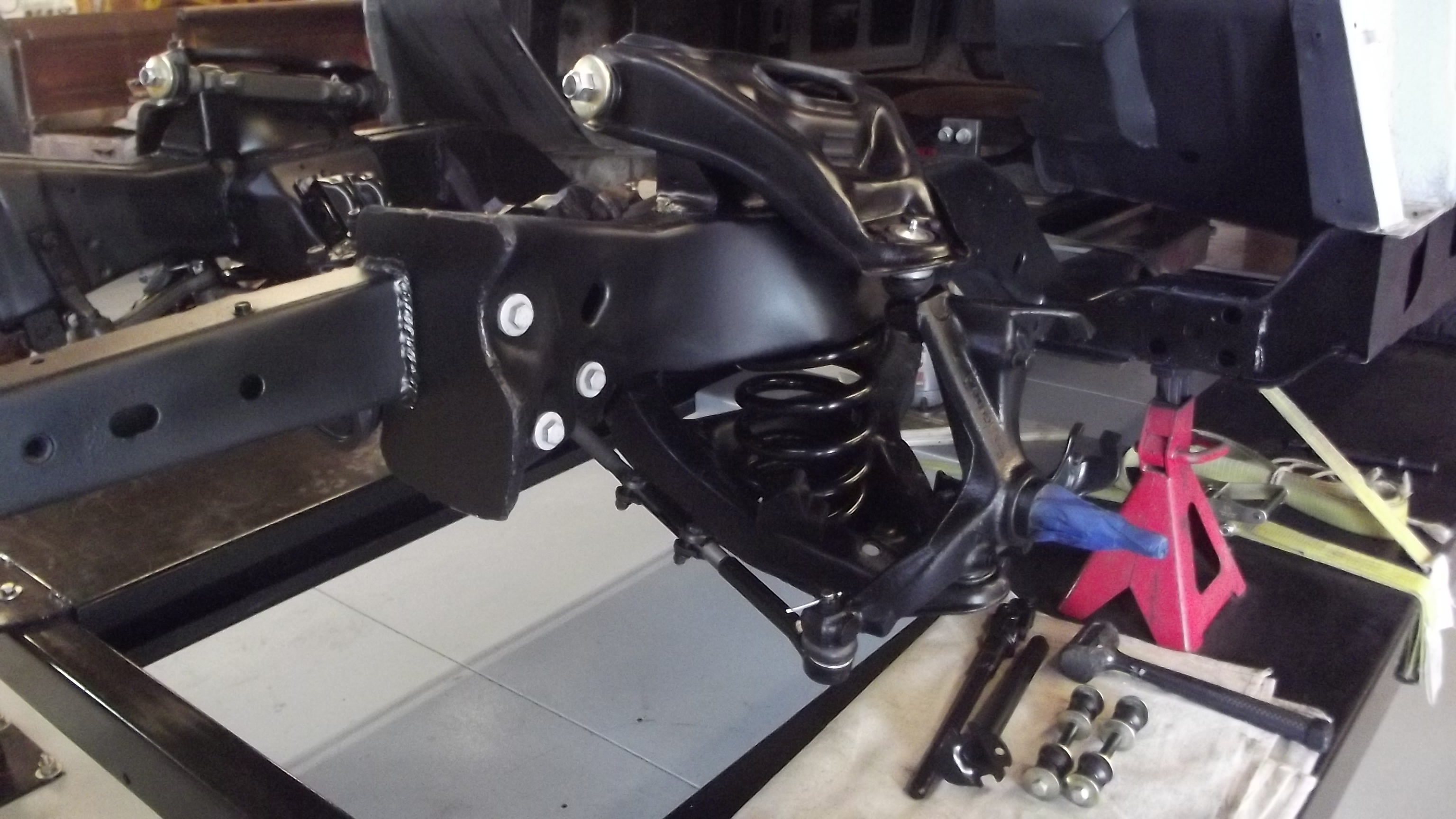

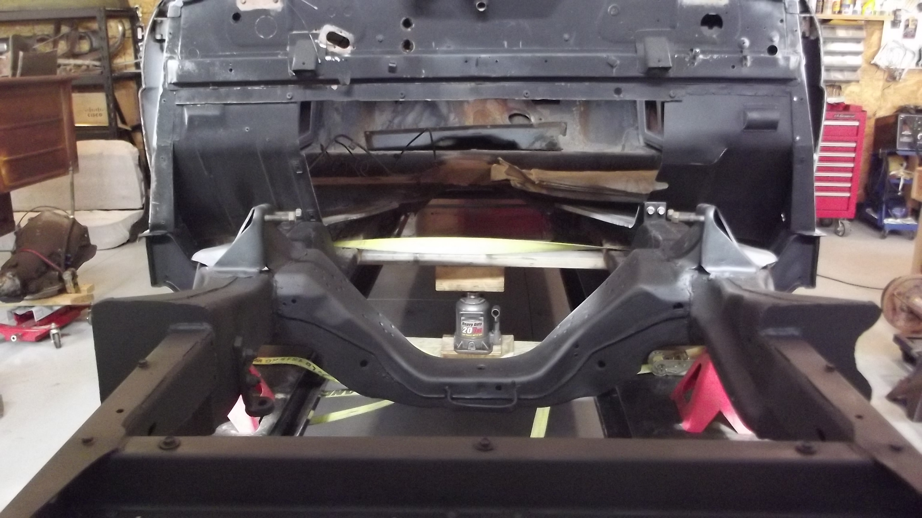

I have a 1976 Nova front clip on my 53 Hornet. I am in the process of rebuilding the entire front suspension.
JC
Nice work!
JC0 -

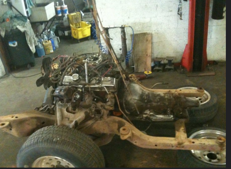

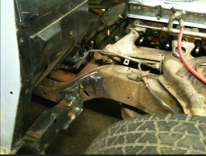

I decided to cut off the frt suspension, and front of the frame back aways , and fabricated my own front frame rails, which I slid inside of the original frame. I then boxed the frt of the frame, and have installed a mustang 2 style frt end from full tilt street rods.
Sound good let's see some pictures....
John

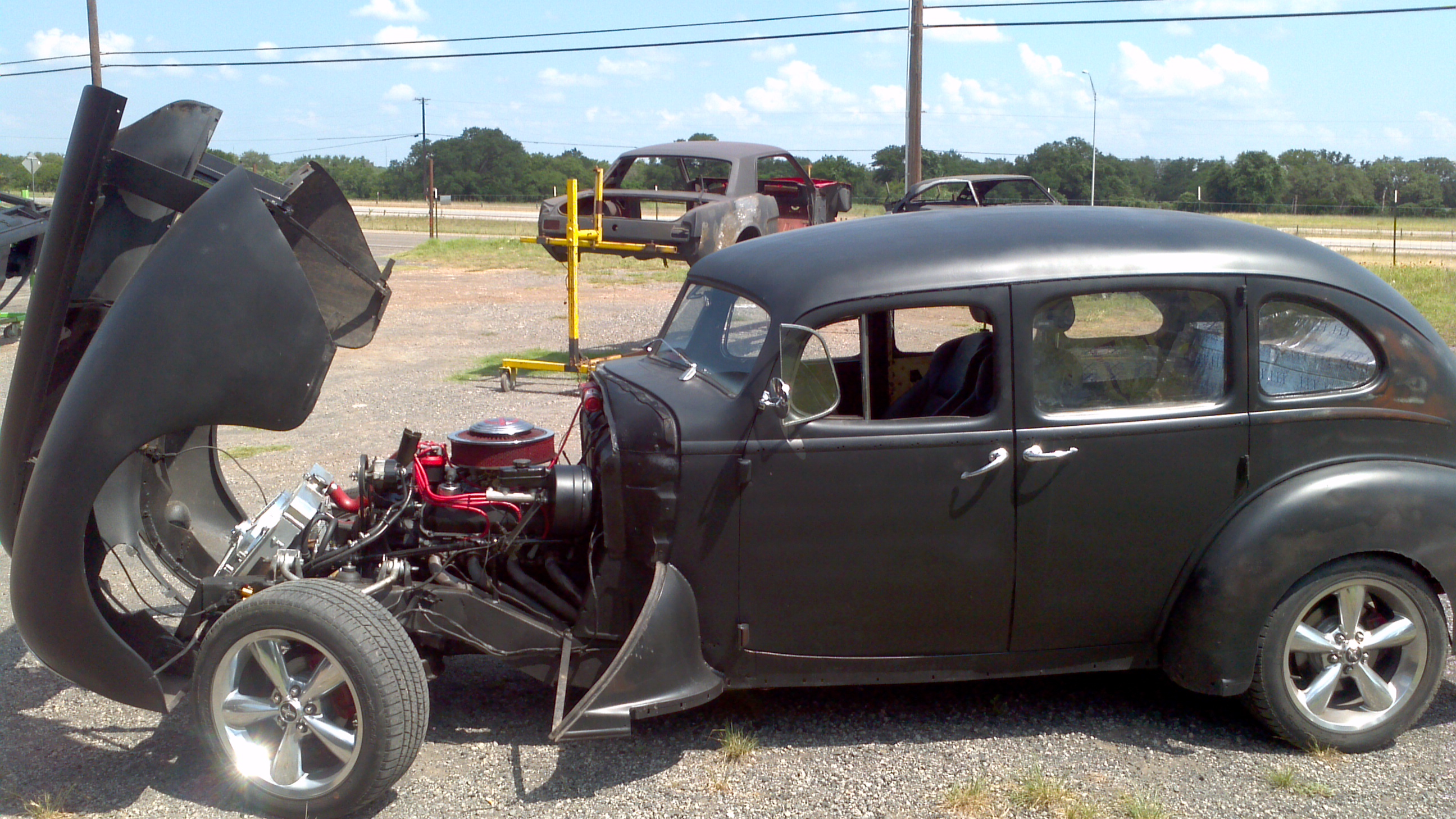

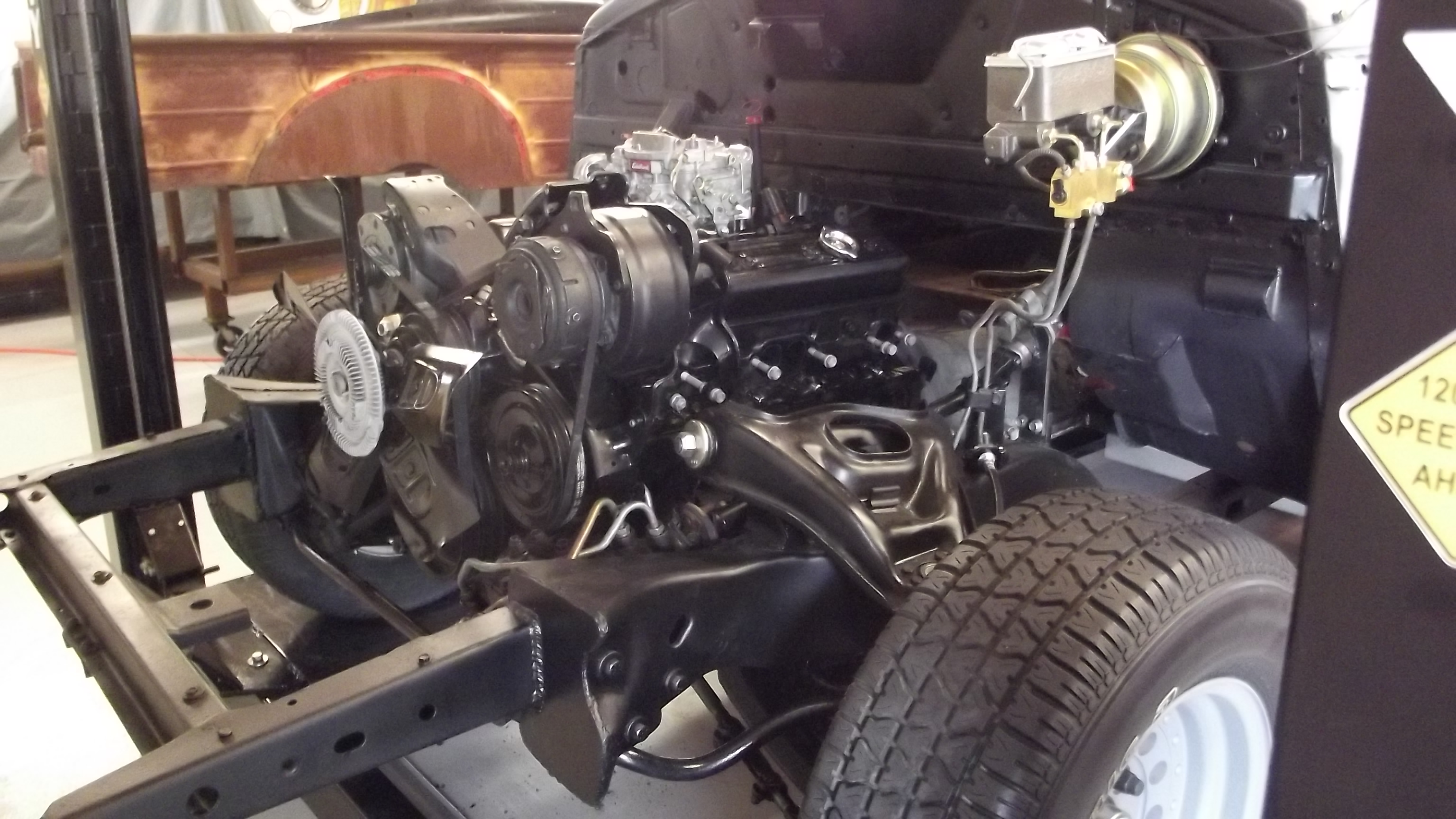

I went with 03 Ford Ranger front clip. It comes with tubular upper a arms, sway bar, disc brakes, and rack and pinion. Would have been perfect width for my 39 Country Club using regular offset wheels. Later, decided to install a 07 Ford Explorer independent rear which is 2 in wider so I now have a 1 inch spacer in the front so that I can run the later model offset wheels on all four corners.
Looking good...Nice Ride!
JC
