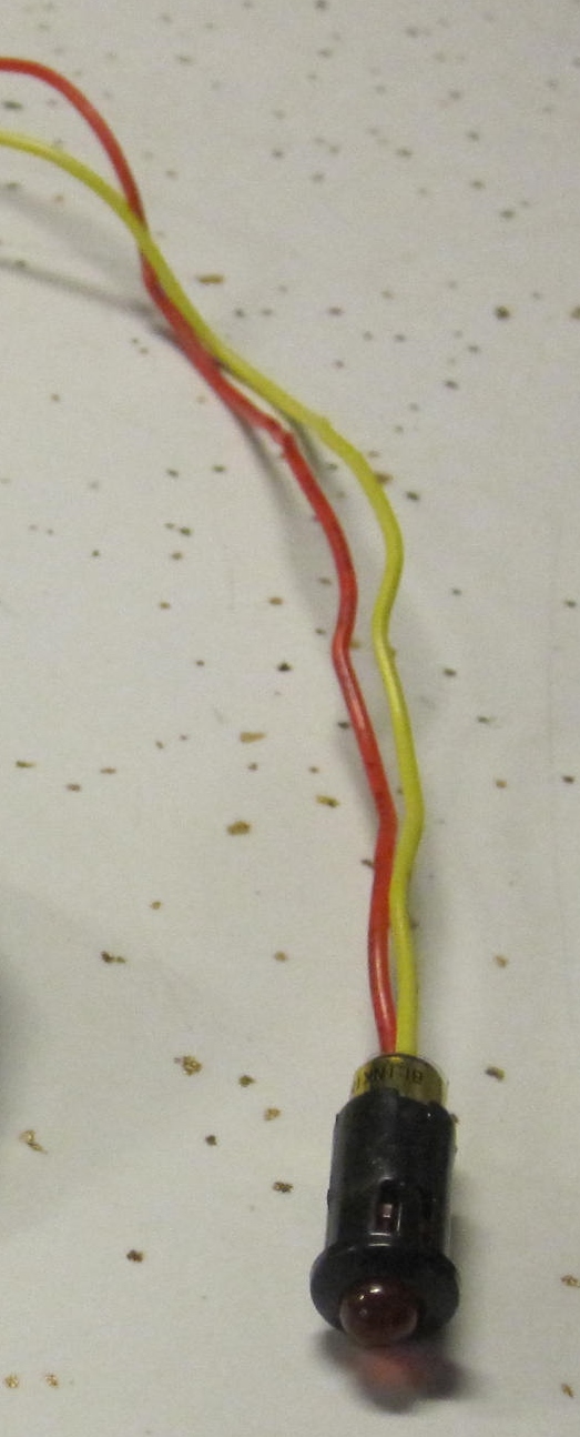

Note: you might want to consider the monitor light that I installed on my Hazard warning system. It automatically blinks when powered. Size is around 3/16. Believe I got at O'reillys.
Is that for a 6 volt or 12 volt system ?0
12 volts0
