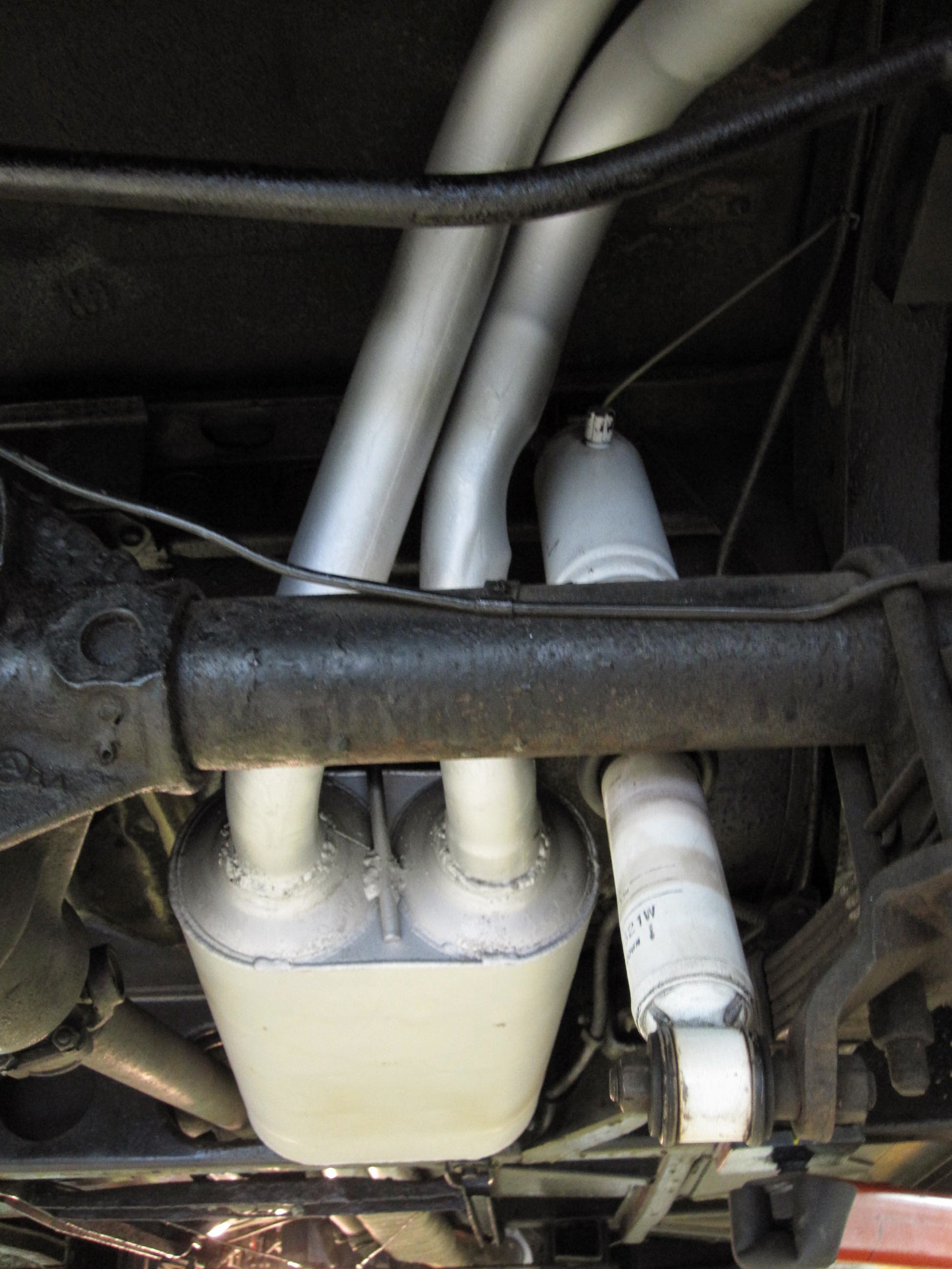

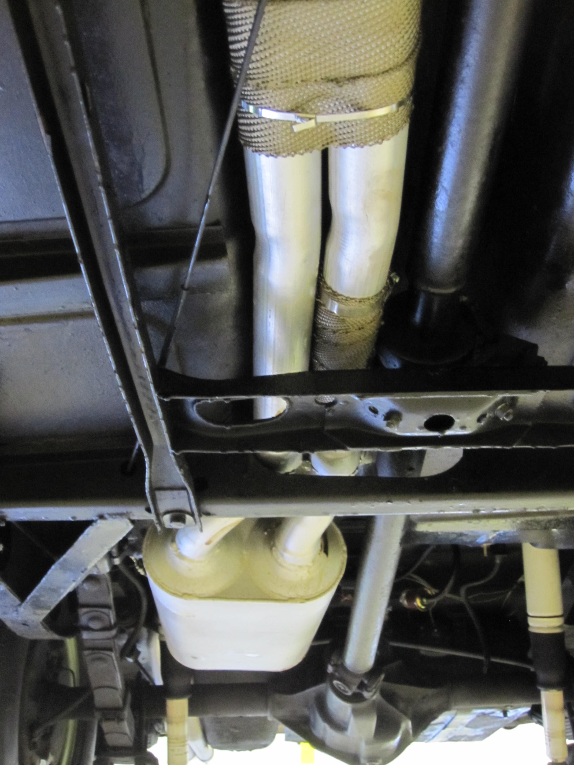

If you are using a header why not dual exhaust? In that case I recommend 2 inch pipes then dual in-dual out Magnaflow muffler. It is an internal x-pipe flow through design. So, you get all the benefits of x pipe, steel pack, and dual exhaust. I got the 17 in version to fit on my 53 in the stock position. Sounds perfect- low rumble at idle, not annoying like glasspack at speed. Love it.0
Could be, Richard. Looks like a dual-dual. I just love having all that technology and performance in a small package. Still true dual with X pipe, if you think about it. Does your muffler say magnaflow?0

Lee, sorry you had that experience with your El Camino. Does not seem to be the case with mine. A torque straight six likely responds differently to such an intervention. Clifford swore by X pipes but I welcome the input of racing types like Russ Maas. As far as seat-of-the-pants result, throttle response is awesome in this car. I stayed with dual 2 inch pipes to avoid the problem you speak of- at <=200 hp it is pointless to use bigger, and more difficult to route. Total performance mods in my case are bigger cam (not 7X though, streetable grind), 262 head, bored to 318 ci (out of necessity), twin H, Clifford headers, dual 2 inch exhaust through the previously noted magnaflow. The carbs were prepped by Walt who knew the mods I had made. I get no lag off the line, and I do not feel there has been any performance detriment since removing dual glasspacks and installing this system, but I have no dynos to prove it. I'm just happy to hit the gas and see the nose lift nicely. I may be out of my mind but I figure HP in the 180 range. Next step would be valve relief but I do not plan to go further. I'm not racing it, just wanted to wake it up a bit.
