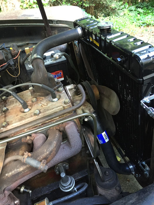

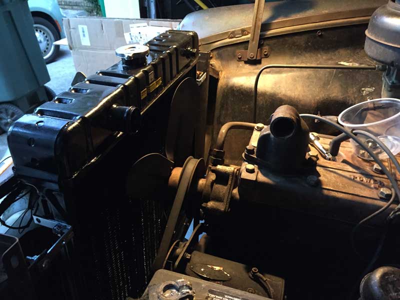

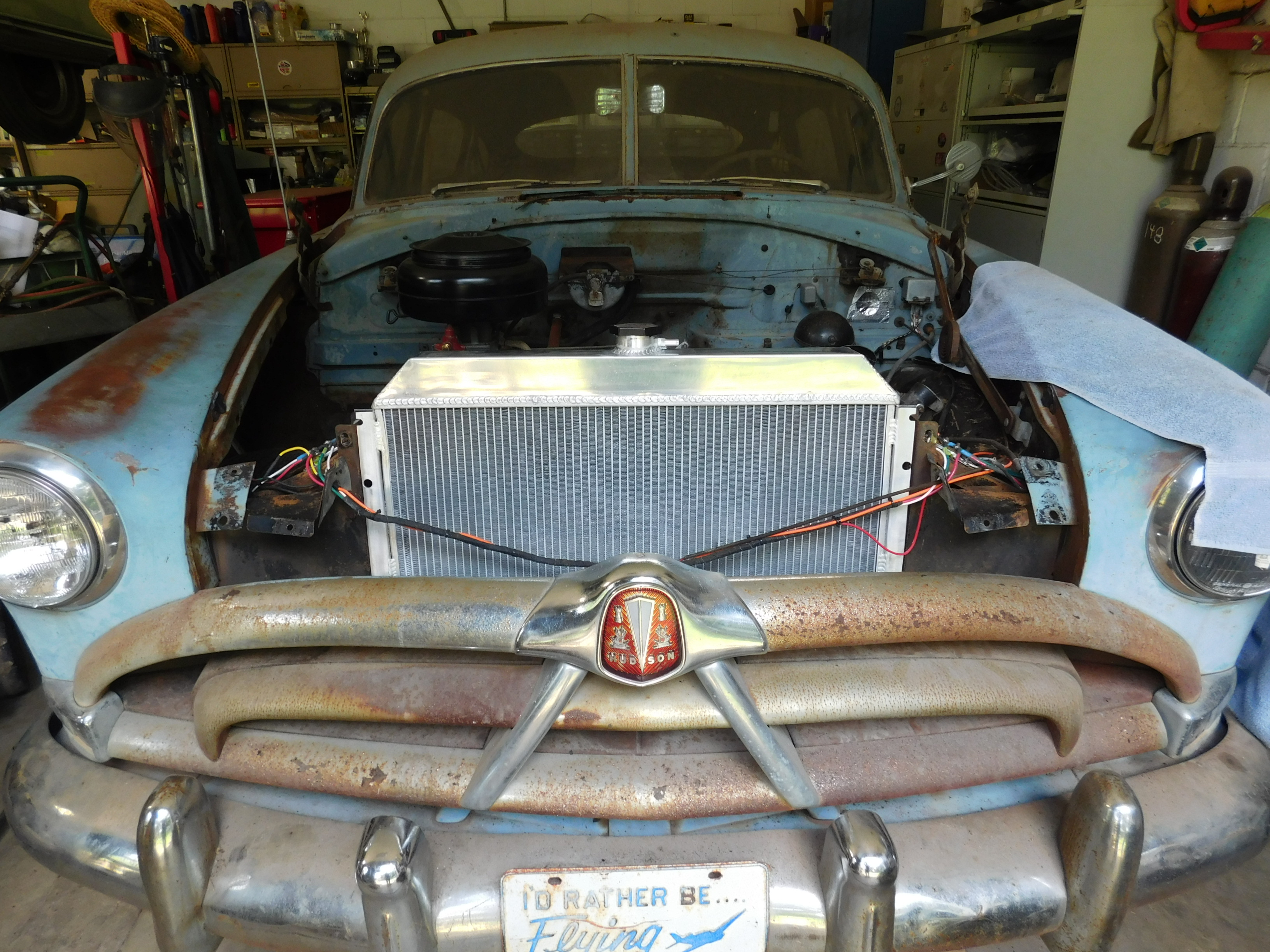

Thought some of you might want to see this. I just installed the new aluminum radiator on a 51 Pacemaker.
Hudson Radiator conversion
I purchased a Dodge application radiator from here-
http://champion-radiators.com/product-category/dodge/
2
Row 1″ Tubes Aluminum Radiator – AE374 $189.98 $177.95
This is a
heavy duty 2 row version with 1” tubes.

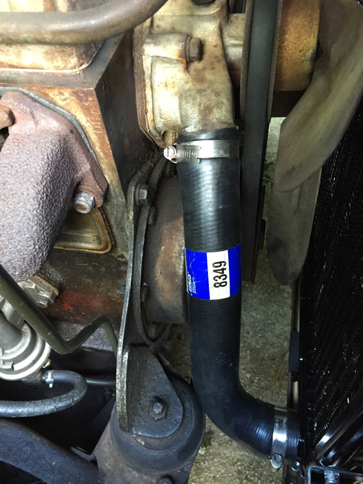

Used Napa bottom

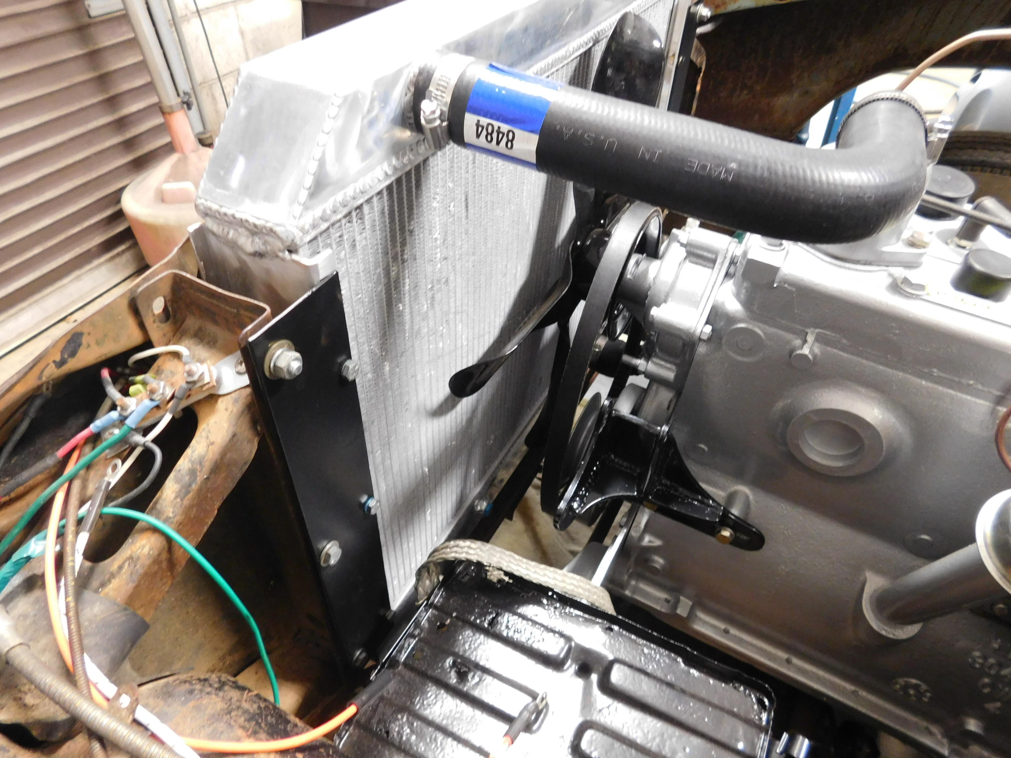

hose (Flex Hose FF209)
Used Napa Top Hose
8484 and cut to fit.

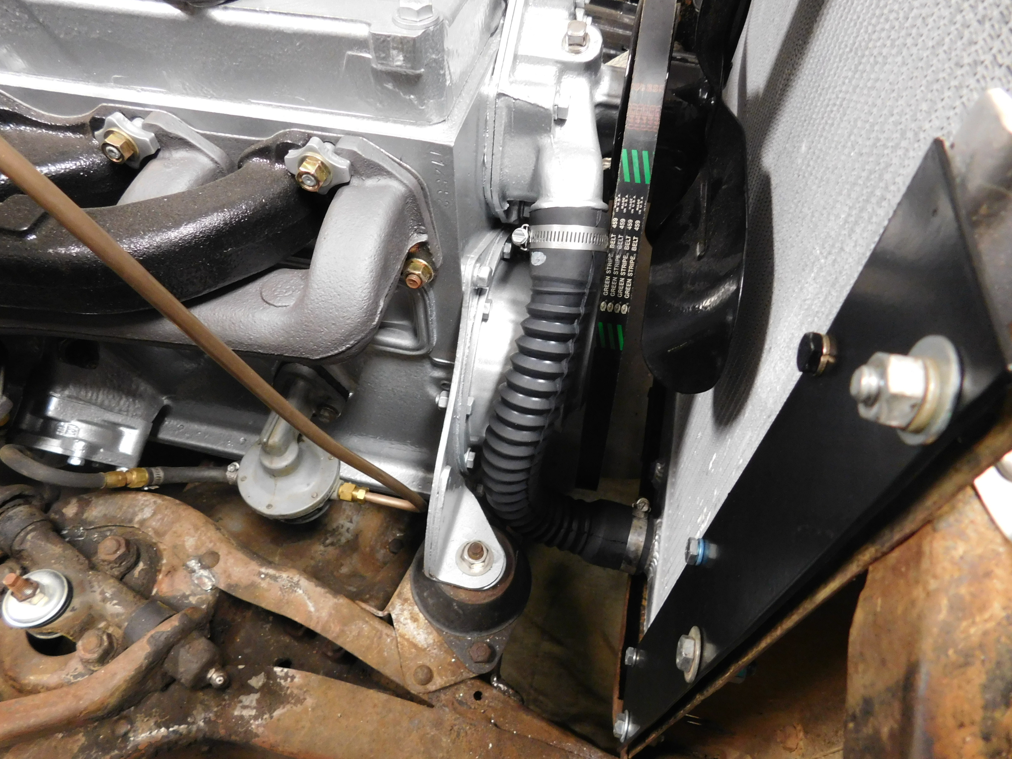

I made mounting
brackets up different than the ones on the site.
A little trimming
on the radiator mount tabs was needed. Don't know if it will need isolators or not.

I made my own isolators.. Bought a grommet assortment from harbor freight and also a small bag of brass eyelets that are used for installing in tarps.0

52hudsonman, really the pictures pretty well tell it. I did mine slightly different than the one on Ken's Hudson page, but at the end of the day, there wasn't much to it.
click on the pictures above and expand them so you can see. Part numbers and all are there to install a new aluminum radiator.
I went that route as couldn't justify the extra expense of re-coring the one on this Pacemaker.
If price is the determining factor, don't go original. Almost always costs more.0

I did the Dodge radiator swap for our '51 Pacemaker back last summer. Inexpensive and super easy, but the biggest problem I had was to find a bottom hose. I'm kinda paranoid about using a flex hose or a splice, so I went over to NAPA and the counter-guy let me go in back and search through a few hundred hoses to find the one that would work. After digging around for an hour, I ended up buying three different candidates but I stumbled onto the right hose: #8349. It's a little long (a good thing) and has a twist at the end, so you'll have to cut it to fit. Anyway, that radiator works like a champ, no leaks and the Hudson runs cool.

A flex hose for the bottom hose doesn't seem like a bad idea especially if the medal elbow is not used (with 2 hoses). They have a wire coil in the rubber that will keep the hose from collapsing on the suction side.0
