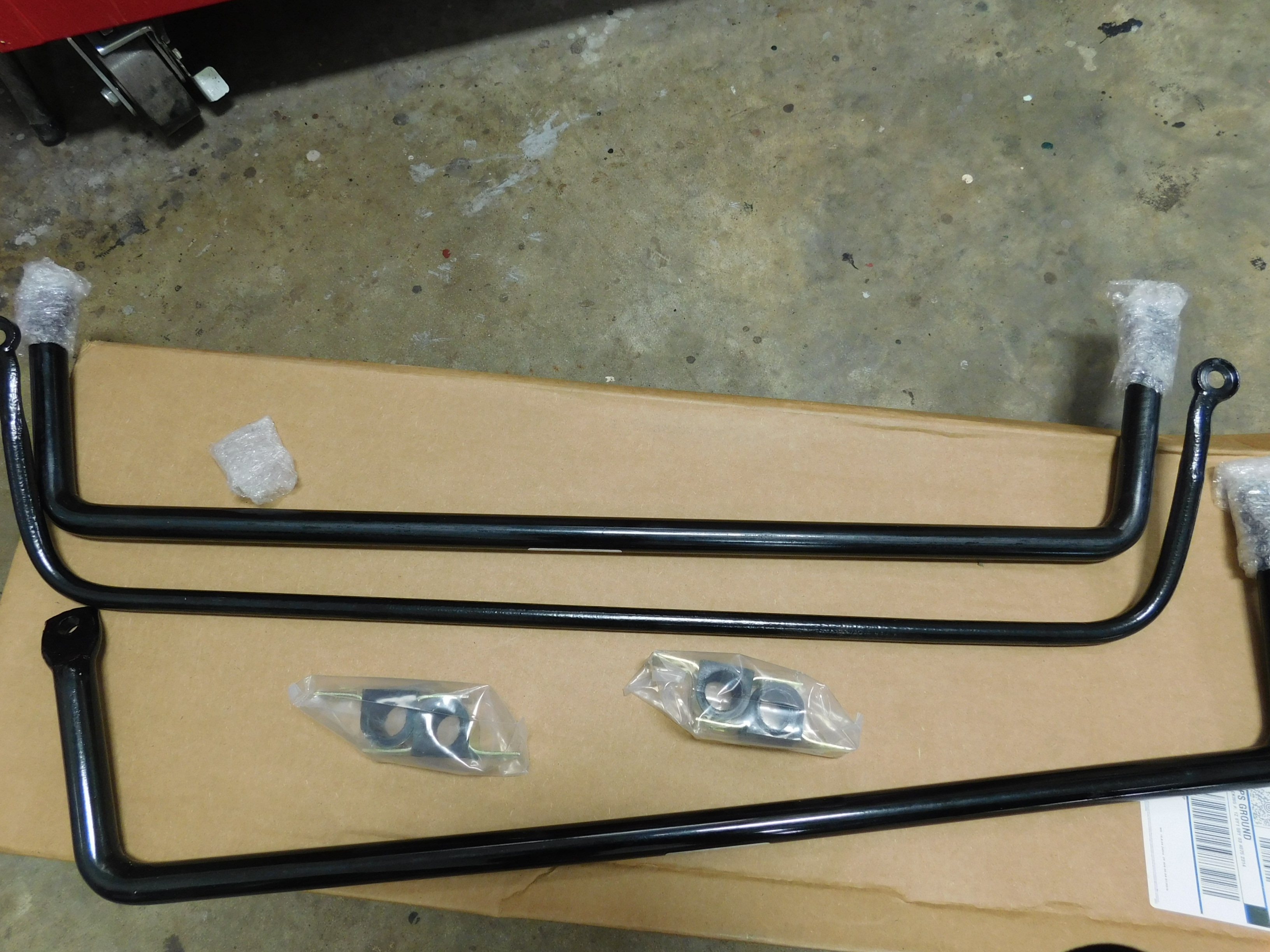

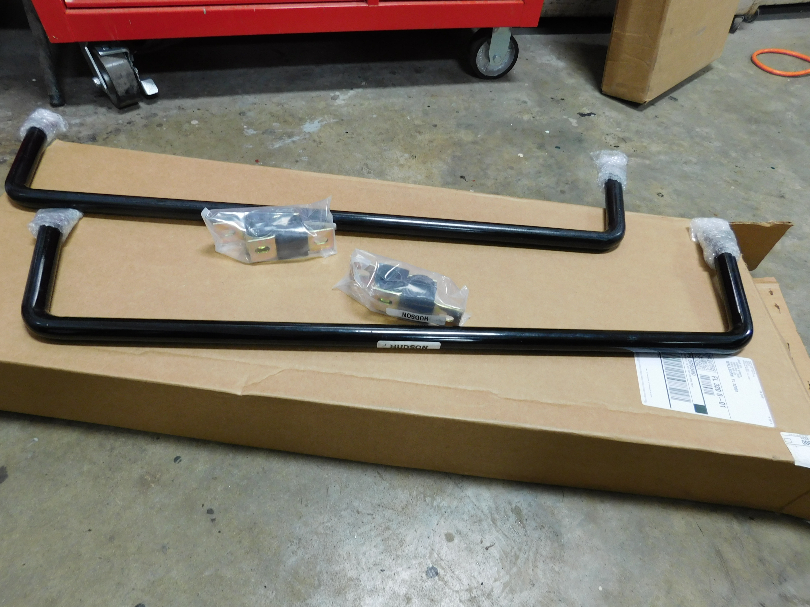

New Sway bars just came in !
Pictures, too, please.0

So, they are thicker and stiffer? I'd be interested in your thoughts after you get them installed and road-test. Are they still available?0

I can't wait to see the difference the 1.125" bar makes and hear from the folks that got them
Richard

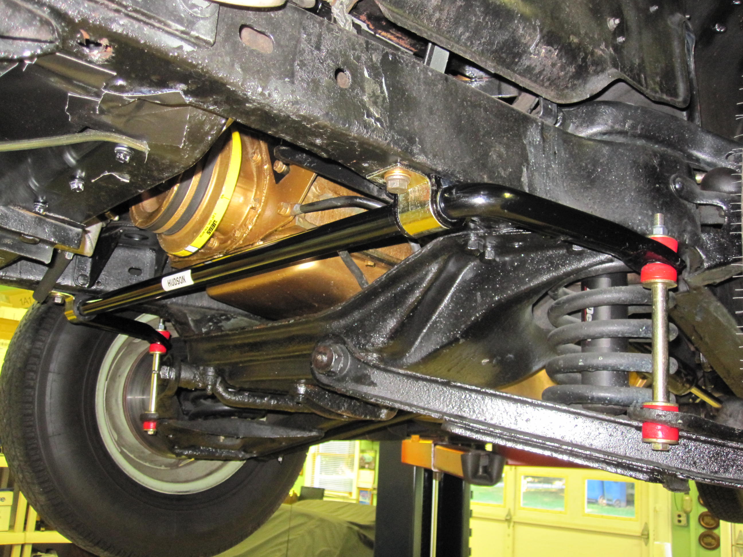

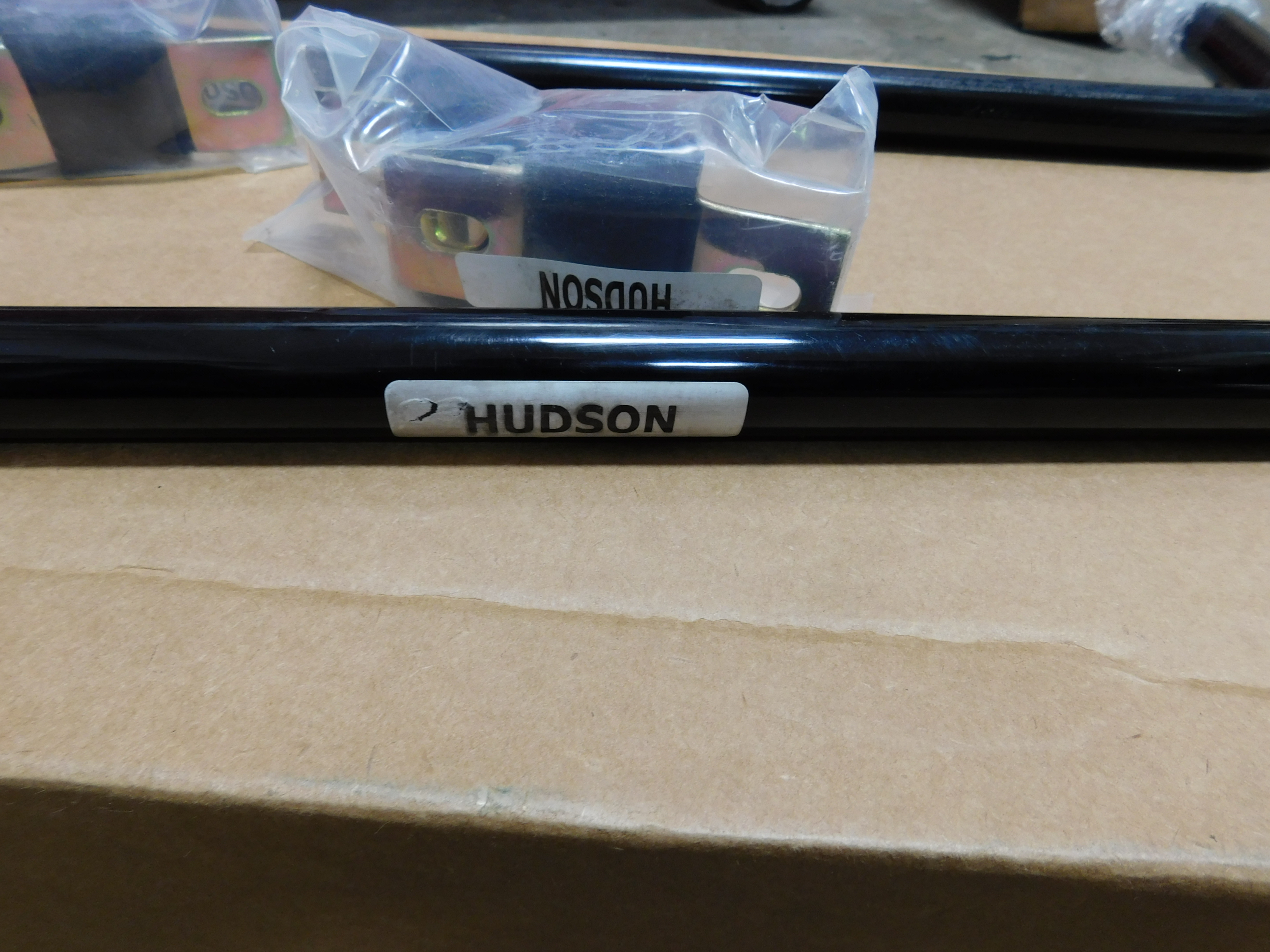

Did the Links arrive with the bar. Your car will look better than picture you posted. Thanks for taking on this project to have these made. I'll be a happy camper when mine arrives.
Still waiting. Lee O'Dell0 -
There was confusion on the links--I didn't get mine with the bar either. Supposed to be shipped later. We will hear good stuff from you when you put it on and go on several curves !!!!

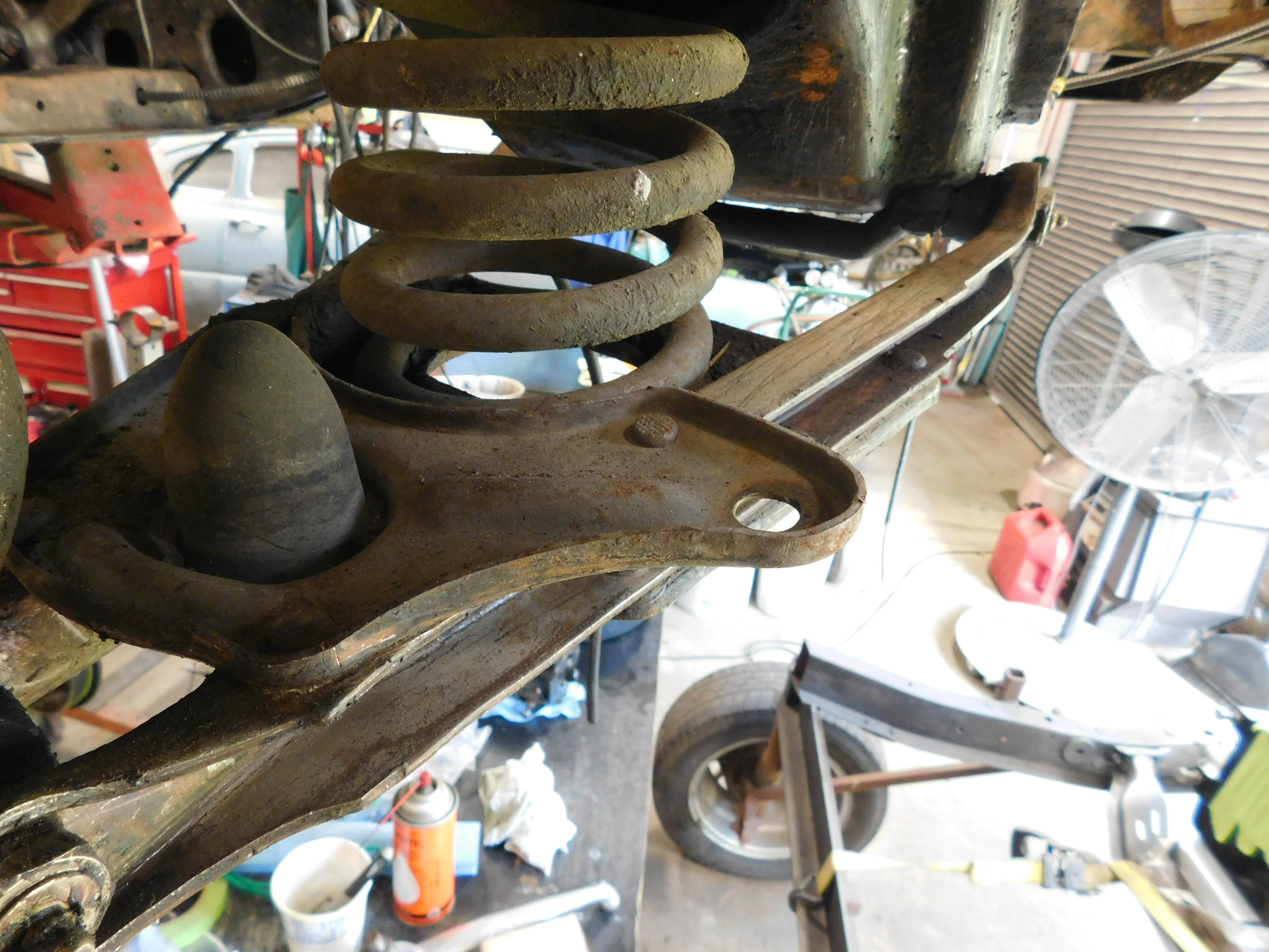

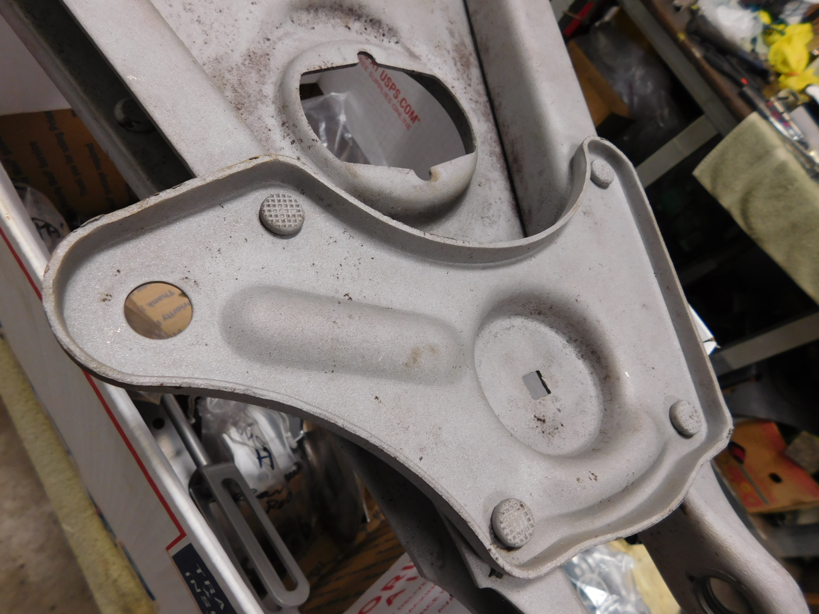

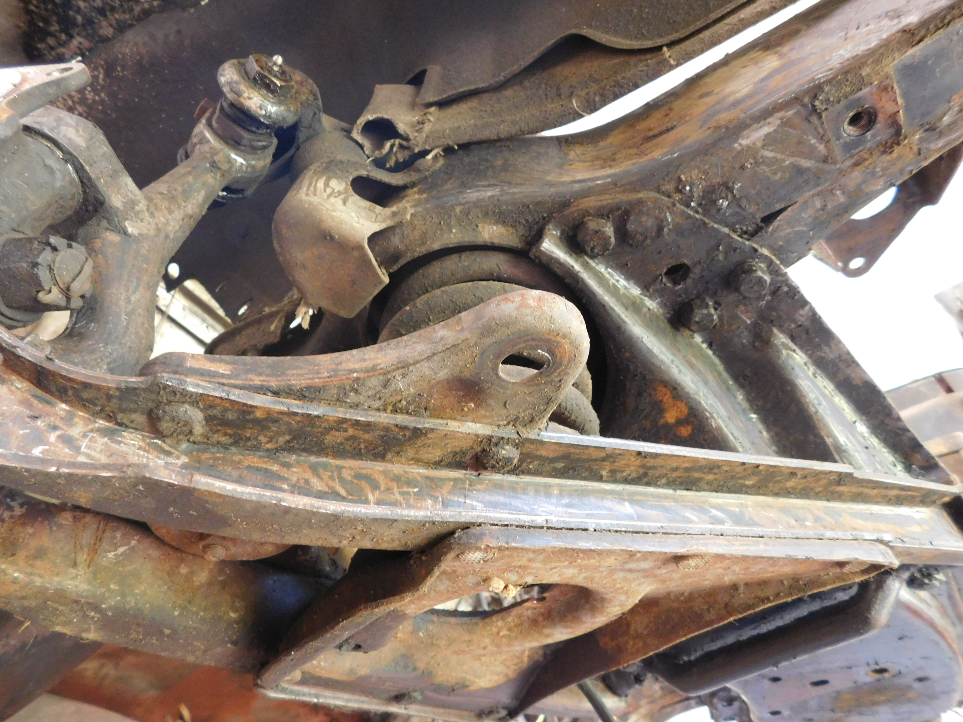

Walt raised a good point, can the stock Hudson sway bar mounts, be strong enough for the new bars?
I sent John some pictures with measurements and he will get back with an answer.
Just taking a quick look, maybe adding a weld bead on the bottom of mount and A-arm would be wise to prevent 'lifting at the front rivets?
Just got a reply back from John at ADDCO. After looking at my pictures and measurement he replied -
You’ll be fine, don’t worry about making it thicker. JW
( I think I will still put a weld bead on that rivet area!)
Kerry-I think that's a wise decision. That's one of those, "It can't possibly hurt, and may very well help"-type of scenarios. Besides, snice you have that off of the car (I think?), it's much easier to add the bead on the bench.0
Tks, Kerry. That will be all I will do also. I will send that suggestion out to all who got the bars since they might not see this.0
Walt had mentioned to me about the stress on the bracket with a bigger bar. In my business I saw many stress related breakage on suspension parts. Most were related to brackets extending out from frame or control arms. Many Hudsons are already high mileage cars with many stress cycles on sway bar brackets. Mine has 78,000. The weld may be enough, but the leverage is still there. I have seen sway bar brackets brake at the link hole and where bracket is mounted.
I'm thinking about triangulating the bracket with a support brace from extended outer edge of bracket down to the lower lip of control arm. That would eliminate leverage stress across bracket.
Also, may consider reinforcing the frame where anti sway bar is mounted.
Another thought for appearance sake, I have seen some factory fixes where the factory would come out with a new part with steel round rod welded to new part for reinforcement. Hardened round rod could be formed and welded to the outer or inner perimeter of bracket to make it much stronger.

After posting my last comments, I walked outside and there was my anti sway bar laying on the front porch.
HOO RAA !!!
Will have to wait for links.

Thanks for posting picture0

Thanks to everyone for sharing pictures.

Thanks for sharing the picture, Richard! Looks great. Look forward to a driving report!0
Richard,
Just wondering what kind of tire clearance you have when all the way right/left, as well as what size tires are you running on the front?
Thanks
Could not begin to tell you? Running too large a tire but I have 5 of them that came with car: P235-75-15.
I would feel better with 225.

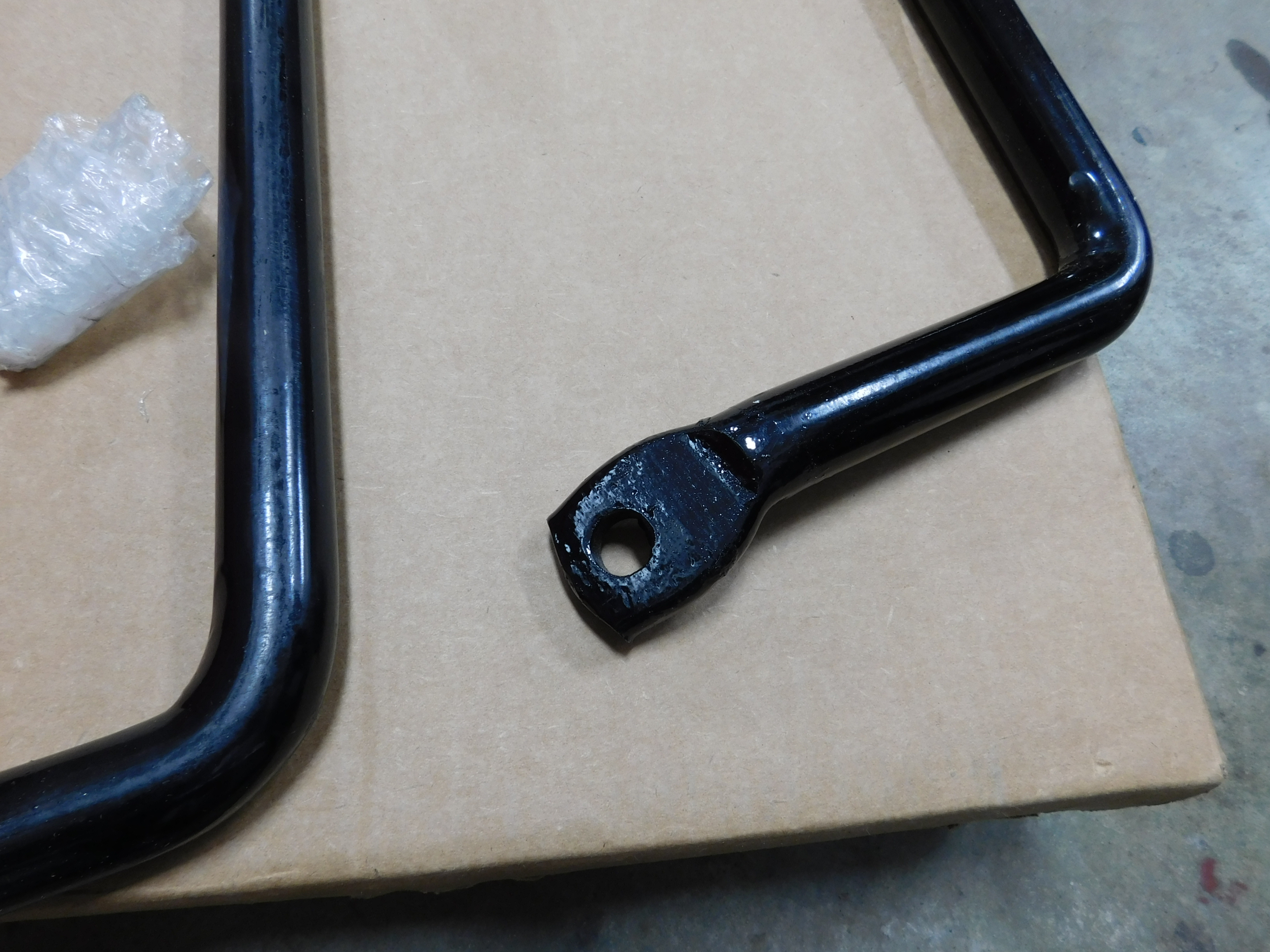

Not sure what clearance you are referring to. The bar is exactly the same as the original dimensions except the diameter. Was patterned after an original bar. That was the beauty of the manufacturing process. Also it is powder coated.
The links are aftermarket; the new ones from ADDCO (w/kit) have not been received yet. Measurements for these were taken from original links. May be slightly larger in diameter than original requiring a slight drilling of the bottom A-arm link hole.
Well, I was talking about the clearance between the tires and the sway bar when turned all the way right or left. Apparently, your tires don't hit the sway bar.
It just looked in the pics like the new one had slightly different angles for the legs, but that must be an optical illusion. Thanks for the info!
