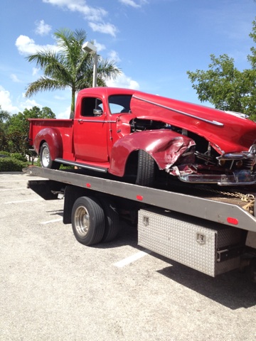

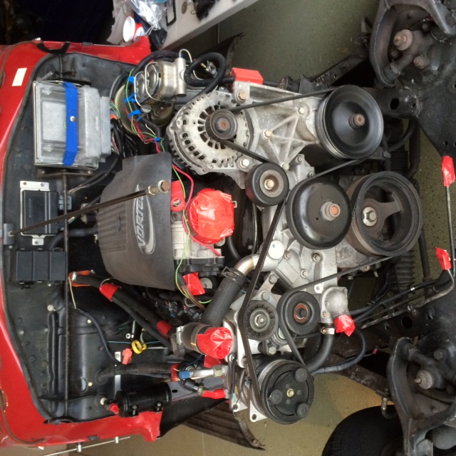

Here are some shots of it as she sits in the garage. Also a post collision pic.
I am sure the prior owner was a member as his wife mentioned the HET site. He passed away last year and I purchased it from his estate.
Whoa! I see why you need the sheet metal.
I have one of those engines out of a 2005 Chevy Tahoe in my shed (along with the 4L60E it came from the factory with), patiently waiting to go into my tan '46 Hudson pickup- only about 400 miles on the engine (someday).
What's your engine mounts / transmission mounts look like? Am very interested in seeing what you plan to do for a radiator.
I think you'll find that the engine is the SUV equivalent of LS engine - the LMG 5.3L or 5.7L version. Essentially, the 5.3L has around 295 HP and around 320 ft-lb of torque. It is pretty-much the same engine except that it has an iron block, not aluminum. It is my understanding that all parts are interchangeable between the LS & the LMG 5.3L.
I think it is a 4.8. The frame was not damaged behind the front suspension at all. The front "ear" of the frame on the driver side is in need of re-welding, but the frame and engine area are in good shape.
I am working on finding a radiator now. Am hoping to get an aluminum radiator with the Auto trans cooler ..The ones I have located for the engine size seem to be a bit too wide though. I think it will just take a bunch of cross referencing different cars w the same engine and find a size that fits the opening.
Once I get the front end here, I will install the fenders and hood and get my measurements. As I have never looked under the (undamaged) hood of one of these things, Im sure there are many small parts that I will be trying to locate to make it whole again.

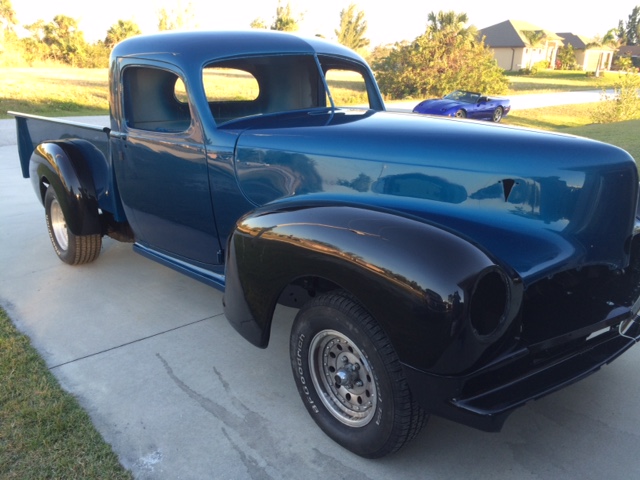

Making Progress. Just got the truck back to the house. Thanks to all who helped with phone calls and parts leads. I figure Im still about 6-8 months from finishing.
Looking good. Did the 4.8 exhaust manifold on drivers side clear the steering gear box and did you have to modify the X frame to fit the transmission? What radiator did you get to fit?0

pivotpro - Can you take some pictures of the engine compartment, motor mounts, etc., for the truck?
Am interested in a good, close look at it - very much appreciated.
