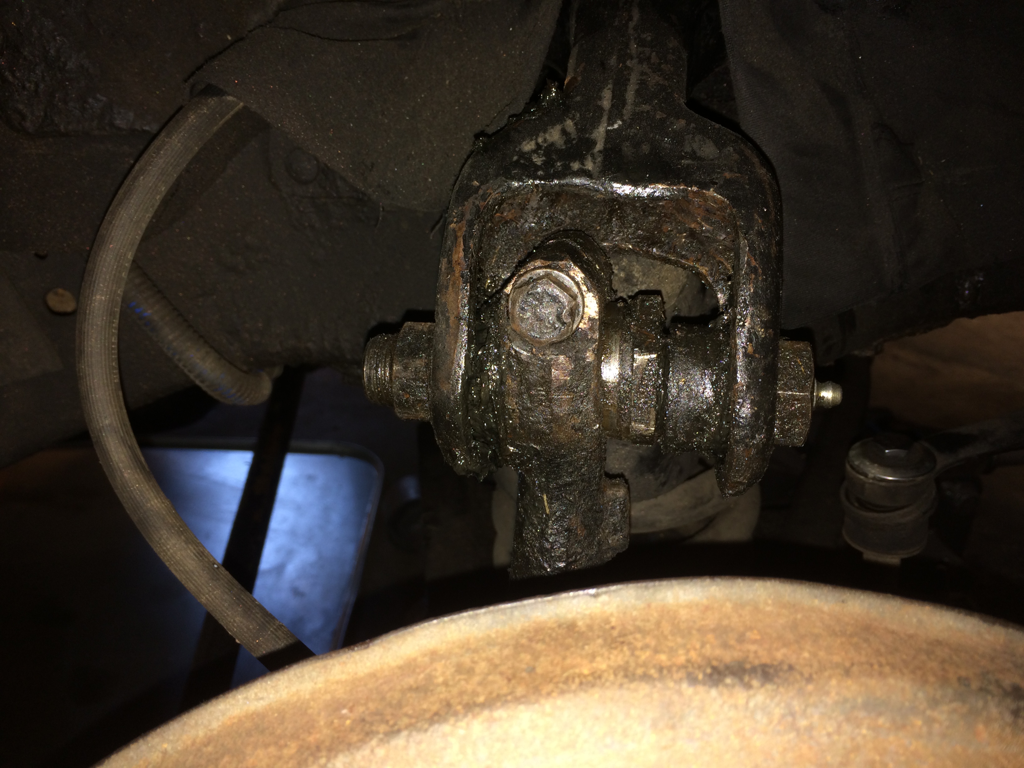

New center pin & bushing installed, unable to find means to adjust driver's side camber. What am I missing?0
Here is a link to a picture of the camber adjustment;
It is easy to see if you remove the wheel.
Loosen the lock nut, and turn the eccentric bushing to adjust camber.
