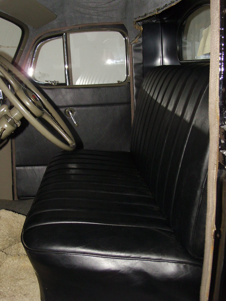

I'm far from an expert, but the trucks I've had a chance to see and sit in are designed for short people who like to sit straight up...
Rob
I used to be 5'10'' and a half, With the aging, I'm 5'10 now... This might help for the future... Another reason to sit in it and drive it before! Thanks! Michel0

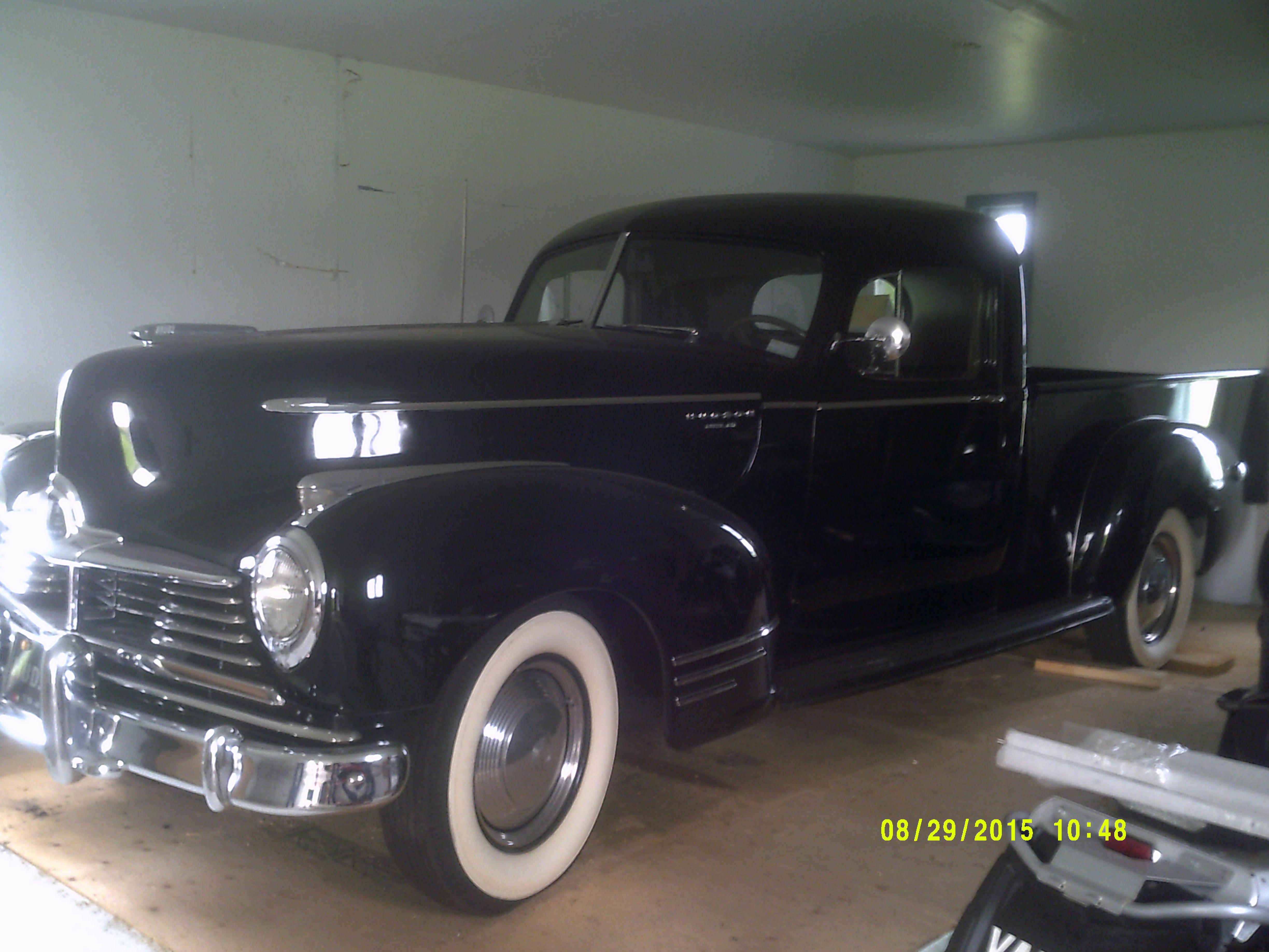

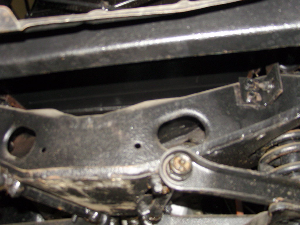

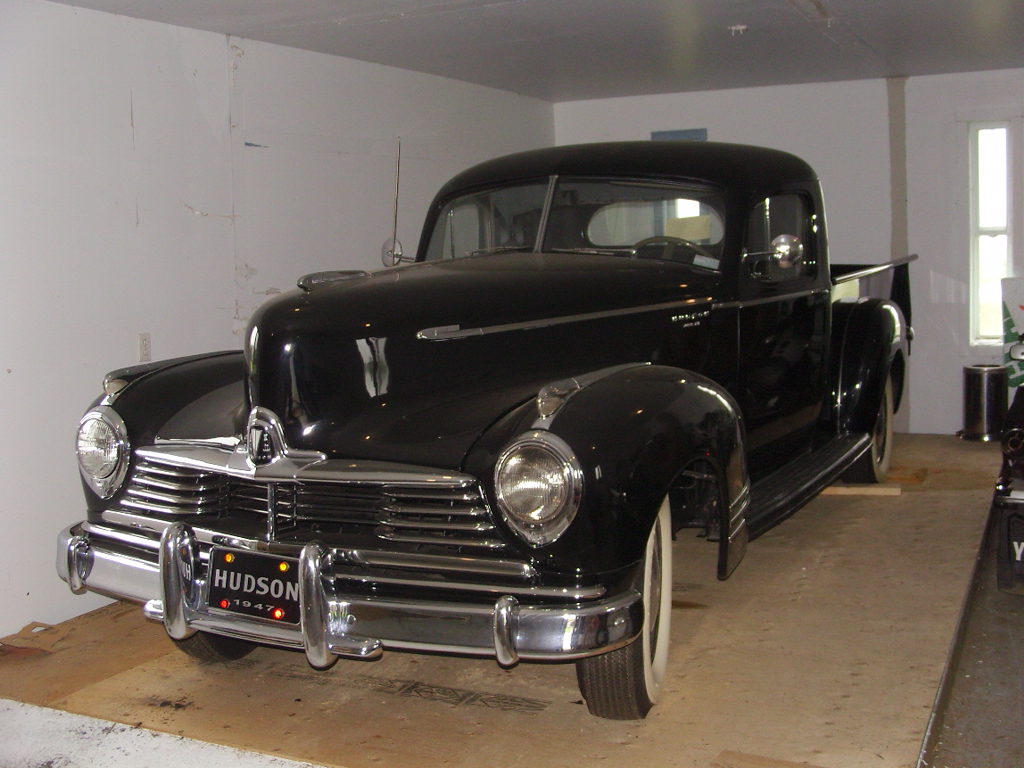

Looks good from the pic. Rust issues on these are usually at the kickup in the frame in front of the wheels.
These things actually handle as good or better than the cars due to the longer wheel-base. They ride rather like a truck 'duh' if they have the original 12-leaf springs in the back.
I'm 6' and 170 and have no trouble fitting in mine. The original seat-backs were some 6 or 8 inches thick. that can be reduced to a couple of inches at the top for more room.
Original engine was the 212 splasher 6 which is plenty of power. Overdrive would be nice or a 3.56 rear end from a stepdown automatic. 16 inch wheels are a plus
If it's as nice as it looks, it's worth 12-15K in my opinion.

Nice looking truck, Michel. I don't think I would have a problem at 19K if it's as nice as it looks. Let us know how it turned out.0
As stated, it looks like a very nice truck. The O/D & rear end gear ratio are great options and sought after for all pickups.
It would not be a #1 (or #2) with any rust issues, however as Josh indicates - the base of the kick-up in the frame is the spot where it rusts, just in front of the rear wheels.
Don't want to burst anyone's bubble, rain on the parade, etc... I have seen a lot of 46-47 Hudson Pickups go thru auction in the last few years, and if the truck is a legitimate #1 - IMO you won't touch it for much under $25-28K (if that)...

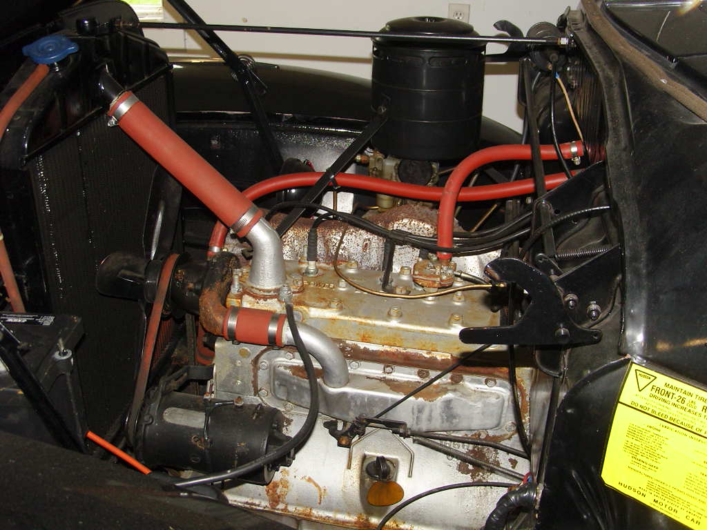

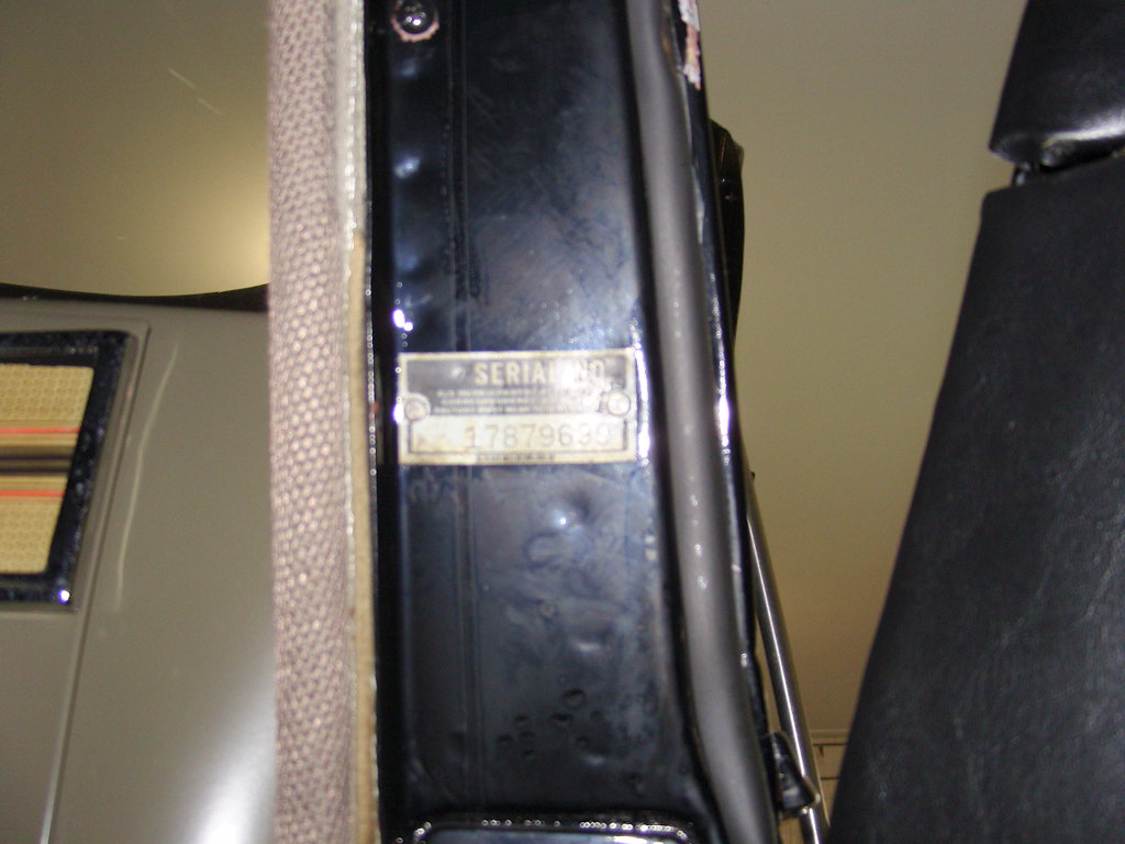

Hi Guys, Thanks for all the replies. Just came back from my 5 hours drive. S/N 17879639 That's what I'm able to read when I get the picture bigger cause I had forgotten my lamp... Overall it's very nice. There are 12-leaf springs in the back ( as stated by Uncle Josh). I thought the engine would have been nicer. Could use some paint. When the truck was for sale a few years ago ( thanks Rick, I did not remember I had translate the details from an add),

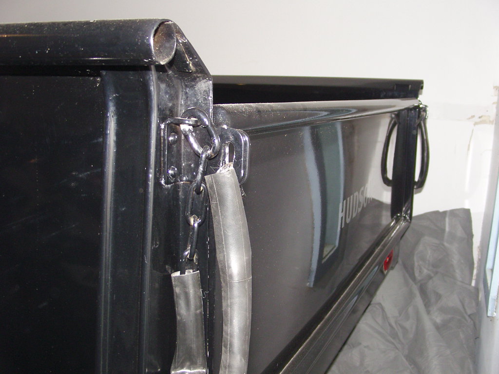

the owner was still living and he wanted some 26K at the time. When he past away, his son called the guy who owns it now and he got it for 23K. This morning it was rainin like hell and I did not want to ask him for a ride. The new owner used only once last summer because he is working very hard and had no time to use it. That truck could use some grease and the usual tune-up. i heard the engine turn but it did not start. Would have needed some gas in the carb and I'm sure it would not have been a problem. Another question: the tail gate. very nice but I was wondering if the letters should be embossed? Because now, as you can see, these are decals. ( Unless it is supposed to be this way, I don't know but I'm quite sure it should be embossed).

Took a look at the pictures - I would say it is a #3, i.e., a 'driver' - and that's only if it will start, run, and stop reliably.
Value (again, if it can be shown to start, run, and stop) - I would say between $12K-$18K...

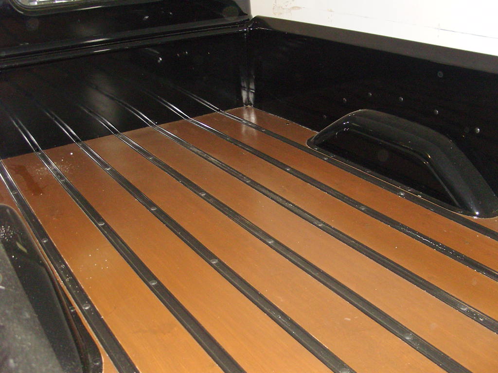

Hello,The inner fender wells on the bed aren't right, are they? It seems like there are a lot of non-original changes, which are fine if that is what someone wants.Take care,Steve Bryson0

You are right the tail gate HUDSON letters should be embossed. To bad you didn't get to see it run and drive it after going so far to see it.

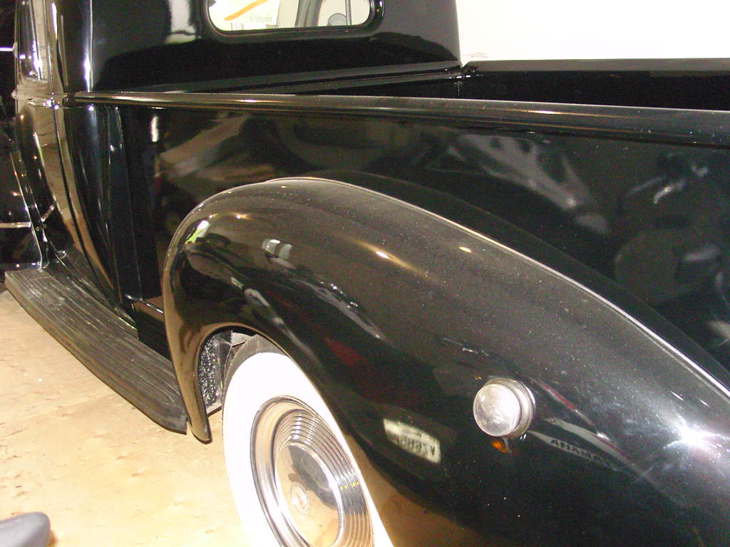

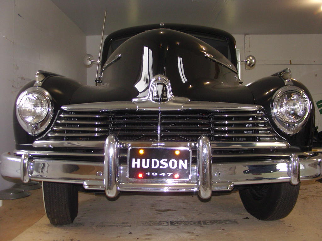

Yes, fender wells are wrong and the radio antenna is on the wrong side. Also, PU's had different front bumpers and did not come with car bumpers, the original bed wood and trim strips were black and the seams of two piece rear fenders has been filled.
Although not original it is a very good looking truck. I like it.

Do you have a name to go with the SN# 17879639 so I can add it to my SN# list I have made with SN's in numerical order. Trying to find how many SN/s are back to back.

I did notice the other items (bed, tailgate, etc.), but was at work so just left a 'quick & short' reply. Those items and the overall condition (leaking engine (? - take note the stained engine paint); non-standard modifications, etc.,) means that unless some work is done ($$), it shouldn't be anything more than a #3.
Even though the tailgate and bed are not fully original, it does look very nice - and if it was dusted, washed/cleaned, waxed, tuned-up and running it would have made a much better overall impression.
And - Glen is still selling the repro tailgates with 'Hudson' stamping/embossing (I bought one a couple of weeks ago from him, and they are available - contact him directly).0
