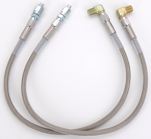

Is there a supplier that sells these hoses?? Have a Hydraulic Co here that will make the hoses for me. Must have the old hoses to make sure all is the same. Can be supplied with clear plastic over the SS or I can put black shrink tubing over the mesh SS hoses {before crimp} if I want them not to look stainless.
Would like to price these if a vendor sells prior to my going local; always best to compare.

No, Park, referring to the flex hoses. three reqd. Makes brake pedal extremely hard (but I am using DOT5, so 'hard' is subjective). "Racing" stuff.
But you can make them look original with the shrink tubing {before last crimp-on banjo}, if desired.
Has Teflon tubing inside the Stainless Steel braid.0

Response from Jim Turner:
"As
long as I can get the fittings, I can pretty much make anything! IF (someone)
needed a 3/8 x 24 female thread on one end and a metric on the other end, I
could make that up too. According
to my catalog, looks like the Hudson’s are all pretty much the same hose on the
fronts, NO listing on the rear hose on a 53, but the 51 takes a front hose on
the rear. (same number anyway) In
answer to your question, yes, I can make up either the stock rubber hose, (mine
are fresh, date code is 10/2014) I crimp them, then pressure test them to 3200
psi for 15 seconds. The mandatory DOT test is 1500 psi for 15 seconds. IF mine
were to fail, they would fail when tested. I
have been making Studebaker disc brake conversions for over 30 years, I am
“serious” on my parts, being how the two MOST important systems on a vehicle are
steering and brakes! I feel like I literally have your life in my hands, and I
make my products that way too! Also,
IF a stock hose is not long enough, I can make them any length. On the rear hose
on Studebakers, I lengthened them about 1 ½” so that when up on a lift, the hose
is NOT under a bind!Let
me know a length on the rear hose, for the 51, the overall length is 14”Thanks
Jim"

I use stainless braided brake hoses on my classic cars. I've read that they don't expand under pressure as much as a standard brake hose and give a firmer brake pedal along with longer life. I also use DOT5 fluid in them also because it is not hygroscopic and the hydraulic system will last for years even with extended storage. Ebay has some vendors that make nice hose sets for a fair price. I got a set for my brothers 54 Dodge Royal and they even offered different colored silicone coverings for them. I chose blue and they looked real nice installed.0
