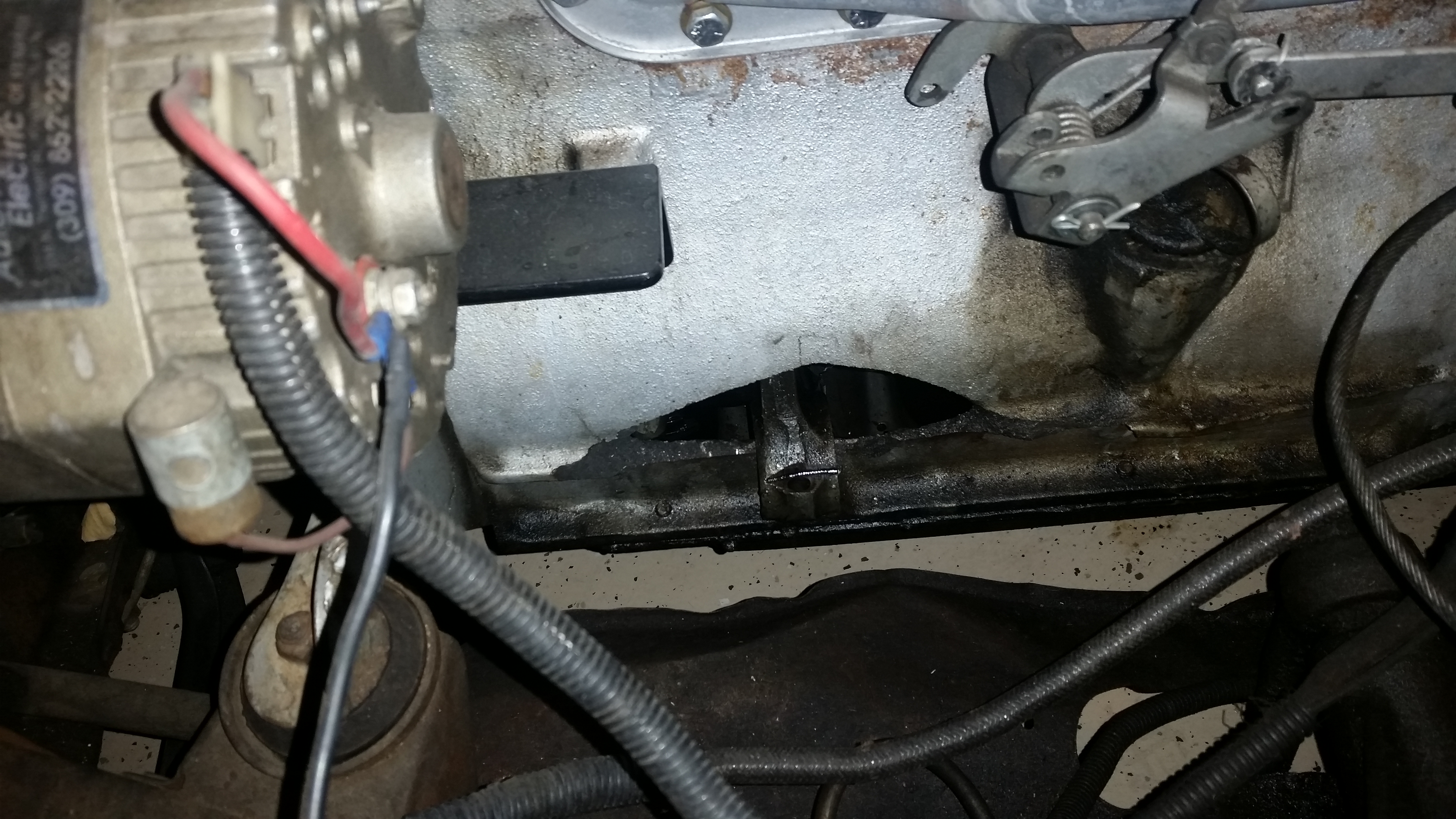

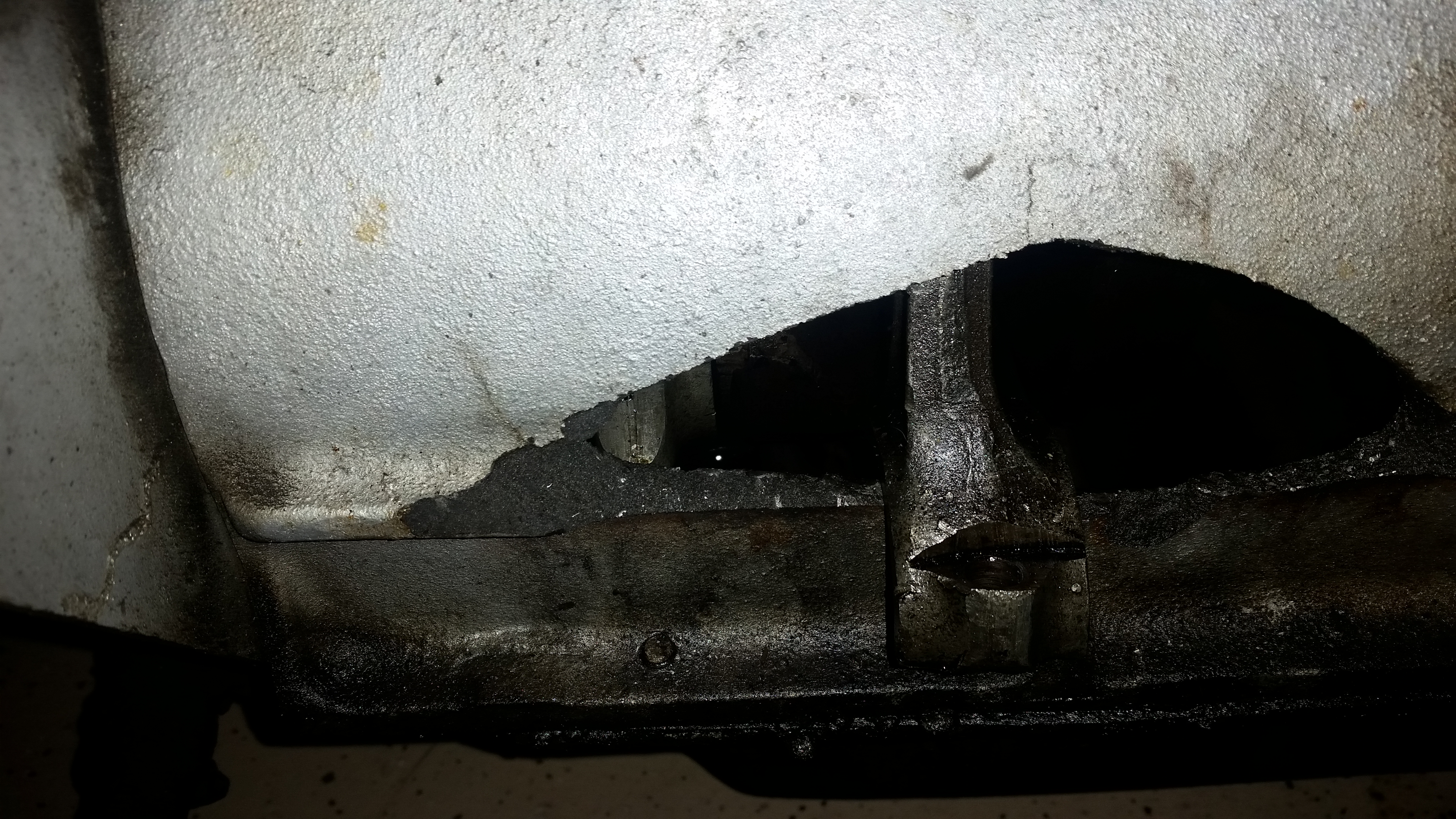

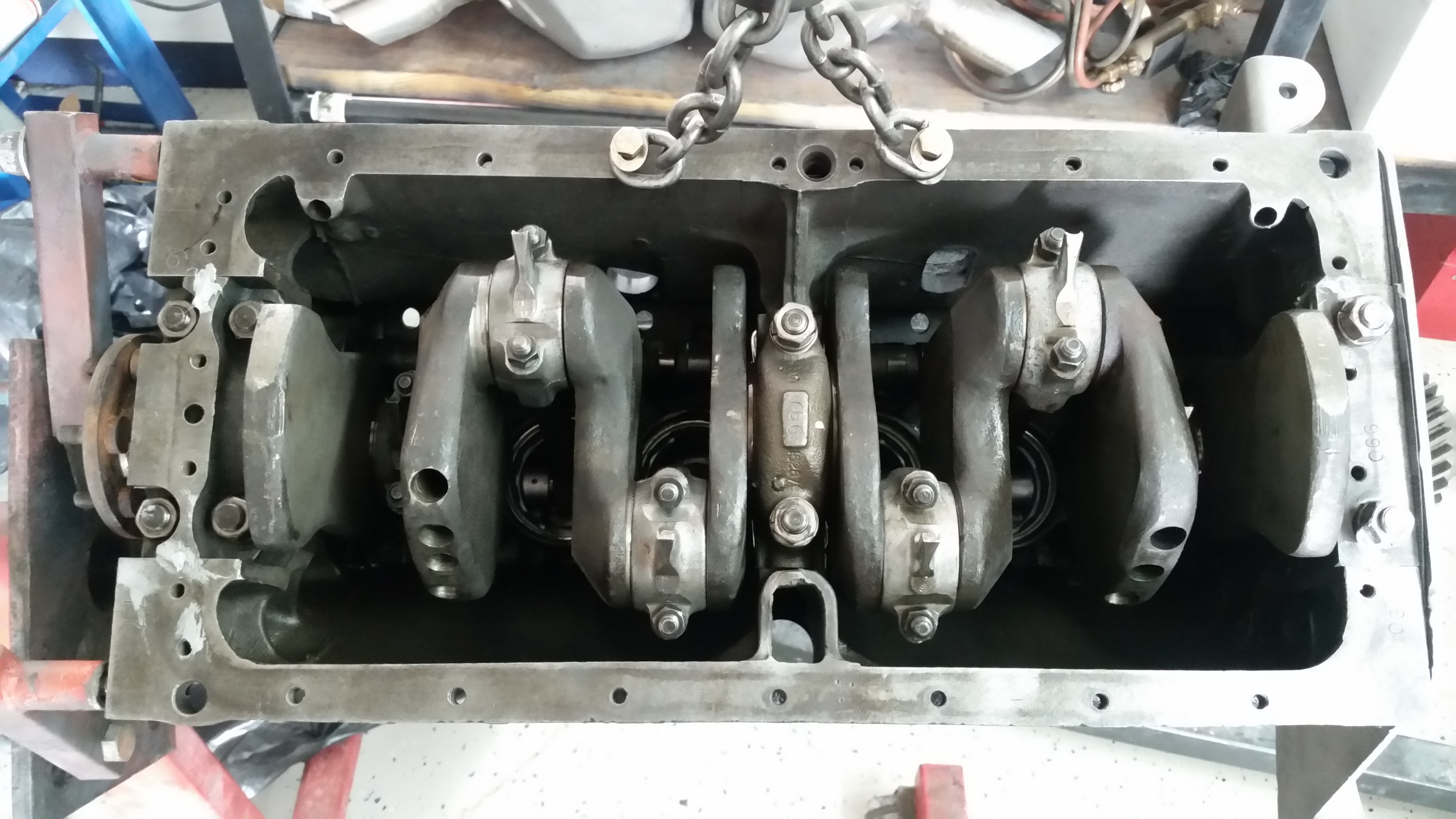

This is what I'm working with... Pretty bad but could be worse I guess. I'm going to pull the motor our in a couple weeks in my shop so I can better assess the damage.0
Just for fun, why not put a notice in the Parts & Pieces section of this forum, asking if anyone has a good used engine -- or even a decent block -- for sale? Even if no one here does, they may know of someone you can contact. It would be so much easier to simply drop a good-running engine in there -- or re-assemble the engine using your internal parts and someone else's solid block -- than to fuss around trying to patch this block. And quite possibly a lot cheaper.

Looks to me like the cap bolts must have come loose to allow that to happen. I reckon the good old fashioned castellated nuts and split pins should never have been done away with. However, providing the cylinders and crank are not damaged that block is repairable with a screwed on patch.

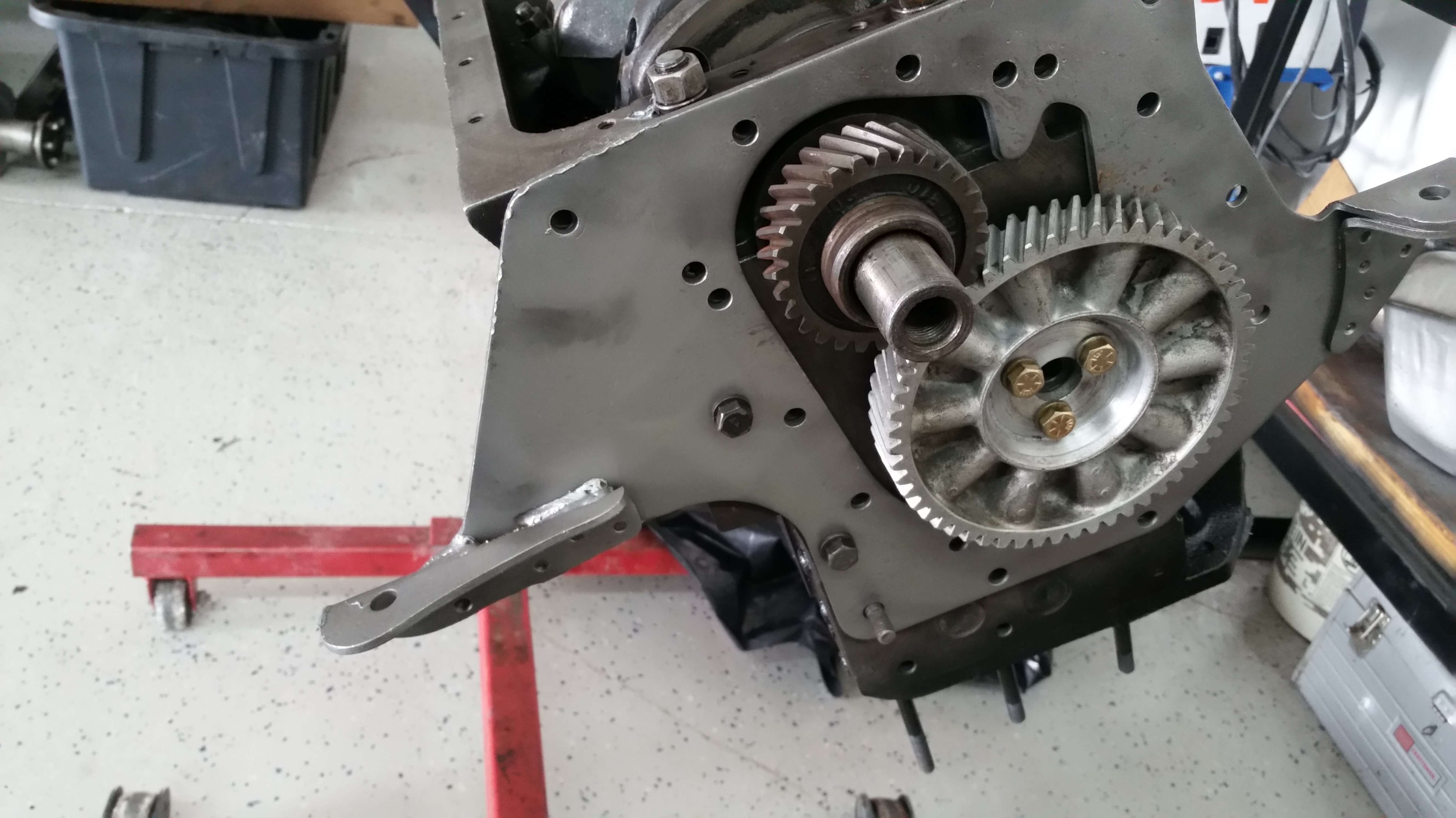

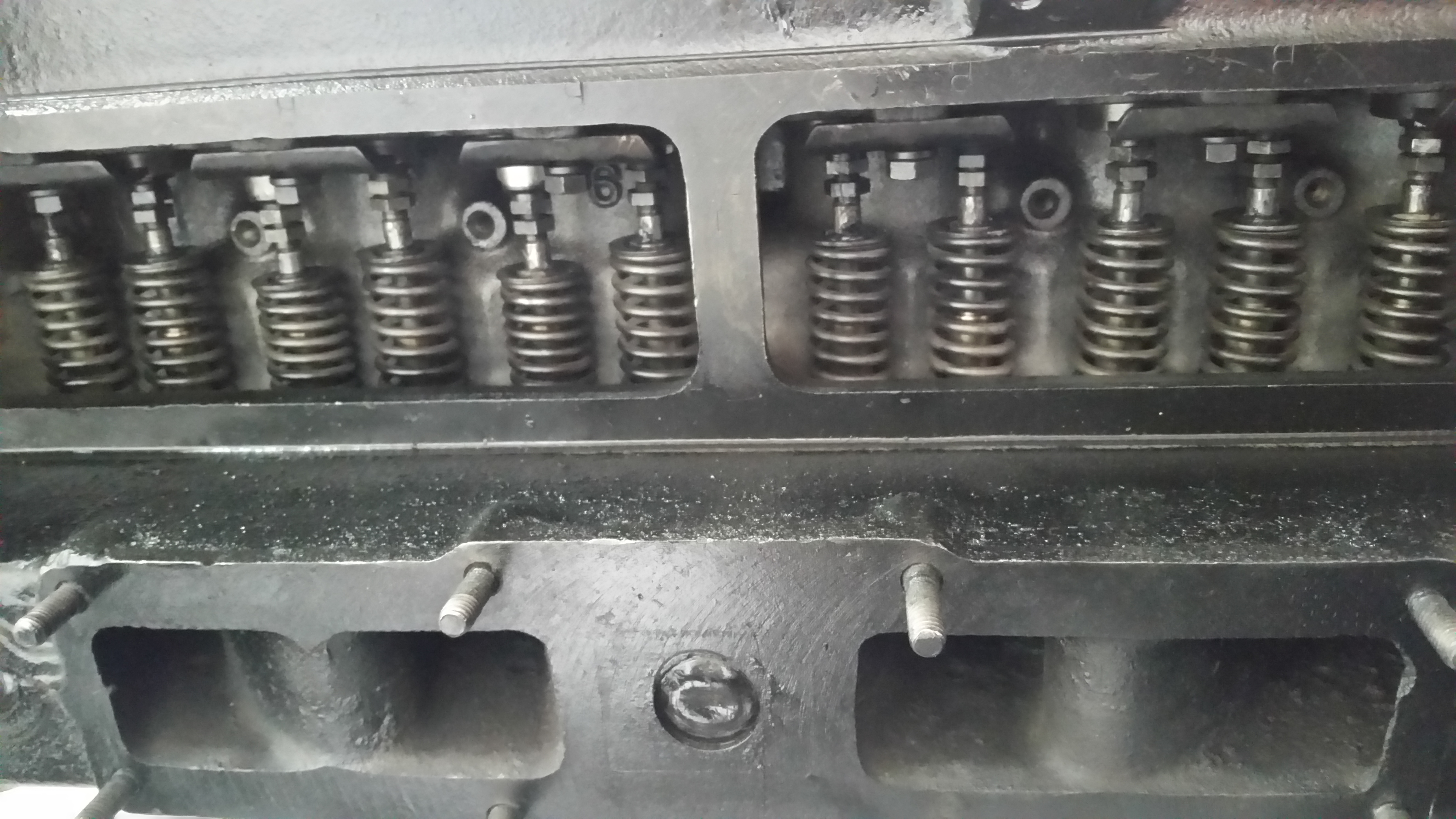

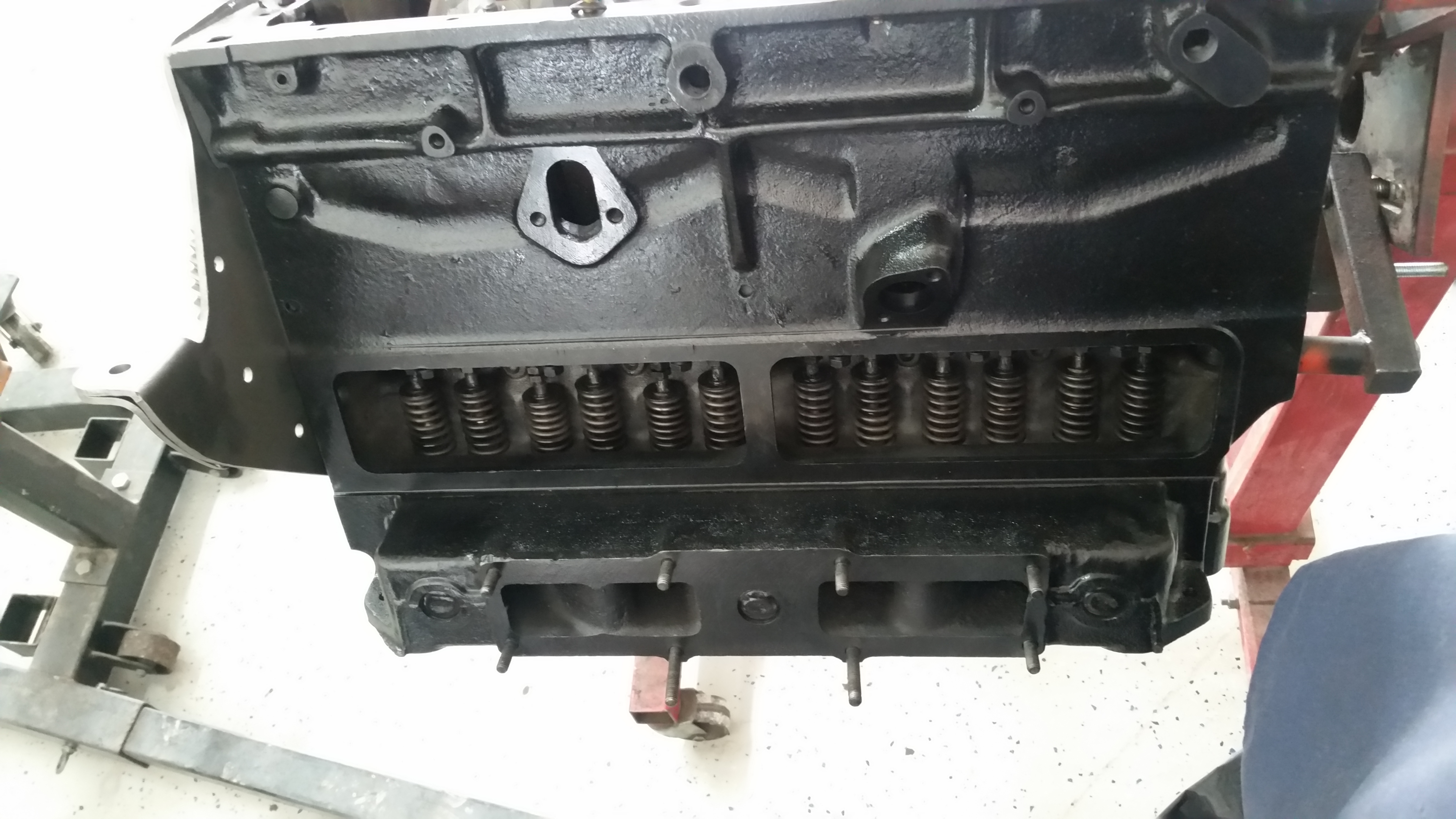

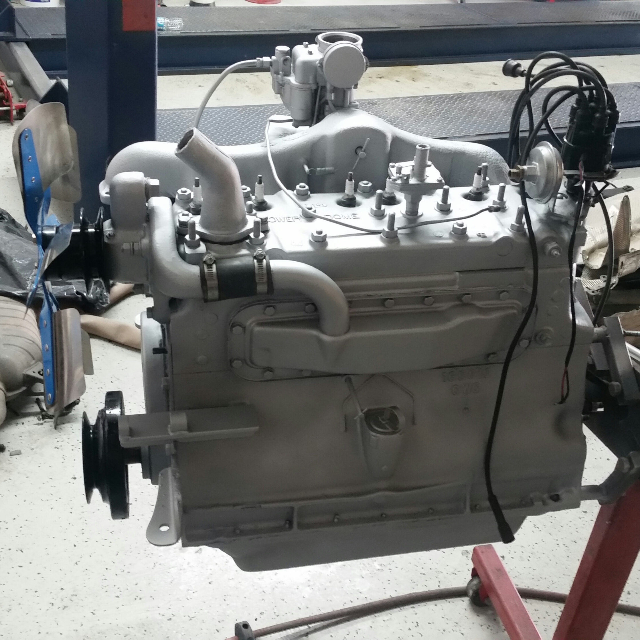

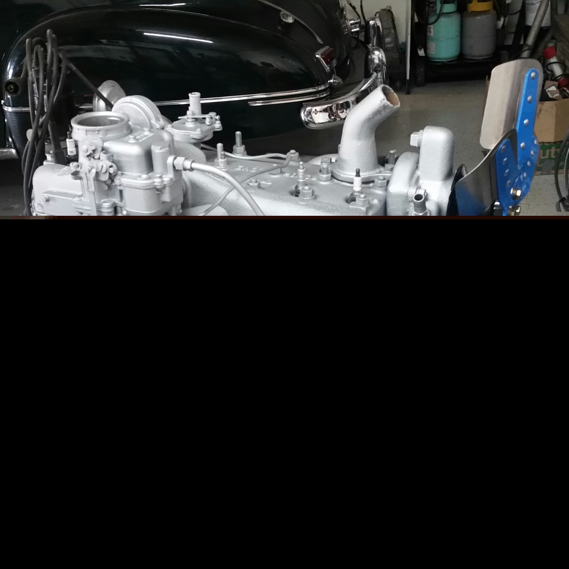

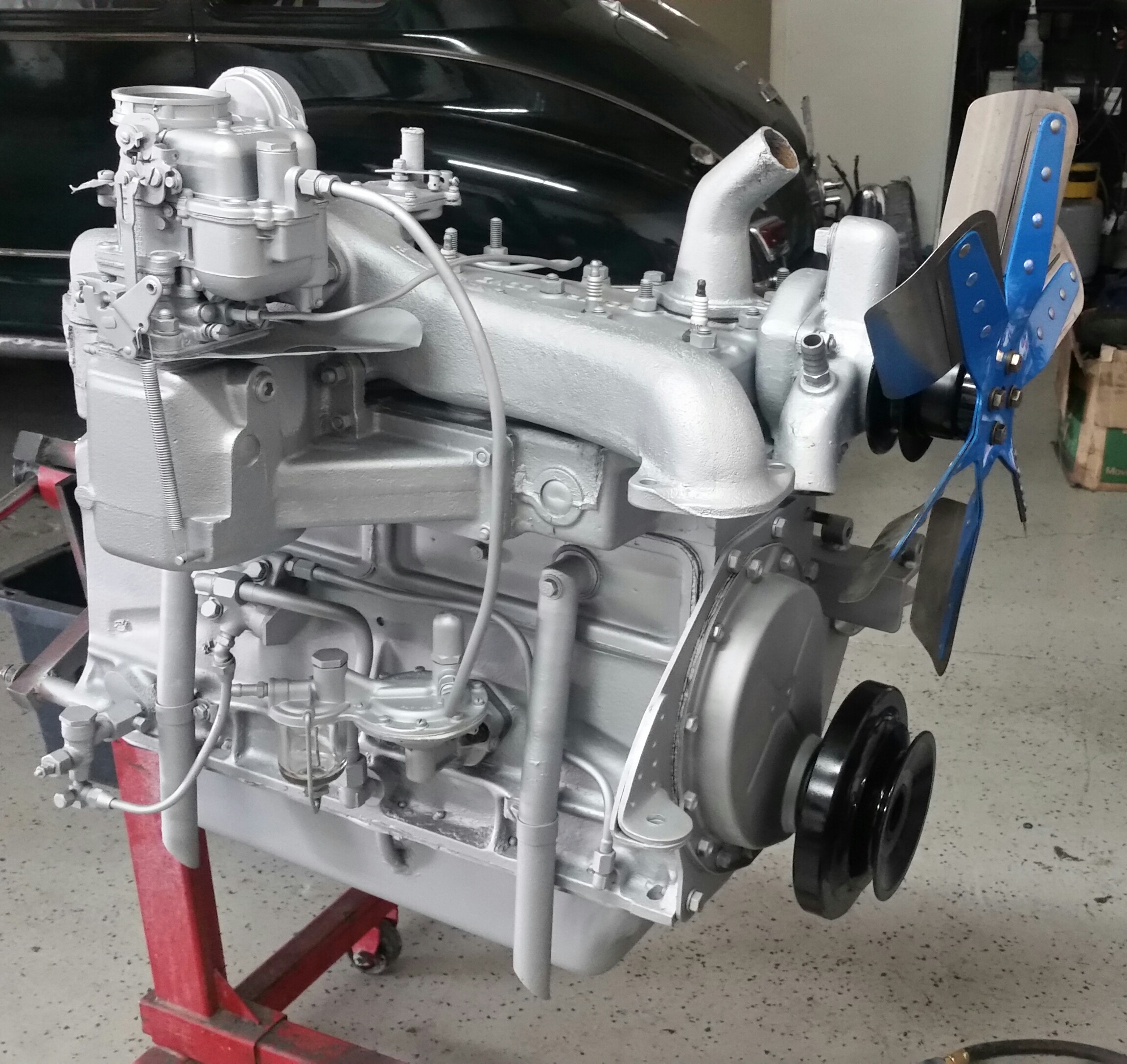

This is how the my 212 block looks now after 2500 in work just have to pop the head and accesories on it.0

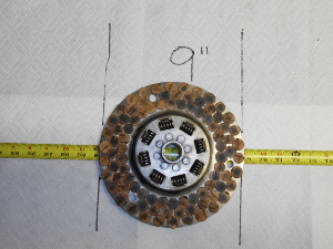

Need a cork 9 inch clutch for a 1947 Hudson six 212 drive master mine has one spring that is broken if anyone has one let me know thanks.0
The clutch is no problem, we have a couple guys doing those in the Club. My personal recommendation is Doug Wildrick. (You didn't say what part of the clutch, but he sells all the components.) http://wildrickrestorations.com/hudson-wet-clutch-parts.html
If you were even remotely interested in switching over to an overdrive transmission in the future, you would want to consider installing the larger 10" clutch rather than repairing the 9"..
Also: which spring is broken? You may need to be a bit specific. If it's for Drivemaster, someone may have one lying around to sell, but they may not be acquainted with Drivemaster, so wouldn't know they had it.
Hi thanks Jon B I need the clutch disc plate with the little round cork inserts. The spring that is broken is on that same plate two other springs are badly worn.0

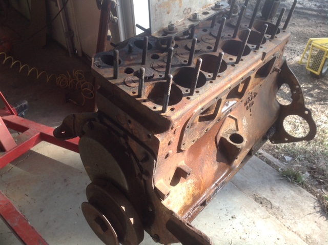

Here are some pics of my 212 six motor and the Hudson motor sign0
Well, you can attempt to find the correct springs and maybe cut up some wine bottle corks, but personally I'd just buy one outright! Like I say, there are people who do this for a living!

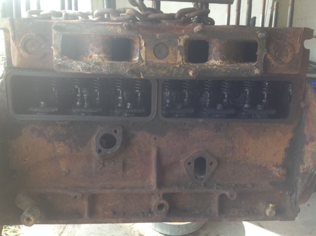

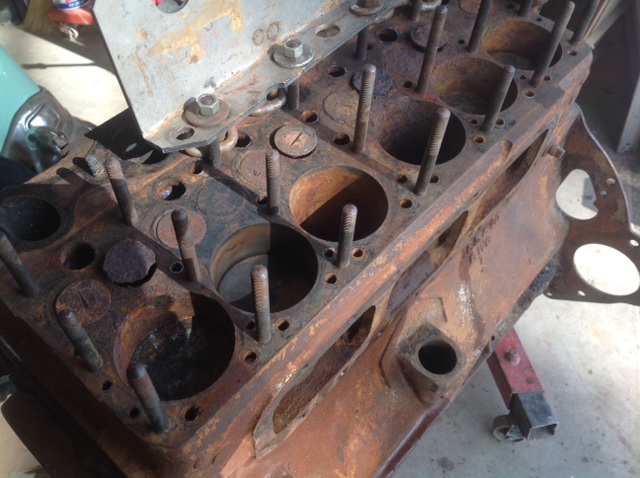

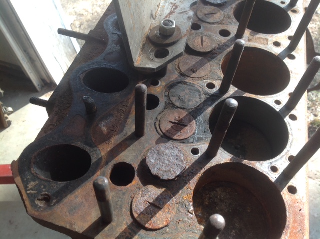

Thanks again Jon B I am purchasing one from wildrick. I Baught the 212 block from Melvin Faulk check out some before pics big change and lots of work!!0
WHY DID YOU PAINT THE CARB ??0
