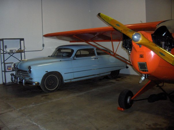

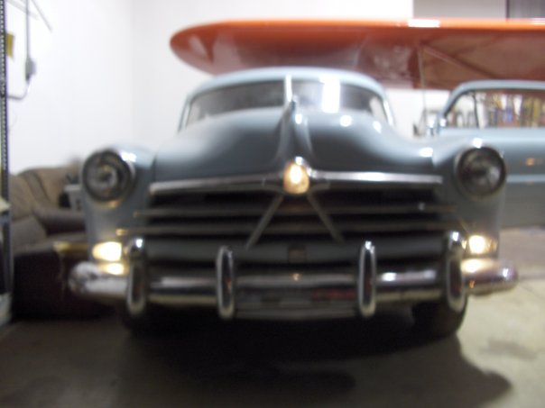

Wow, just realized I haven't posted the latest updates on the 50 Super 6. She runs, drives, and stops all on her own now!!! I did put a couple vids on the Facebook page, if anyone wants I can repost them here. Still need to redo all the weatherstripping and a million other details.... But I am super happy about the progress so far. The next couple weeks will be moving into a new shop, of mine own, with a lift, so super thrilled about that as well. No more "borrowing" friends lifts and working by their schedules....
Pictures PLEASE0

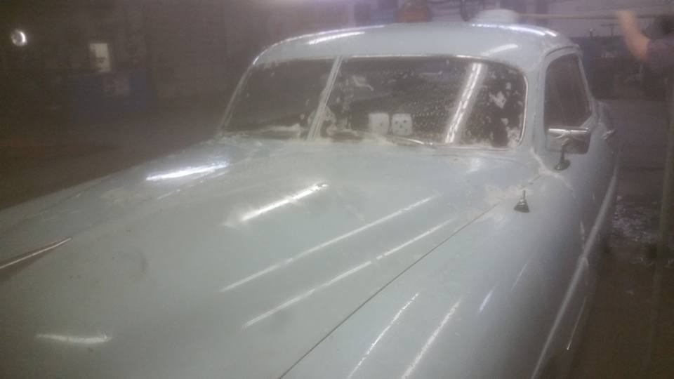

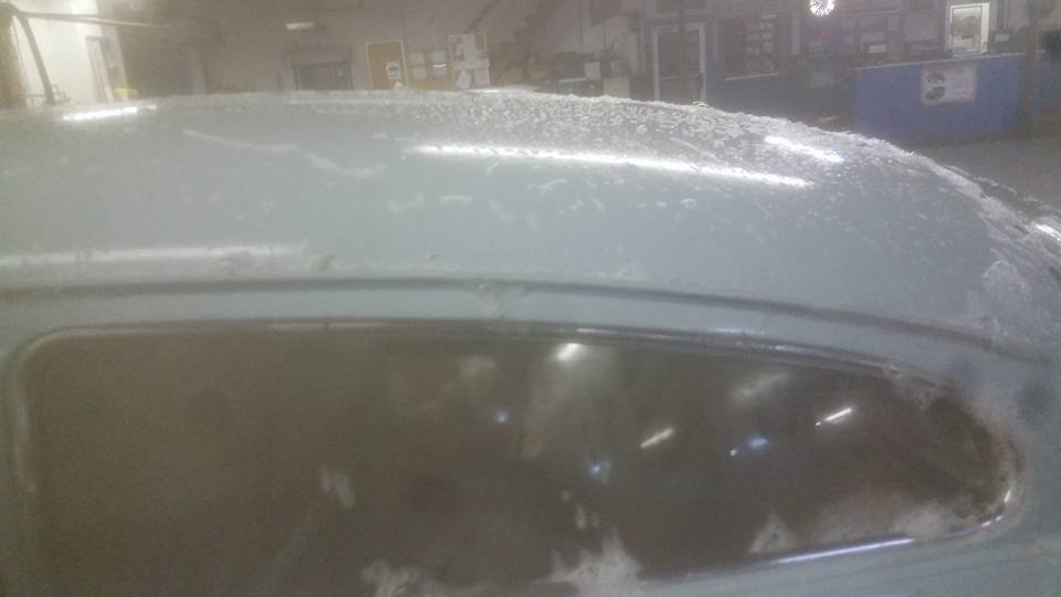

Pics.... washing a few years of bird crap from my storage building off her....
