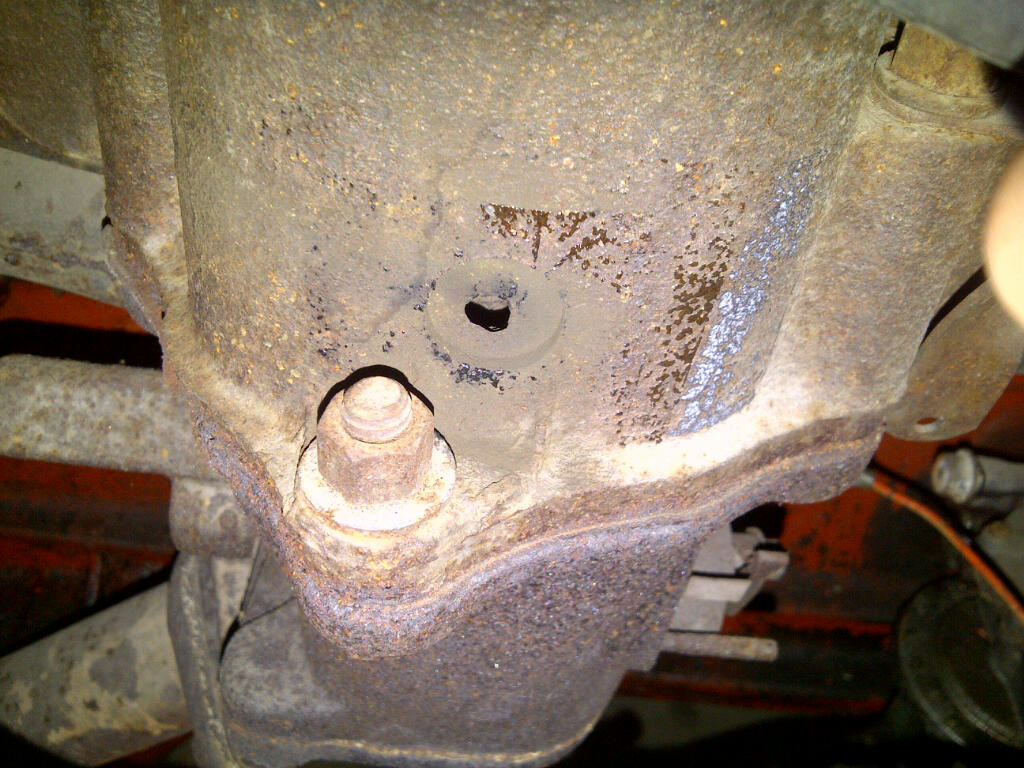

Hi everyone: My son-in-law is in the process of ending up with a Hudson Super Six convertible that has belonged to his grandfather since 1979. Unfortunately, his grandfather is now 90 years old and can't help at all with providing any info about the car. I'm more a street rod guy from the 1960's, but am helping him get it going after being in storage for about 5 years or so. It's a cool car and I'm having a ball thus far. The car is titled as a 1947, but the serial number from the title and door post being 3173678 falls into the range that online sources cite as a 1946 Series 51. My first question then, "Is the car really a 1947, or could it be a 1946 that has somehow been titled as a 1947 at some point?" The engine has a casting number of 304539 with head markings of 308 and Power Dome 309121. The block is stamped at the right front as 202797 which online sources would identify as a "late?" 1952 model year engine/SN. We are currently replacing all the electrical tune up parts in hopes of getting it running soon. My question with regard to the engine is that there seems to be a hole in the intake manifold casting just below the carb and facing the fender where perhaps a plug of some type was and should be. It backfired some flame out of this hole when we were initially cranking it. I plan to just use some metal tape over it temporarily, but "Can someone shed some light on this hole/missing plug?" I'm new to this forum and look forward to everyone's expertise as we get this classic back on the road! By the way, the car has been converted to 12V, negative ground in the past.

If the car now has electric wipers, you may be seeing where the original fitting for the vacuum line for the wipers was installed. The hole will be a pipe thread, so just install the proper size pipe plug.0

We got the car running yesterday! After some initial roughness and sputtering it settled down and ran extremely smooth. We are definitely excited now. There were a few issues with some purchased parts and I will be posting some questions about those. There also seem to be some issues with the shift linkage that will have to be addressed before we can attempt to drive it around some. That hole I mentioned actually produces some pulsing from the exhaust, not vacuum, so could it be for some type of heat riser purpose? The strange thing to me is that it has rough edges and an irregular shape. I'll post a picture when I get the other questions together. For the old farmer, I'm in Weatherford, TX and the car is located near Gainesville, TX.0

Here is a picture of the hole I referred to in the intake manifold below the carb. There are similar casting marks on what I would call the "back" and "front" sides (toward the back and front of the car) with what seems to be a slightly rounded head of a plug(?) in them.0

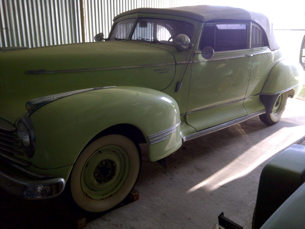

That's one lovely looking car!I bet you're looking forward to it hitting the road0
Yes Paul. Working on cars is always fun, but driving them down the road is better! We'll be looking at our shift linkage issues later this week. When we get those sorted out, we can at least do some preliminary moving around and discover what else needs to be done.Ken, any suggestions on sourcing the expansion plug? Thanks for the input.0
