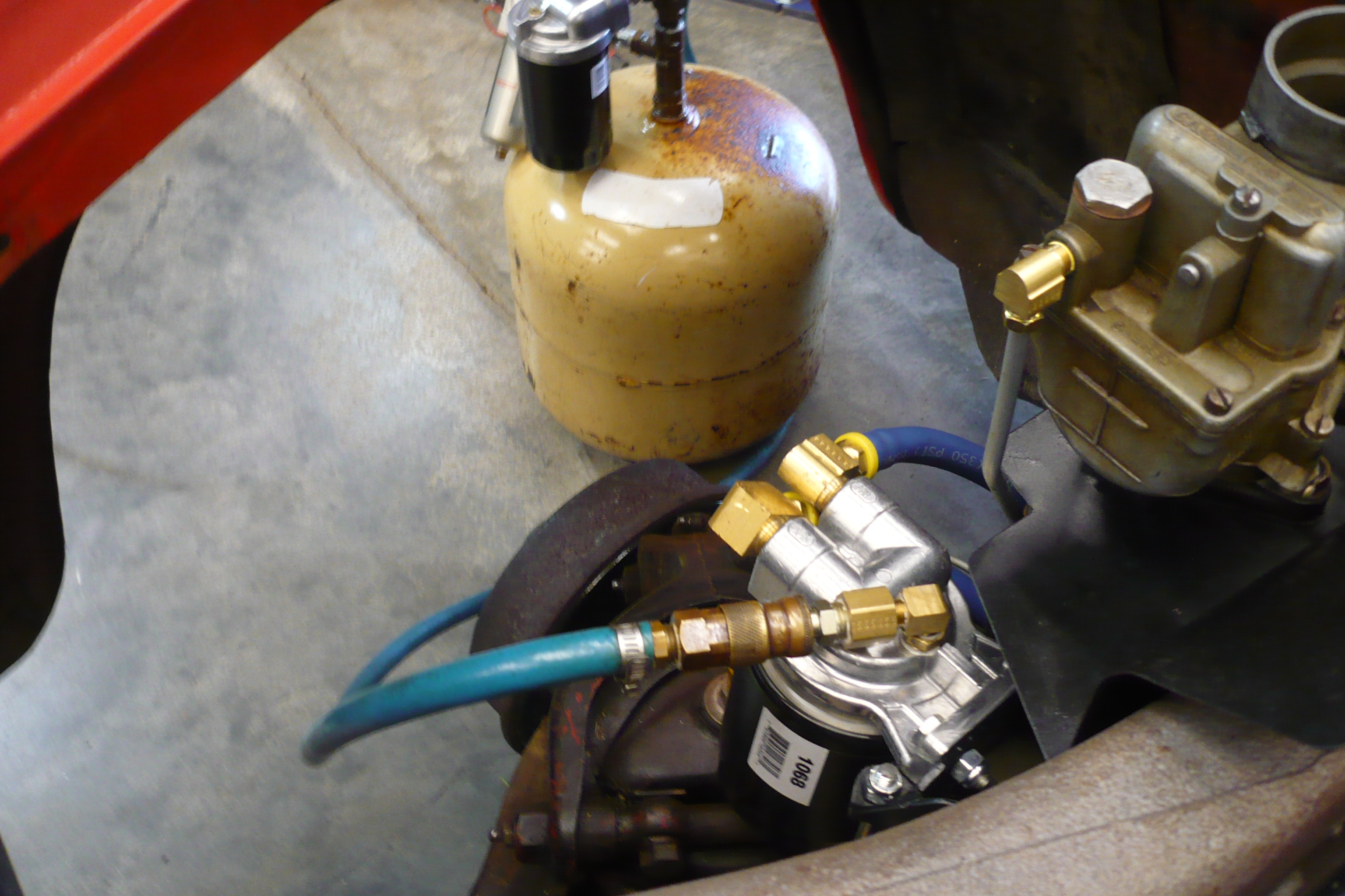

I had thought about priming last night but I wasn't sure if it worked like my old fords.....sounds like it doesn't. Is there a way that I can prime it before attempting to start it? Maybe rig a way to send oil through the sender hole? I know I can pull the plugs and turn it over once installed but I'd hate to even turn the crank a couple of times if the journals are dry from sitting so long. I'm sure they used the sticky assembly lube but I doubt it would still be coated if sitting so long.0
There are pressurized oiling kits available. Oil filled can with flex hose. Sometimes come with rebuilt engines.0
50,

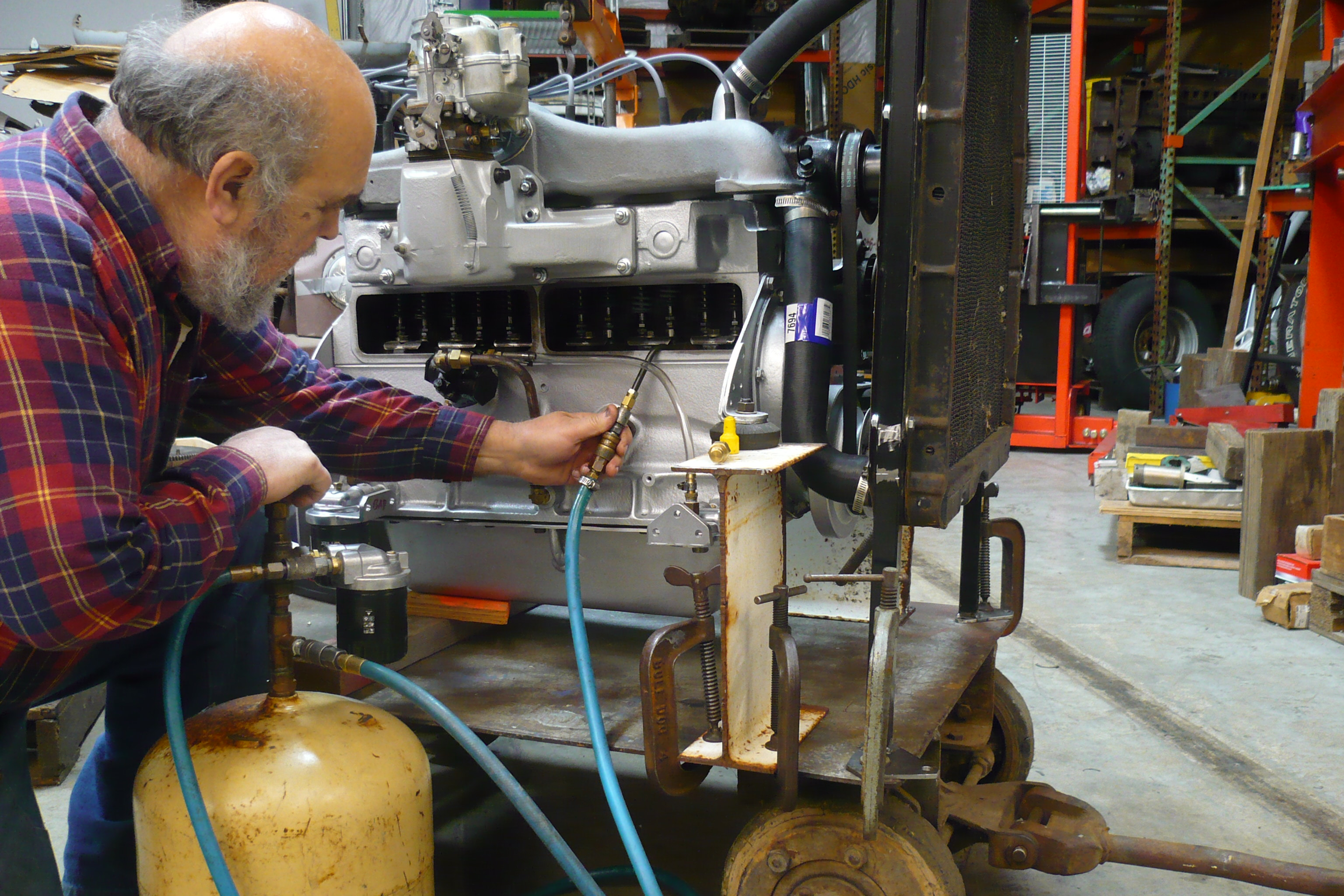

I use a pressure pot connected, as you had surmised, at the pressure-switch port. That primes the pump as well, running oil backwards through the pump (at a low rate since it's passing through the normal internal pump clearances), pre-filling it and giving you instant O/P at start-up.
The "small block" and FE block Fords (and many others) can be primed by removing the distributor and driving the pump with a hex shaft from above, but that's not possible with the Hudson. An up-side is that, since the pump drives the distributor, if the pump ceases to turn (stripped gear, sheared drive pin, etc.) the distributor also stops, killing the engine instantly. In the opposite driver/driven scenario, the engine will continue to run, potentially to destruction, if there is no warning light or "looked-at" gauge.

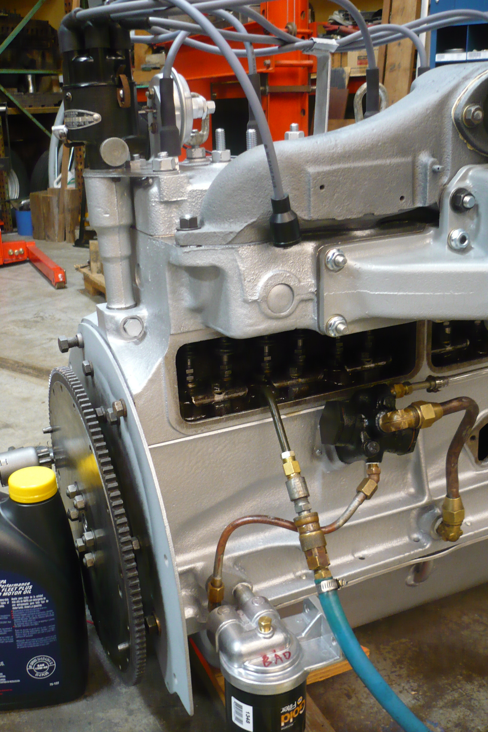

Here's a shot (however poor) of the pressure pot plumbed into the gauge port on the filter base of a 202 Jet. The outlet of the filter base goes to the aforementioned pressure switch port on the engine, just like the 232-262-308. The double filtration (pot and engine) isn't really necessary, it was just a convenient place to attach the pot.
F
I'm curious about the setup too. I was thinking of using a pump sprayer bottle but I'm not sure what PSI is needed to push the oil through. If it's more than 20-30# then maybe I can rig up something using an auxiliary air tank....the $30 deals at Harbor Freight.0

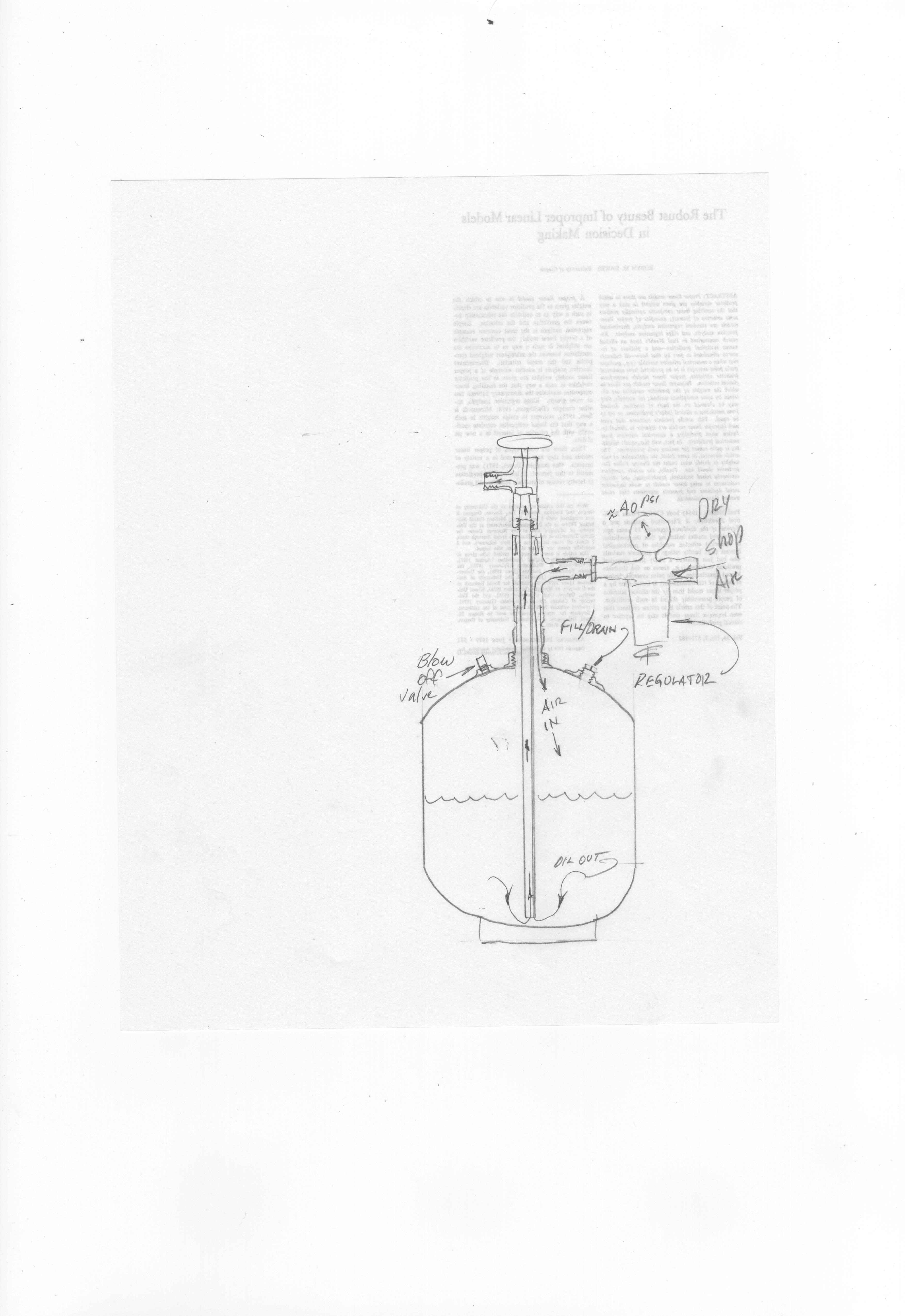

For those who inquired about my pot design, first, I must pre-empt the "all-you-gotta-do" and "cantcha-just" replies with the statement that I can't do much of anything the easy or quick way......I need to make a project out of it in order to feel like I've accomplished anything. Personal problem.
So......A sketch and photos follow.
Criteria: No penetrations below liquid level.
Controlled, uniform pressure by shop air, regardless of volume remaining.
Controllable discharge rate.
Last but not least, make it out of crap I have on hand.
Photos:

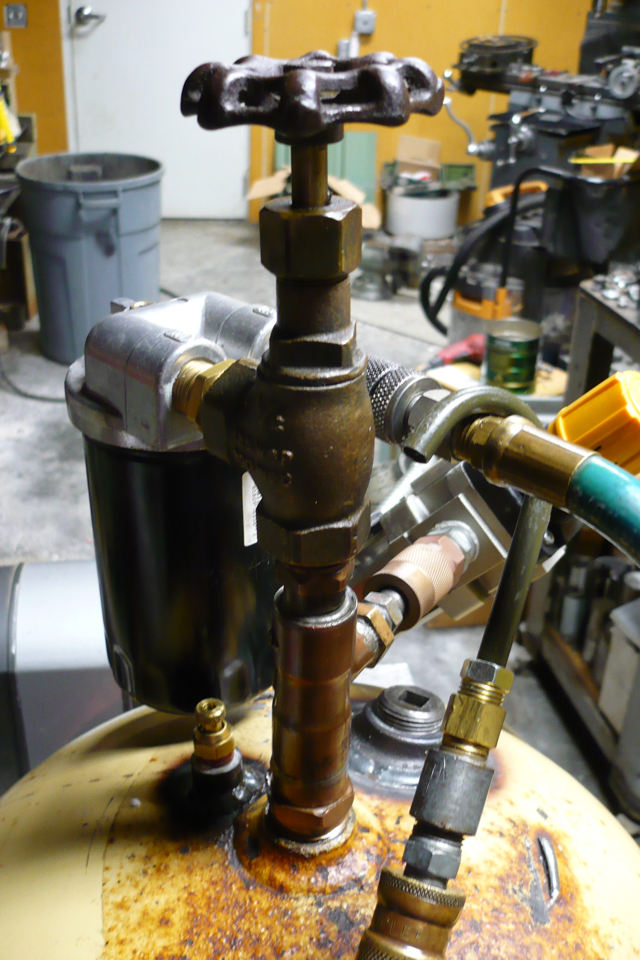

732, 33, 34) Air enters through the coupler (with regulator attached), passes into the tank via the annular space between the discharge up-tube and the tank attachment fitting. Oil is forced up through the discharge tube, through the globe valve and then through the hose, adapted to whatever connection suits the project.

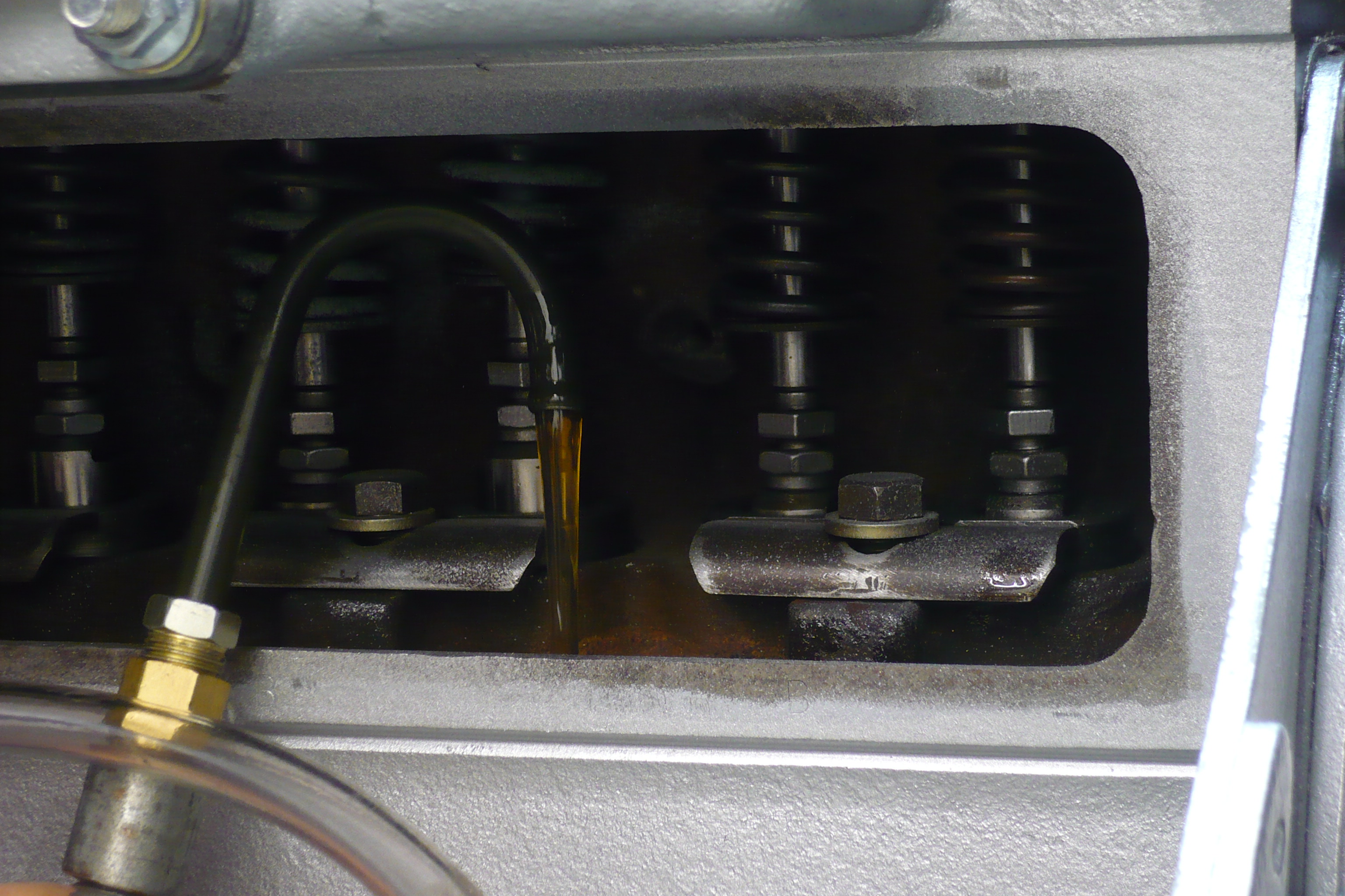

The "J" tube shown is handy to pre-fill dipper trays in the Splashers through the tappet chamber floor drain holes. That way I can assemble the engine completely without the potential catastrophe of installing a pre-filled tray. (276, 287 [sunglasses suggested], 288, 289)
