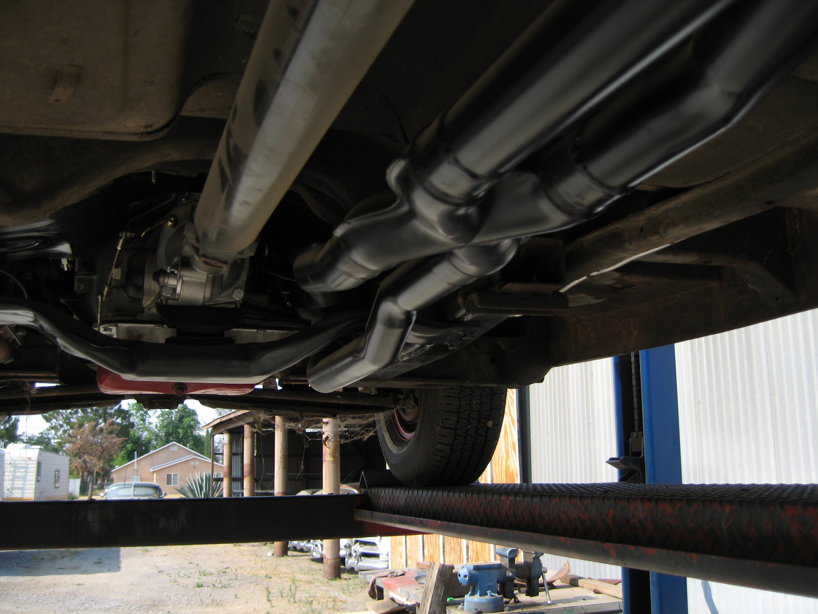

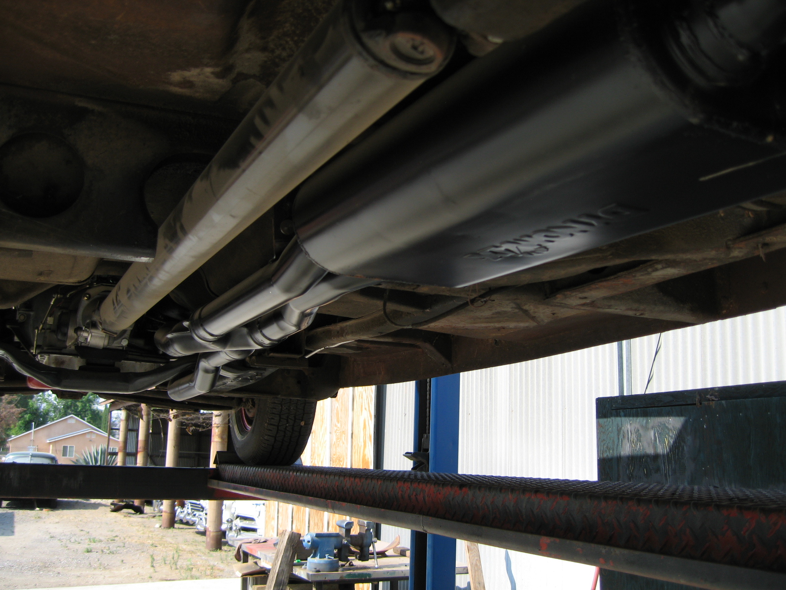

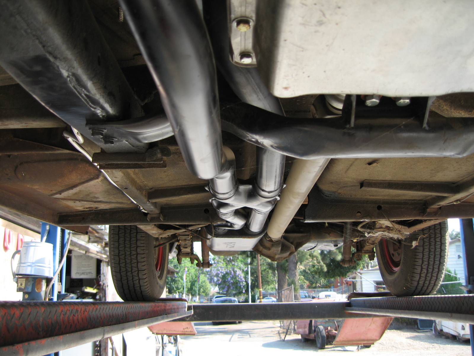

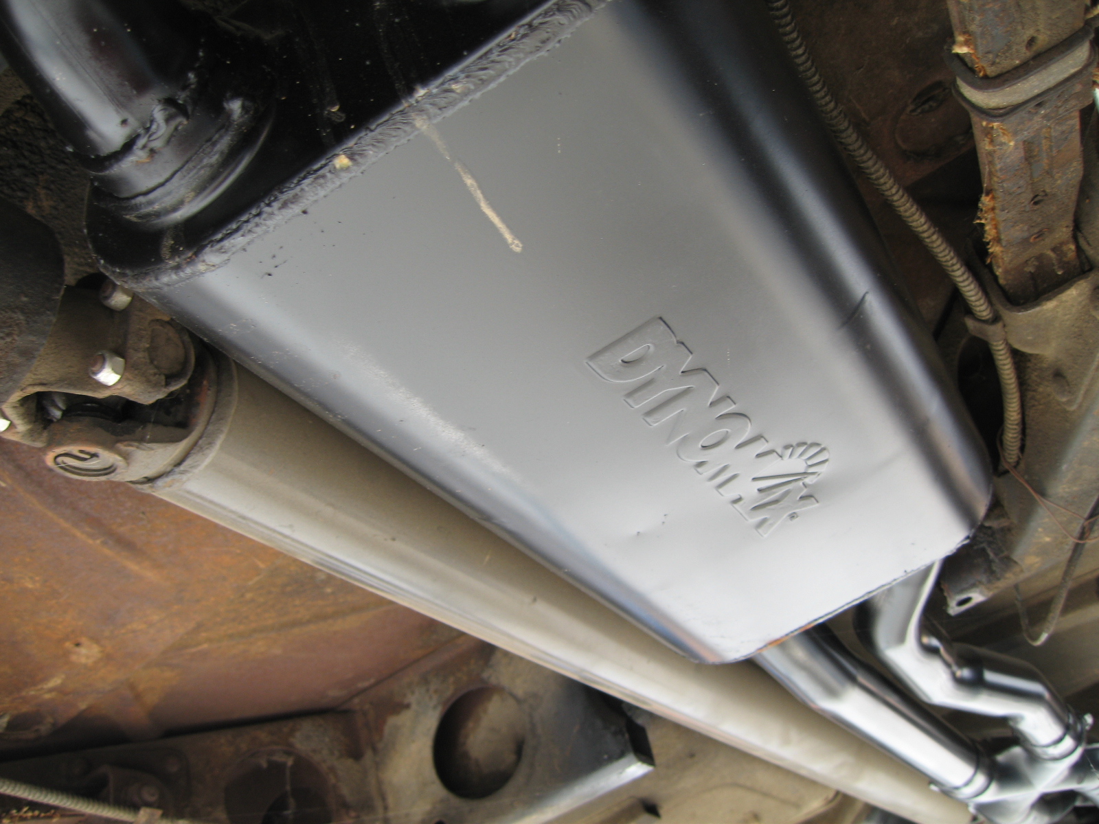

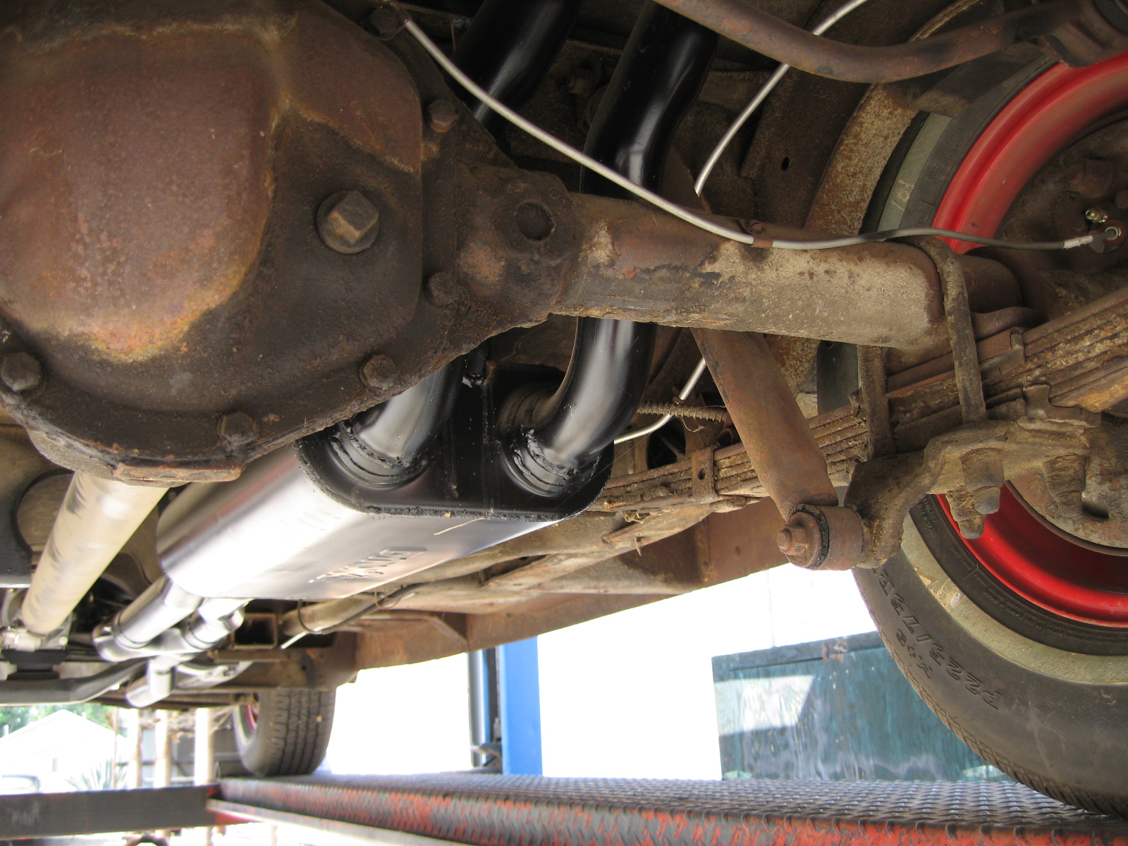

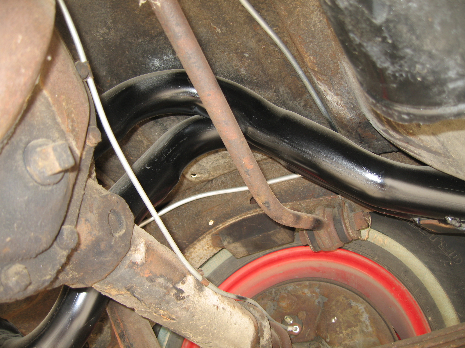

Interested in specific info as to how they interfere with wheel well, intake manifold, driveshaft tunnel and how they can be made to exit rear. Any shots from below would help.For some reason, old pics on this site don't show up in old posts??Thanks0
Wish these were mine - I do believe they came from a user on this site.
FWIW airbrushguy, Mine's slightly different, but the routing of the pipes is similar to what you are going to have to go through.'52 Hornet, so it has the upright wheel well. '52 and later is the toughest to do duals on, I can assure you. There's just not much room, especially for bigger pipes. I don't have pictures handy, but can explain. Also, what I got is not what I wanted, but the guy doing my exhaust made decisions w/o me. Instead of headers, I've got the 7X splitter which takes it from the manifold and dumps into two pipes right away. Those two pipes need to run side by side on the passenger side of the driveshaft until you get to the heat deflector where the muffler(s) go. Here, you can dump both pipes into one muffler and exit with two or use two mufflers, 1 for each pipe. Mine's got a single muffler, but both options work. From there, once you go over the rear end, the driver side can divert up by the top and in front of the gas tank and then turn beside the tank and continue on out the back.You can't really be up beside the frame at the rear, you have to be below it, as there's just no room. So, if you have a tail dragger, like mine, it's a little sketchy on going up a steep driveway (but the stance is killer). Mine is lowered 1-1/4" in the rear.If you run seperate mufflers, I highly recommend a crossover somewhere, for a smoother exhaust note. If you don't, and you run something like glass packs, you get a loud BAP-BAP-BAP on the rundown, which is obnoxious to me. I prefer a smoother rumble, but that's just personal opinion.0
