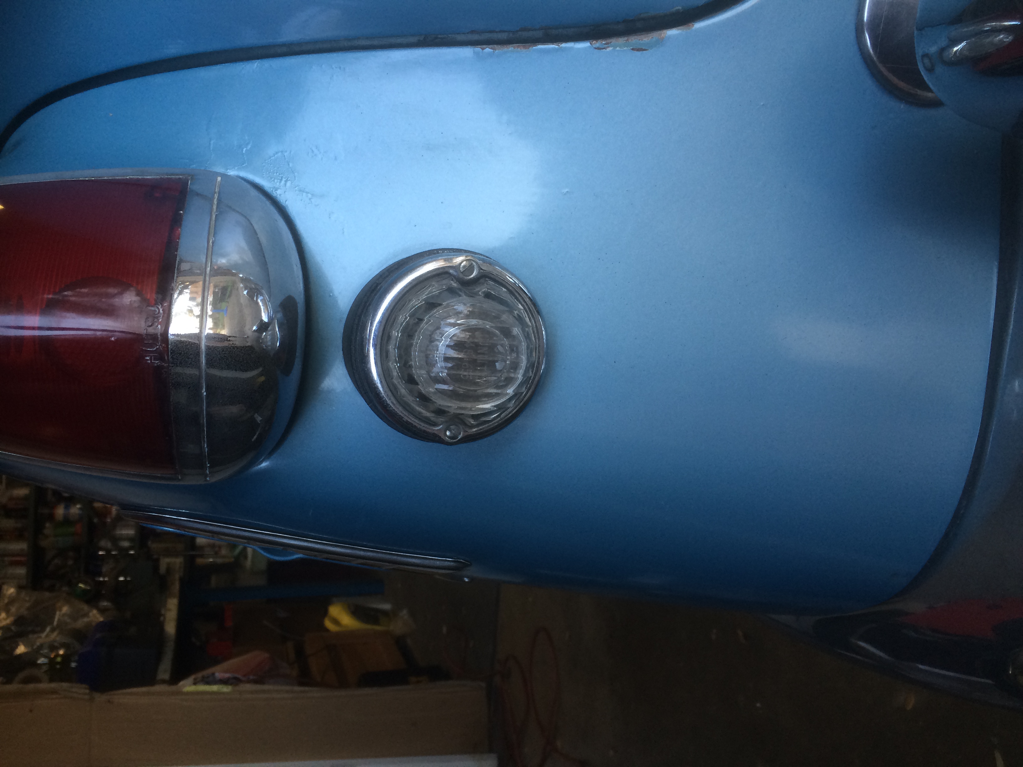

Backup lights were an option available from the dealer either before the sale or afterwards.0

Back up lights and turn signal diagrams are found in the 1953-54 Mechanical Procedure Manual.They are quite small! Will need magnifying glass.0

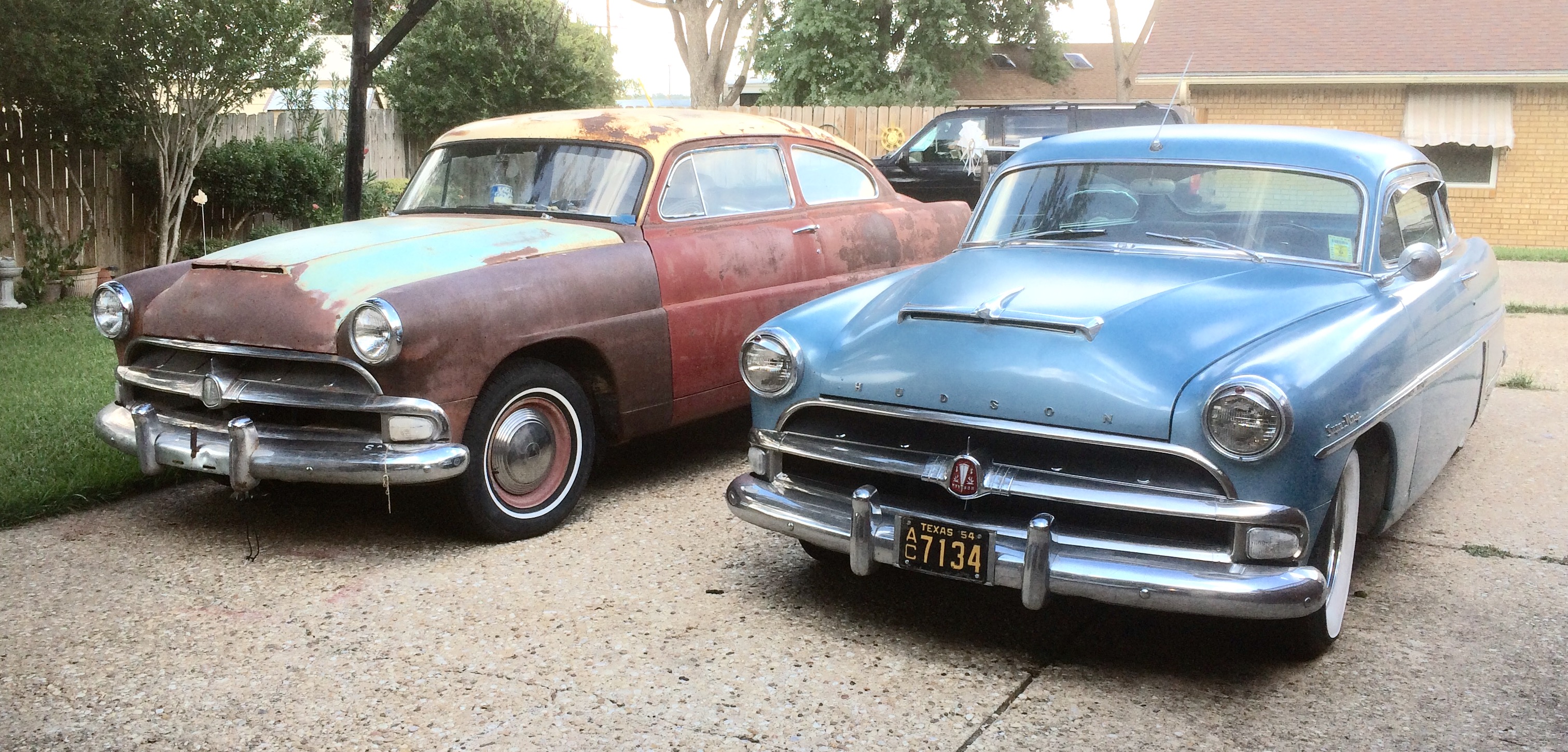

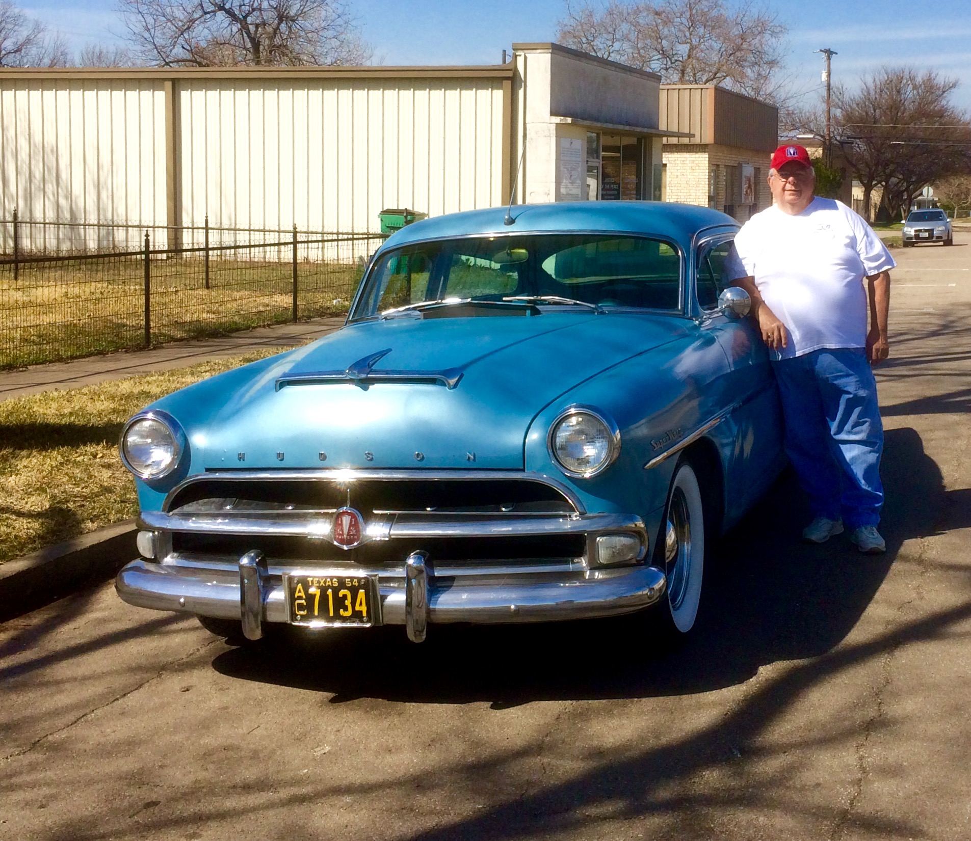

Jim - welcome to 1954 2 door sedan ownership! I own 2 albeit they are Wasp variants. The wiring diagrams and information about Hudsons can be found at this page http://hudsonrestoration1948-54.com/ElectricalSystems.htm Explore the site there is a wealth of information for your use there. http://hudsonrestoration1948-54.com/index.html#RESTORATIONAIDS0
