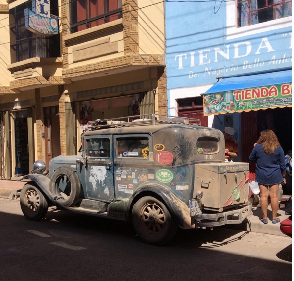

Heidi says that the water pump failed and is totally frustrated with mechanics that don't know what to do, according to her posts with pictures.

l'm amazed that Heidi found a workshop that as well filled in the huge hole on the engine block side also recreated the piston crank from nothing Real 1920's solution :-)0
What's the story about the hole in the engine block?
Hi Jon Heidi put pictures of the hole and its repair on Instagram. Seems one of the piston cranks let go and went through the block - probably the real reason why she had fluid loss - Heidi said the car was running rough during the day before it started overheating - I suppose running on 7 cyl isn't much different to 8 cheers ken0
Could this perhaps have been the result of replacing a "left" rod with a "right"?
What would cause the rod to twist so?
Well, she has consciously slowed down, so it might not be that. At some point recently she had to replace a rod but, not having a "right", had to use a "left" that she was carrying. (or vice versa.)
I was not aware you could do that, and wondered if that might have been the cause of the calamity. I have not asked her yet, if the bent rod was the one that was put in. In fact, the rod that failed might have been the correct one for its position on the crankshaft.
You can use a r. or l. rod in any position simply by reversing the cap, but you must then ensure that the bearing is fitting correctly. The chances of getting it bored exactly on centre are very slim, so some scraping and fitting will always be necessary. When Heidi came through N.Z. with the "new" motor I had grave doubts she would complete the journey without catastrophic failure, particularly the way she was driving the car. And Murphy's Law has a clause that says "All modifications will have an inverse effect on performance and reliability. "Geoff0

They are only interchangeable in that they must be hand fitted when you reverse the relationship of the rod and cap. Obviously the cap must have the scoop pointing the right way. In theory, if the bearing was bored exactly on the fore-and-aft and lateral centre-lines then you could just turn it around and away you go, but the probability of this happening is very low. As to my premonition, my ear-ometer told me there were severe problems with the assembly of the internals of the motor, but she would not allow me to explore further, because it was a "Newly rebuilt" motor, that had been shipped out from Germany. I did fix one obvious oil leak, but there was an inherent problem with misalignment of the retro-fitted alternator and the drive coupling which could only lead to further trouble. And having only an electric fan was also a problem leadign to overheating. A friend of mine installed a heavier duty fan, but even this would not shift as much air as a conventional belt driven fan.0

During her drive through Argentina, Heidi found that the engine was developing more and more problems, many of them having to do with the connecting rods. In fact there is now a hole in the side of the engine.
One repair followed another. Modern mechanics are clueless. The "old school" mechanics are dying off.
In Mendoza, Argentina, Heidi gave up, and had the car trucked 407 km west to Vina del Mar, Chile, northwest of Santiago. There, members of the local car club -- Club de Autos Antiguos 5ta Region -- are delving into Hudo's engine, trying to scope out exactly how to get this thing running RIGHT so Heidi can continue her trip in peace. Mr. Lars Sorensen, a resident of Chile and old-car enthusiast (among his cars: a 1934 Terraplane roadster and a 1928 Hudson 7 pass convertible) is a member of the club and arranged all of this.
