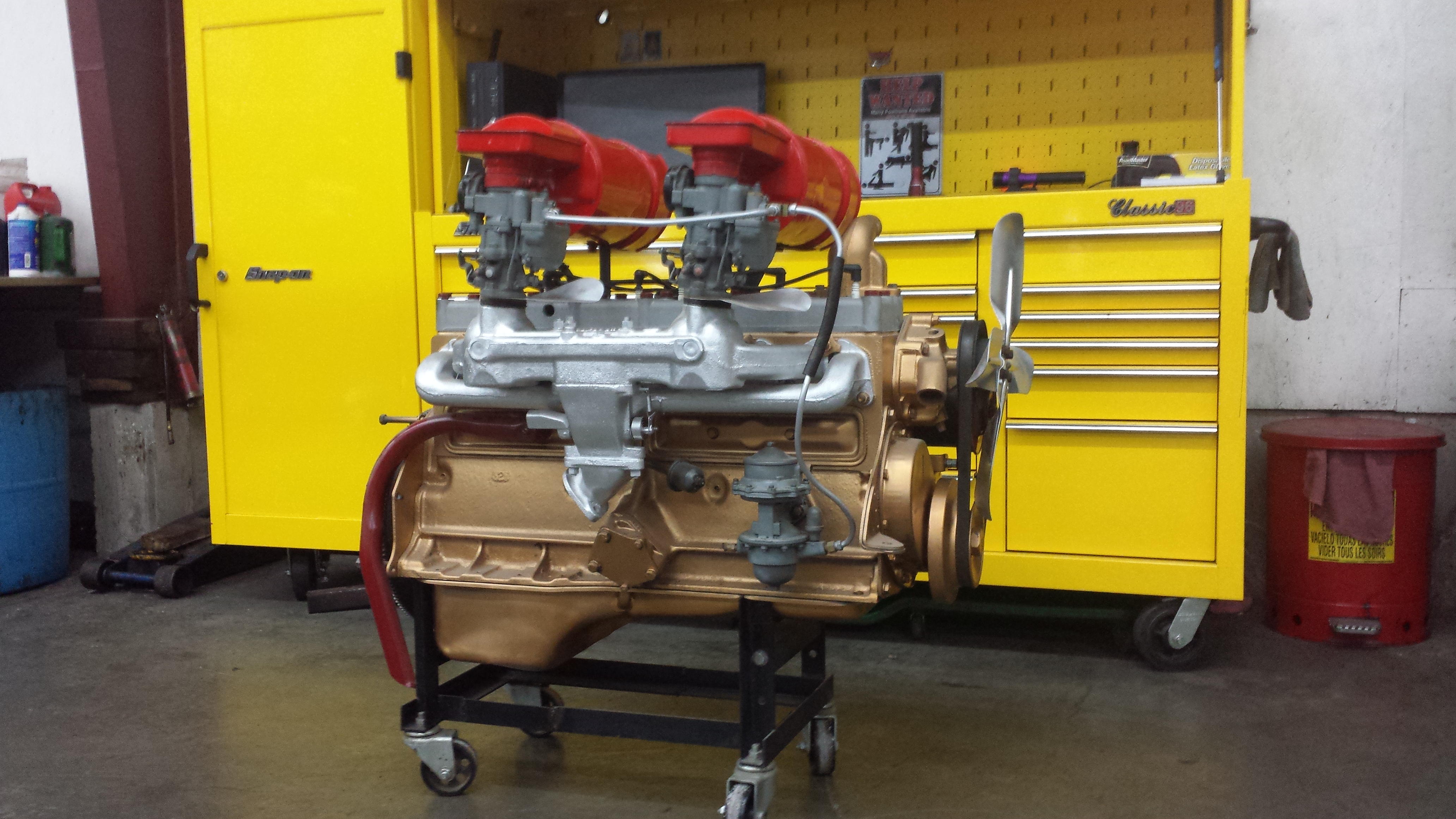

I have an aluminum head on the recent display motor that I purchased for the 308 Twin H for my 54. That is about all they are good for in my opinion...
