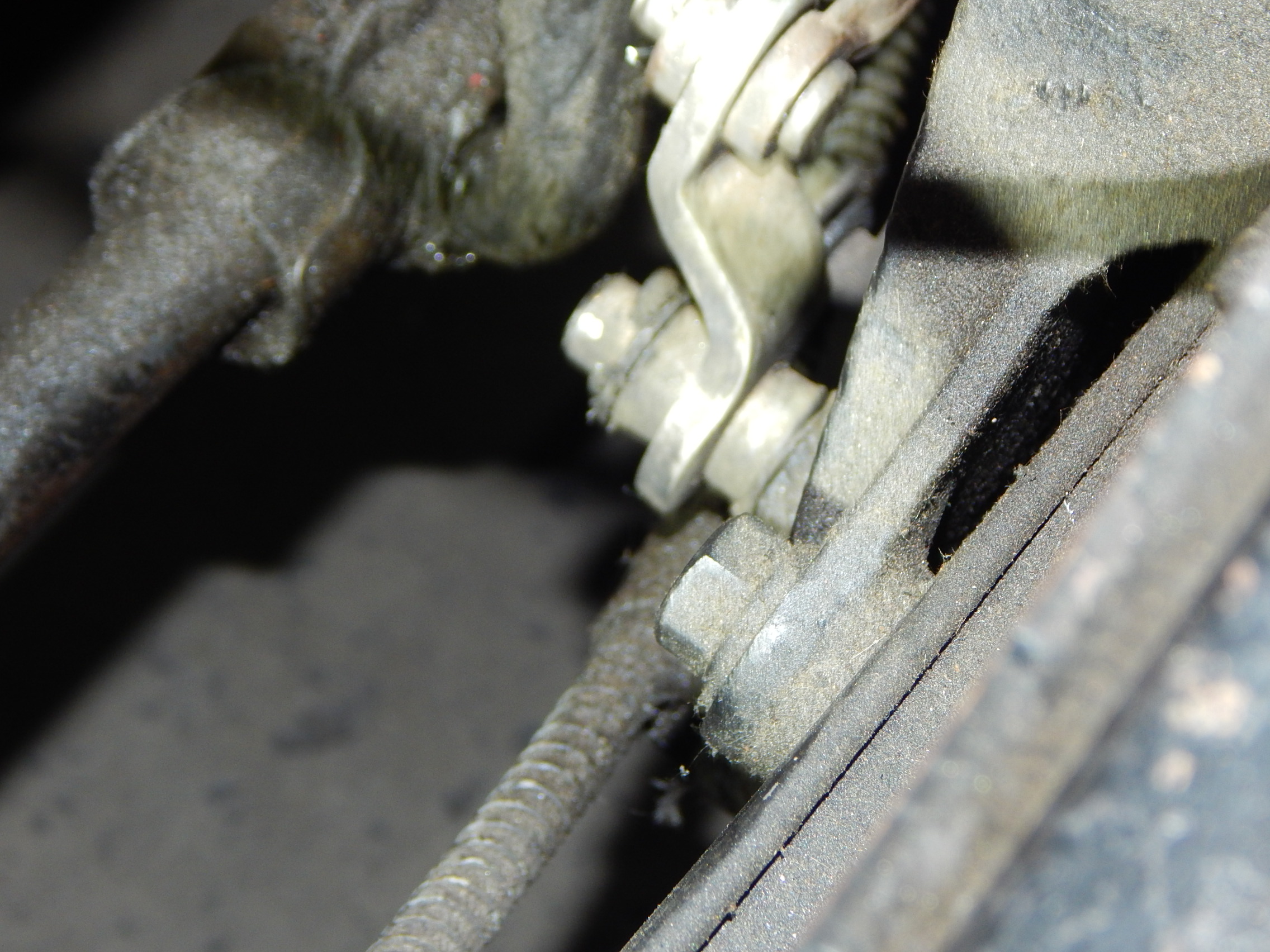

Okay so my trans guy has the car now and says that the bell crank has excessive movement and believes that there is probably a pivot bushing missing- does anyone have a source for same?0
See my webpage above is a link. The bellcrank repair actions are shown there. Note the end of the bellcrank that fits into the bellhousing side is fitted into a rubber bushing. God luck0
Thanks for that.0
Stopped by the trans shop. Mark says that there is a shift rod bell crank that pivots on the frame which has excessive play. He believes there was a bushing there which has worn away. Does anyone know of a source for a replacement bushing? Photo attached:0
I'll snap some additional pics when I pick it up today. The car came from Indianapolis if that helps.0

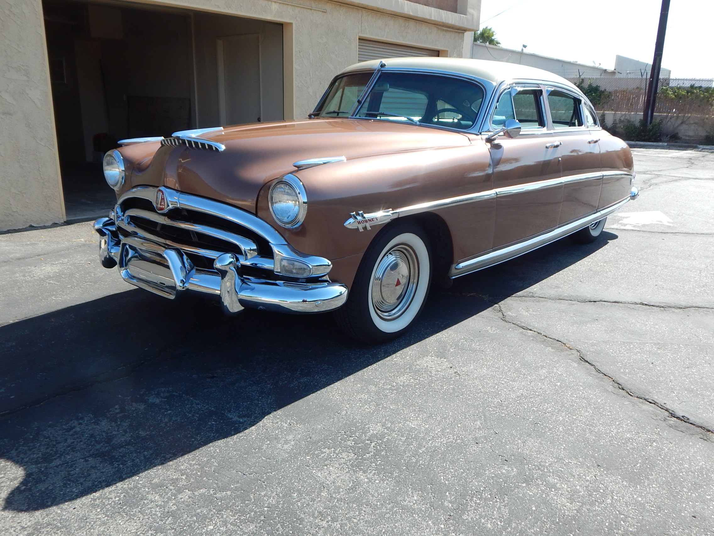

Good looking car, Jeff.0
Thanks. I have it back and Mark adjusted it so first is better, but looks like there will be some time invested in searching for parts. It's quite a nice driving car.0
